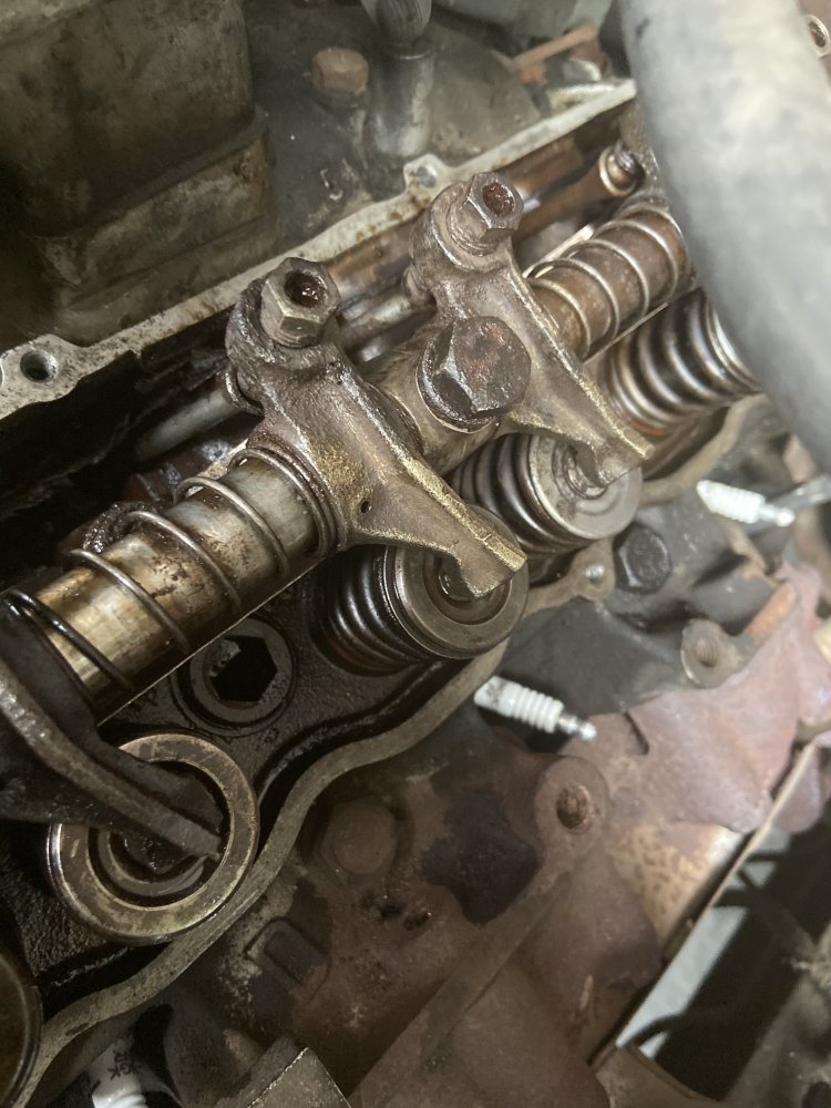

Ok, that makes sense. I wonder why it is then that the middle cylinder is having such an issue when you can see that the other two are getting oil, and are atleast not corroded. The ticking is loud. Too loud. And gets worse the longer I drive.

I don't understand why it looks so crusty and rusted? Where did the water or moisture come from to create the rust? Is the water causing the sludge build-up with the oil also?

no, the oil Is clean, and there’s no other signs of water leakage any where else. The bronco did sit for 14 years, it’s possibly it built up condensation. However if that’s the case the. I don’t understand why it’s only the center cylinder that’s corroded. Im thinking that somehow the corrosion is what’s causing the tick
I’m thinking that the rocker arm shaft is clogged up and starving the entire valve train of oil. It seams somewhat simple to remove and replace, I’m just going to go for it. Ill replace those two rocker arms while I’m at it. Worst case scenario, I put it back together and it still ticks.
That looks to me like you have either water or coolant in the oil. If the pcv system is plugged or restricted moisture can build up, that would be the good news. Otherwise a gasket failure or crack could be allowing coolant to ooze into the oil. Finding the source of the milk shake is first priority, the tick just slipped into second place.
I dunno, the other two cylinders look well oiled with no corrosion. Does someone have an oil flow diagram for this engine? How do the outter rockers get oil and the center two not?

From what I understand, oil is fed into the rocker shaft through the center bolt, and then Travels to each end.. from the shaft, the oil travels through the front hole that you can see on the rocker arms, then travels down each rocker arm and onto the valves. I believe the corrosion is clogging these holes on the center rocker arms.
There is corrosion because the bronco sat stagnant for 14 years with alot the vacuum/ breather lines unplugged. There is no water in the oil
I'd probably pull that rocker assembly off and clean up the parts - the center two at least, then readjust and do a compression check. If it had no clearance it could have a burned exhaust valve. Looking again it does seem to have oil, it's just ugly.
