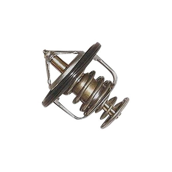

The gasket/o-ring my thermostat had on it looked like the picture below. I am looking for a better picture on the web, but this is all I can find so far. Can you see the black round the plate? It's like a o-ring with a slit in it. The slit fits around the diameter of the thermostat plate. I would think your thermostat would have come with one in the box.
Here's a picture of the gasket. You can barely see the slit in the ID of the o-ring.
I see what you're talking about. The thermostat did not come with a gasket or O Ring. Im getting all the gaskets and waterpump tomorrow. I figured i might as well change the pump out now while i have everything drained and disassembled. Im not quite sure why they put the thermostat down low, im sure they had their reasons.

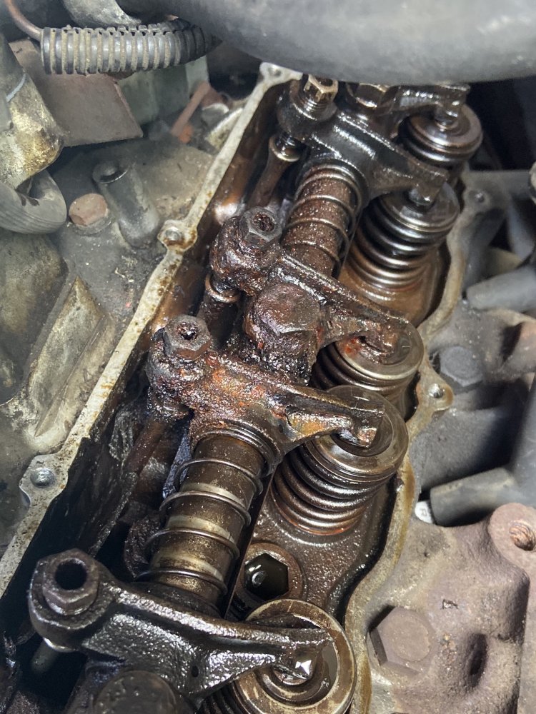

well I made the adjustments today. This is what i found on cylinder 5 upon removing the valve cover..
39126
They’re corroded, and I’m most certain they’re not getting oil. Ive basically pin pointed the tick/ knock coming from cylinder 5s valves. I even used the screwdriver stethoscope trick while idling, even after I made the adjustments, and all things point to #5.
At cylinder 5, the rocker arms had no space/ play between the valves when they should have. I triple checked to make sure cylinder 1s valve was open... according to the manual, which should have allowed me to adjust cylinder 5s lifters. They were too tight.
Oil travels up through the pushrods right? Does this mean they’re clogged up? Can I replace the rods without doing a complete overhaul? The engine has good compression and plenty of power. It’s just this damn tick.. heck .. at this point I’m going to call it a knock. It’s getting worse.
All other cylinders were basically within spec, I made a few minor adjustments.
