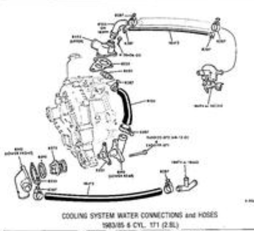

well.. I went to replace the thermostat today... and there’s no thermostat installed. Not on the lower or the upper. I guess this confirms that the gauge actually does work and the engine really does run cool all the time...
So I’m going to install one. The issue is that since there was not one on there I have no F’n clue how it’s supposed to go on.. any ideas?
it for sure goes in the lower because the fail safe goes straight through to the bypass
I don't know enough about that engine to say. Normally, thermostats are in the goose neck at or near the top of the engine.
Sorry, I don't know that particular engine very well.
It’s super confusing... their doesn’t seem to be any sort of grove that the thermostat fits
Into like most engines. I found this picture online, however there’s no guidance on placing the thermostat correctly
I just did the one on my 2.8. It's pretty weird, it does go down low in the water pump housing right where the lower hose hooks on.
You have to be careful, it's sort of a sandwich deal. You have the front part, the waterpump housing, and then a rear plate that is threaded that the bolts go through. One of my threaded holes was stripped, so I had to use a longer bolt with a nut on it to get it all back together. This thermostat also uses a o-ring with a groove in it that goes around the od of the thermostat to seal around it.
Once you get it all together, I had something else I had to learn. You can't use the standard procedure and leave a heater hose off, fill the radiator till coolant comes out of the hose, and then put the hose on, fill it to the top and then start the engine to burb the rest of the air out. Mine overheated quickly after I did this, and I tried and tried to get water in it.
I finally found the procedure in a manual I had. Once you are done, you take the upper radiator hose loose, and pour as much coolant as you can down into the engine like that. Then put the upper radiator hose back on, fill the radiator, and then run the engine till the thermostat opens to burp the remaining air out of the system.
thanks very very much for this explanation and putting me at ease, I’ve been stuck trying to research this.
so, just to be clear, the thermostat is inserted into the engine and sits flush on the block, then the O ring, then the front part of the assembly that the hose attaches to..
did you use any RTV to secure the thermostat in the center before putting the rest together? If not, how did you keep the thermostat center while you sandwiched everything in place?
The thermostat sits in the water pump. Just so you know, that casting is the waterpump, and it hangs off the side of the block. There are gaskets, one on the front inbetween the hose nipple housing and the waterpump, and also a gasket on the back where the threaded plate goes. I did not know about the rear gasket, the old one tore a little bit but I did use some silicone back there as well as the front and it sealed up ok.

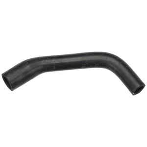

There is also a weird bypass hose back there. Mine looked original and not so good. I tried to make my own but just could not do it. You can see in the picture below one end is very large, the other end is small. This hose is not cheap, but you can still get it. It's Dayco B70773
does this look about right to you? I realize the thermostat goes in the water pump, there’s just no grove that centers the thermostat in the hole, so I don’t know how I’m going to keep it centered while I’m reassembling.
