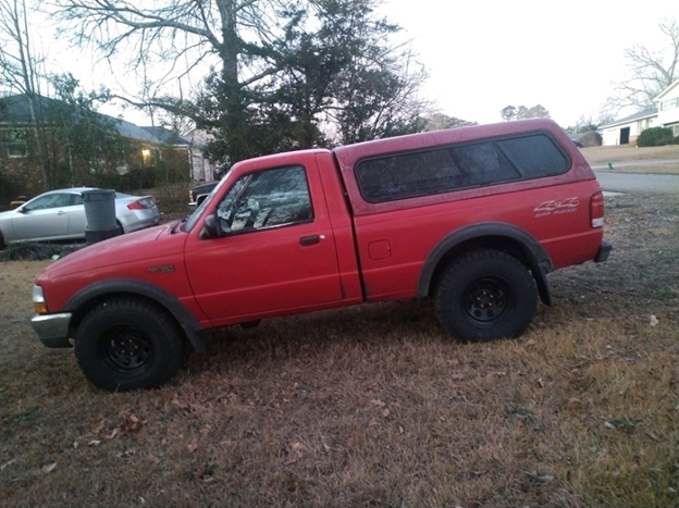

265X75X16 on 2000 4wd
16X8 wheels 4 inch backspace as I remember
