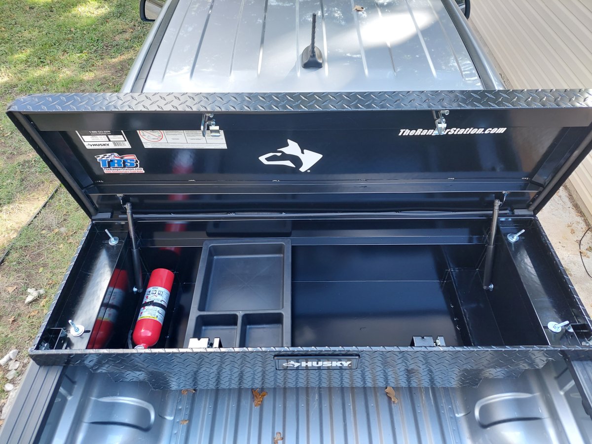

I have mine in one of the plastic storage bins under the rear seat.

I don't have a better picture but it's not on the bottom of the box. The box steps up on the ends and the extinguisher is mounted to that narrow ledge.
Better than the bottom of the box. Imo still not the best spot. I realize that you're probably worried about theft. And it does happen. Twice to me. But I believe that having a very easily accessible extinguisher to anyone is the best option and worth the risk of loss. If you're not around and the lid is locked then it's useless.

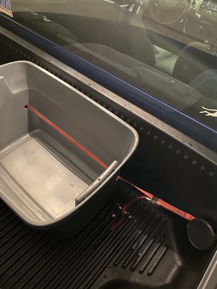

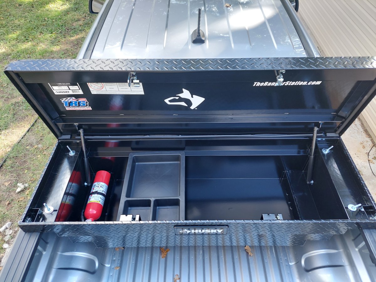

Mine is in a storage box in the bed along with my towing stuff, jumper cables, etc. Secured with a tie-down to the bed hooks, drilled a 1" hole in each side. Not locked but fits under the tonneau so it's out of sight. Lid is off for photo.

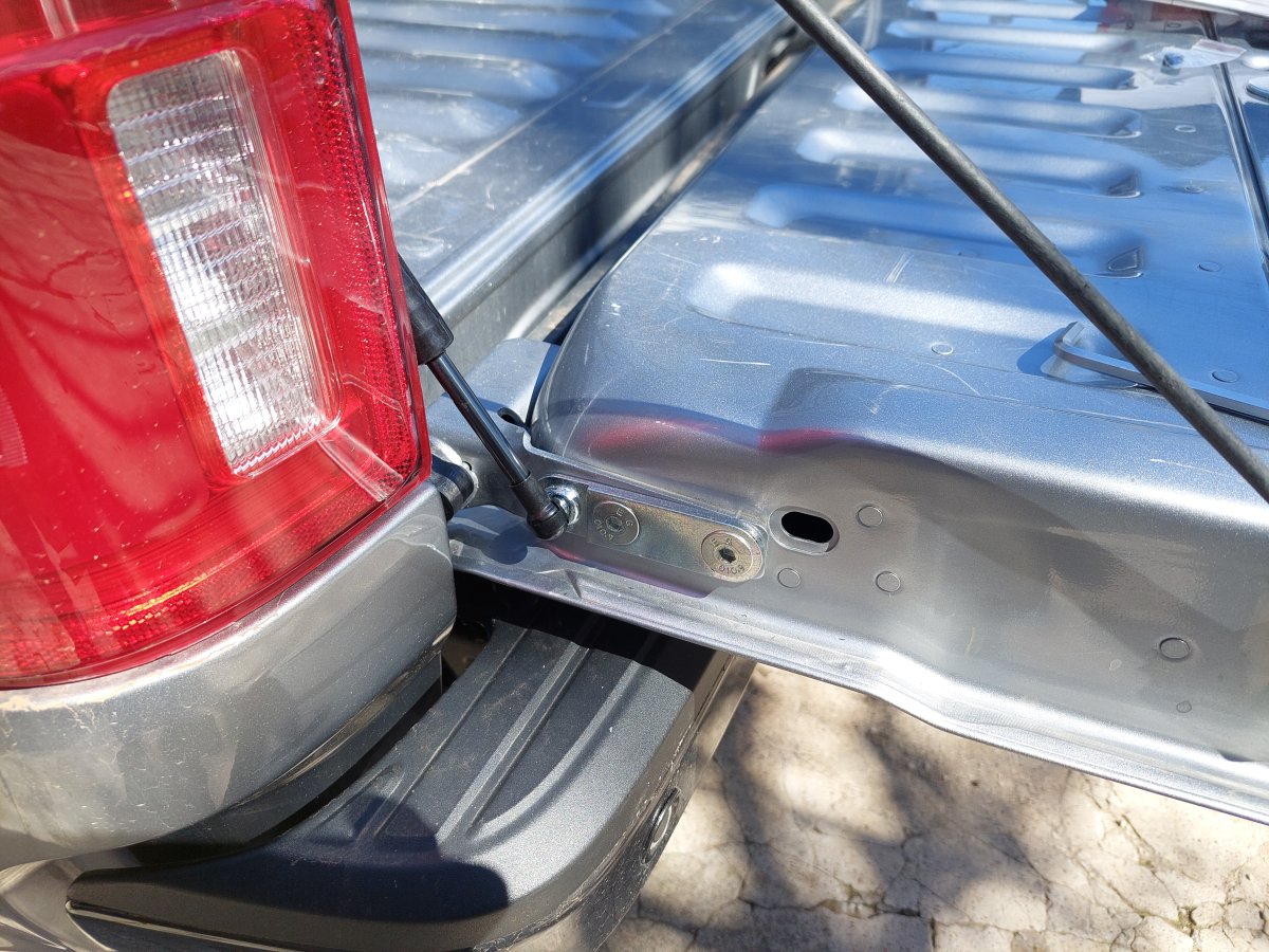

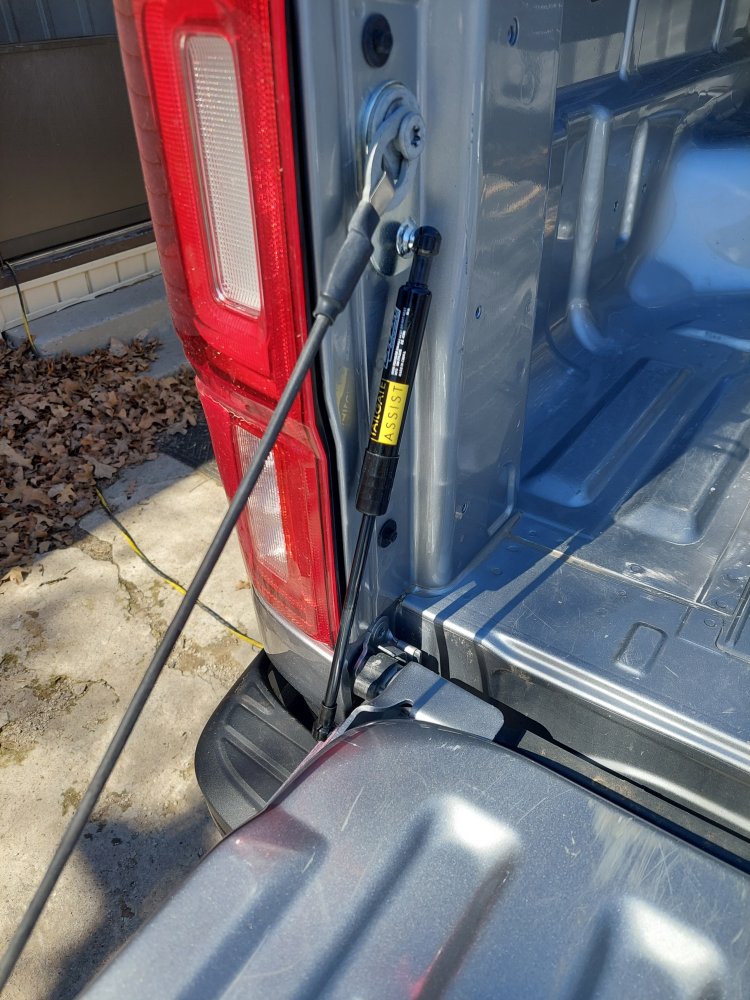

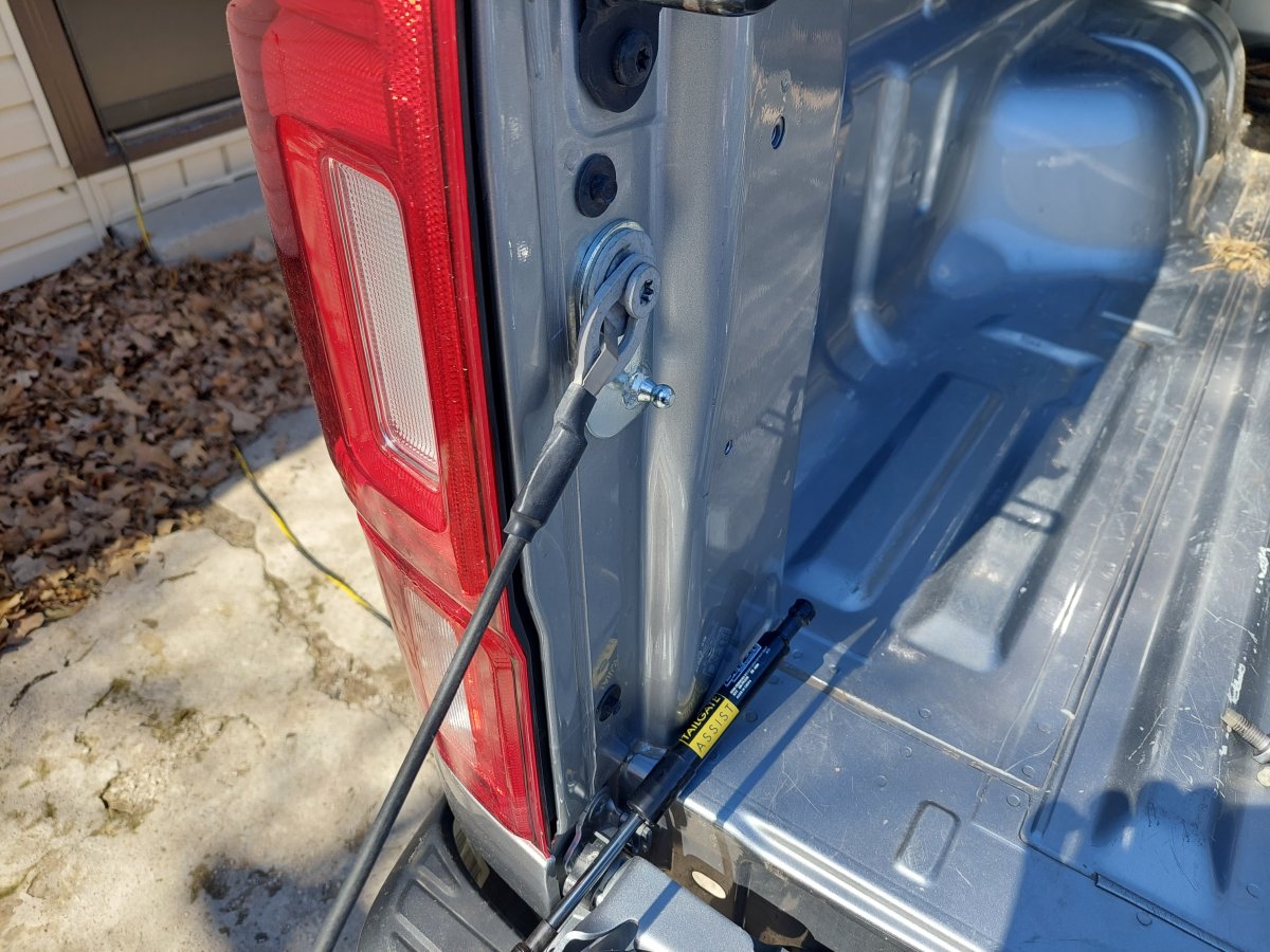

After having an F-150 with an automatic tailgate I didn't like how the Ranger tailgate drops so abruply. Especially when I know you can get a strut to prevent that from happening.

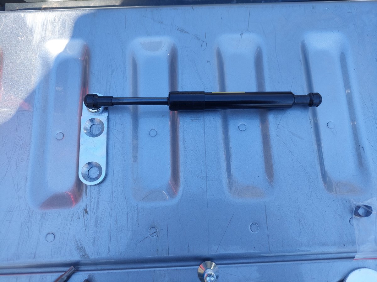

I decided to install a DeeZee Tailgate Assist P/N DZ43206.

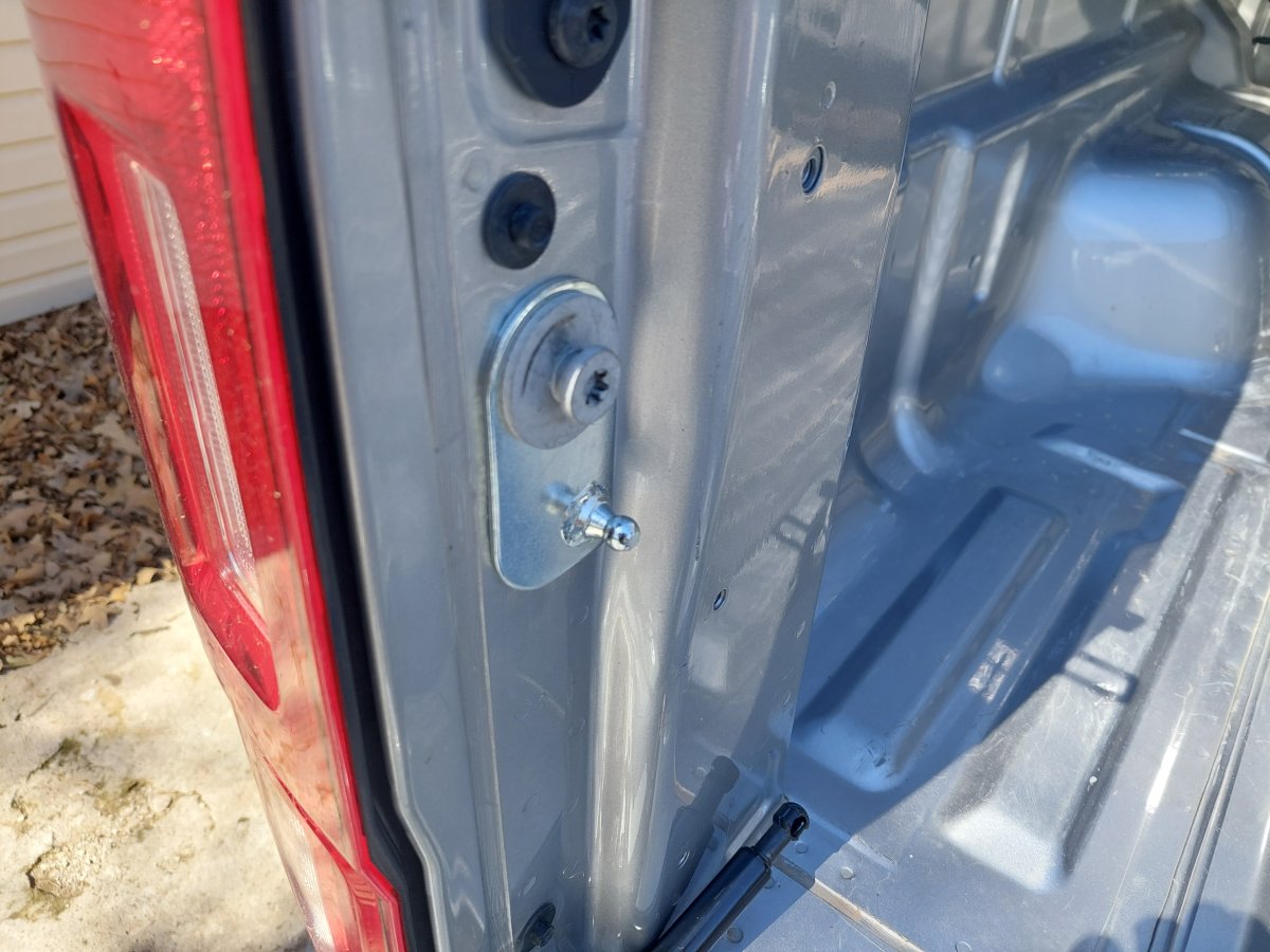

First you remove the rear most bolt at the hinge.
Then install the strut on to the supplied lower mount with the new bolt.
Then replace the upper bolt on the hinge bracket with the new supplied bolt.

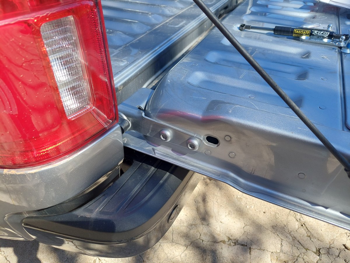

Remove the cable for the tailgate and then the latch bolt.
Install the new upper strut mount behind the factory latch bolt.
Reinstall the cable and snap the upper strut mount
It's a quick and easy modification.

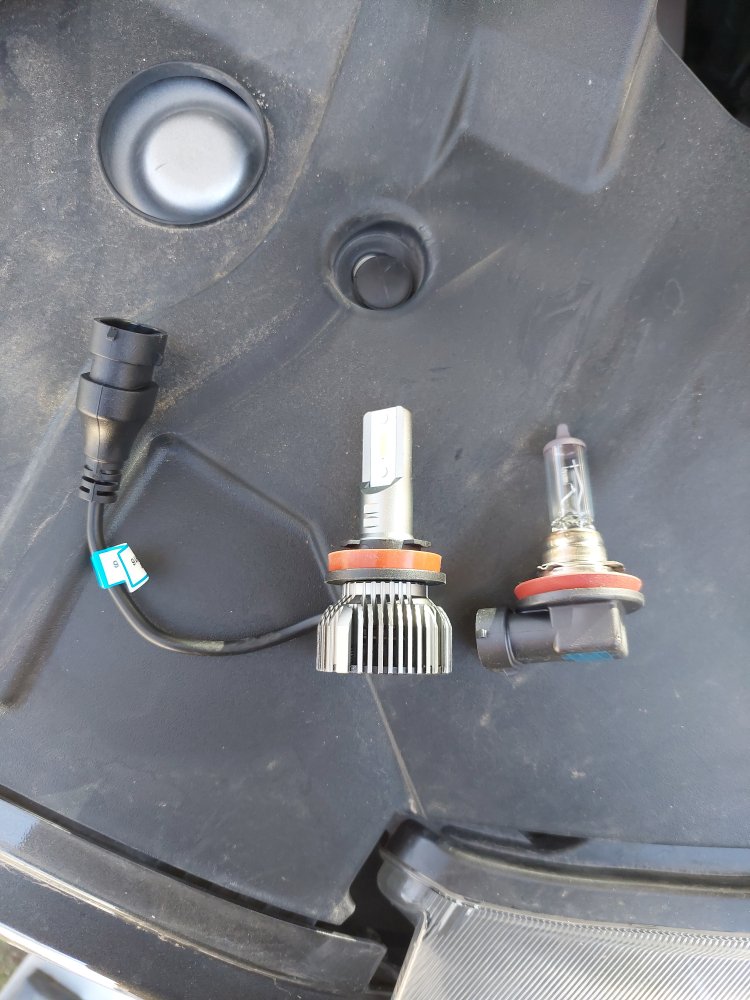

I wanted to upgrade my halogen lights with briter whiter light so I bought some Nilight LED bulbs.
The new H11 low beams and driving lights are 50 watt 10,000 lumen bulbs.
The new 9005 high beams are 100 watt 20,000 l7men bulbs.

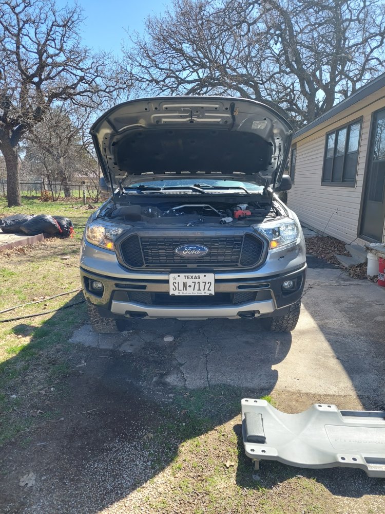

2021 Ford Ranger FX4 TRS-3 Project Build

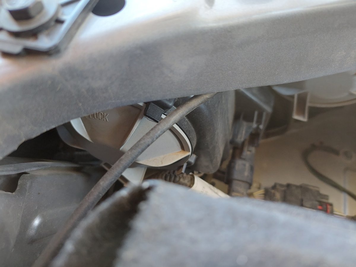

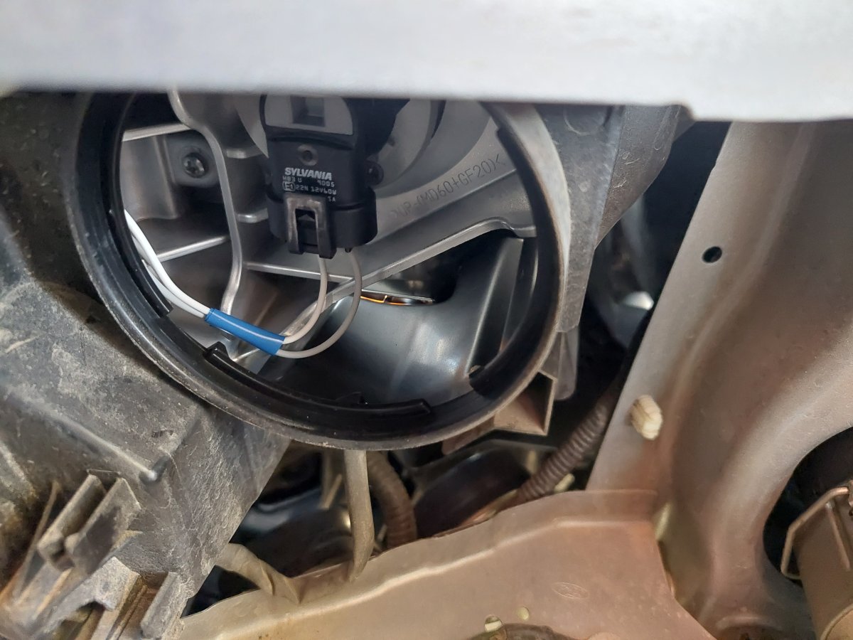

The bulbs sit behind these white twist off caps.

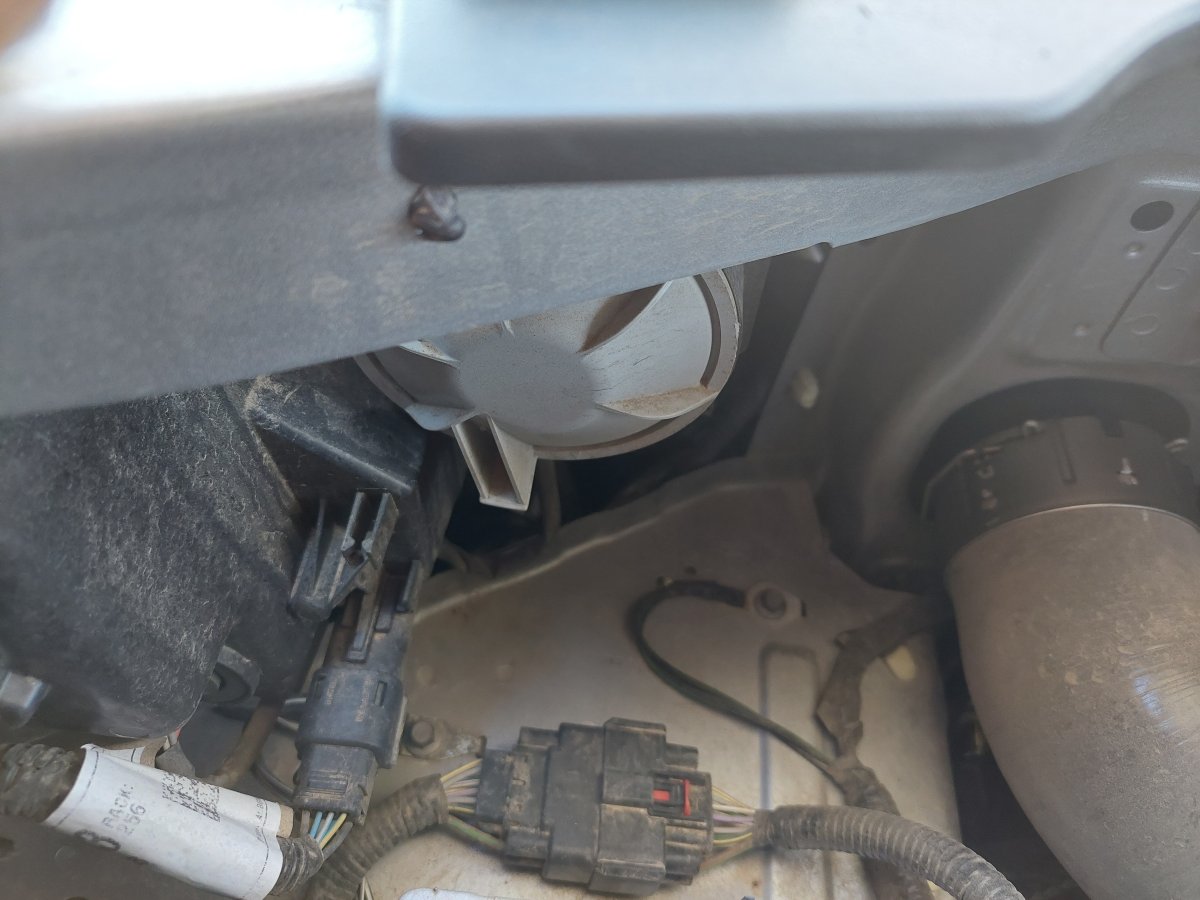

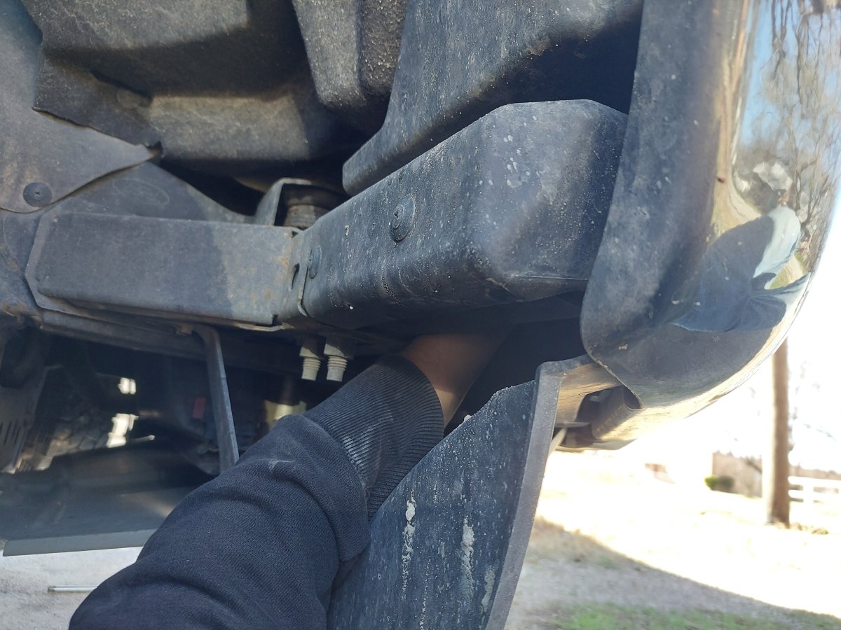

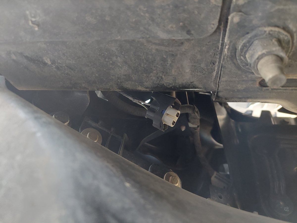

The driving lights can be reached by reaching up between the bumper and crash bar.
You can reach the light to unplug it but it's hard to get two hands in there to plug the new bulbs in. It helps if you turn the wheel all the way to the outside.

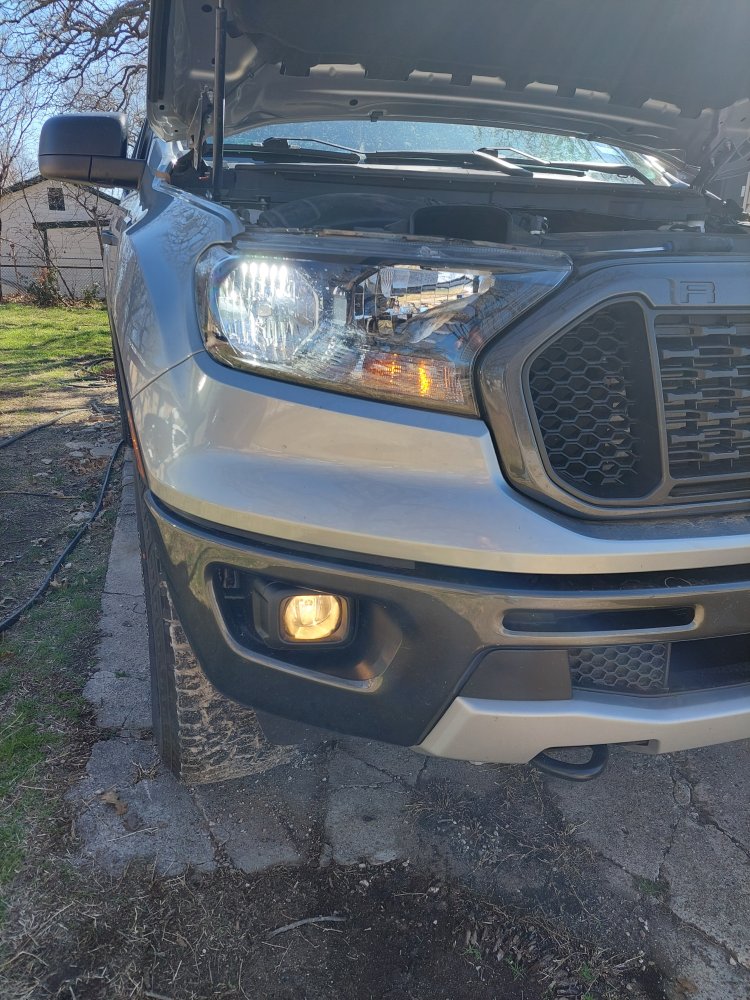

You can see the color difference between the LED (white) and halogen (yellow) bulbs.
I really like having brighter whiter lights. Especially living out in the dark country. I haven't had anyone flash their high beams at me indicating that they're to bright.
