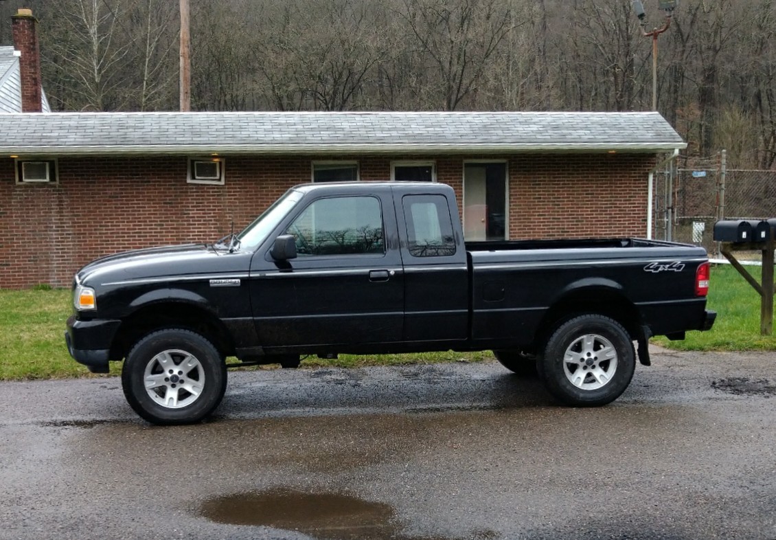

Finally got the suspension finished. 1750 lb rear springs and lift shackle on the rear (with shorty 2011 blocks) , and #1 bars and rough country leveling keys in the front. Took 8-9 tries with adjusting torsion keys to get the ride height correct, but I finally dialed it in. Front sits 1.25" or so lower than the rear. It looks opposite in the photo, but I think my phone was canted a bit.
Had the pre key blocks in the back and the front adjusted to match, and it just wasnt possible without lift spindles or different upper control arms. With the taller rear blocks, my front arms were 1-2mm from contacting the frame. I swapped out the blocks, and adjusted the front down. "Much more better" now.
For a 2011 that started as a 4X4 low rider, I think it looks good now.

That looks GOOD !!!

Fixed photo. Stoopid technology.

Why do I feel like I need bigger tires...
Because you're living in a cartoon?
Bigger tires would look a little bit better on there, but don't go too big.
Just curious, what gear ratio do you run? That will play into the equation.
Also, with a commute like you have, I would stay away from an aggressive AT tire. I have the General Grabber AT2's on mine. Don't get me wrong, I love them. But, they are not a tire I would use if I had a commute like yours. I am probably going to look into the Goodyear Wrangler Trailrunner's or the new Firestone Destination AT tires when the General's wear out.
Have you considered a Torsen diff for the front?
I think you would be happy with 31s. With the stock suspension, the wheel wells look stuffed with 31s but with the lift you have, I think it would be a good choice.
