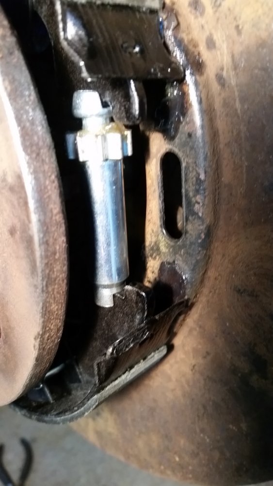

The factory had placed the star adjuster up on the drivers side, and down on the passenger side. I thought when placed down it was harder to reach, so I put it back together facing up. Also, the upper nail had come loose somehow and the clip was laying on the bottom shoe.

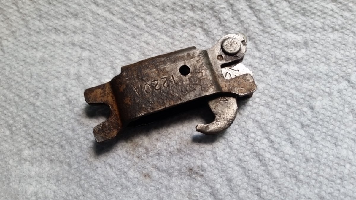

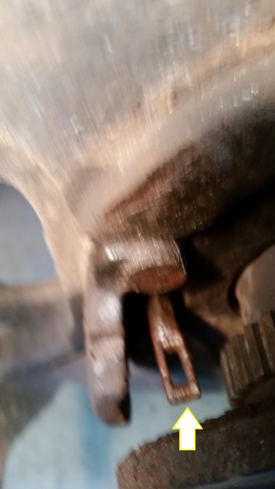

The Passenger e-brake actuator was more frozen. Luckily it came out from the cable easily. Cleaning it up with wire wheels and rotating it through full travel freed it up well. The bearing surface had mushroomed just a bit so filing that smooth helped it also. I'll post a photo tomorrow as being able to see how the actuator fits onto the cable helps.

For some reason the star adjuster is just outside of the access hole on the passenger side. No matter if you place the star nut up or down, the hole placement is still awkward.

This is the end of the emergency brake cable that is normally unseen inside the actuator.
66015
The actuator, cleaned up and swiveling freely
66016
The cable connector engages the hook, and pivots inside the housing to install. Small fingers are a plus.
Odd about the adjuster. Both of mine are right at the access slot.
The arms on the star part look different than mine.
Are the shoes reversible, because something ain't right
Oh, and the stars were on the bottom, not the top when I adjusted mine yesterday.
This kind of poor alignment of the star with the slot was the same as the factory had it. Dunno. Brakes work fine.
I can only tell you what I see with mine. If you got it work, all is good.
