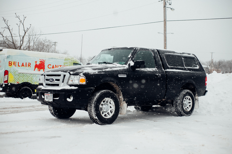

235/75r15 on my 2010 XLT before the lift. The performance change is barely noticeable, but it made a huge difference in the overall look of the truck. No rubbing whatsoever. This size is also in that sweet spot where there are a lot of choices, but most of the tires in this size (even C-rated LT all-terrains) are A. reasonably inexpensive and B. light. 10/10 would recommend.

How big/what kind of lift did you install? And what specifically did you use to mount your spare in the bed?
It has a 3" performance accessories body lift. I planned on doing spindles but after hearing about people having issues with suspension lifts and the Advancetrac, I figured a body lift would mostly give me the height I wanted without risking endless headaches and warning lights. I think it looks pretty good - it looks a lot tamer on the 2wd than it does on a 4x4. Historically I had always been opposed to body lifts but I'm happy with the amount of lift and the fact that I didn't have to mess with alignment. You really can't see the frame at all. The hitch looks goofy because it hangs down lower now, but I'm planning on removing it since this truck's tow capacity is pretty laughable and the bumper should be able to handle towing a couple canoes, etc. Here's what the truck looks like currently. Pardon the snow; we got hit pretty hard last night and the entire truck is encased in a crust of ice, so that should be fun. �� Right now the spare is just on the floor of the bed between two sandbags with a chain to one of the bed tie-downs.
