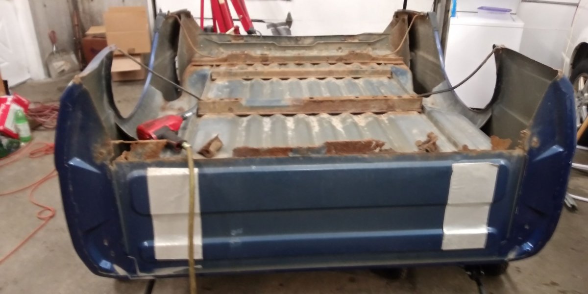

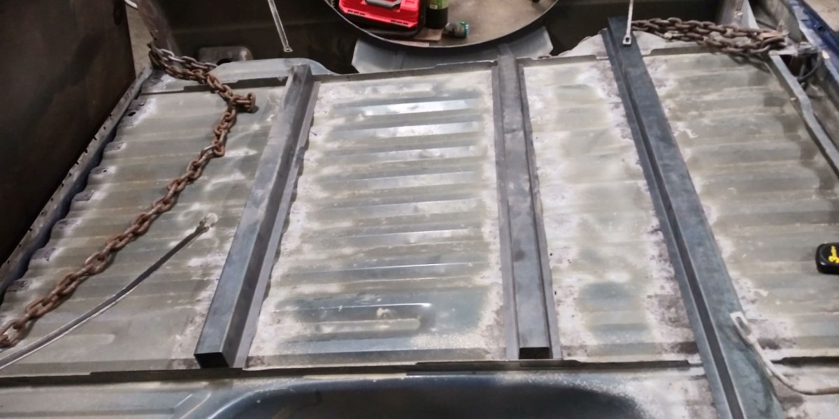

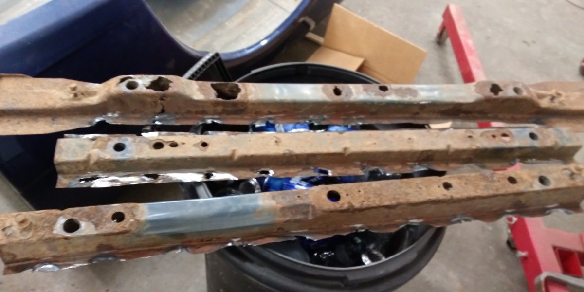

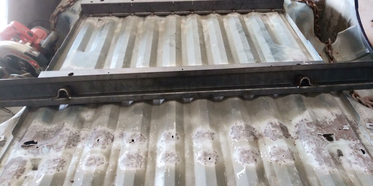

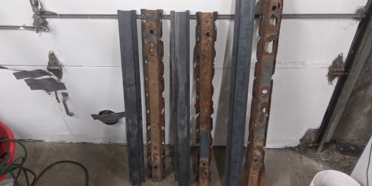

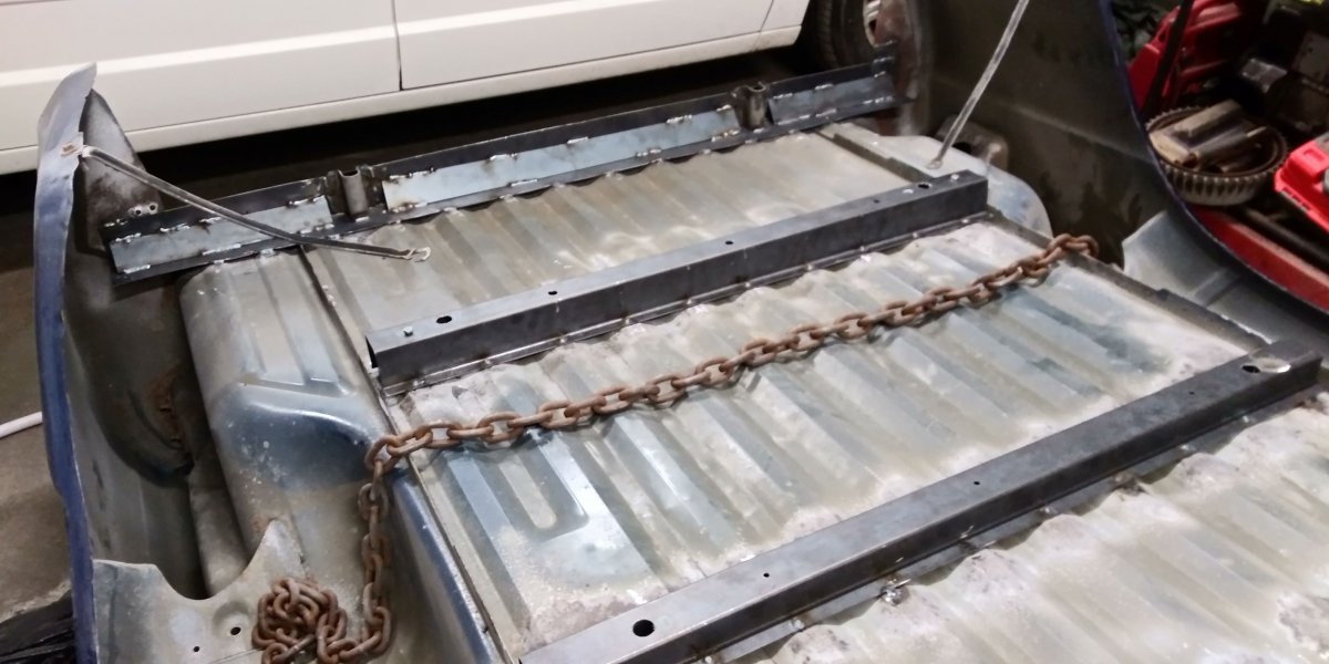

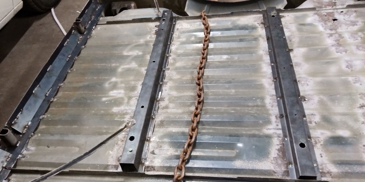

2010 ranger bed crossmember replacement
Those are originally welded to the bed to give it structural rigidity from side to side. The square tubing may be a good idea. But I would recommend attaching it to the bed to follow the original construction.
Sounds great, thanks. I will probably go with bare steel tube and POR-15 coating after welding.
Yes i agree with your decision.Have fun with that project.My crossmembers still look like the day i finished them,course only been a year.
Google “galvanized hat channel” used in commercial construction. A couple of years ago I found some hat channel the right size to replace the original crossmembers.
