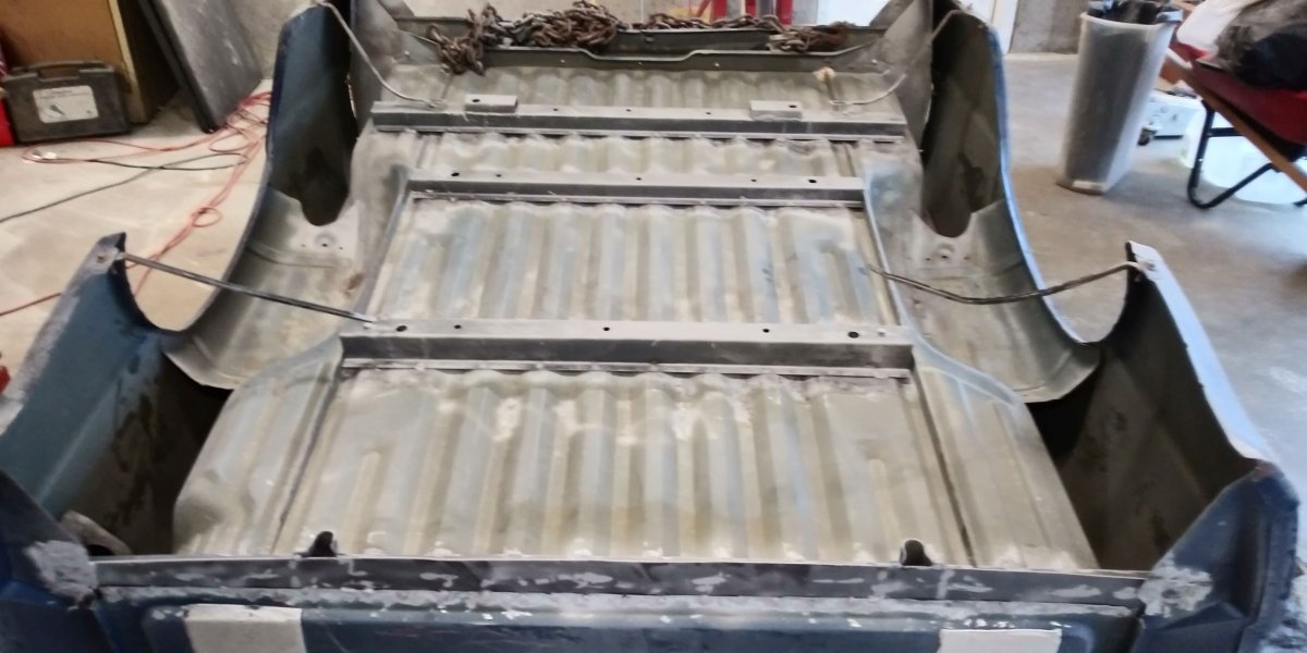

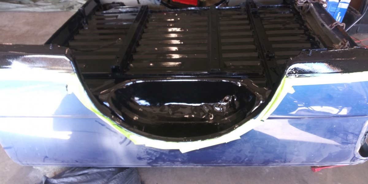

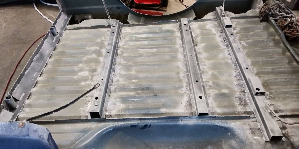

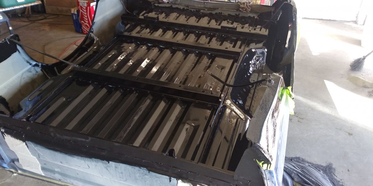

2010 ranger bed crossmember replacement
a few more pictures
Very nice. I vote for you to be my new bodywork guy.
Cost was
3-crossmembers $120
1-sheet of 16g.steel $48
3-bags of bellemare 30-60 glass grit $34
misc grinding discs etc $30
Paint-will paint along with the truck frame at a later date.
Used a lincoln 140c welder {im not an expert}and a clarke 10 gallon blaster in my home garage.

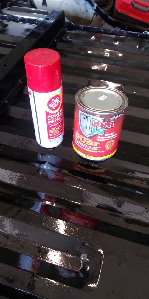

Did you POR-15 and then fluid film over that once the POR was cured? Or just fluid film inside the crossmembers where you couldn't apply POR?
Used fluid film inside the crossmembers.Yes if they were available i wouldve bought them.
