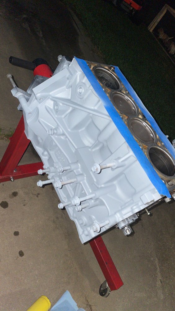

Alrighty guys after a whopping month i got all my parts in and started rebuilding the 2.3 today. Got crank and pistons in, got the head on and am about to do the timing chain and oil pump chain. before i put the head on i put some primer on and some black engine enamel. gonna go with red valve cover, kinda like a 2/3's of a barra!\

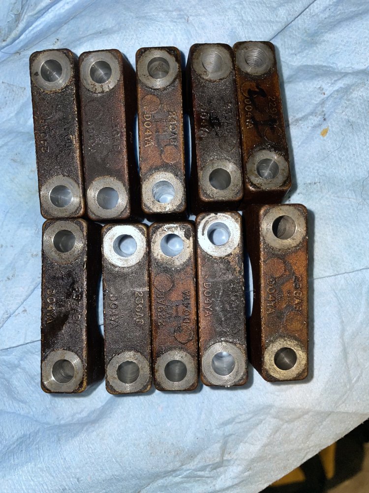

Build is almost done! just working on getting the camshafts back in. problem is, i did not label my cam caps. is there a certain order these must go on? will i be able to tell but the numbers printed onto said caps?

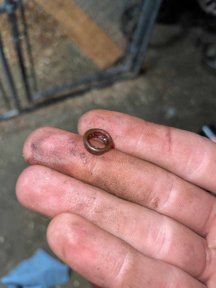

Also, this fell out of the head and i have no clue what it is.
