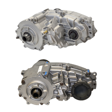

I decided to see which transfer case motor I have to buy the correct transfer case motor. After reading online, I assumed I had the electronic BW1354, just to verify I crawled under the truck, and to my surprise, I saw that the transfer case was a BW4405-8. After doing some research I found out that the BW4405-8 is for a Ford Explorer and now I'm wondering what a Ford Explorer Transfer case is doing on a Ranger. I'm assuming that the previous owner swapped that transfer case motor from its original for a reason I have no idea.
Basically when I put it in 4x4 hi the dash will make a click sound and nothing else happens, when i try driving forward the truck will just go into neutral and stay there, at any gear. Turning off the 4x4 and going back to park and then back to drive, it will go back into gear with a loud clonking noise. 4x4 low is different, it will engage into low gear and still drive in any gear, but the front axles will remain in 4x2.
Now my question is will it still work on the Ford Ranger if I try fixing the current transfer case? Or would I have to swap it out for the correct BW 1354? Whatever the case is, I am pretty confident I can do it myself. It just would be a matter of learning what I need to do to solve this issue.

from what I'm reading the 4405 is a torque on demand tcase, it has clutch packs to give full time AWD.
drain some fluid for inspection.
more info on 4405

more info on 4405
Hey pjtoledo,
Thanks for the link, after reading the article, it seems that what is going on with the current transfer case I have in the truck is exactly what the article mentions about wear :
"The BW4405 can show early wear of the rear case by the output bearing, causing failure of the shift cam, range hub, and input shaft. This failure mode may be manifested by popping or grinding sound in reverse as well as excessive rear yoke end play. "
I will go a head and look for a used transfer case as the website states that it also has a speed sensor and that 4405 under my truck has its ripped out ahahha.
