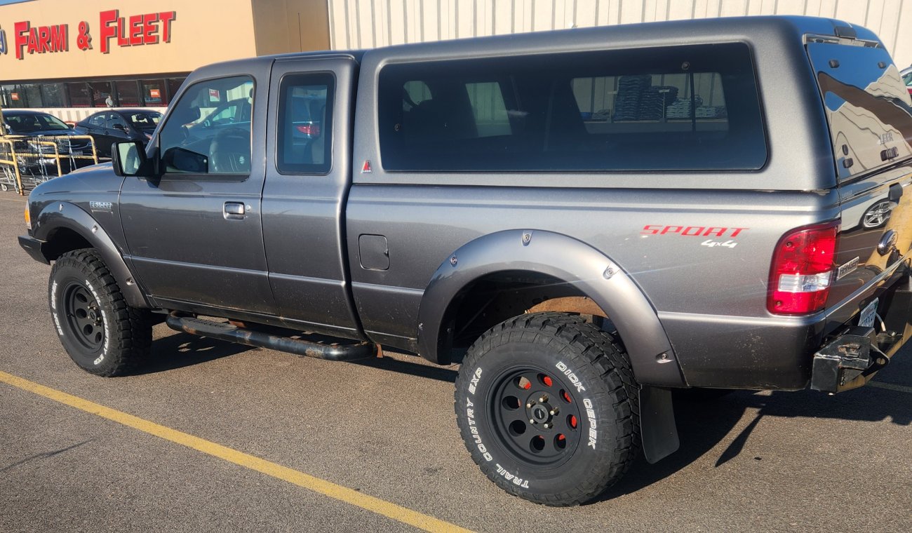

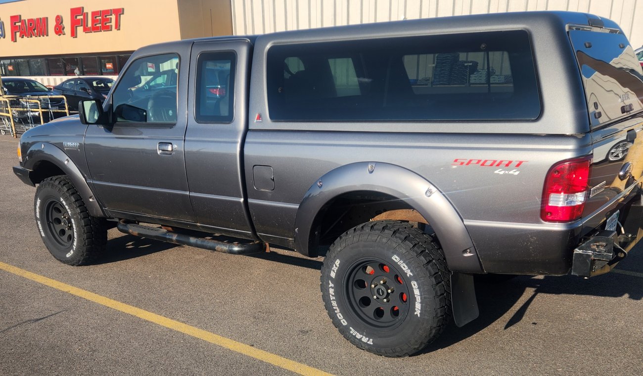

My 06 with no body lift... new 1750lb springs in the rear with a one inch shackle. Fornt has RC lift keys that are set one inch over factory spec. On 32 inch tires.

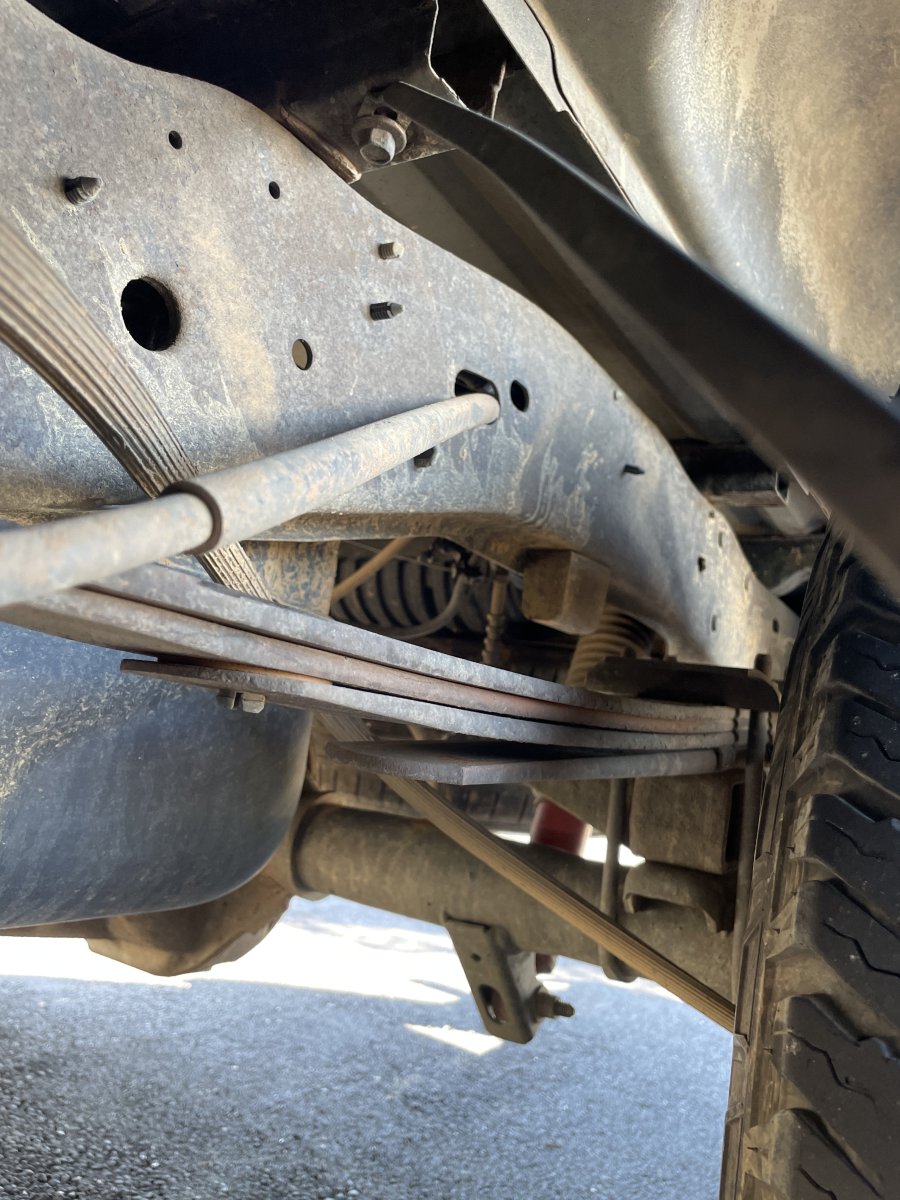

Drivers side leaf. Are the 1750lb springs stock? Don’t know spring rates on these trucks.

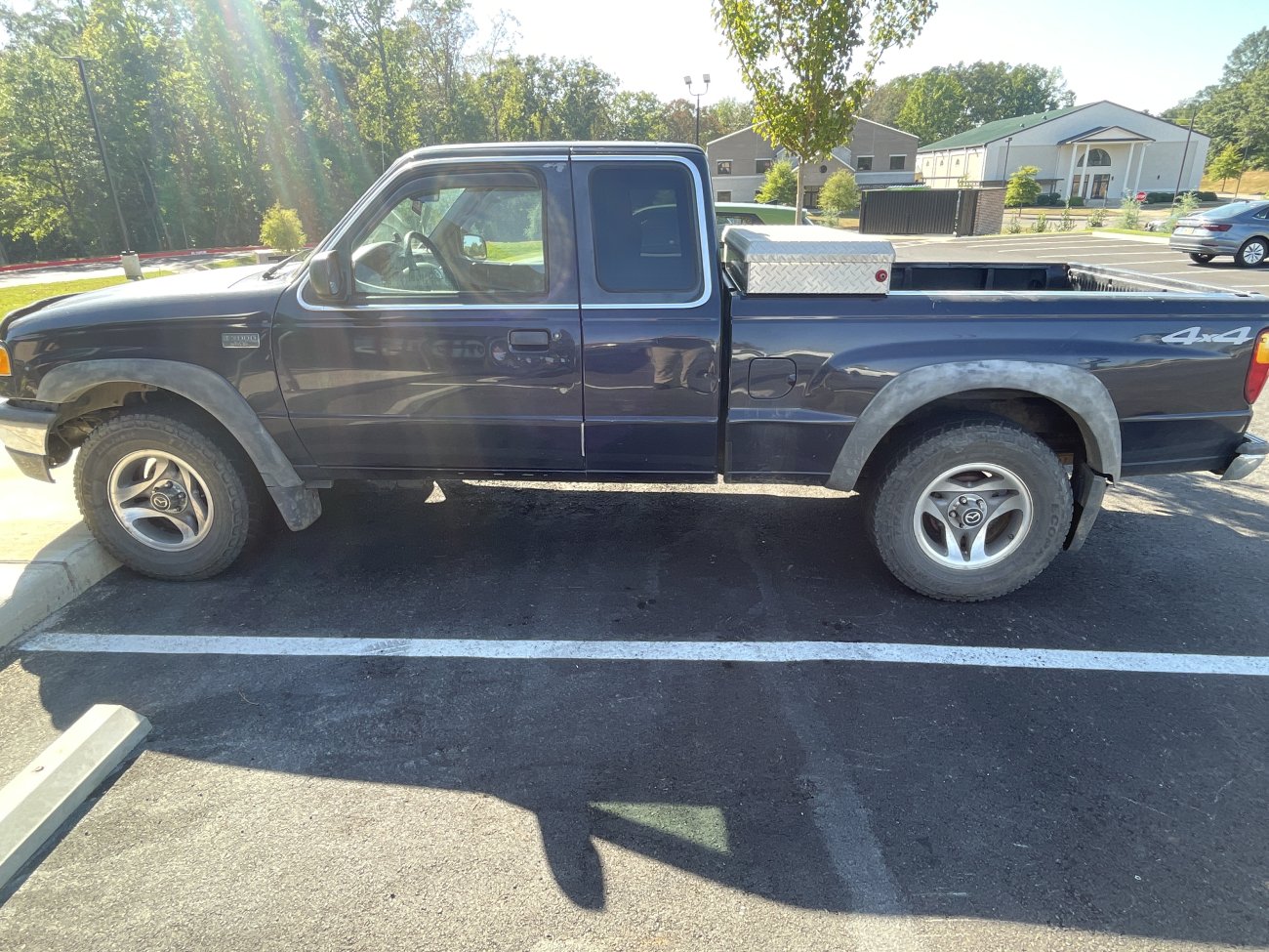

This is mine with (I’m pretty sure) no lift. The guy i bought it from didn’t tell me anything about the suspension but he took great care of the motor.
2002 Suspension(ish) lift, Shock questions
I’d like mine to ride a little higher than yours does with 1” so i think 2- 2 1/2” is where I want to be. I’ll start looking at shocks later today.

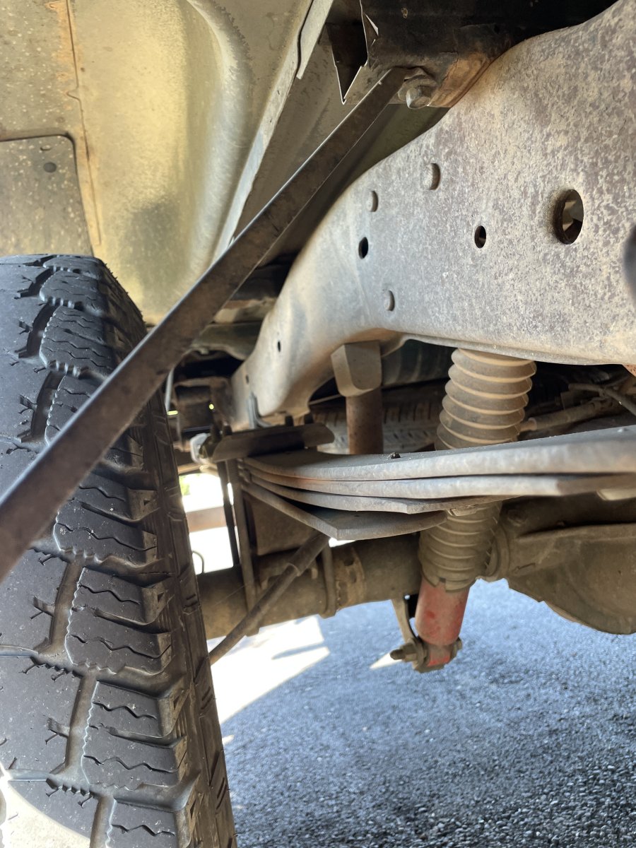

Passenger side. I have no idea how these should look.

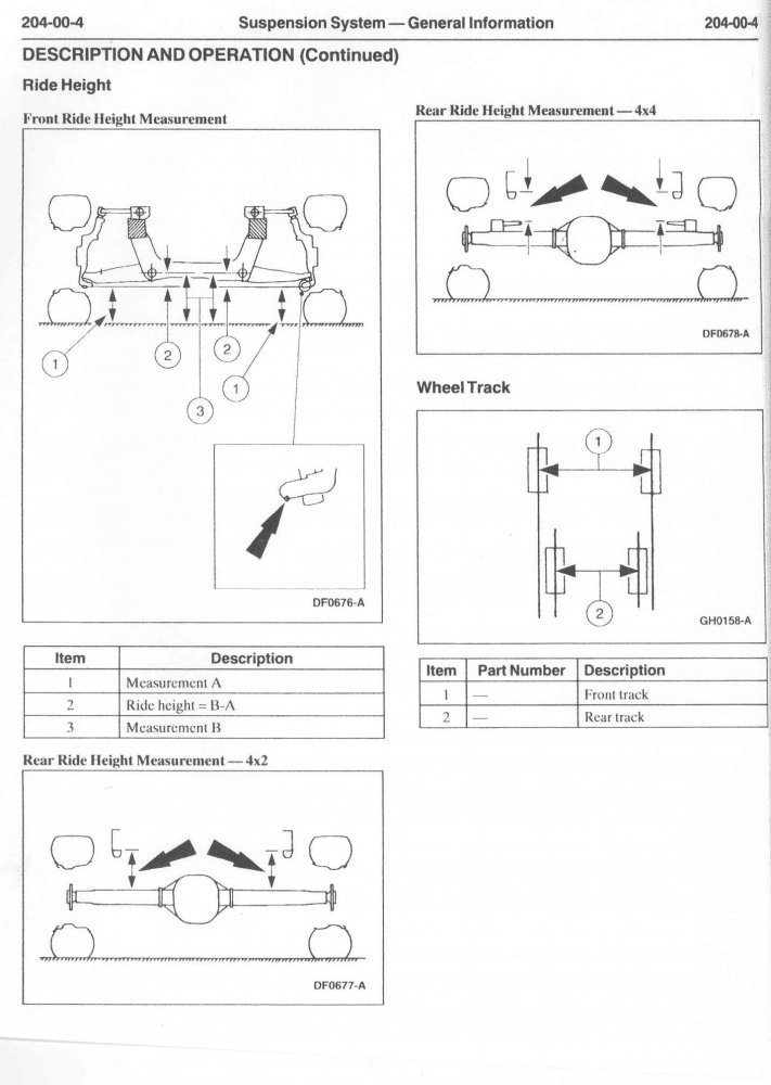

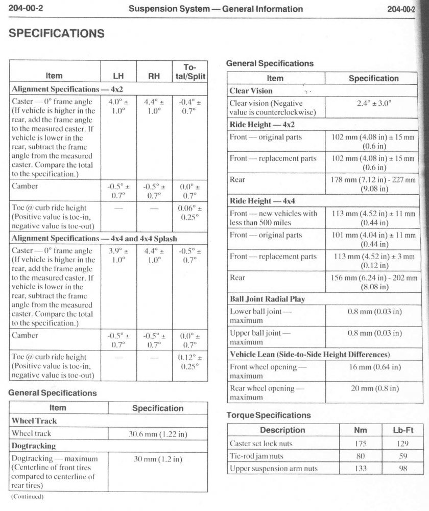

When we talk front lift... let's be on the same page. Use this for your measurements. I'm not sure i doubt you could achieve 2 1/2 inches measured this way.

1750ib springs are heavy duty replacements.
