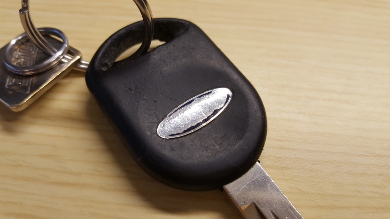

my key
Here's what my key looks like.

1999 and up V6 Rangers had PATS, i.e. 3.0l or 4.0l engines
Rangers with 4cyl 2.5l SOHC Lima engines(1998-2001) did not
Rangers got the new 4cyl 2.3l DOHC Duratec engines in mid-2001 and they got PATS at that time, so 2001 could be PATS or non-PATS depending on engine size.
You can remove your lock cylinder and take it, with the worn keys, to a locksmith and have new, less worn out, PATS keys made
A Ford Dealer can often make a new PATS key, or keys, from your VIN
A heads up, if keys are worn out then cylinder may not like NEW keys, it can be worn as well, so grain of salt on that.
As said if you have 2 working PATS keys now then you can add new PATS keys yourself
If you don't then someone with a Laptop and Ford software can add new PATS keys that way, this can only be done by plugging laptop into the truck, I know make sense but some have asked if you can take computer in to have keys added to it, answer is no, but you can Delete PATS from a computer, while its out of the truck, if you have programming software
