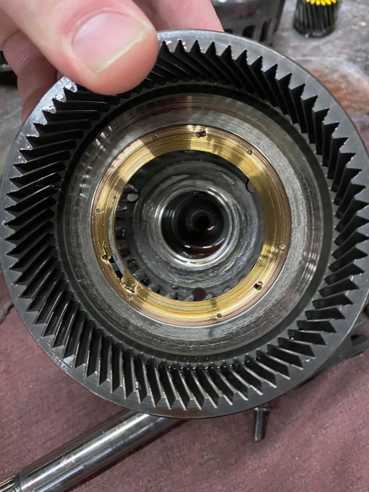

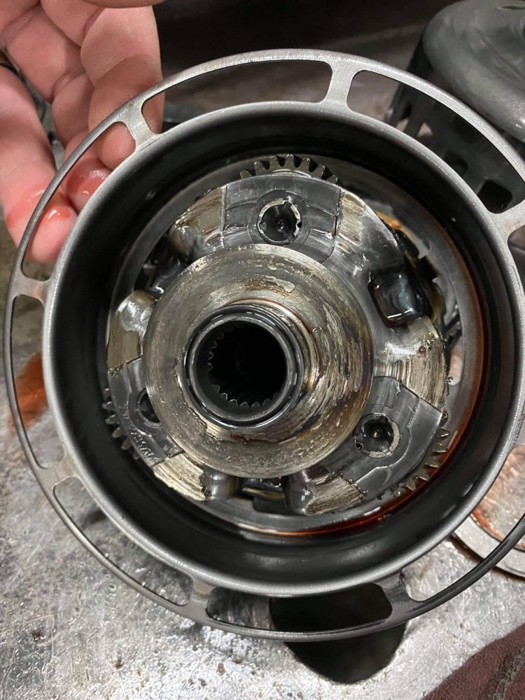

Just had the same happen with my 04 only had 59K on it! I bought it a month ago and 10 days later complete tranny rebuild needed to the tune of $3551.00 with updated valves, shift kit and added a larger trans cooler, as G8orFord mentioned above it was indeed the OD Sprag and Planetary that was roached shop said the OD issue is super common on these trucks usually from heat but known for failure
Didn't realize you could buy a gold plated 5r55e...
55376
55377
Funny I said the same thing, must be the gold lining in the second pic LOL
Holy crap! You're superman!!!!!!
