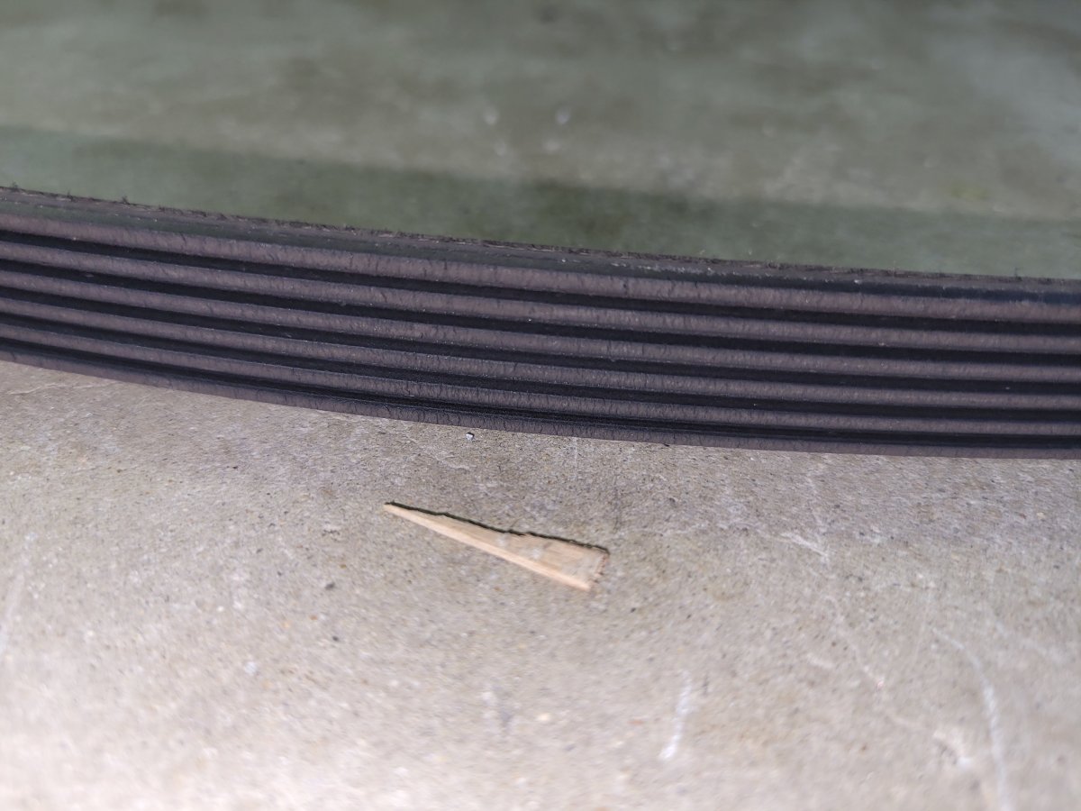

Removed the belt and took and took two new videos and a pic of the timing belt. Timing belt is dry/cracked and will replace. The first video is if the idler pulley. Makes a bit of a rattle when you spin it and has some axial play. I assume it is a good idea to replace this along with the idler pulley and serpentine belt? Or is this normal? All other accessory pulleys felt smooth and were quiet when rotated by hand.
For replacing that parts above, should I strive for OEM or is this kit from advanced auto fine? Typically stick to OEM, buy I assume these kind of parts are a dim a dozen.
As for the engine noise without the belt, please see the second video. Gets louder by the intake manifold. Can dig into it more after work, but I assume this is the timing chain? Does not sound nearly as bad as any of the death rattle videos, but I could be trying to talk myself into it being okay.
For reference, I did take off the intake manifold to re-tap the chain tensioner thread. Pretty sure I put everything back okay.

Believe you did the right thing: prepriming then squeezing oil out before install, then dead crank before starting.
After a few seconds of cranking engine, the 2 OilPressurized TimingTensioners should be fully pressurized when OilGauge bounces.
Consider dropping OilPan (relatively easy to do) , inspect for schrapnel\brokens from bad TimingGuides & clean Pan+OilPickupScreen;
if you hopefully find no brokens, will make you more confident, then new OilPanGasket + new Filter + fresh 5w30.FullSyn.
