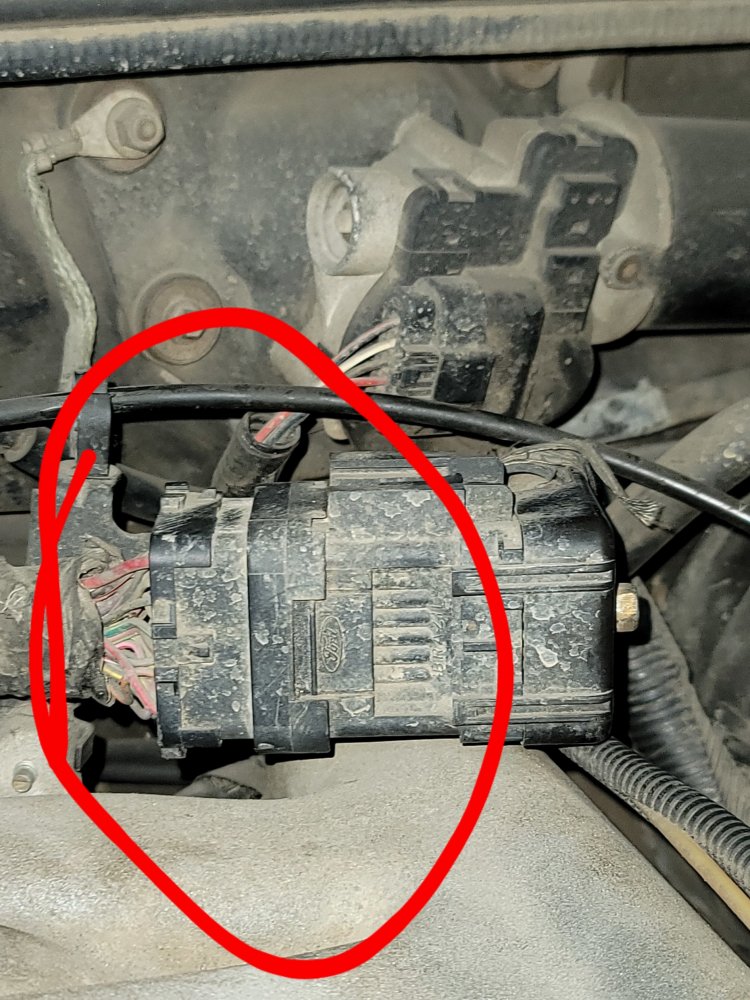

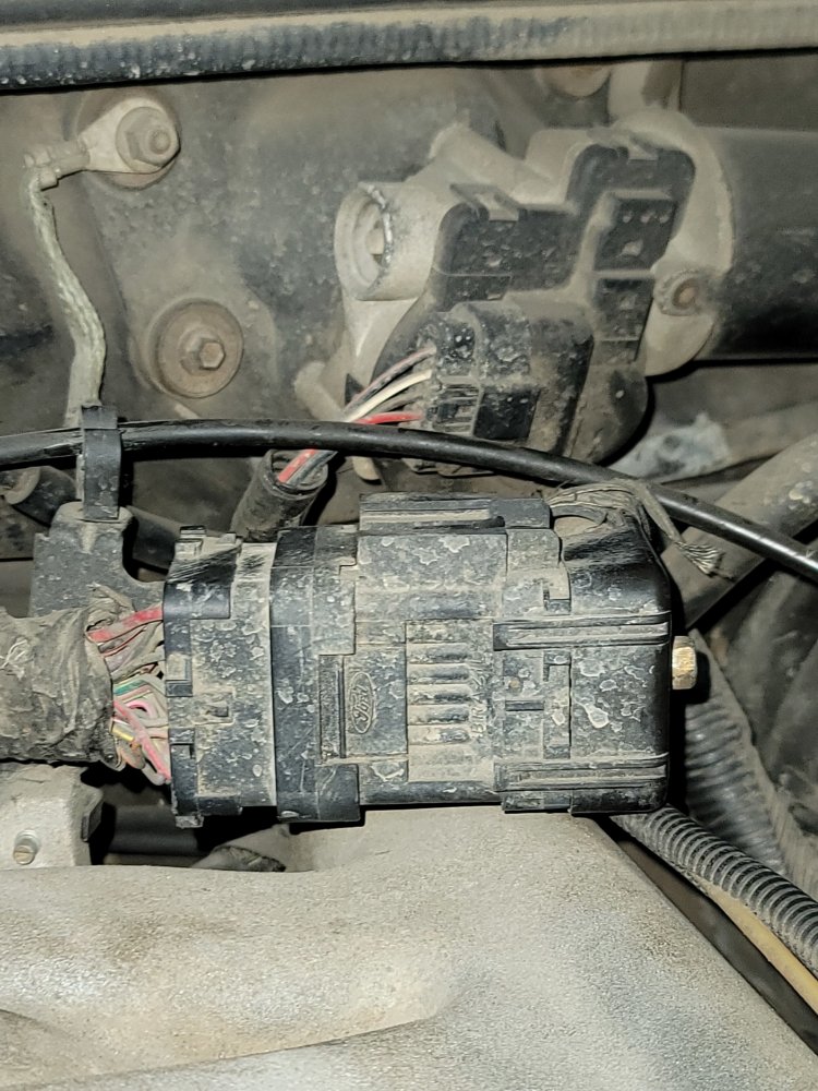

I got a P0340 code and i'm trying to replace the crankshaft position sensor and assembly. But whoever did the wiring in the engine bay last time put the tubing, wiring, and everything above the bolts. Which I need to even access anything with the crankshaft anything. So after loosening some connectors, and the area that keeps the wire assembly for the pcm held in that corner im close to being able to move it out of the way. I just have one more connector restricting me and im unsure of how to unclip it. (I think its the c110 wiring box?) If anyone can show me a video with a them unclipping this connector would be amazingly helpful. I just need it a bit loose to work on my crankshaft position sensor. Sorry if this seems like a stupid question, im genuinely stuck since I cant find videos of this being unclipped or even a description. Also excuse the dirty bay.

You loosen the bolt that is showing its head to the right of the circle you drew, and that will allow the connector to come apart so you can move it.
