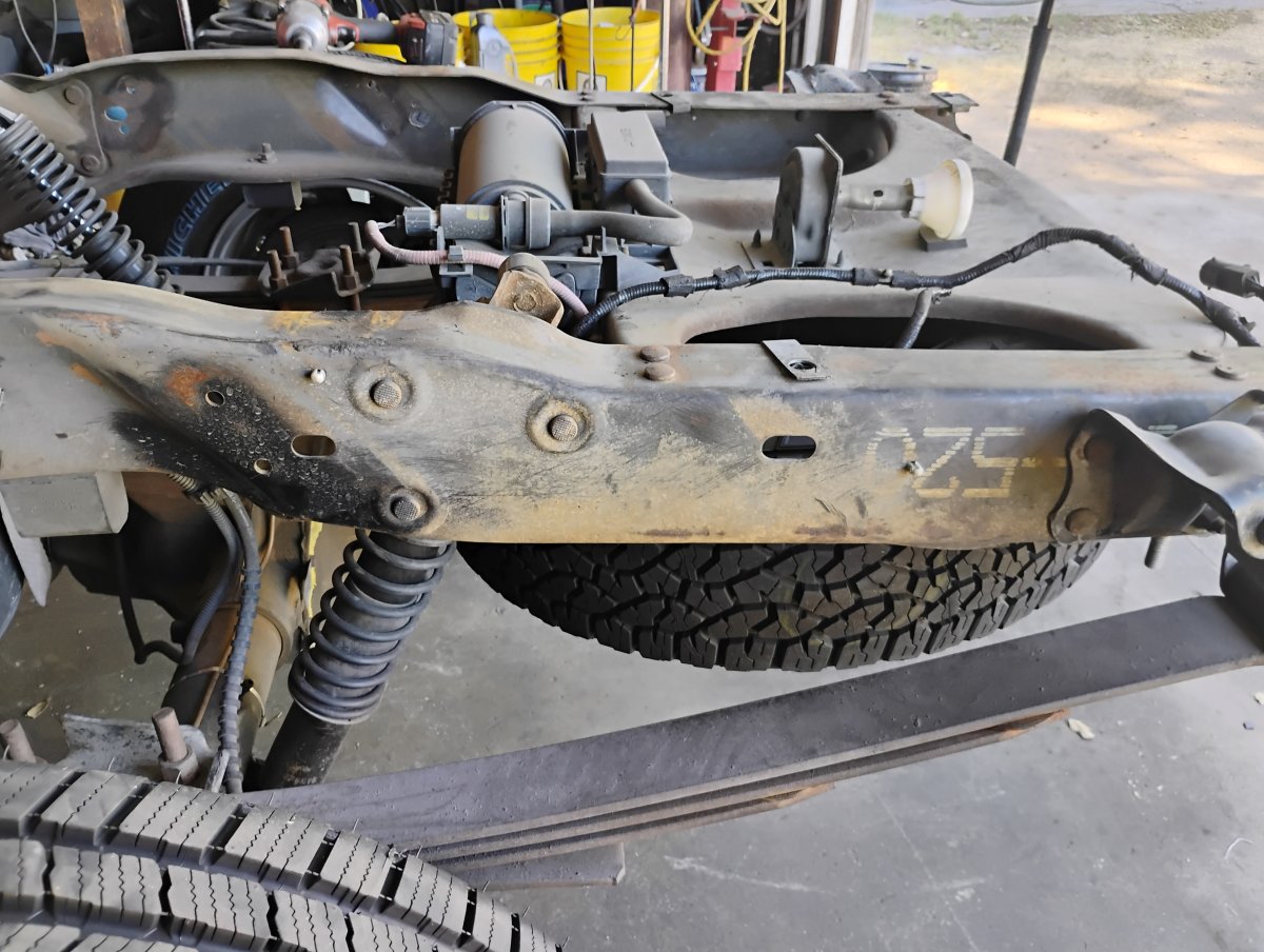

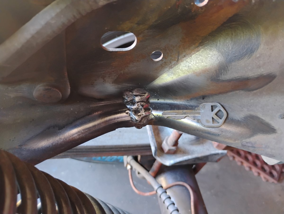

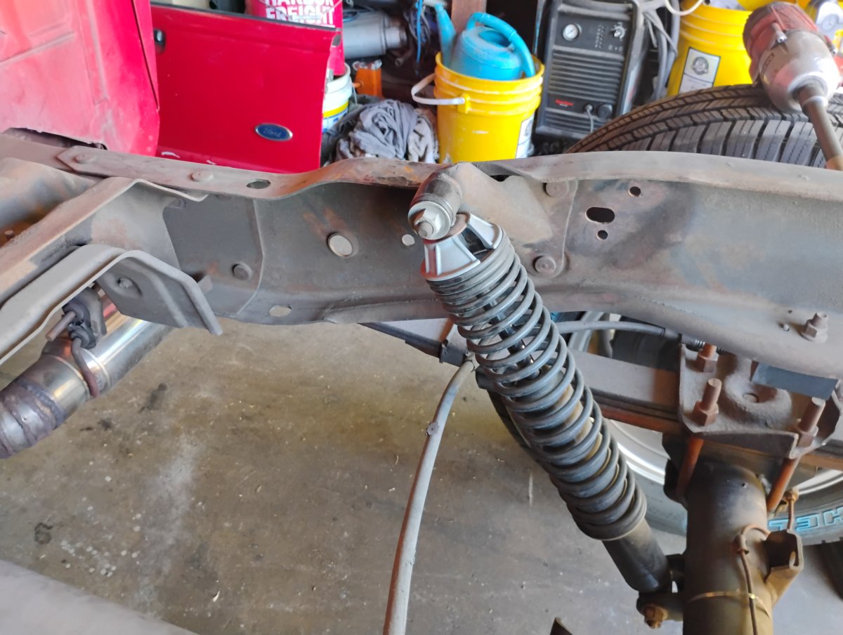

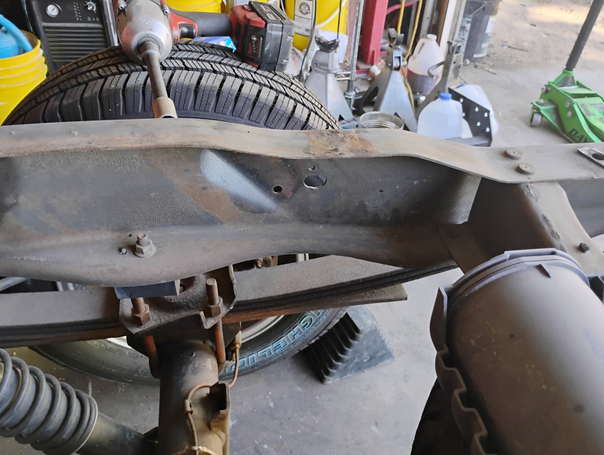

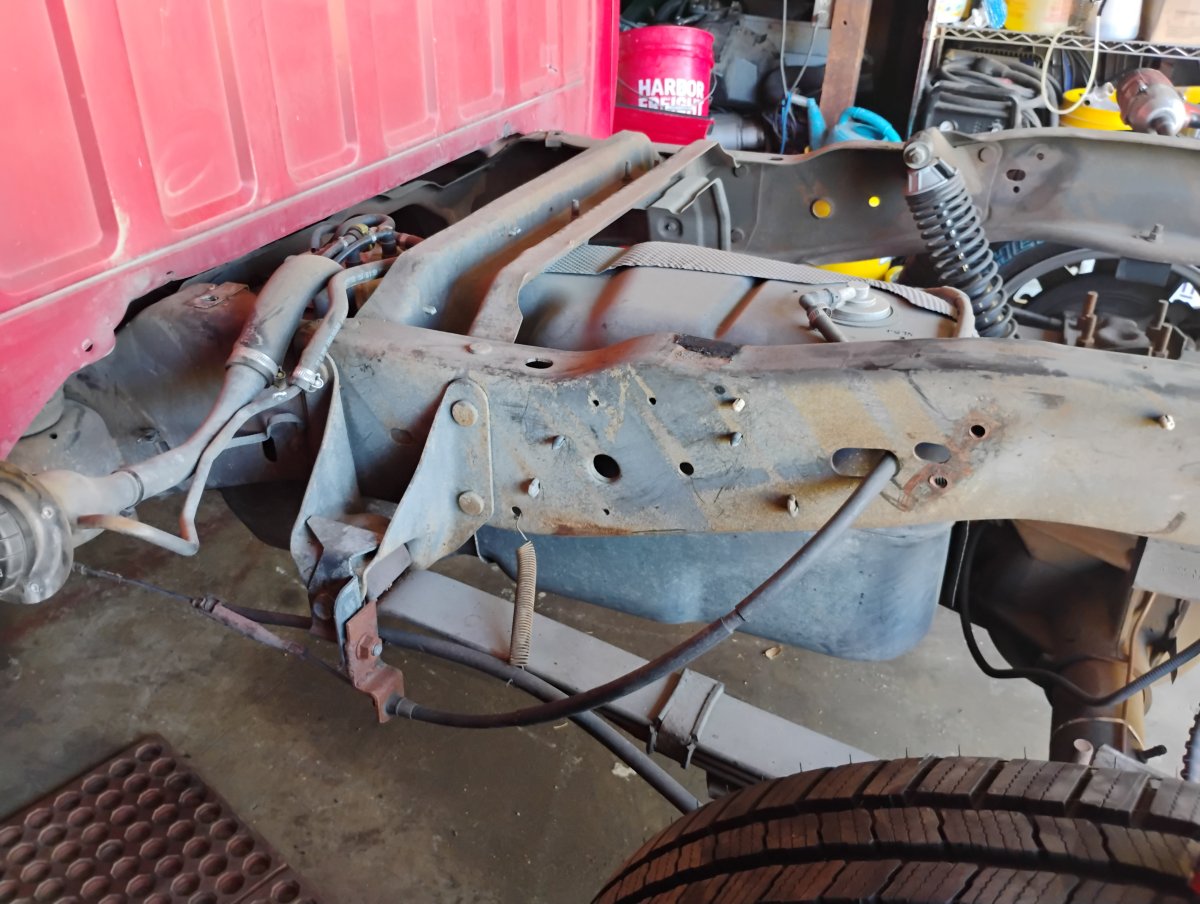

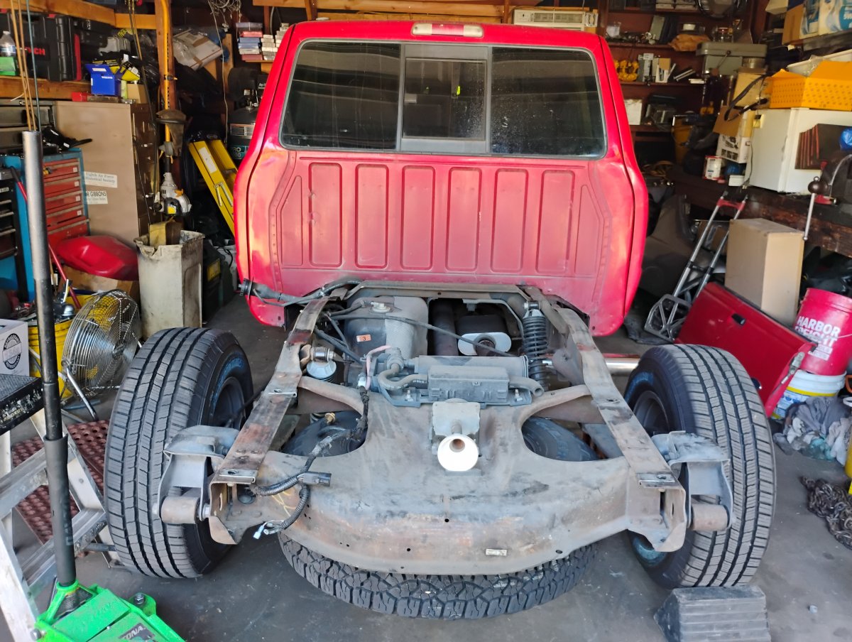

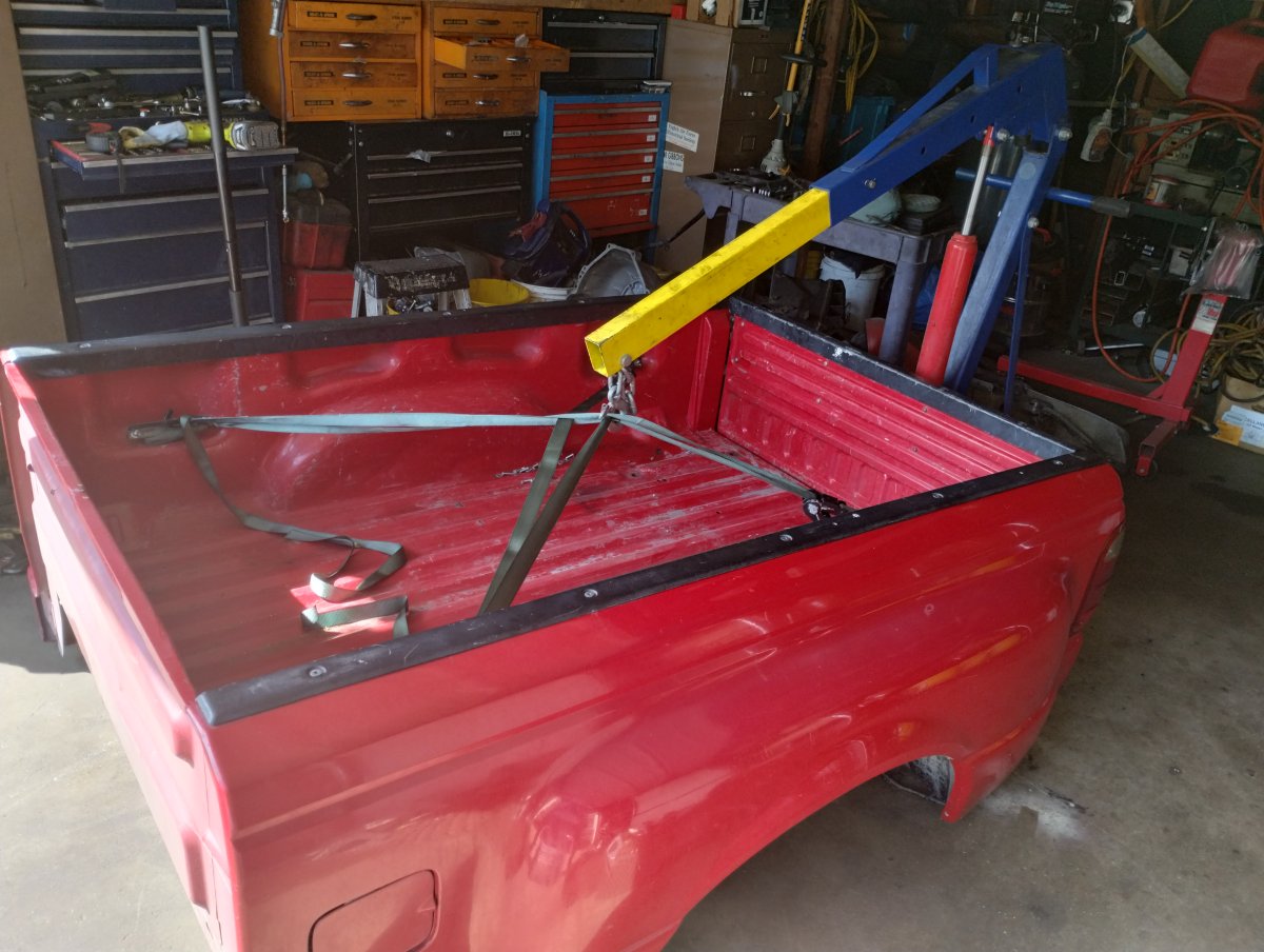

Thanks for your reply and the photosGot the truck home, drives straight as an arrow. Removed the bed and checked dimensions, The chassis is square side to side but has a 3/8 drop on the left rear chassis, probably due to overloading. The Chassis is in very good rust-free condition with very light surface rust that comes off with the callouses on my hands.
Now to the bad part, It has obviously had a crack in the chassis and has been repaired... it's a massive 1 " long and has been repaired perfectly fine.
I will attempt to straighten the rear chassis with my hydraulic equipment and put in some nice bracing.View attachment 117178View attachment 117179View attachment 117180View attachment 117181View attachment 117182View attachment 117183
Agreed... and Sorry about everything... they said it was bent 5 inches and diamond bent which means nothing... It was Upland auto body and collision that tried to rip me off. They also claimed that the frame is short in length cut short then welded. Is the frame still factory length? So all of that was a lie then.. Sorry everyone for starting this thread...That shop was trying to sell me a frame job i didn't need.I've drilled holes bigger than that crack... I'm going to get the frame back in place and put some HD bracing in where it bent.
