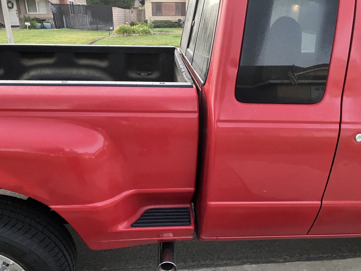

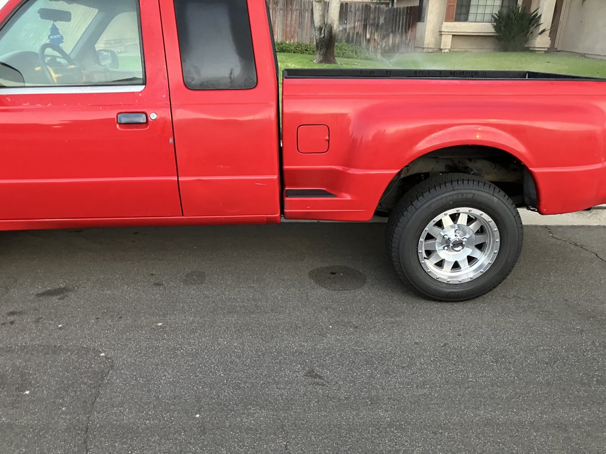

But the only thing that i am wondering about is the slight cabin elevation. Why is the cabin slightly elevated on both sides or one side. Would that be a front frame issue then? Or when the bend is taken out the back that should go away. The cabin is only slightly elevated very little. Maybe @Thedrill should check it out just in case there is something there. But i don't know im not a mechanic....

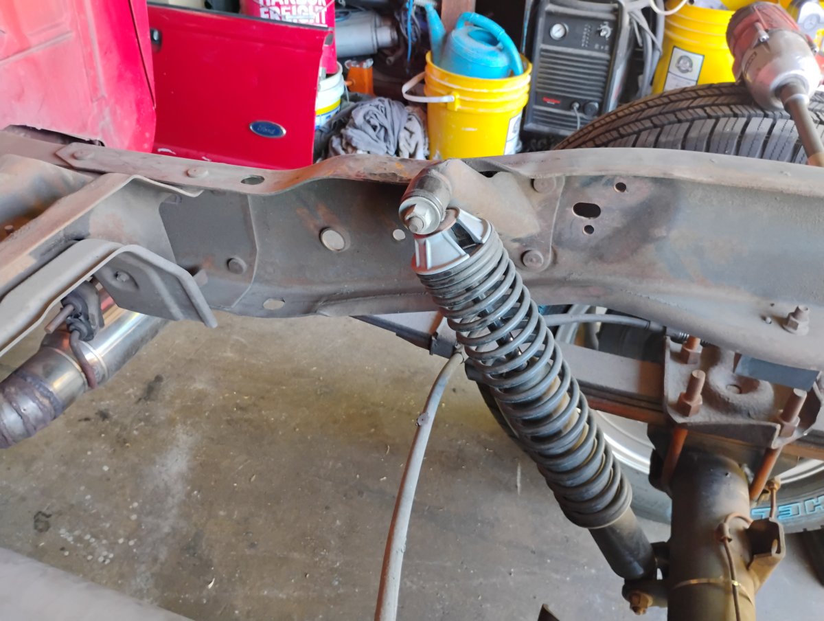

a 3/8 drop on the left rear chassis, probably due to overloading
Shhhh…. I’ve overloaded the ranger a few times and I don’t want to think about any damage I may have done. But she drives fine so I’m not sure it did anything.
less worried about having bent the axle, the ford 8.8 is pretty stout. More worried about the frame or bed mounts.
I'd say talk to @Thedrill about your concerns, and wait to see what happens from fixing the frame before worrying about it much. He knows what he's doing and don't want to step in his toes.
I will say that some misalignment is not uncommon in trucks, and many leave the factory with shims installed to bring things into alignment. Push come to shove it won't hurt to add more shims to get the panel alignment you seek.

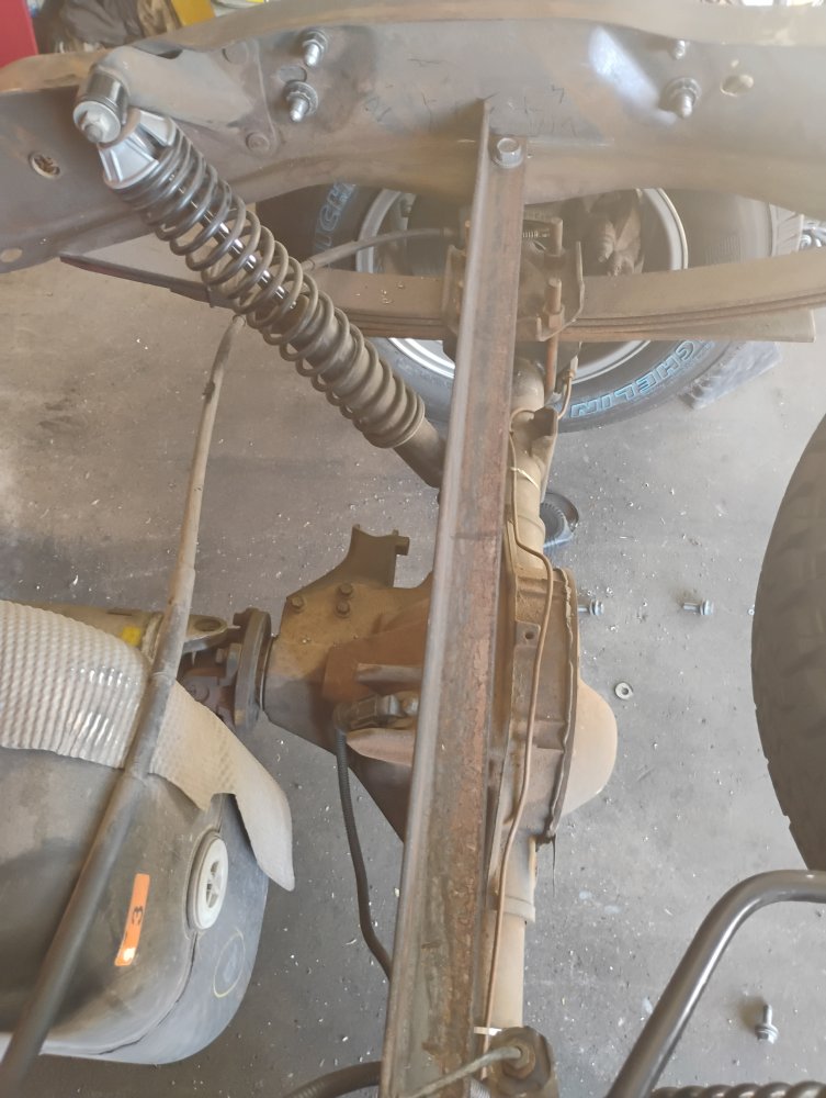

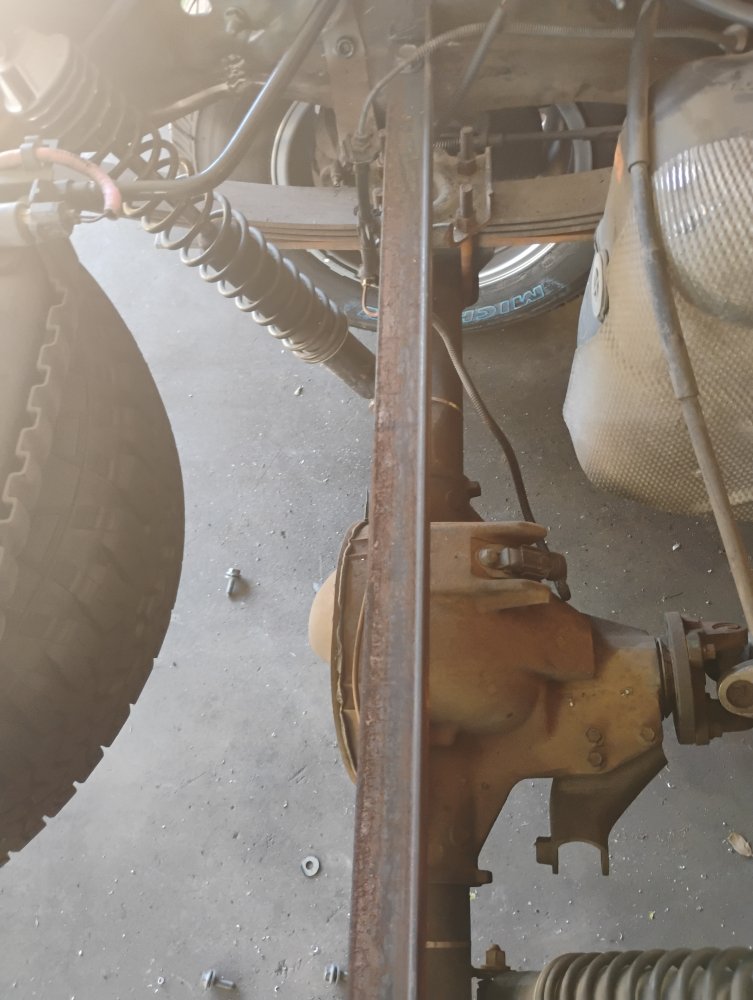

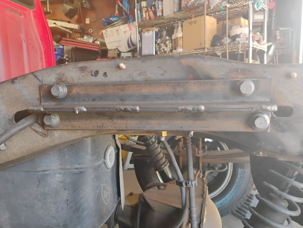

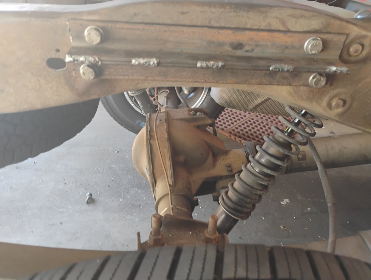

Just finished up the repairs, I pulled the frame up on the left rear past where it needed to be, taking out the tension and relaxing the frame with a BFH.
I fabricated some 3/16 angle bracing above the rear axle and bolted it to the frame both sides using existing holes that were drilled for an extinct air spring assister.
Also added a cross brace from one side to another. Nothing fancy but

has stiffened it up.
Also added a cross brace from one side to another. Nothing fancy butView attachment 117324View attachment 117325View attachment 117326View attachment 117327 has stiffened it up.

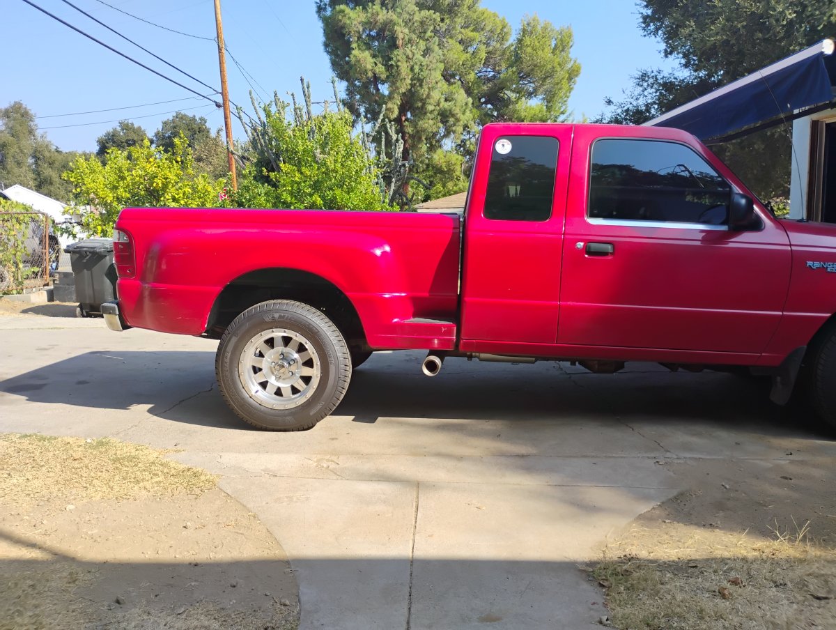

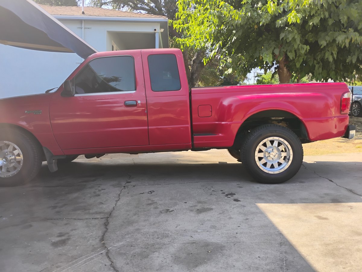

Given the age of the vehicle/truck i think it looks great. I got the truck back from @Thedrill and everything is good. The truck looks much healthier now. Im going to take good care of it, i don't drive that much anyway. I plan on keeping the truck for a long time. Unless someone really wants to buy it from me. Its a special truck...
