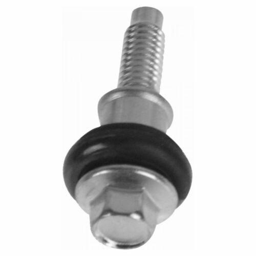

It is hard to describe so a pic is worth a thousand words. The dealers have never sold just the grommet. They have always sold the complete bolt assembly. There are two versions and maybe more than one length of bolt, not sure. BUT here are a couple pics. What I want is the RUBBER GROMMET ONLY. The assemblies are unavailable anywhere I can find (except overseas in a month or more and would cost $$$$$).

Look at the shape of the grommets. IT is two different diameters with one that enters into the hole in the cover (alignment) and the next seals the cover.
I have already tried to find Orings, but they do not seem to seal properly. I have considered silicon vacuum line, but inner diameter and outer diameter are too large. The cupped metal washer will not hold it in place as diameter too large.

If 1S7Z-6K562-AA is the assembly you're talking about, fitment on that is apparently listed thru '11, plus '04-'07 Focus, which gives you a bit more flexibility in junkyard pulls than just '01-'03 Ranger.

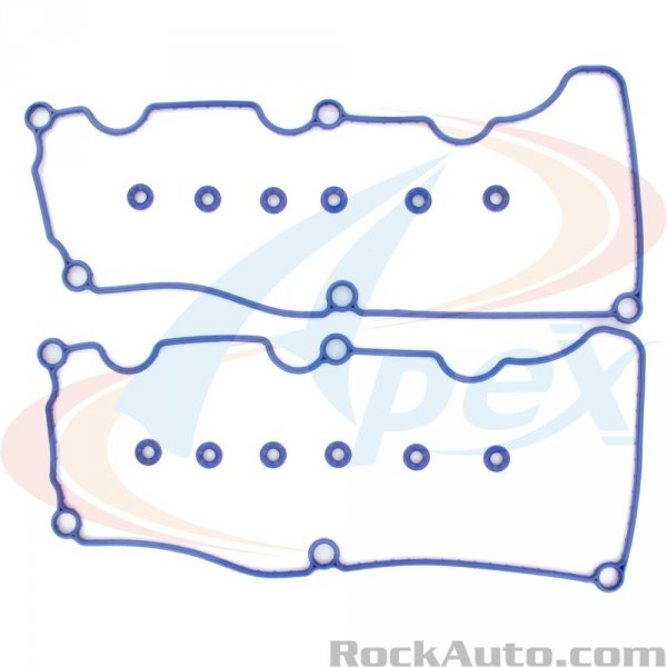

If I try to chase it down, I find some guys talking about trying the comparable Mazda 3i part LFBL-10-237, but I can see that's literally the example picture you posted before. Have you already eliminated that part as being close, but not exact-fit?
