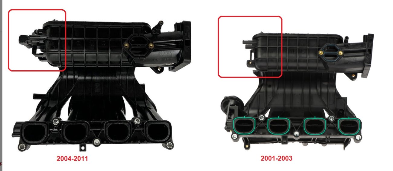

2001-2003 2.3L Intake Manifolds, Swap for 2004+?
Anyone know how major the changes here are? I think it's just the PCV stuff attaching a little differently.
There is some follow-up on the other thread. One fellow deleted the flappers and shaft, epoxied the holes shut, and left the MIRC on doing nothing -- computer was happy. Another used a 2004 intake and had to make some changes for vacuum lines as the previous post here suggests. I'm going to be removing the flappers in mine and sealing...
That was me. Here it is:

Is there any advantage to using a 2004+ intake over removing the flappers and sealing the holes in the 2003? I'll be retrieving a 2004+ thermostat housing to ditch the heated electronic thermostat anyway. I know it might be less work, not really worried about that.
