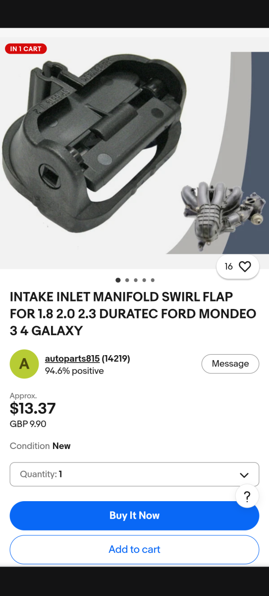

Are these compatible with the Ranger? I was deleting my flaps and broke a couple.
2001-2003 2.3L Intake Manifolds, Swap for 2004+?
I've often wondered that, too. If they'd work that would be awesome for those with the 2001 manifold with removable holders.
I volunteer you to buy one, try it, and report back.
It's inexcusable that there is no aftermarket support for a wear part like this. Once Dorman stopped making them it was just a matter of time.
I might still order one just to see, but I decided to snatch a manifold from an 08 at the junkyard. I am putting everything back together tomorrow and hopefully she'll purr nice and smooth.
