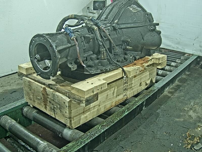

You need to find a 2wd transmission. Or have the awd converted to 2wd. The transfer case bolts to the back of the transmission and there is a big ass hole there
See what I mean.
The awd transfer case is not usable without the front driveline connected as it would just spin the front output shaft and not move the vehicle. You could potentially use the 4x4 trans if you connected a part time 4x4 transfer case such as the F-150 used and only connected the rear driveshaft.
The pcm will not care if you have all 4 wheels driving or not.
