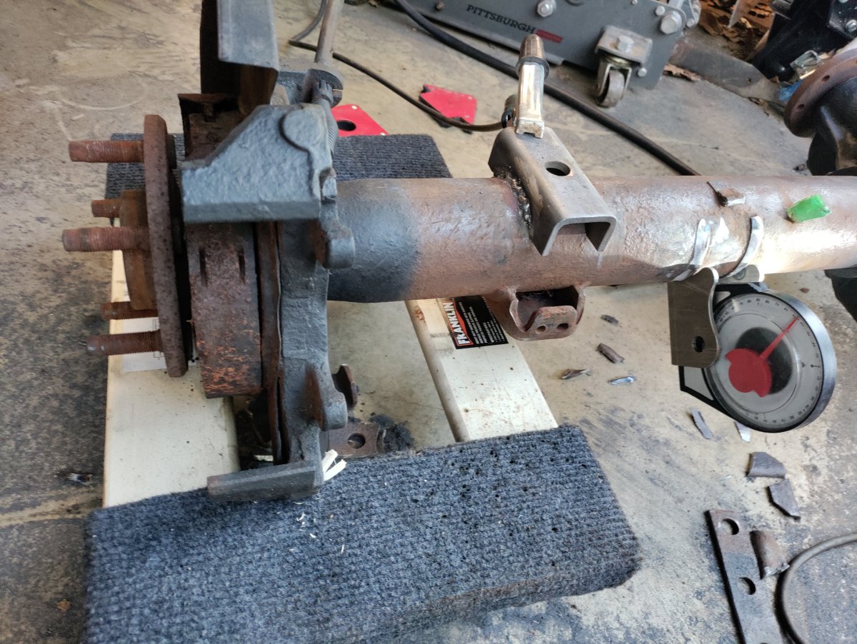

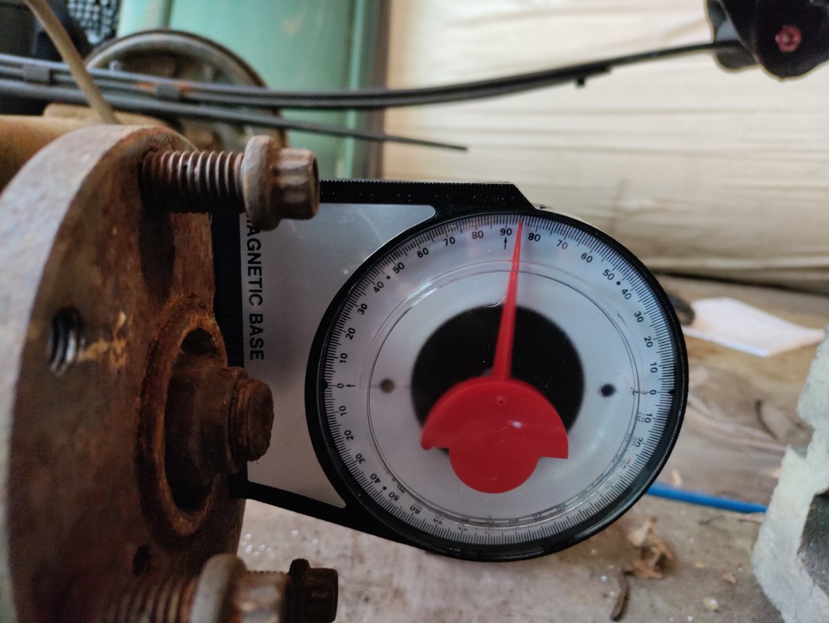

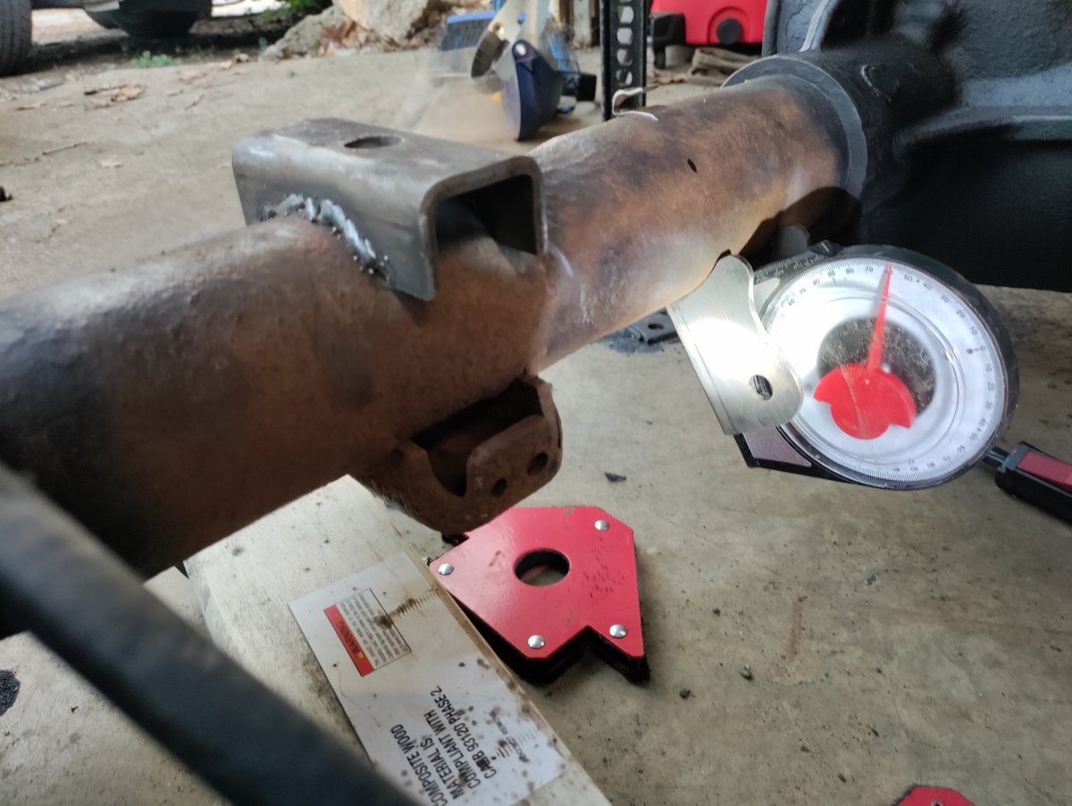

After a little bit of fooling around I figured out a way to take basic measurements from the stock axle to transfer to spring and shock perches on the new axle. I set the old axle in place, measured the angle of the front face, then placed the new axle in the same spot with the same angle and welded them on. I need to rebuild the brakes on both sides so I haven't tested the fit yet but I'm sure it's good enough.

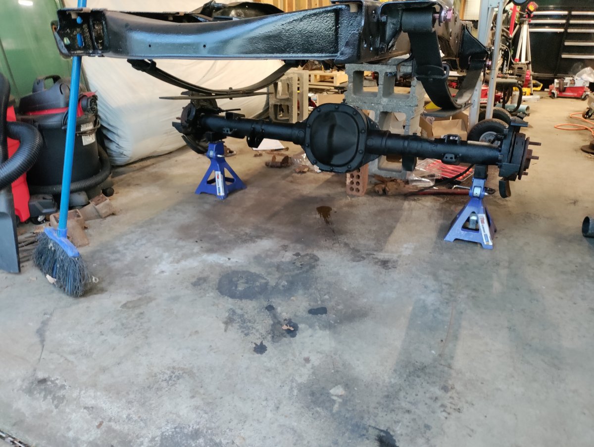

What kind of paint or coating did you use on the rear diff and axle? Looks like a good one.
Anything that isn't new I've been blasting with Rustoleum Rust Reformer. It's not the cheapest, but I can get a lot of run time out of a can and I've always used their Hammered black with much success on everything else. Since it's not glossy like the frame I think it will age well as it starts to rust again.

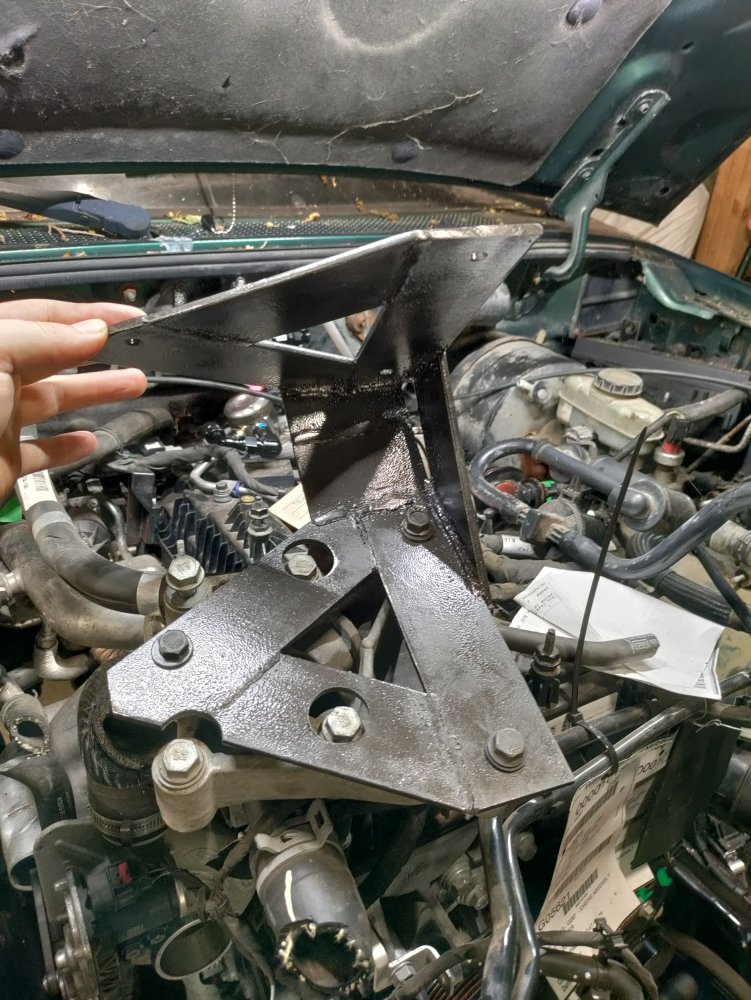

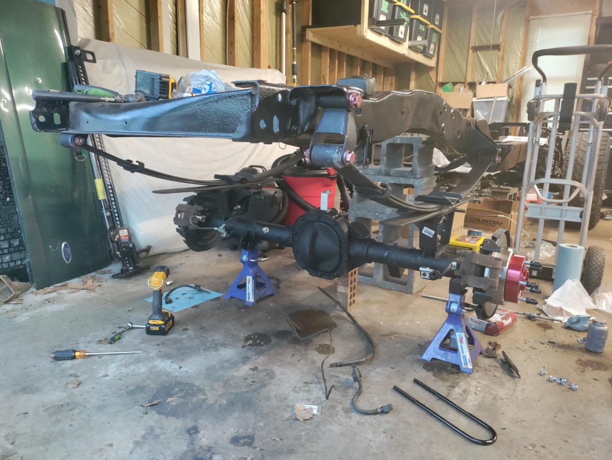

Finished up the brakes and pushed in the leaf spring bushings. Spring perches look good enough but the shock mounts are a little questionable. We'll have to see if they slot in correctly or not. Unfortunately something I didn't see coming was that the axle tubes on the Explorer rear end are are larger diameter than stock Ranger. The lift kit U bolts didn't fit. At this point I have serious regrets for not solid axle swapping the front and just welding up my own lift. I know this part wasn't their fault but I feel like with the RC kit I can't stop throwing good money after bad. Waiting on parts again...

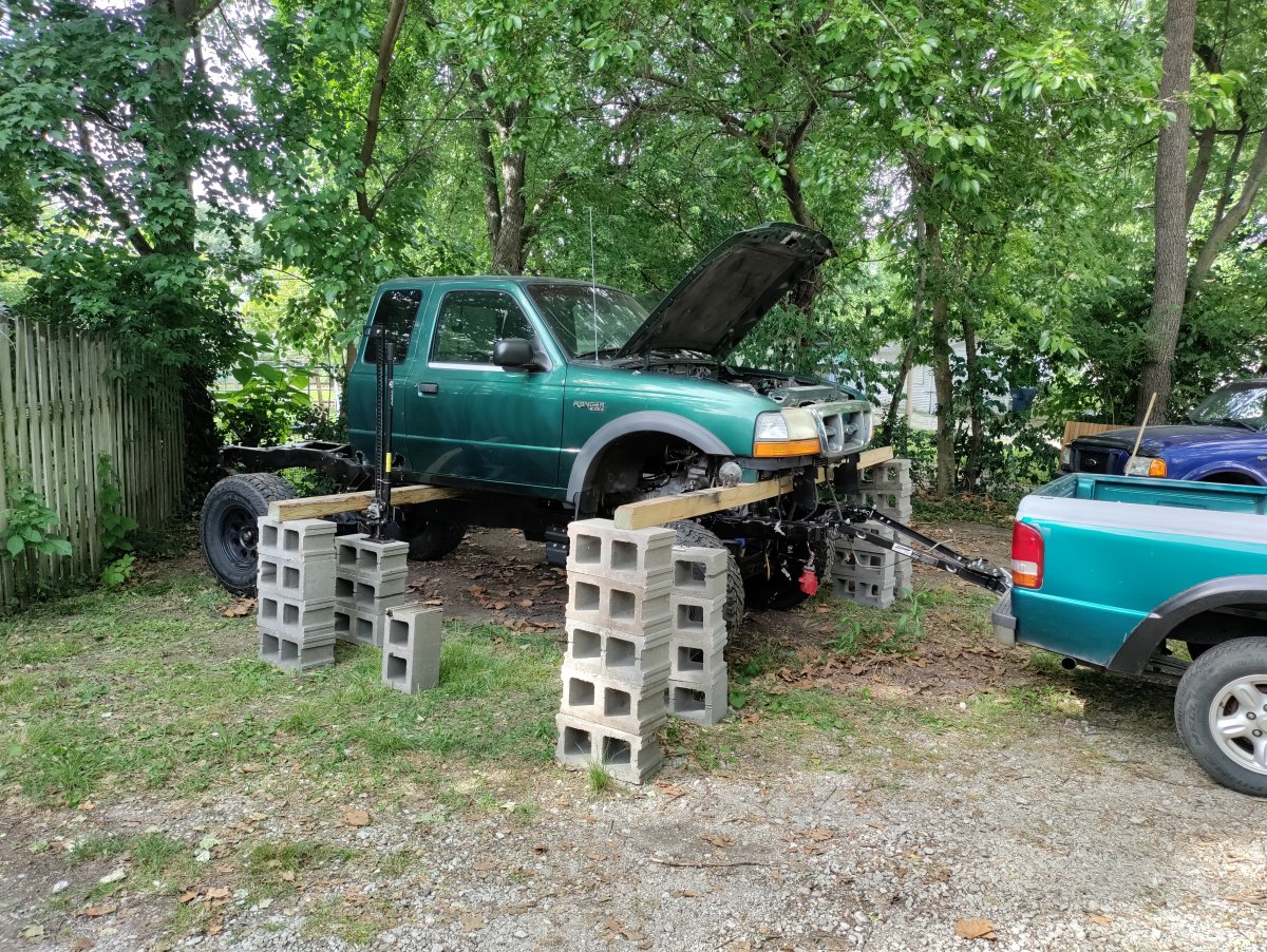

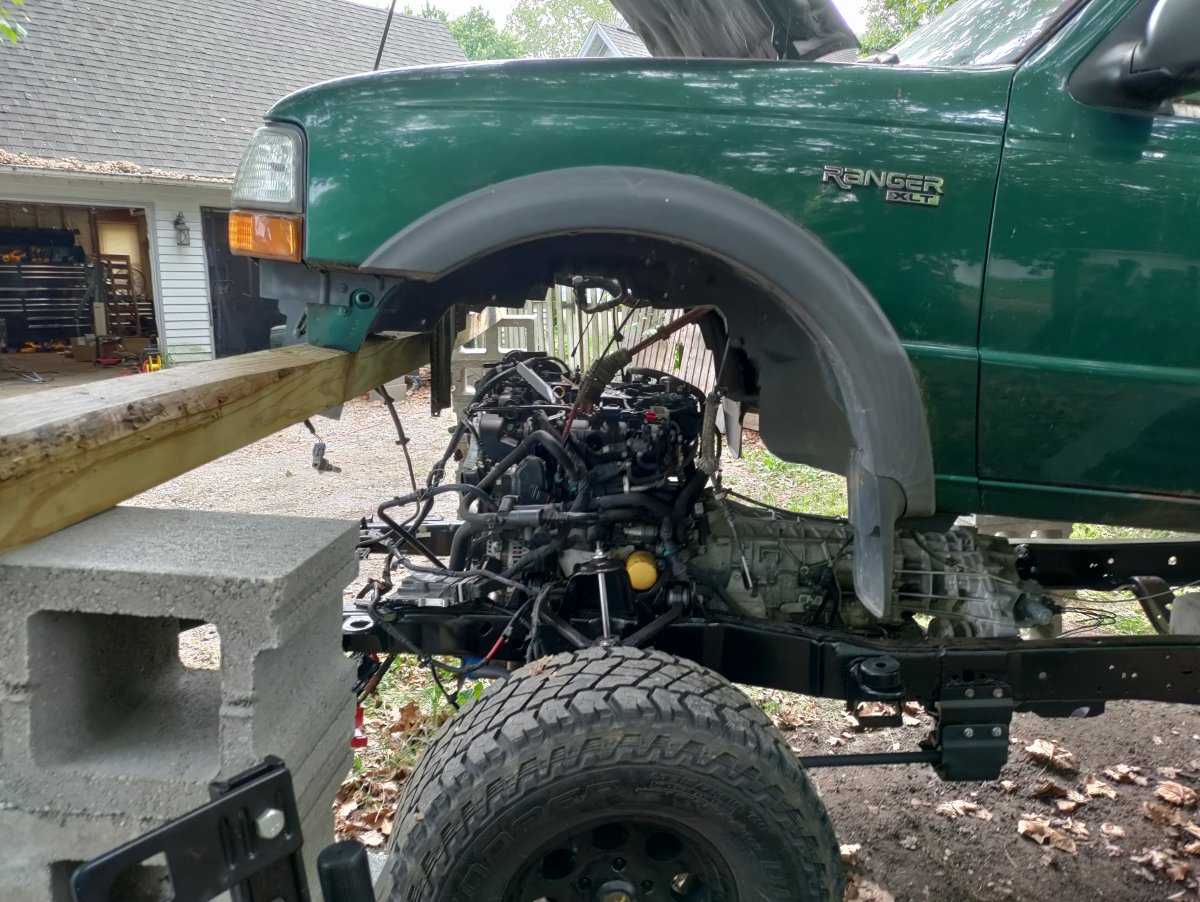

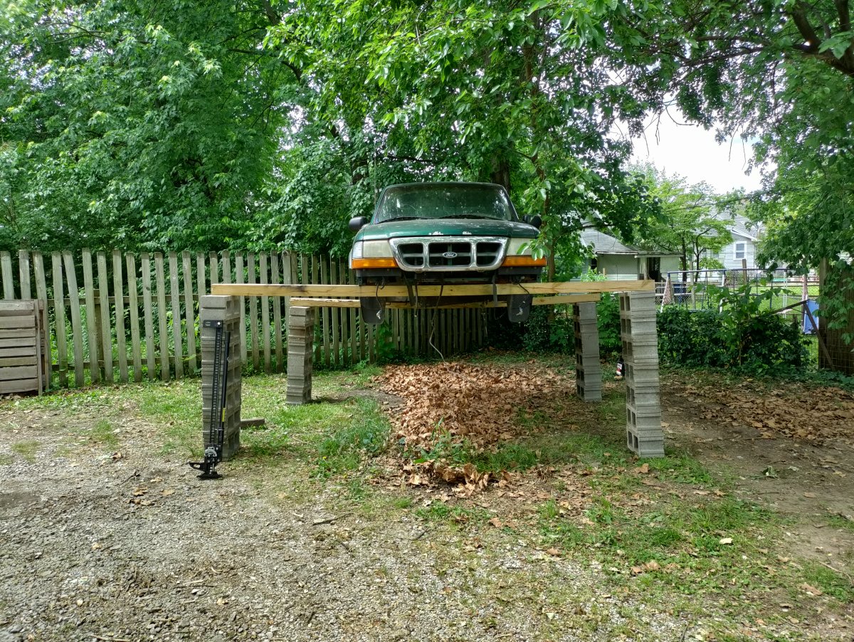

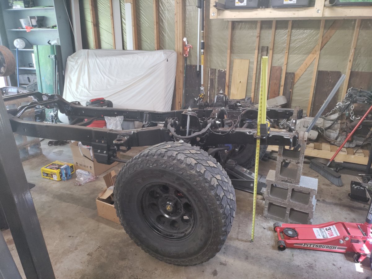

On the bright side I went ahead and set the front down for the first time on its own. The bad news is that I now realize just how much of a lift I got myself into. It currently measures 36 inches to the top of the frame. I'm almost certainly going to have to downsize tires because this thing is a monster and it just doesn't need to be.

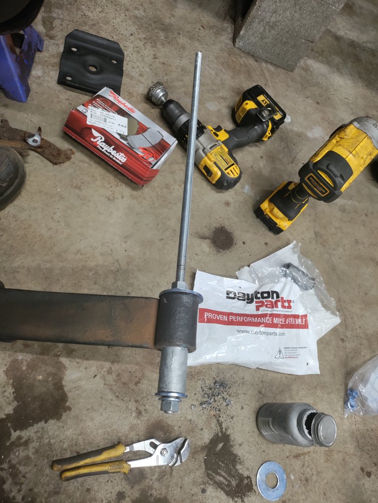

I had been putting off pressing in new leaf spring bushings considering the time I had getting the old ones out but the new ones took seconds. I used some threaded rod instead of fooling with the ball joint press this time and it paid off handsomely.

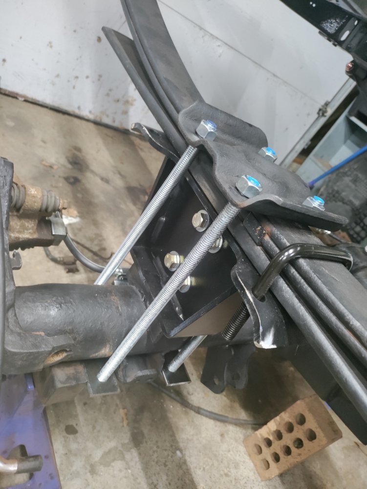

Since the U bolts in the kit didn't work for me and I couldn't really afford to wait any longer, I went ahead and made my own to get the platform mobile. The new ones have since come in but I want to weigh the old vs new axle to compare and I don't have time for that yet.

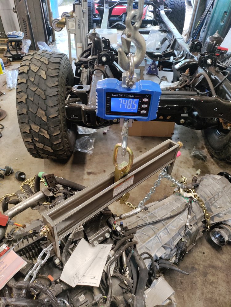

Speaking of weight - the wet 2.3 with transmission and transfer case (plus 1-2lb of chain weight) runs just under 750lb. I'm not sure what the listed spec is but that's what I measured. I'll get the weight of the old drivetrain later on but I haven't had time to do that either. I don't know what the weights are supposed to be compared to each other, but I'm looking to save weight anywhere I can to improve my tow numbers.

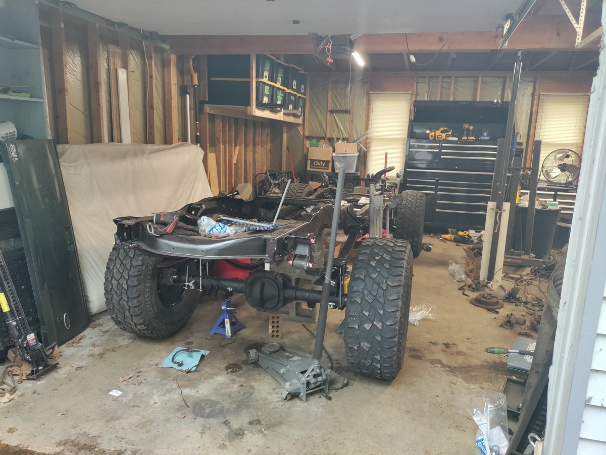

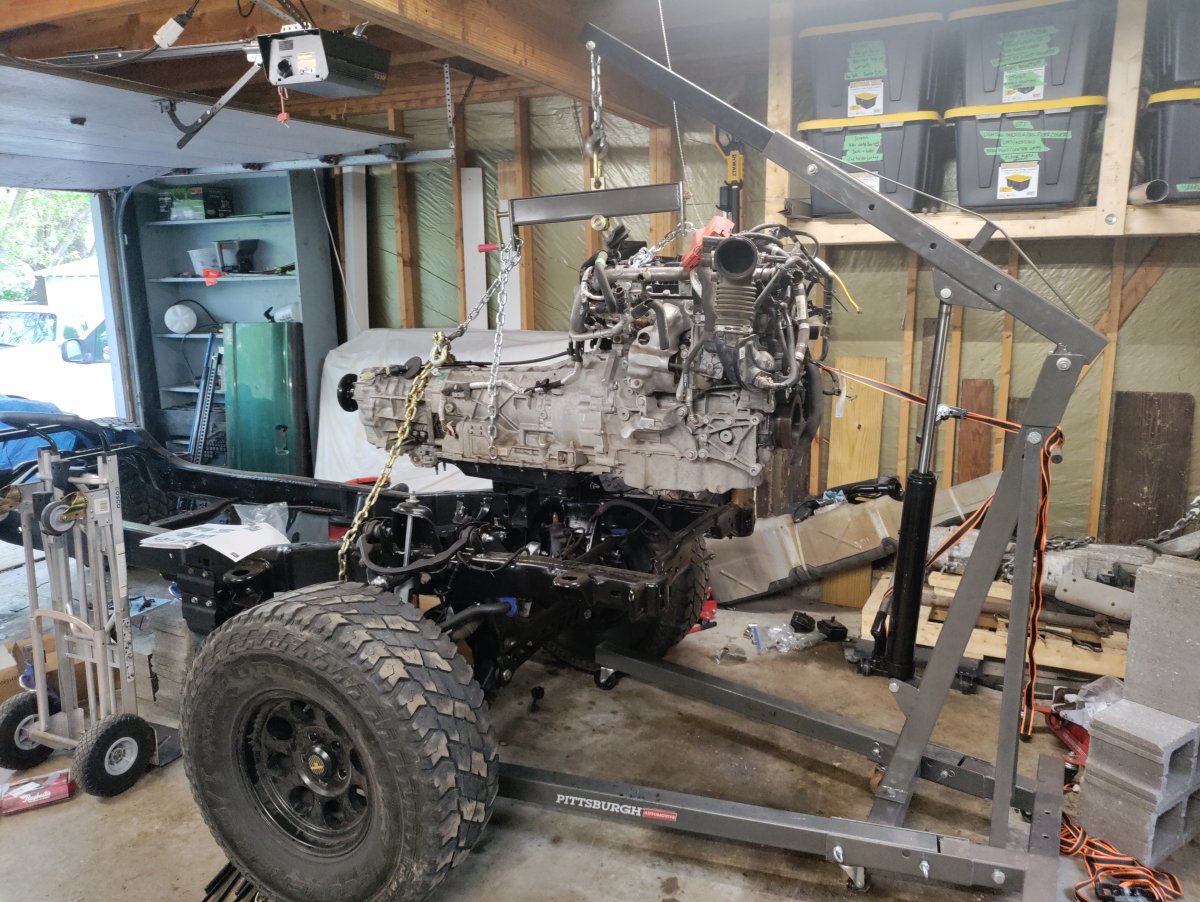

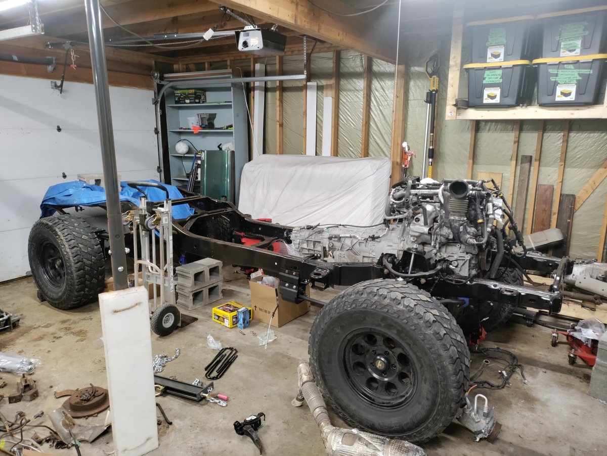

Getting the axle underneath meant I could move the platform and put the engine in head-on which was necessary now that I don't have side clearance with the lift and tires on. Getting the engine in was nice to clear up floor space and also start planning engine management.

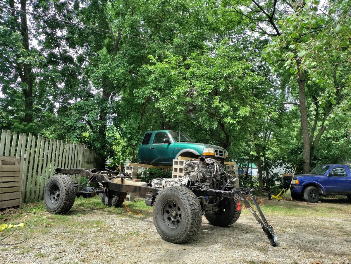

With the rear tires on you can see how massive this thing is. I'm not sure it will even fit in the garage once the cab is on. Also if you saw me running the massive 1.5" spacers earlier it's just because I got a stupid deal for these wheels and tires and they are 5x5 pattern and more positive offset than I needed so I just corrected the offset and pattern in one move. I'm not sure if I'll keep the combo or not but at least this gets me rolling for the time being.

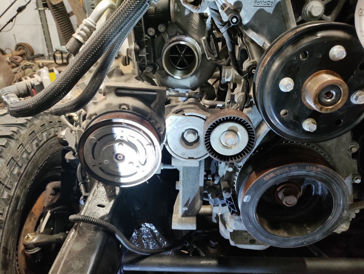

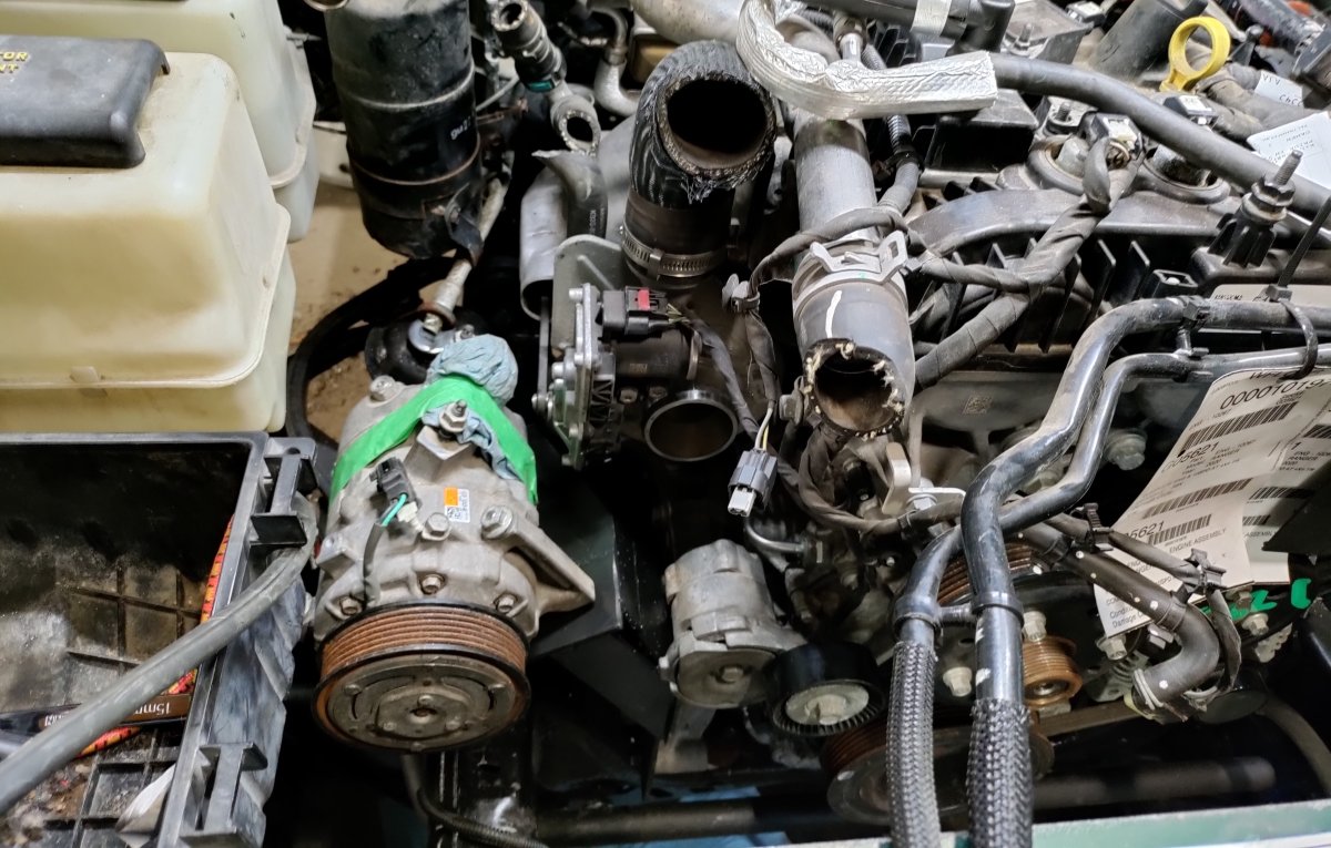

After a lot of thought, I'm thinking if I get creative with piping I may be able to fit the AC compressor back on with a little bracket work. I'm going to have to test suspension travel because clearances are tight, but with the factory air pipe out of the way, it barely makes space for the compressor. As I mentioned before - this build will have AC one way or another by the time it's done.

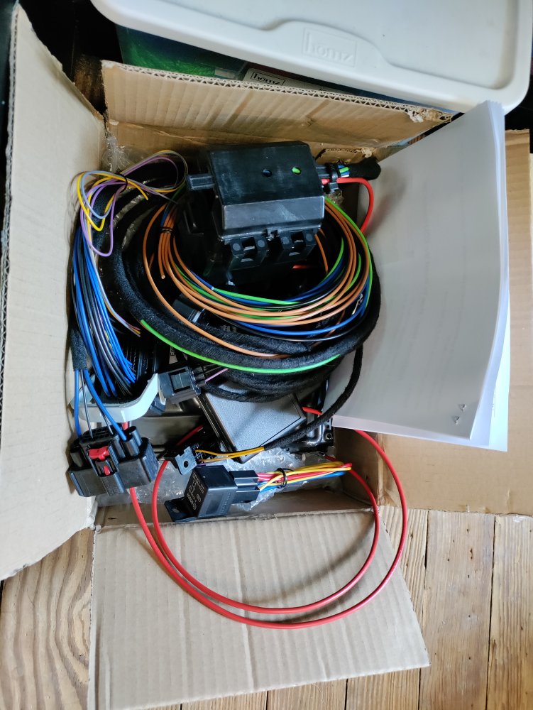

I decided in the name of progress to sell my Qwik Lift to fund the ECM. The quality seems to be extremely high and I'm glad I decided to skip past all the junk with immobilizer and whatnot on my factory ECM. My working theory is that if this seems stable, paying for the Mustang ECM might bypass the need for tuning the Ranger computer to make the gains from stock 270hp to stock 310hp just by switching the platform. For science we're going to find out if this is indeed the case or if I blow something up! Determining the cross compatibility I think is worth the risk.
I'm going to replace the alternator with a Mustang one since the mount looks identical from the pictures. The electrical plug is different, and the Mustang appears to be rated higher anyway. There are also a couple of sensors that I am going to switch to Mustang just to try to keep things as predictable as I can. I don't know which ones yet.
Here is a picture of the harness in all its glory:

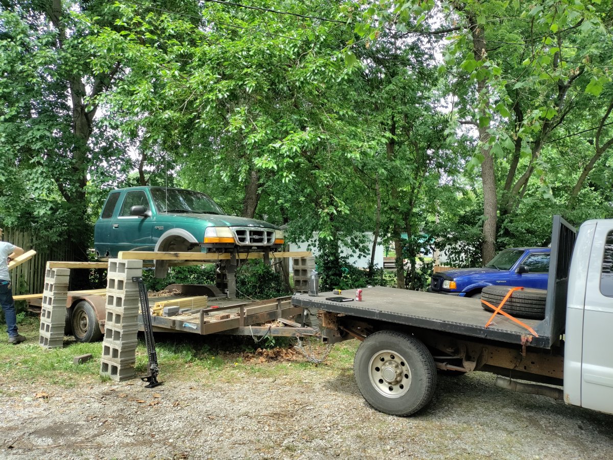

Side note - the body had been sitting on these 4x4s for exactly one year at this point outdoors. While they were still stable, they don't have much strength left in them where I'd trust them for much longer with this amount of weight. Also if I ever have to do this again it will definitely be done with a lift because this was painful.
2000 Ranger 4.0 to 2.3 EcoBoost Swap

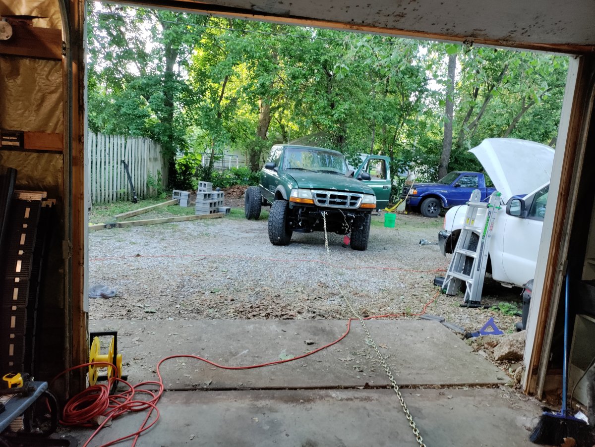

It took forever and apparently I didn't measure transfer case clearance properly so the body is lightly sitting on top of it. Having the steering wheel back made it much easier to move around.
The lift is not as crazy as I thought it would be and luckily it fit back in the garage. Had I not been as careful with the laser measurements in placing the engine mounts this would have been a very bad day if it didn't fit.

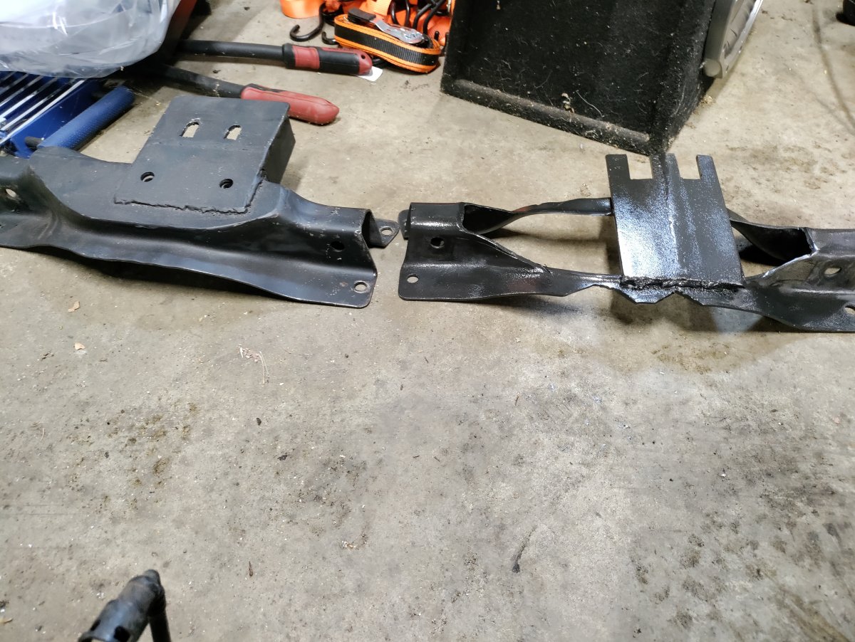

It's been slow going with the heat and other projects but I've made a new crossmember an inch or so lower so that the cab doesn't rest on the top of the transfer case. I ended up getting a new one from the parts yard to cut down instead of modifying the one I had in case I didn't like how it ended up. In my case without a body lift I just chopped it even with the bottom flange. I notched the flange a little on the back due to two lobes on the transfer case making contact. I'll add strength later on if I need to but I really just needed something that would get the placement right and see what happens.

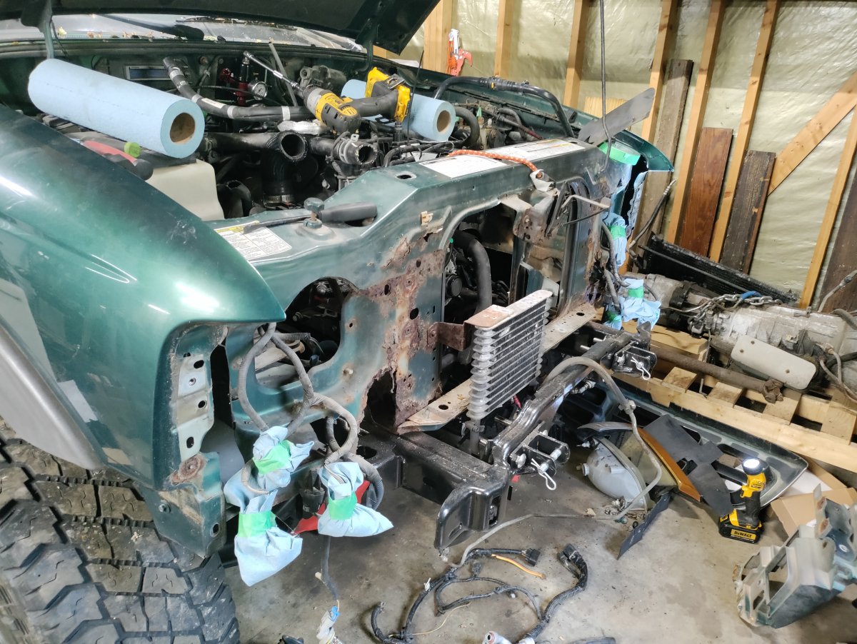

One fuel line is done, two more to go. Most of the front end has now been disassembled to prepare for replacing the radiator support and start plumbing the intercooler, radiator, and AC lines. The whole bottom of the support ended up crusting all the way off, transmission cooler and all, with a little motivation. This has been a big help with easy engine bay access. I seem to have made a big mistake not replacing the evaporator core for the AC while the cab was off and it may be impossible now with the engine in place. I had to saw off the AC line that goes into the box because the connection was corroded together completely. Luckily this isn't the end of the world though because I already plan on taking the cab off one last time for rust repair once I know if this thing will run or burn itself to the ground. The floor pan is rusted through so much that this thing might as well be measured in footpower instead of horsepower.

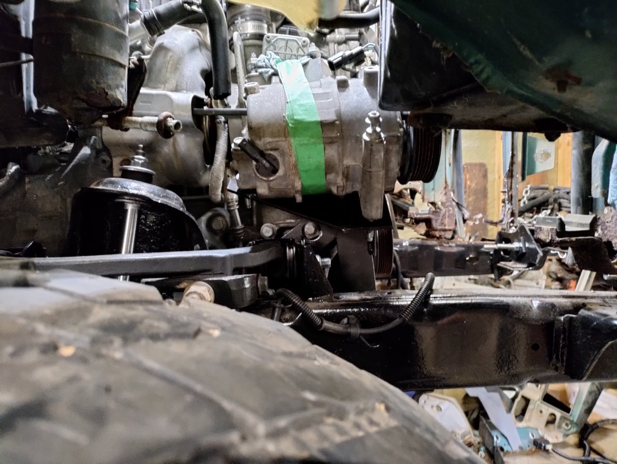

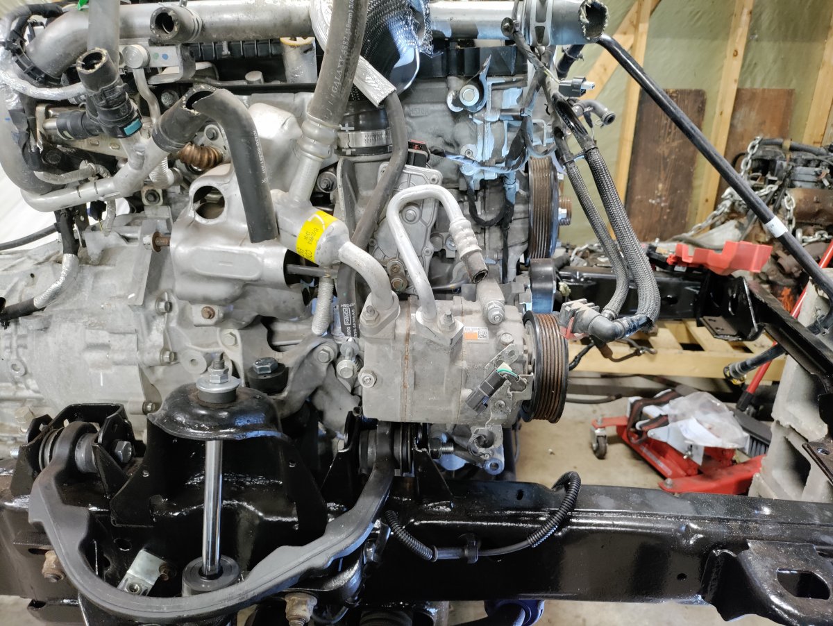

In light of the extreme heat recently and not having AC in my daily driver, I have devoted time to getting the AC compressor fitted. I ended up making a pretty crazy bracket that seems to work but if I had placed the engine anywhere else it wouldn't have fit. I wouldn't say my skills have improved any, but at least I'm not afraid to use the welder anymore. Time will tell if the suspension interferes at all but my hope is that the triangular shape puts it out of the way enough to clear. Worst case scenario I'd be willing to install longer bump stops to keep AC if that's what it takes.
