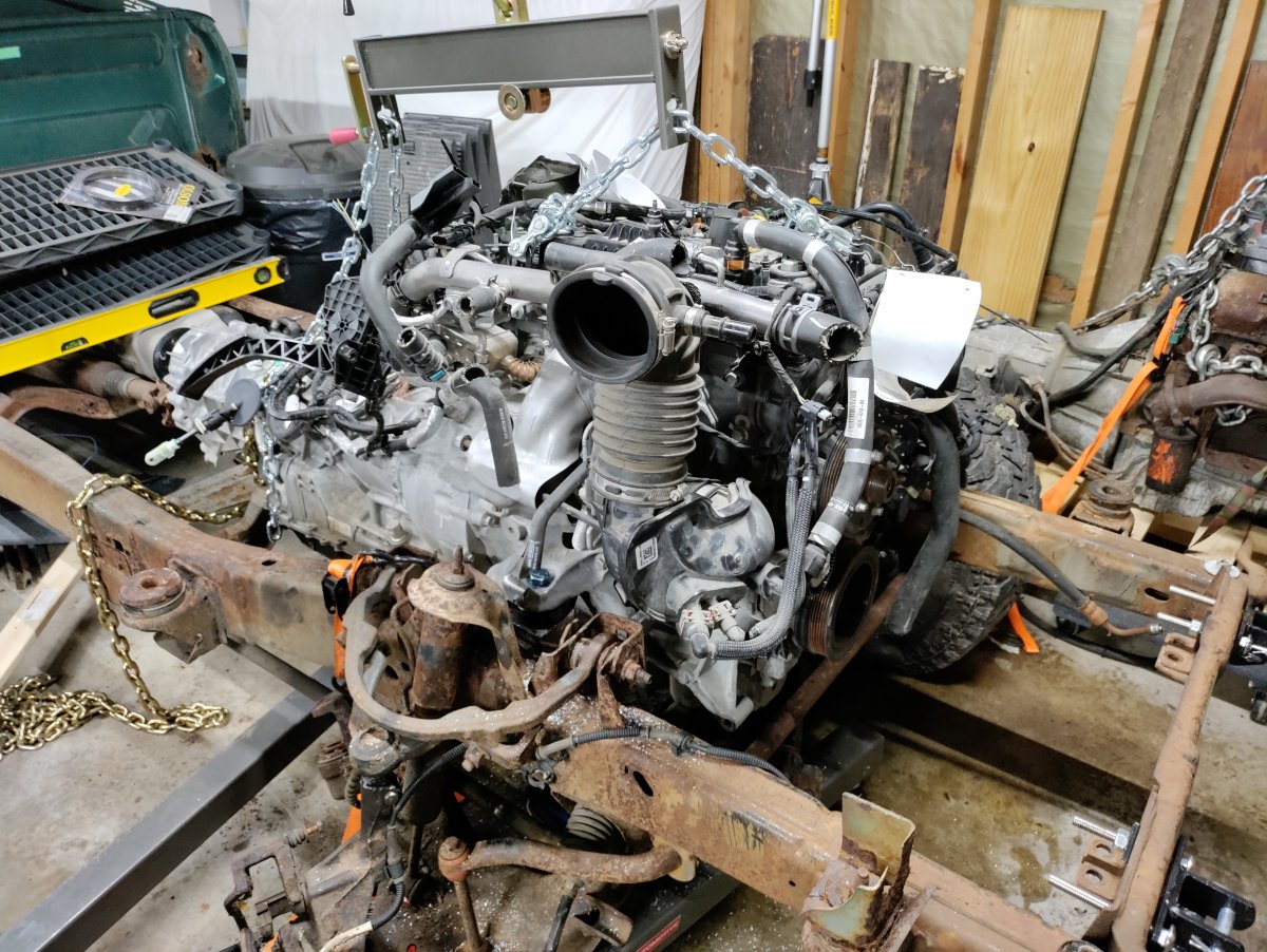

Progress has been slow but steady since I'm not a fabricator. The engine went into its home today. I still need to make a transmission mount and relocate one of the brackets about 1/16" so the bolts fit better. I was going to make a diagram for dimensions of my mounts, but I'm on revision 4 or 5 after a lot of tweaking so they look like franken-brackets that need redone into a final form before I'm comfortable sharing. I don't know what people generally use for brackets, but I made mine purely out of 3"x48" 1/8" steel that I found at Rural King. I have no idea if that will be strong enough but it feels pretty stout. To save myself a lot of headache, I used factory bolt locations through my plates. The actual engine mount holes moved forward considerably and I have some concern about strength, but it should be a good enough start.
2000 Ranger 4.0 to 2.3 EcoBoost Swap

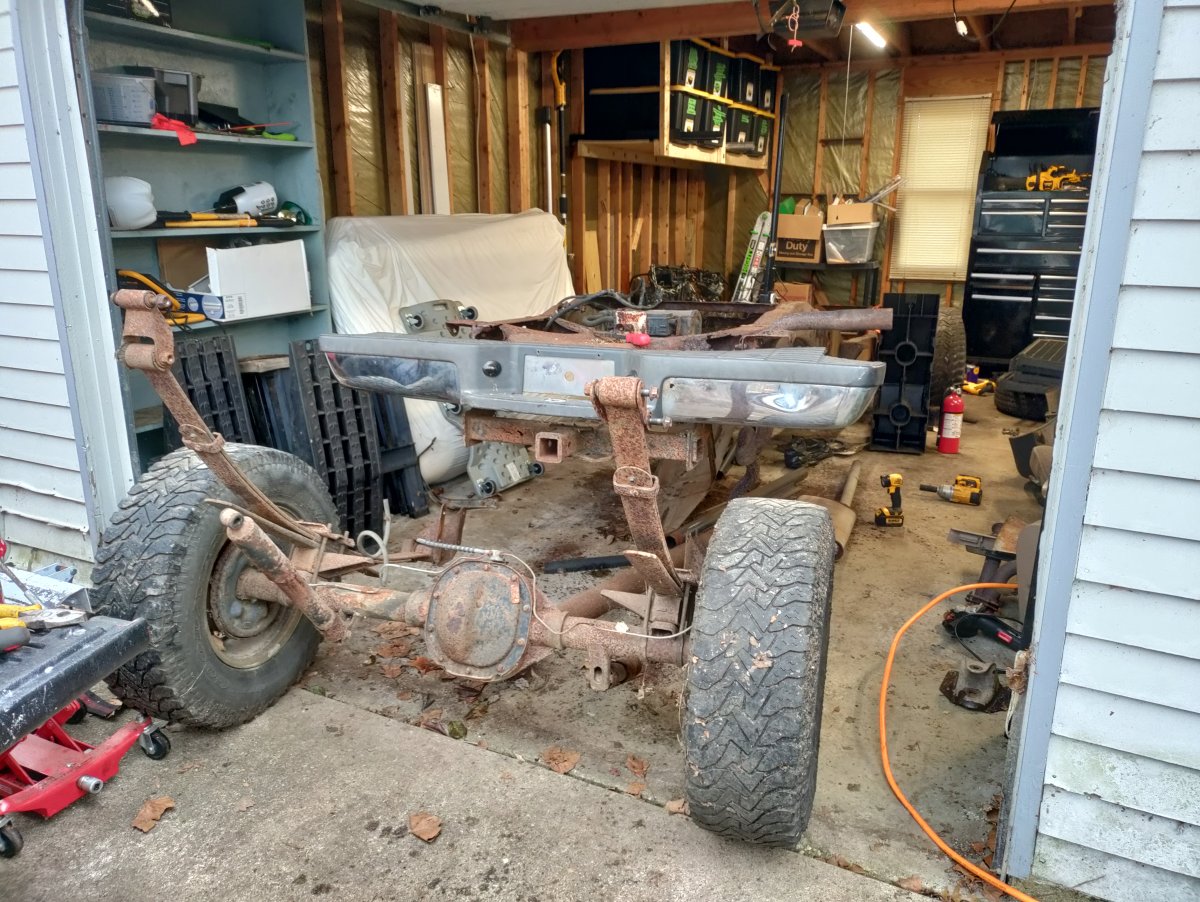

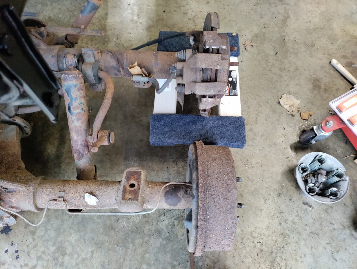

I ripped the bandaid off and bought a pricey 4.10 limited slip Explorer axle over the weekend because I can't stand drum brakes and I wanted some extra meat for the rear end anyway. Assuming the engine is OK where it is, in theory the rest is coming down to details. I will need to install a lift kit for the front diff to fit, but that pretty much guarantees I can't get the cab back on because I was barely able to lift it high enough the first time.

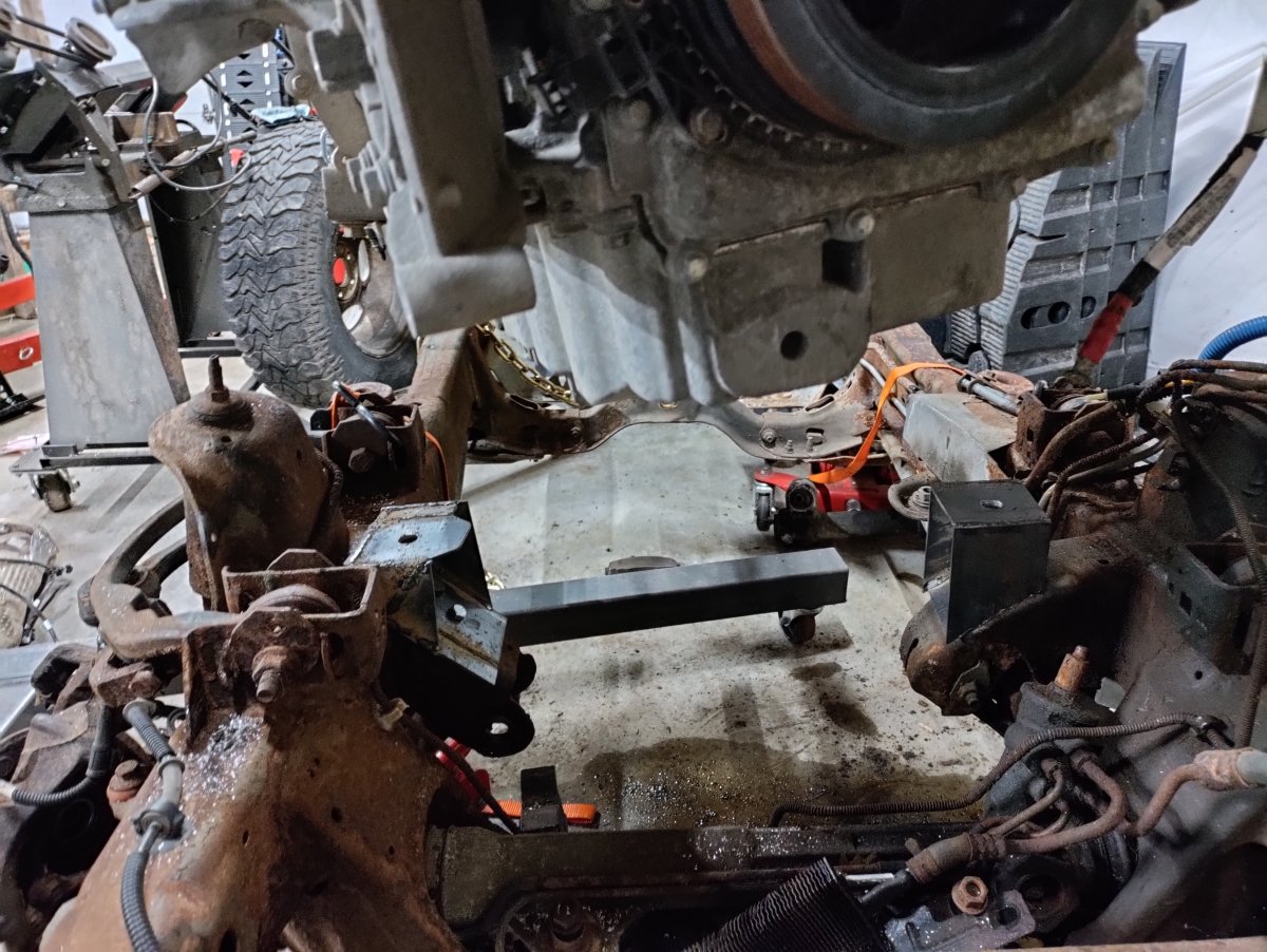

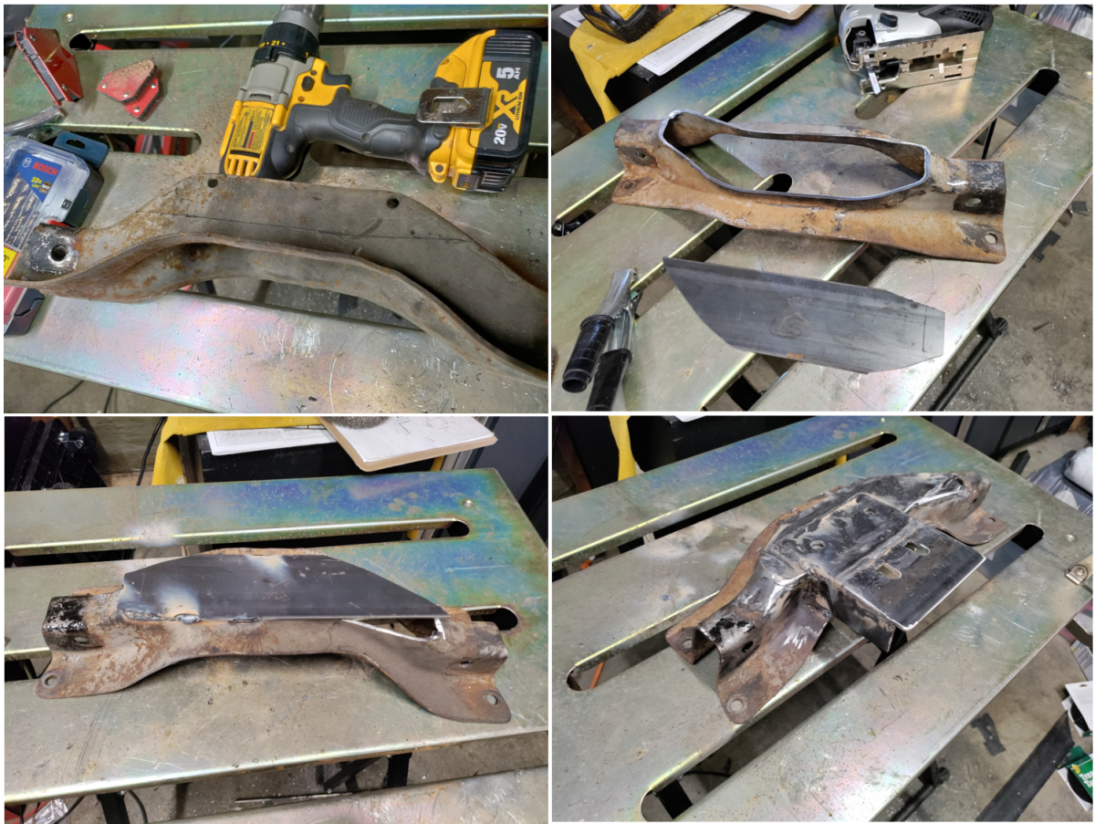

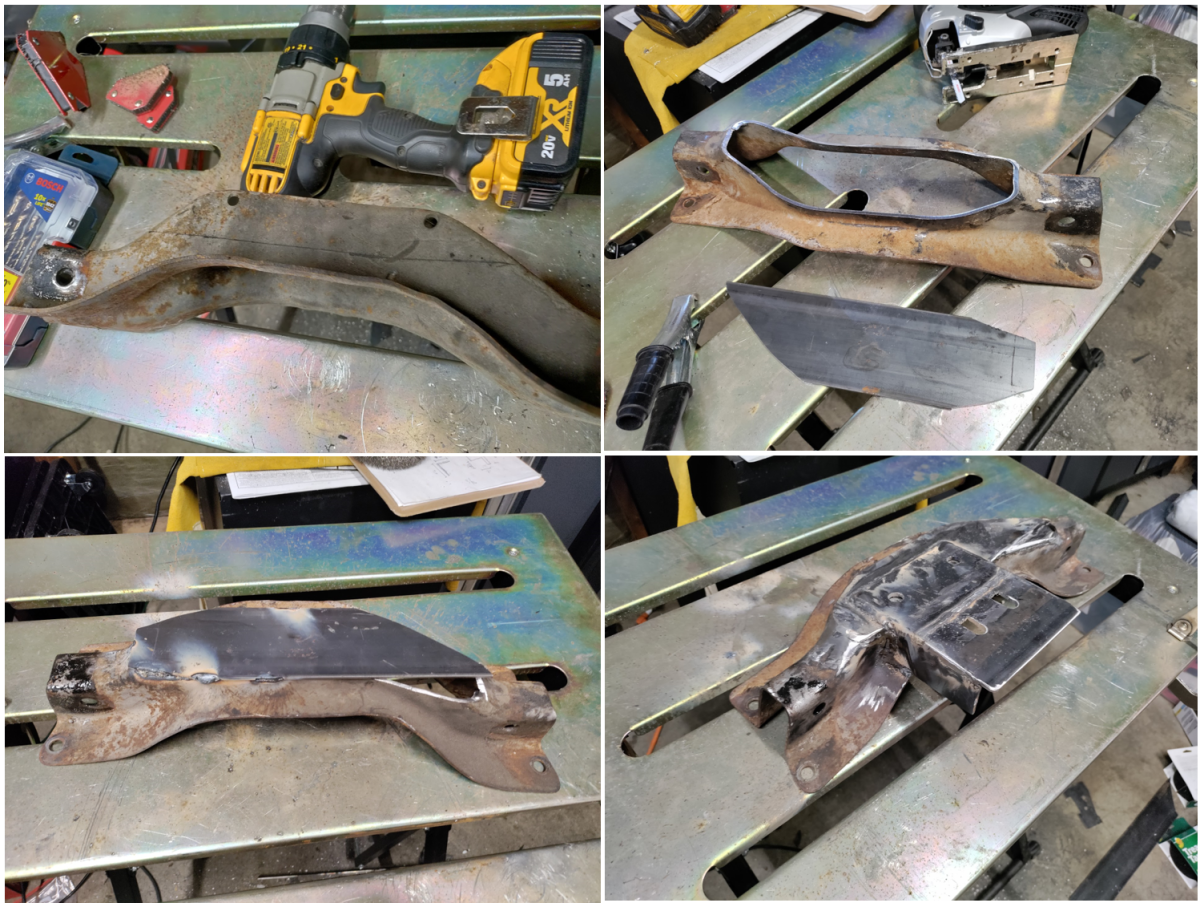

Transmission mount is made. I had to cut down about 2 inches off of the crossmember to clear measurements for the tunnel. I wasn't very interested in doing a boatload of cutting and framework to move the entire crossmember so I opted to just make a little extension piece. It looks silly and it's probably not the most sound but we'll see what happens. According to my measurements the drivetrain should be completely set now. I think I want to go ahead and try a cab test fit but it will be a little bit before I can schedule that. In the meantime I'm now ready to start fixing the hoses and broken pieces on the engine itself and get it ready for primetime.
I think that will work just fine.

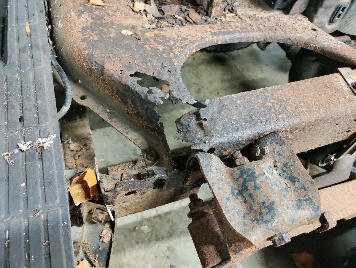

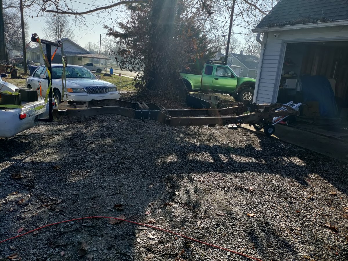

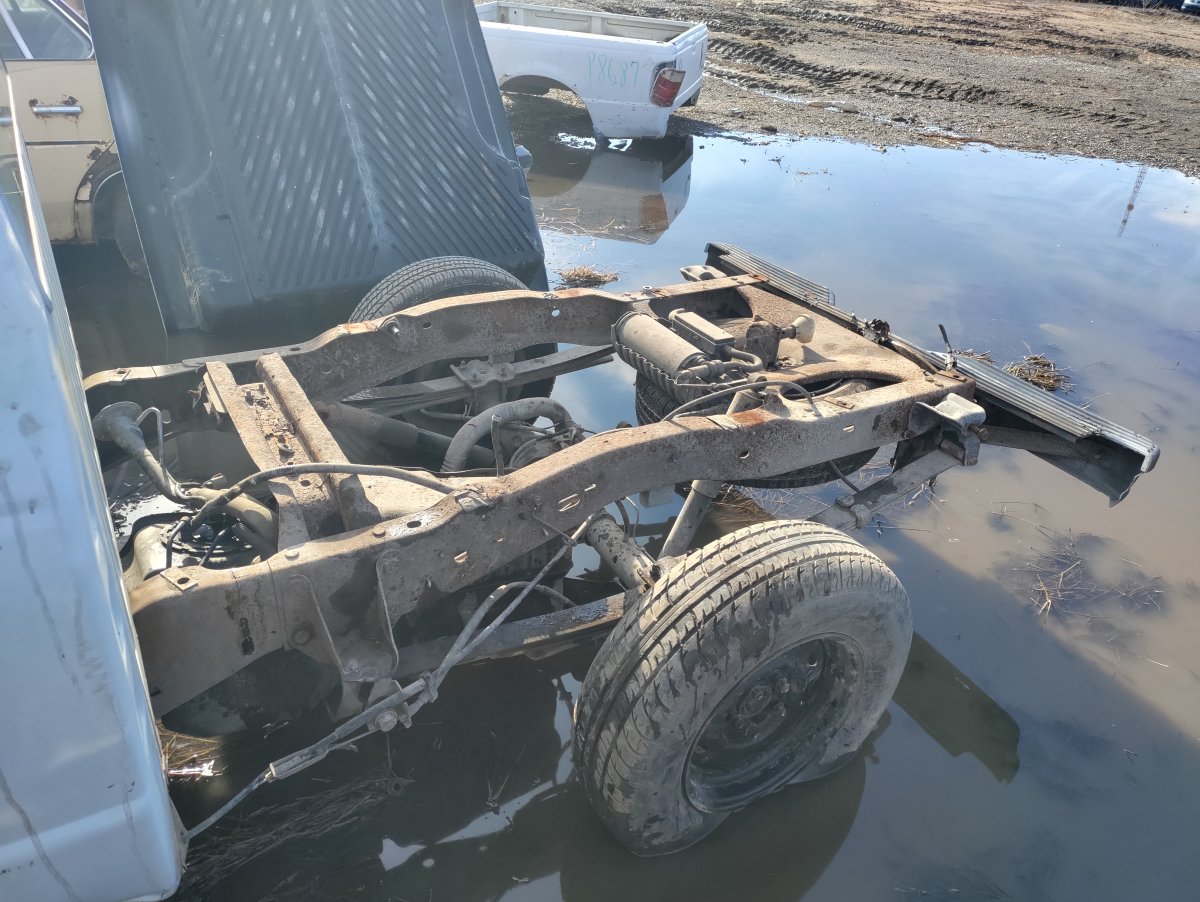

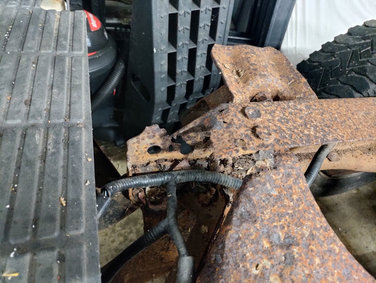

Due to some nasty frame rust issues, I've been searching for a replacement frame without much luck. I finally decided to settle on a half frame when I found a really nice one at the local parts yard recently. Since I plan to tow with this build I don't want to risk a poor frame repair would prefer to just replace the whole rear half. The last few inches are almost completely gone.
It may not look like much from the picture but the frame I found is in nearly perfect condition. I just hope it ends up being a match.

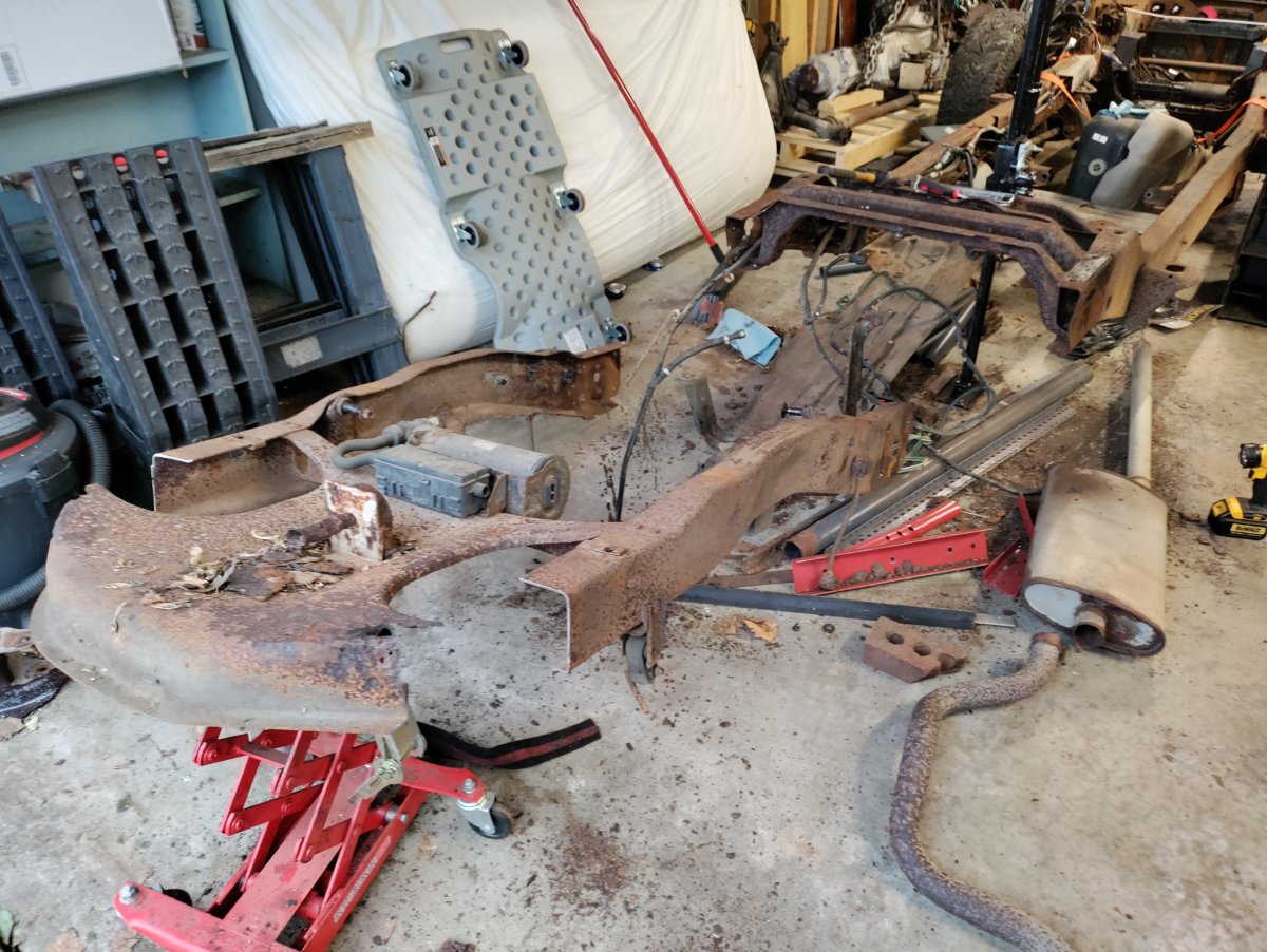

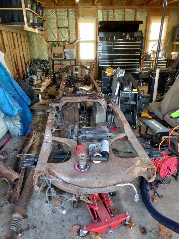

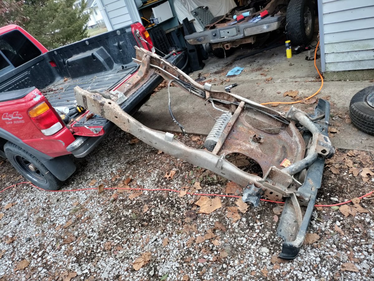

Next up is stripping my 2000 frame, replacing the rear half, then shipping it all off to be blasted and coated. It will be nice to have it finally going back together.
Working around the weather, I was able to squeeze in another work day. I found that the new frame section was too heavy for me to move around on my own with the rear bumper and hitch attached so those had to go. I wish I had a scale to tell exactly, but the rear frame section is lighter than I thought and I might guesstimate it between 80-100lb with the hitch and bumper off. For anyone curious like I was, with the bumper at hitch attached the best I could do was drag it where I wanted it but with them off it's not a huge deal to deadlift the whole assembly.

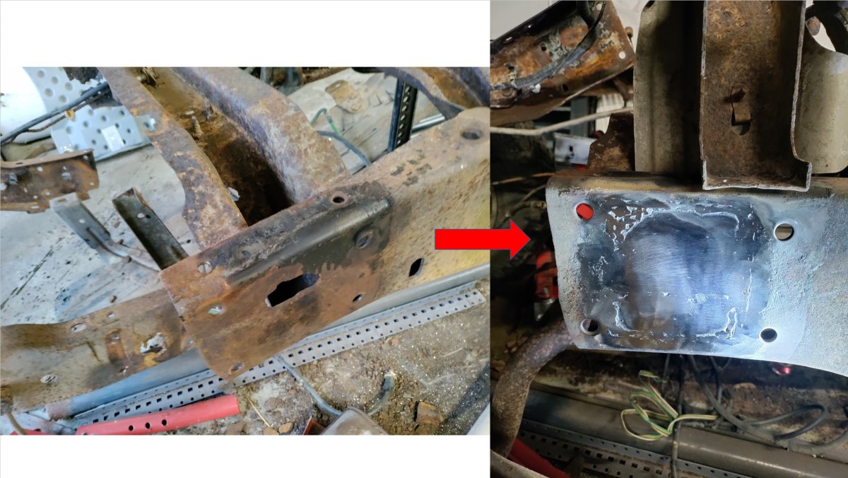

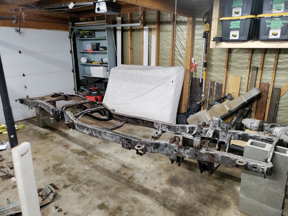

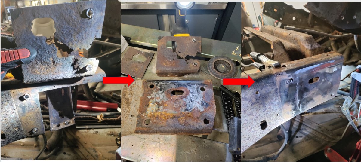

Another couple of nicer days and a bit of time away from work and I've got the worst parts of the frame patched and pieced back together and the entire front suspension removed. Since I sawed off the frame at the parts yard I had a good usable piece for patchwork which made life a lot easier.
Since this area overlaps and a cleaning process won't get to it I sprayed it all down with some off the shelf Rustoleum Rust Reformer before assembly.

I'm calling this officially the halfway point for the project since I think the worst of it is over. By my count it took me 107 labor hours to get here. If I had a lift I doubt it would even be half that.

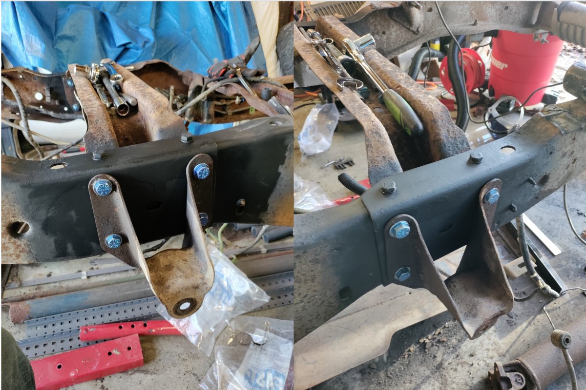

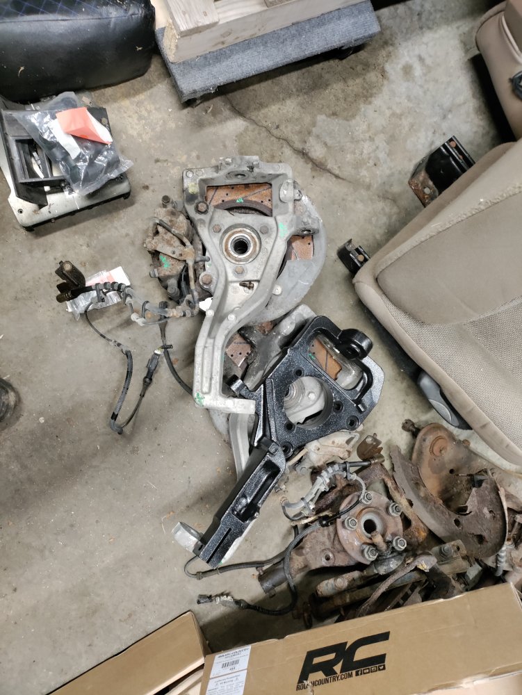

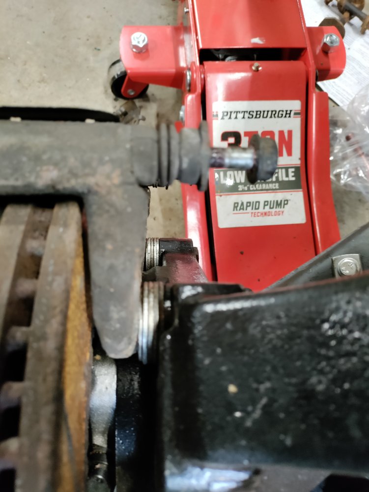

The 5 inch lift kit arrived this week so I'm ready to start putting it back together. Rough Country says an upgrade to 12" brakes is required so I pulled two knuckles from an '03 Explorer with everything attached to compare. Explorer knuckles next to the Rough Country ones make me think that if someone was inclined, they may be able to flip their tie rods and gain the same amount of lift as this kit. The diff drop hardware was really the only thing I care about in the kit. May be worth a try some day since I have the whole assembly now anyway. Both knuckles with all parts attached ran me $160 at the parts yard so it would be a dirt cheap lift option if so. Considering there were three Explorers next to the one I pulled with knuckles intact, availability seems high. Below is the RC +5" on top of stock 03 Explorer. They are offset in the picture for better visibility, but with the ball joint holes lined up they are very very similar.

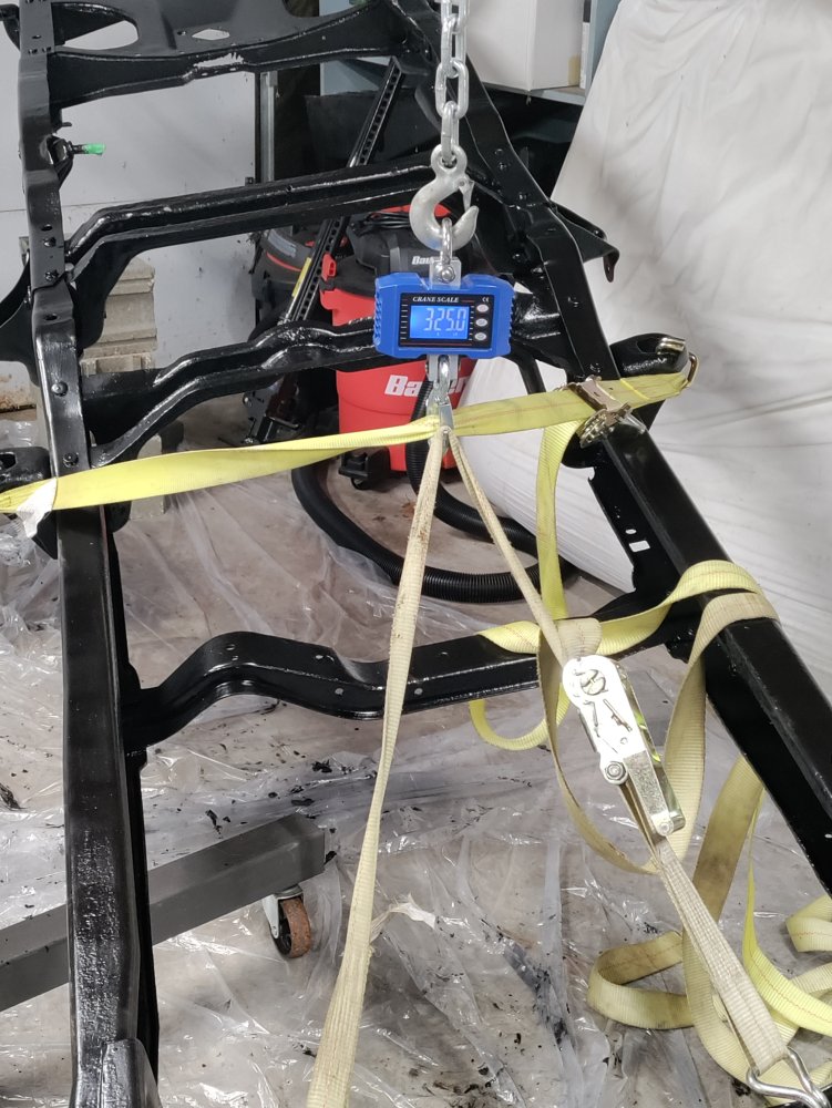

Lastly - I've always been curious how much an extended cab frame weighs. Knowing this ahead of time would've helped me adjust my expectations for moving it around without suspension. It may not have been born this way but after lots of rust removal it sits right at 325lb. Uncomfortable, but not the end of the world to pick up one end at a time if necessary, especially if you have an engine crane.

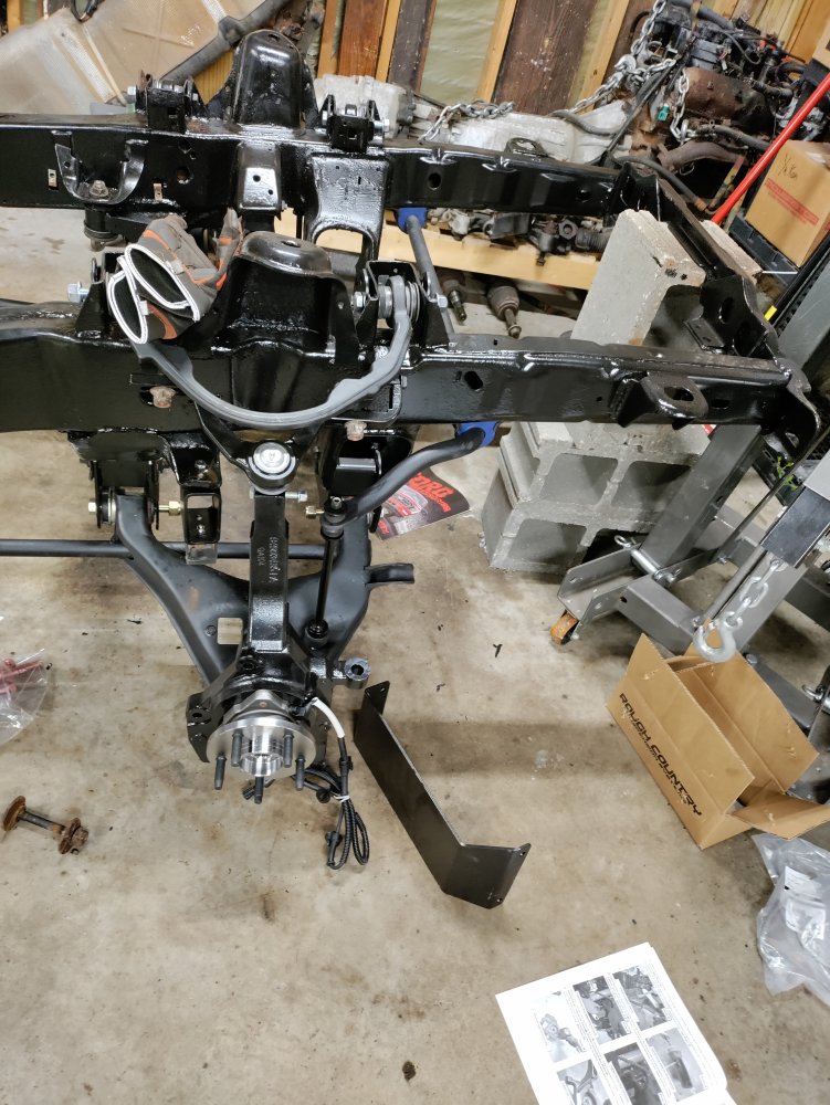

I've been taking advantage of the nicer days as much as I can and pushing forward. I have most of the front end pieces for the Rough Country 5" kit installed but unfortunately it took some time because there was hardware missing where I had to improvise. I'm not very impressed with that considering the cost of the kit. At least it was only nuts and bolts and not something more critical. In putting together the torsion keys though I noticed that my dampers or isolators or whatever they are called were toast so I had to stop and get some ordered. They seem to be a bit difficult to find but they're out there.
Pressing the bushings out of the lower control arms gave me all sorts of grief. I am lucky that the new bushings are fairly durable because I had to misuse my ball joint press pretty bad to get them replaced. I'm also lucky Harbor Freight released a ball joint expansion kit because without it I would've been lost with my standard pieces. To save money I am reusing as much original equipment as I can get away with so many items in the picture below are actually old but have been wire wheeled and painted. Rustoleum Hammered black is a pretty solid choice IMO. It's cheap and it dries extremely quick. As someone who really hates painting, I use it for just about everything.

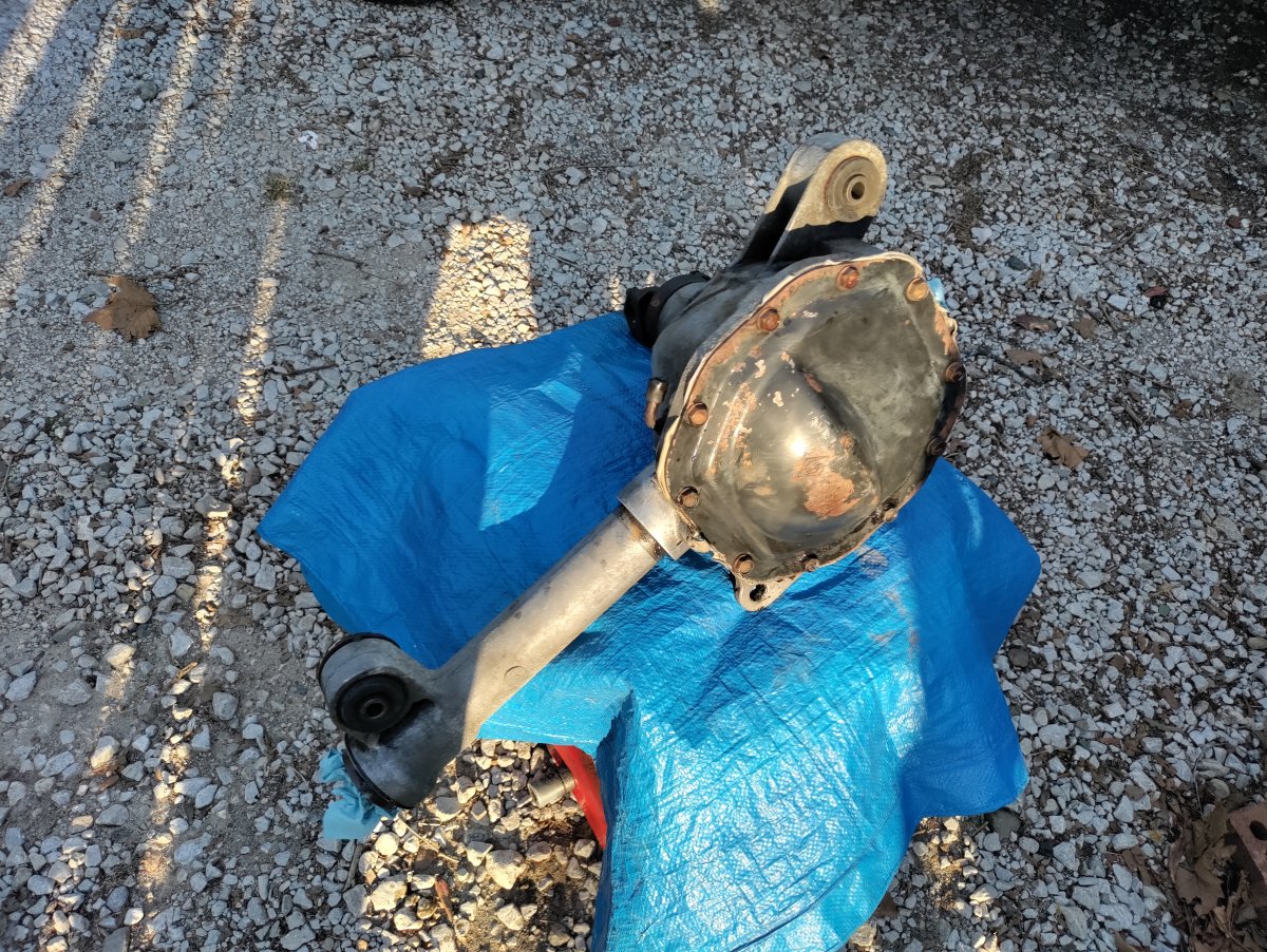

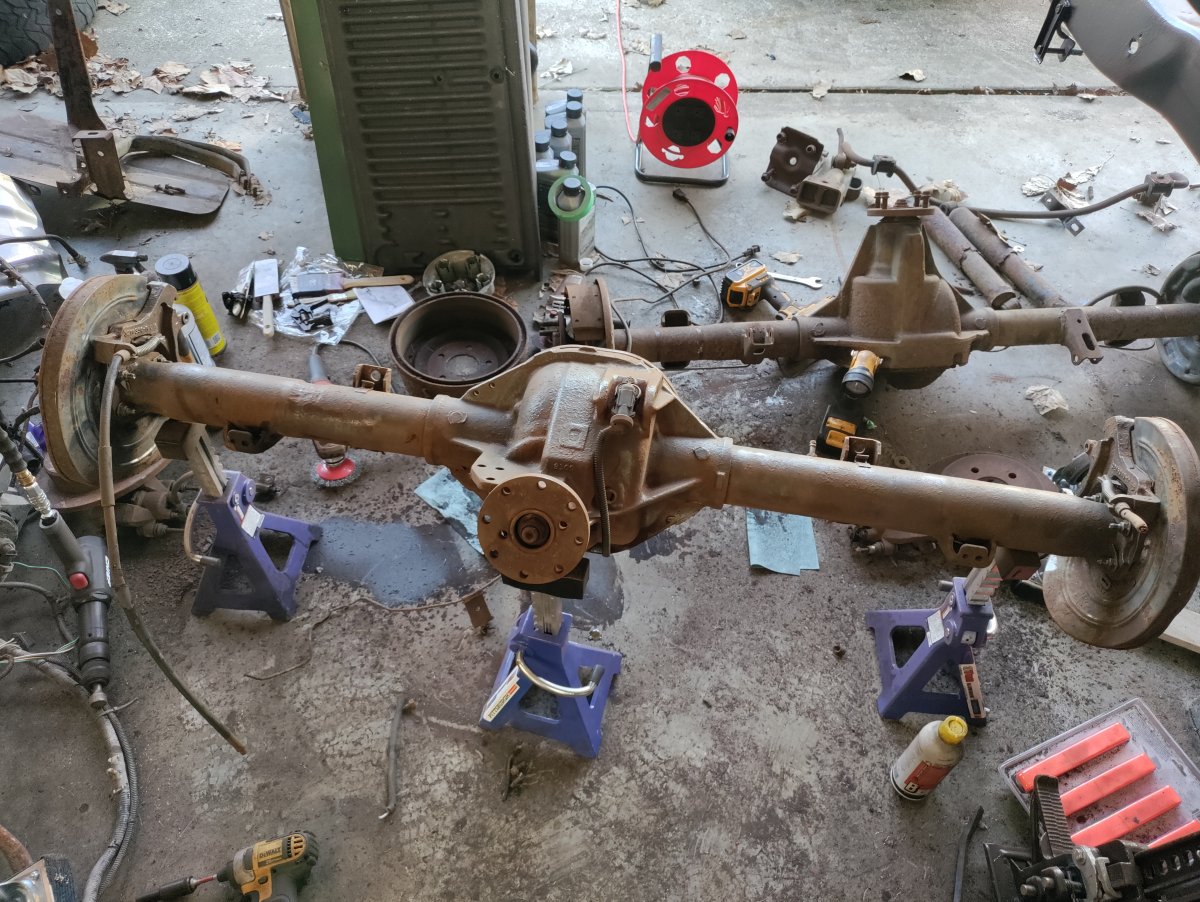

Two of the biggest items left for me were cleaning up the front differential and getting the rear axle converted to bolt up to a Ranger instead of Explorer. After an hour or so of scrubbing and degreasing I got the front diff "good enough" and slapped it with some paint. I tried to get some aluminum colored high-heat paint from the local Menards but it was the only spray paint that was sold out that day. I ended up with some silver extreme heat and didn't realize that it was metallic. Unintentionally I now have a glitter diff. Too late to go back now. There are extremely few results on google for "painting a front diff" and most people opt not to do it or just do the cover. I decided to full send and paint the whole thing and we'll see what sticks. Is there a reason nobody seems to paint aluminum? We're going to find out. Did I mention I hate painting? As a side note: I've googled as hard as I can and haven't found anyone local who does blasting and powdercoating to make it worth my while to drive to. I would love to have these pieces done for me and I hate painting enough to pay for it. When I was calling around for the frame to be powder coated, the most likely place to do it said they were on a 3 week waiting period that started when I dropped it off and I can't get in line before then. I hate waiting more than I hate painting and since that left a bad taste in my mouth here we are with a glitter diff. From here on out I'm going to say it was on purpose. I'd also like to point out that while I intend to baby it while in 4wd, if I ever decide to give it the beans I imagine I may blow up the front diff which is why I'm not being very kind to it, just like I imagine the first 200k on it weren't.

While I wait for parts to come in I'm going to work on the Explorer axle and get that prepped and welded with new perches. To help anyone in the future, I've pictured the two right next to each other to compare. I got mine off the Facebook Marketplace and I believe the guy said it was a '99 Explorer 4.10 (on dollys) vs my original (on the floor). I was worried the Explorer would be a little wider but that doesn't seem to be the case. I am extremely excited to finish up the suspension and get this sitting back on the ground. Once that's done I can place the drivetrain again. Since I've already made the mounts it should go in quickly. Since pretty much the whole interior and exterior of the truck is laying in parts on the garage floor at the moment, the more I can complete, the less time I spend tripping on things and carefully maneuvering the tools I need around it all.

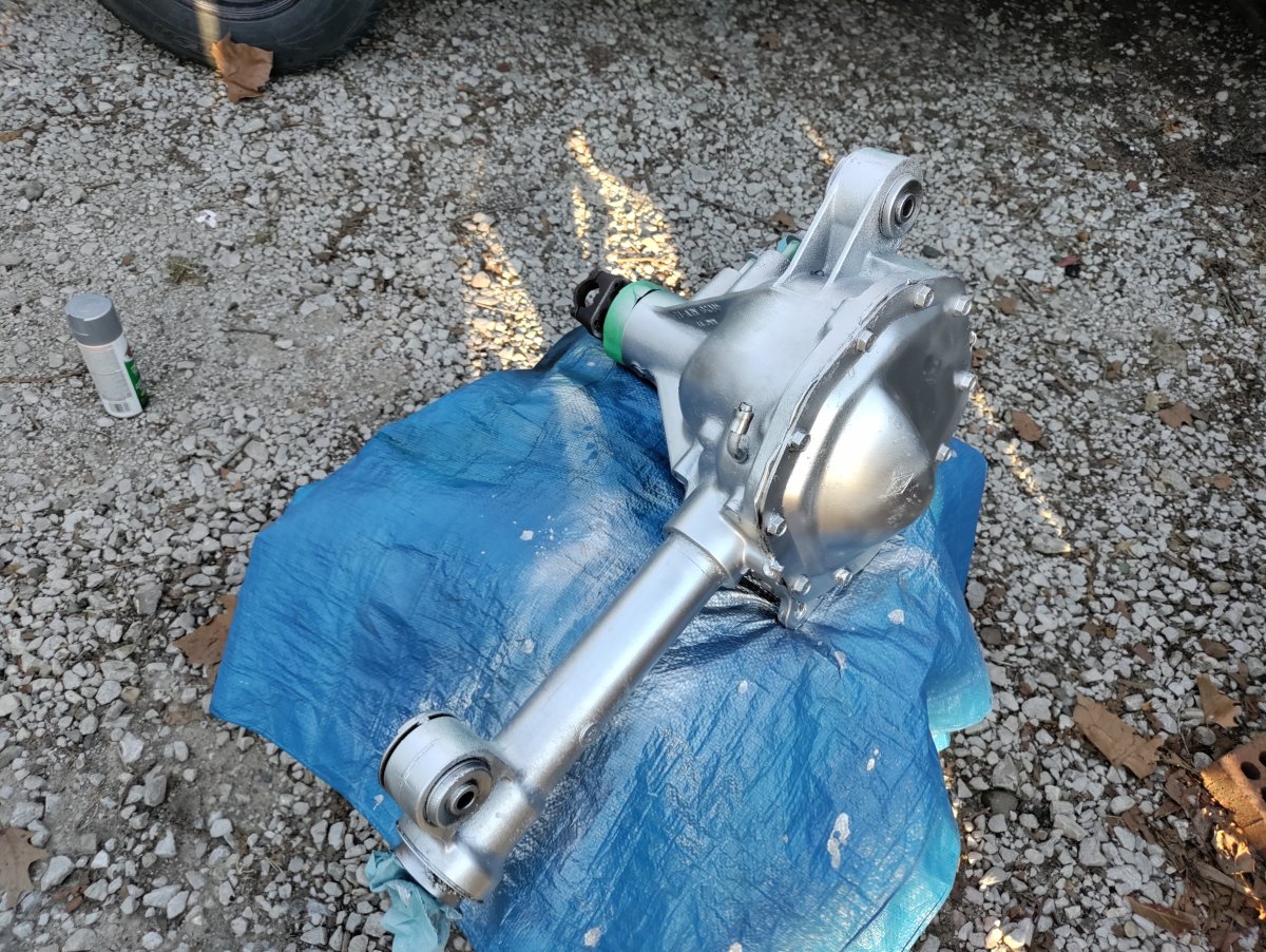

Boost Bucket, has anyone told you that glitter diff looks fabulous? :LOL:
Seriously, people paint aluminum, but they tend to use a color that looks like aluminum (silver or silver-white). Any color will work. Aluminum should not be left uncoated or unpainted. It isn't the corrosion-proof lightweight miracle metal some people seem to think it is.

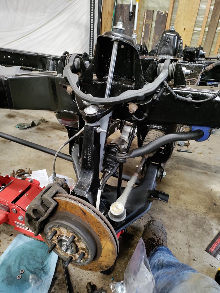

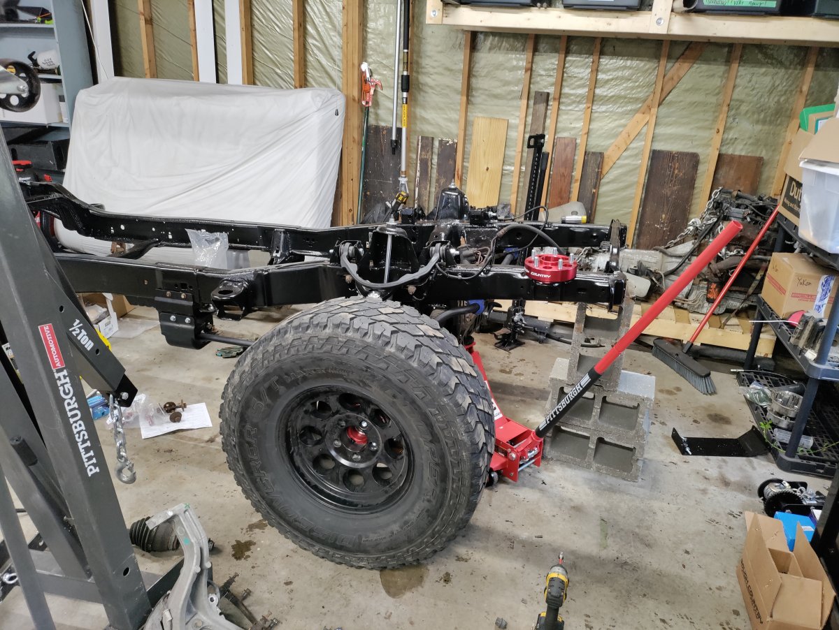

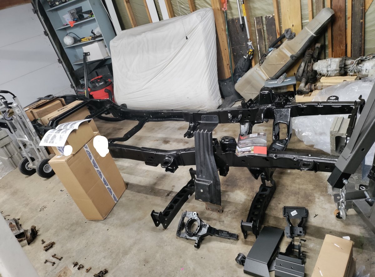

It took much longer than I anticipated but I finally completed the front suspension.

I was going to let it go but after several more issues with the Rough Country 5" kit, I have to say not impressed is putting it mildly. While I appreciate the kit being on the market still, the ease of installation is trash. Case in point is the custom front diff cover they include in the kit which I was excited to have. The bolts for this go into threaded holes on the front crossmember and the holes were gored so bad that trying to run the screws in stripped the screws of their threads. I actually had to run one in backwards to attempt to clear the threads since neither of them can be started from the other side. I've never seen anything like it. Since it's the first piece of the kit that goes on I can't really get to it anymore to drill it out without removing the axles and diff.
Putting in the steering rack it became clear that there is no access to install the nuts that hold it on through the new crossmember. The original crossmember had specific access holes for these. If my hands were any bigger at all I wouldn't have been able to get my fingers past the control arm bushing to start the nut onto the threads. Had this been totally impossible I would've had to take the entire front end apart to get to it....or more likely got out the sawzall to make my own access point.
I'm not sure if it's something I've done but I'm going to also blame the kit for having misplaced offsets on the spindles for caliper brackets. Since the kit specifically calls for 12" brakes up front from an Explorer, I was surprised to find that the caliper brackets did not fit. Neither did the originals. By my count, the spacing was off by 10.5mm which is not an insignificant amount. I had to buy longer bolts and stack washers 5 or 6 deep to make up the difference. In the end I got it to work but I couldn't believe how far off it was. Other than that though the Explorer brakes went right on. Time will tell if a hard stop shears off my whole front end.

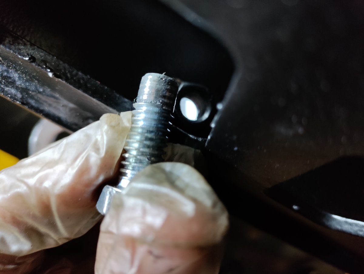

My last complaint so far is back to the lack of hardware. My kit was missing some nuts and bolts and I think I am up to trip number 4 or 5 going to the store to get them. One of my hardware bags was ripped which might indicate that items were lost in transit, except that the boxes were very much sealed. These items were never boxed. Additionally, after making my way through the instructions I feel that in several cases where they say to "reuse factory hardware" is good in theory, but many of my factory bolts broke in half on me or were otherwise rusted to death where it would've been nice to have some included in the kit.
With all that said it is complete and I'm over it. It was a $1000 kit and honestly if I did it again I'd feel bad paying more then $400 due to quality. The last kick in the pants after hours of struggling and multiple trips to the Rural King was that the factory Ford lug nuts were too large to fit the holes on the wheels I bought. Despite this I put one on anyway to see some much needed visual progress.

After all that, I am back to waiting on parts. I cleaned up the rear axle and it seems that in my haste to find one I didn't notice that while the gears seem ok, pretty much the entire rest of it needs reworked. At least three studs are broken off, brake lines and hoses are toast, the brakes themselves need completely replaced, and I've got to place new spring and shock mounts to go from the Explorer config to Ranger.
