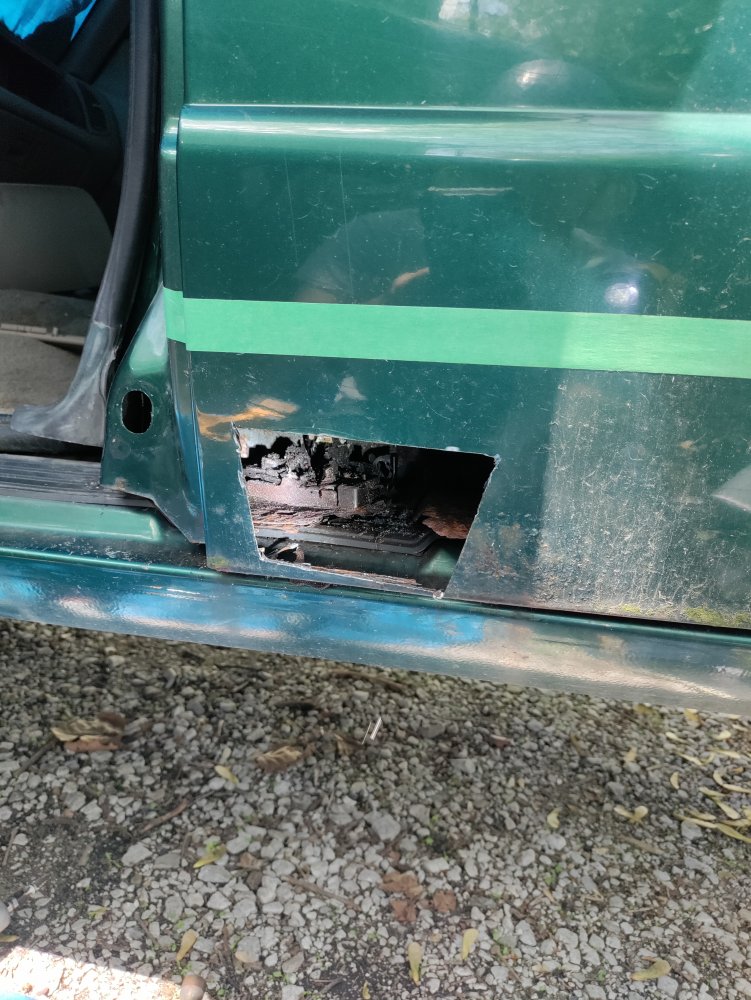

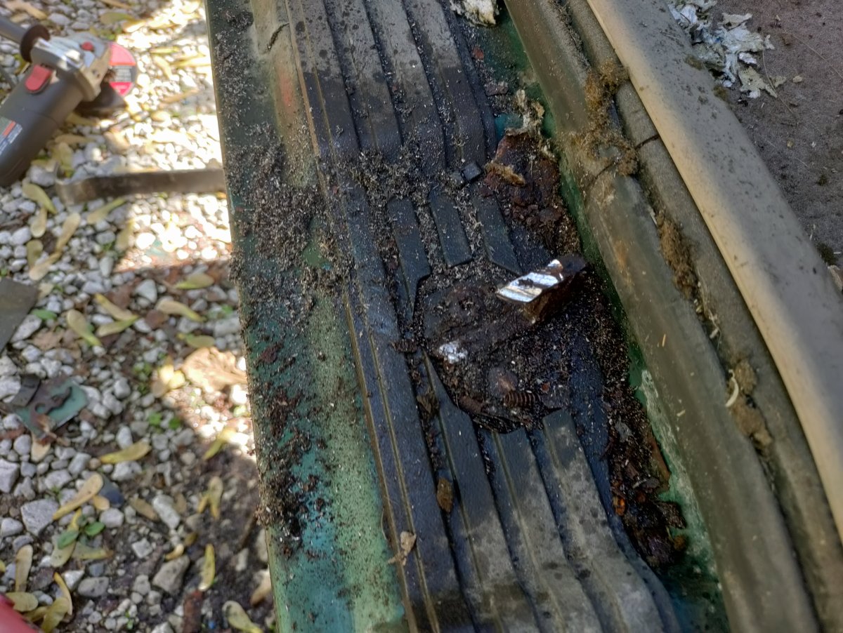

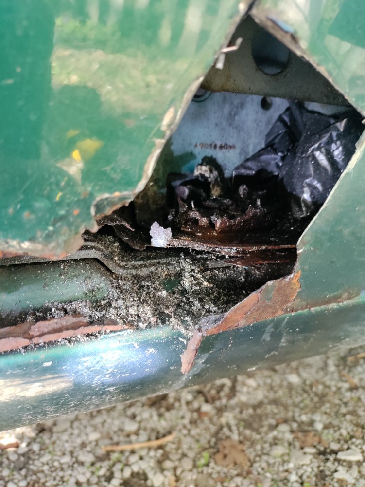

Next, I started on the back doors. With the truck not in great condition to start with and then having sat for probably years, I wasn't surprised the bottom latch on both sides was seized. Believe me when I say I tried everything I could think of and then some to get them free. The last time I handled one of these, some PB Blaster and a mini sledge did the trick, but no luck this time. After hours of searching around online for any hints that applied here I ended up deciding that caveman brain was the solution. Since the bottoms of the doors were already shot, I decided to just cut the hole bigger on each side with an angle grinder and then sawzall through the entire latch assembly, including the bolt. It ended up being so seized that the bolt was stuck in the clasp even after it had been sawed completely out of the door. I did this for both sides.

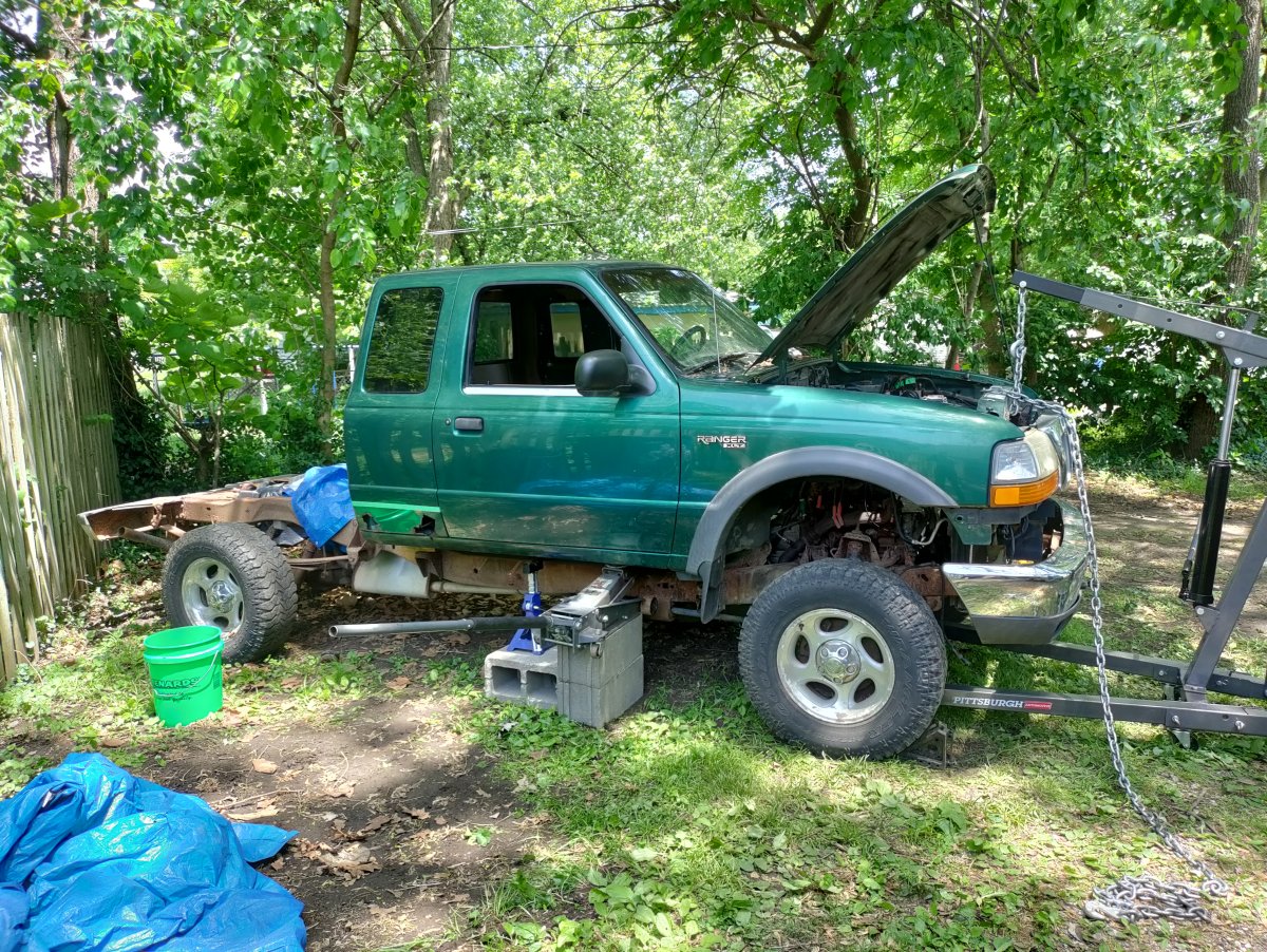

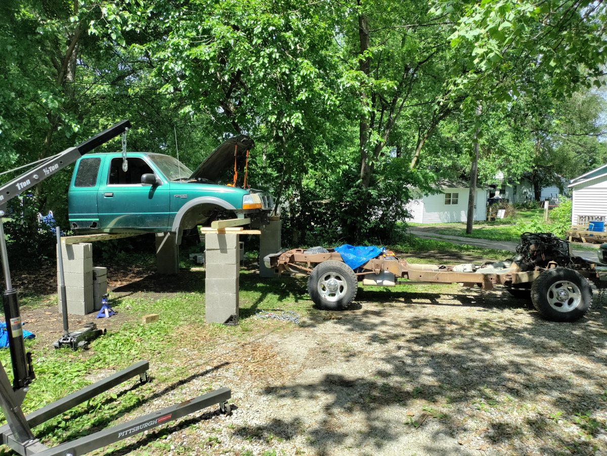

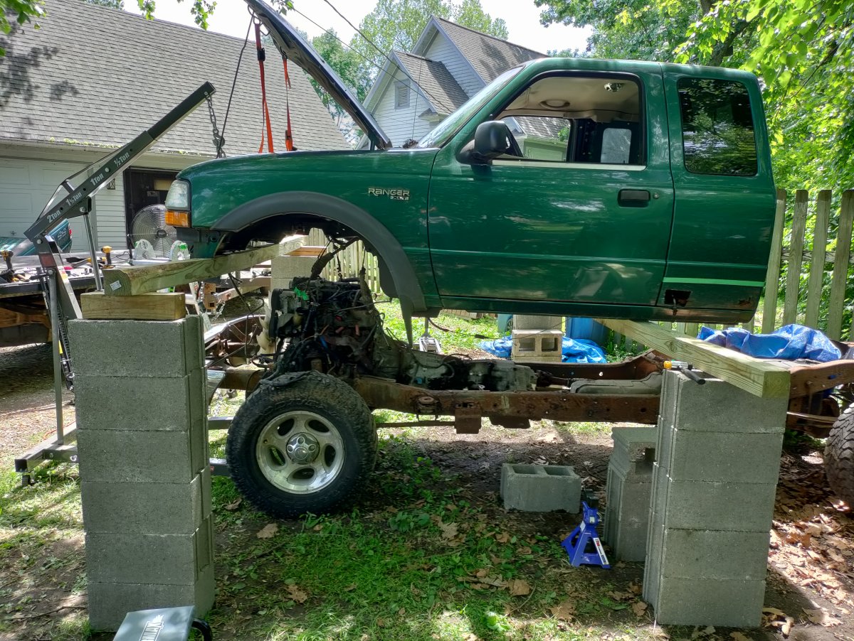

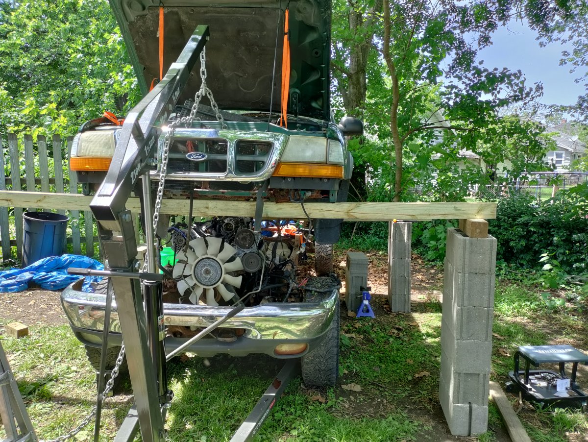

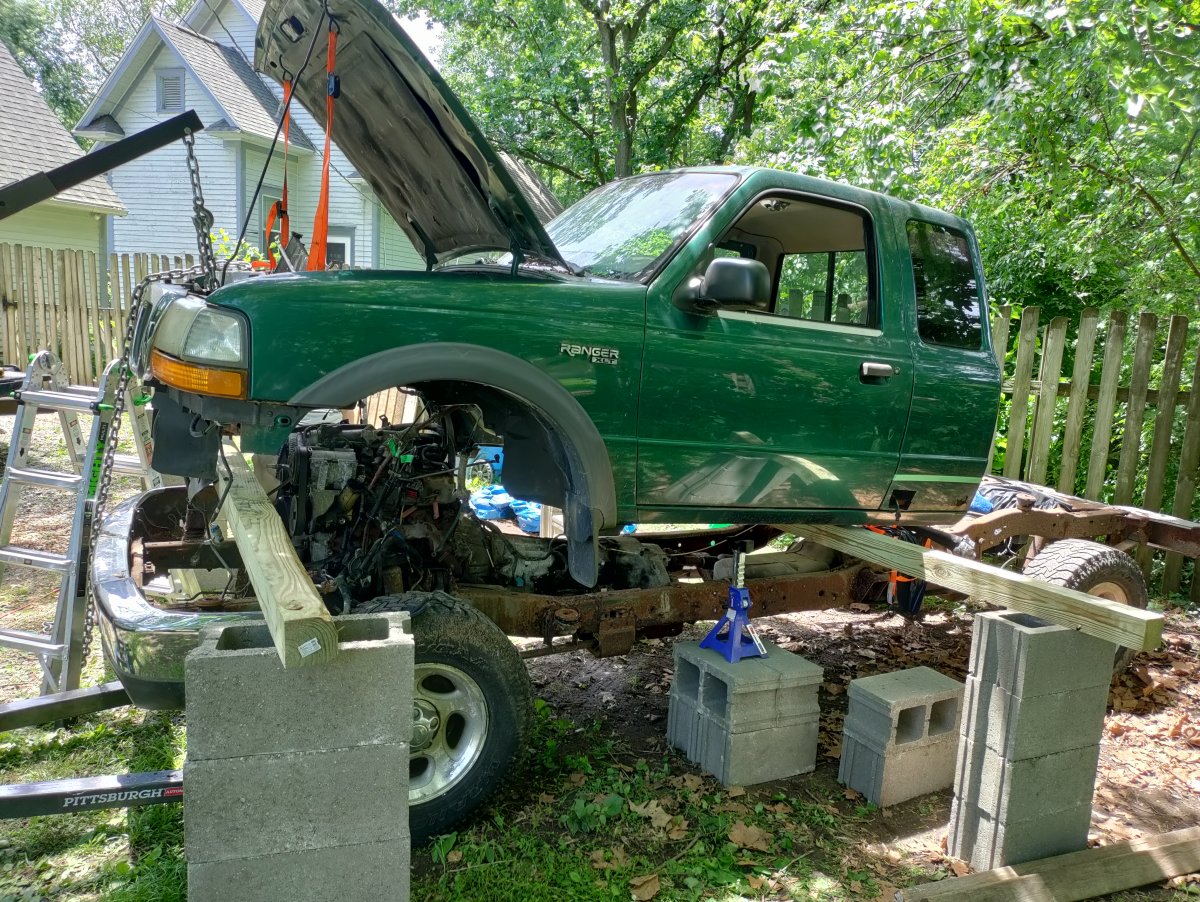

Next step for me was to pull the engine out. I was still on the fence at this point whether I was going to just do the swap and be done with it or if I wanted to pull the whole body off and do it right. For me the decision was made when my breaker bar rounded off the final exhaust bolt I needed to get the engine lose and simultaneously drew blood and peppered my face shield with rust. Since I had the engine disconnected at this point I used a chain and steel bumpers to drag it across the yard to a better position.

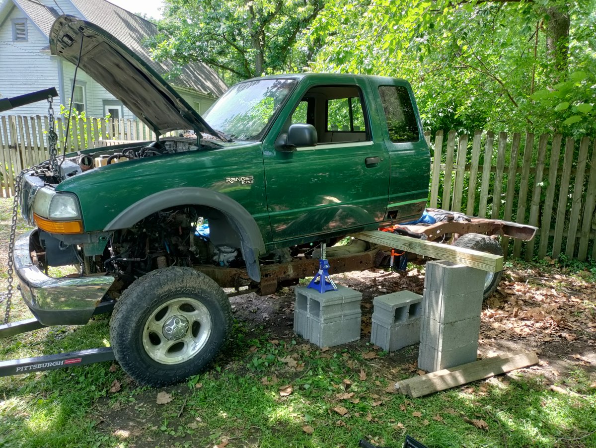

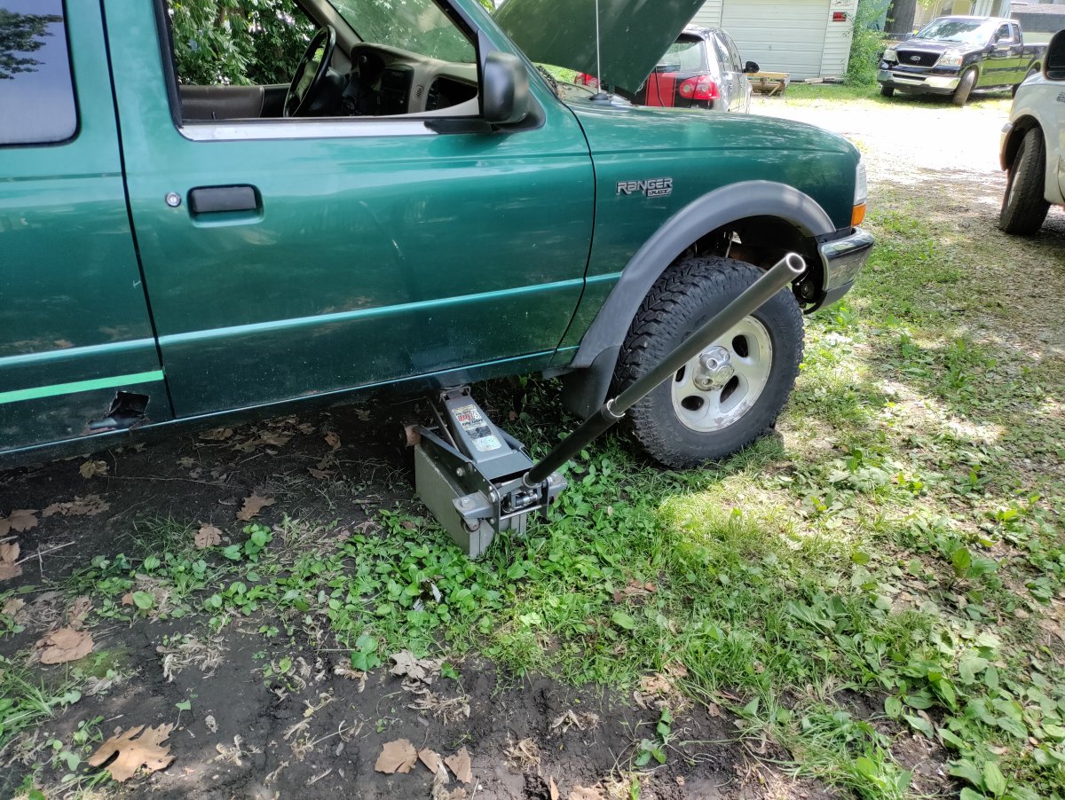

For the next party trick I did some careful planning and found the I would need to raise the cab about 4 feet if I wanted to get the frame with the engine still in it out from under the body. Since I don't have access to a lift or really any upward room in the garage, I decided to do things a little differently. I spent about $95 on 2 12 foot 4x4s (AC2 Green Treated were the cheapest they had) and 30 concrete blocks at the local Menards. I decided that now was the time to finally invest in a farm jack since it goes more straight up and down than a floor jack that wants to roll. I went with 12 foot 4x4s because I wanted to clear the fenders on my trailer and set the body down on it later.
After I unbolted 3 body mount bolts and cut the other 3 in half, I used a floor jack on a concrete block to being to raise the back half of the cab. With the extended cab it did seem to be pretty front heavy with the center of gravity being close to the dash. I did remove the whole interior except for the dash before I started to reduce weight.
Once I got up too high for the jack, I added more blocks.

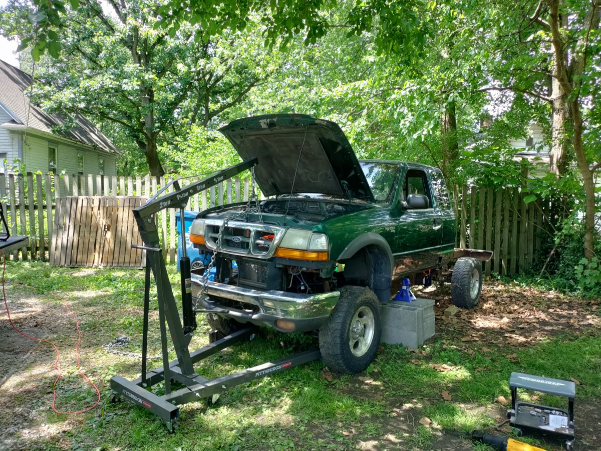

This is about the time I realized that if I used the engine crane on the front end it would stabilize the load a lot better and mean I only have to manually lift the left and right side of the back of the cab instead of all four corners. I wrapped a chain around the hood latch area and used that to lift. In my case it was a little sketchy because that whole front piece is pretty rusty so your mileage may vary. I wouldn't recommend getting under the cab when it's lifted for any reason so I made doubly sure everything was disconnected before I started lifting. Also, if you're rednecking it like me and have to use the engine crane in the dirt, I recommend putting it on a sheet of plywood if you have it or planning carefully so that it doesn't need to roll as you go up.
Keep checking for anything you missed before and for clearance and keep going up!
Eventually you'll make enough room to slide one of the 4x4s underneath. Again I used 12 foot and spaced the blocks wide enough to get my trailer under it later. The wood did bow a decent amount but it didn't seem close to failure. I definitely wouldn't try this with anything heavier at this length. This is also the point where I was able to switch from floor jack to farm jack to go up straighter and faster. The "lip" of the jack cradles the 4x4 perfectly like it was meant to be.
Then lift the front a little higher and do the same. It isn't strictly necessary in this setup to have the front 4x4 in place yet but it's a little piece of mind if the chain wants to slip for whatever reason.
Eventually it is high enough to clear the engine.
I did use a die grinder to grind off the head of the bolts holding the front support since those were also rusted in place. This reduces the amount of required lift significantly.
Since I would be pulling the frame forward, I made sure there was enough space even with the wood bowing to clear the throttle body. I think it goes without saying but I would not recommend doing this on a windy day. You can get a good look at how rusty the front end is from the shot below. I didn't even have to remove the two body mounts because the mounts had already rusted off of the cab itself.

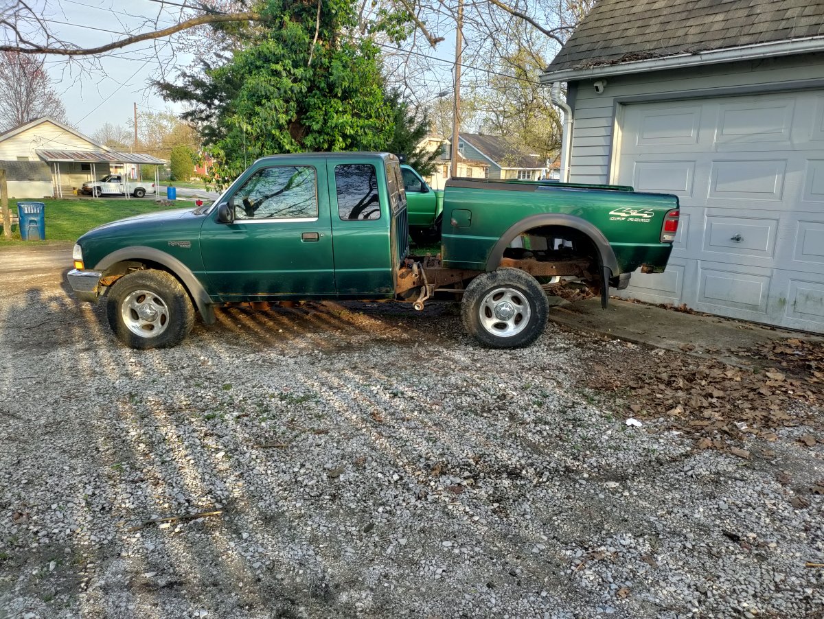

Then it is just a matter of pulling the frame out with a chain again! I should also mention at this point the transmission was in park. My plan was to disconnect the driveshaft and then pull. Turns out I only had a 6 point 12mm and this required a 12 point so that idea was out. I didn't feel too keen about getting under this disgrace of an operation at this point anyway. This may make some laugh but even with the transmission right in front of me I didn't know how to manually shift it into a given gear. Google wasn't my friend in this case either because who really takes the time to explain something like that? I ended up grabbing where I remembered the linkage connects to the transmission and clicked it one click to the left as I was looking at it. I could see the wheels immediately release tension and knew I had put it in neutral.

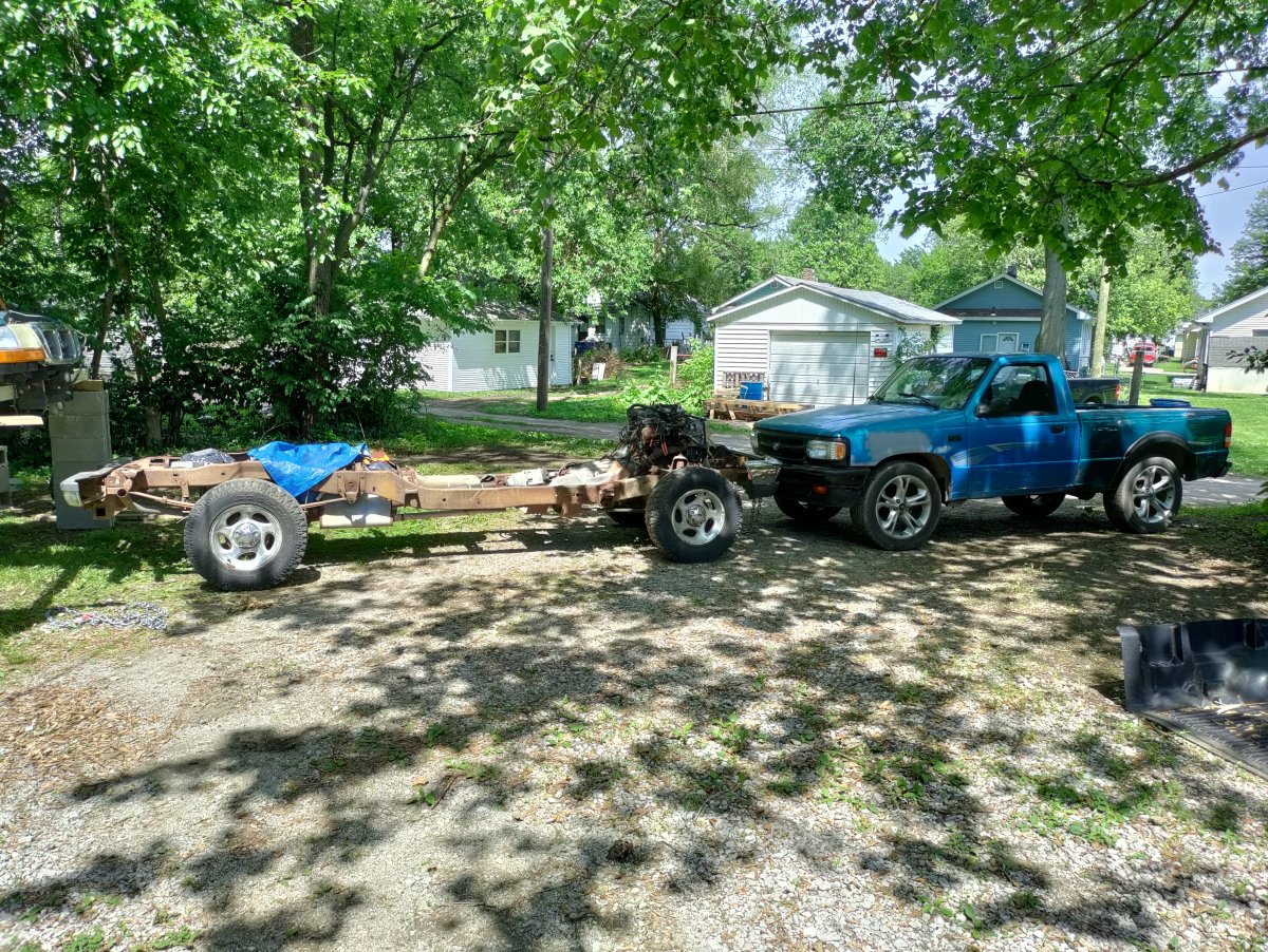

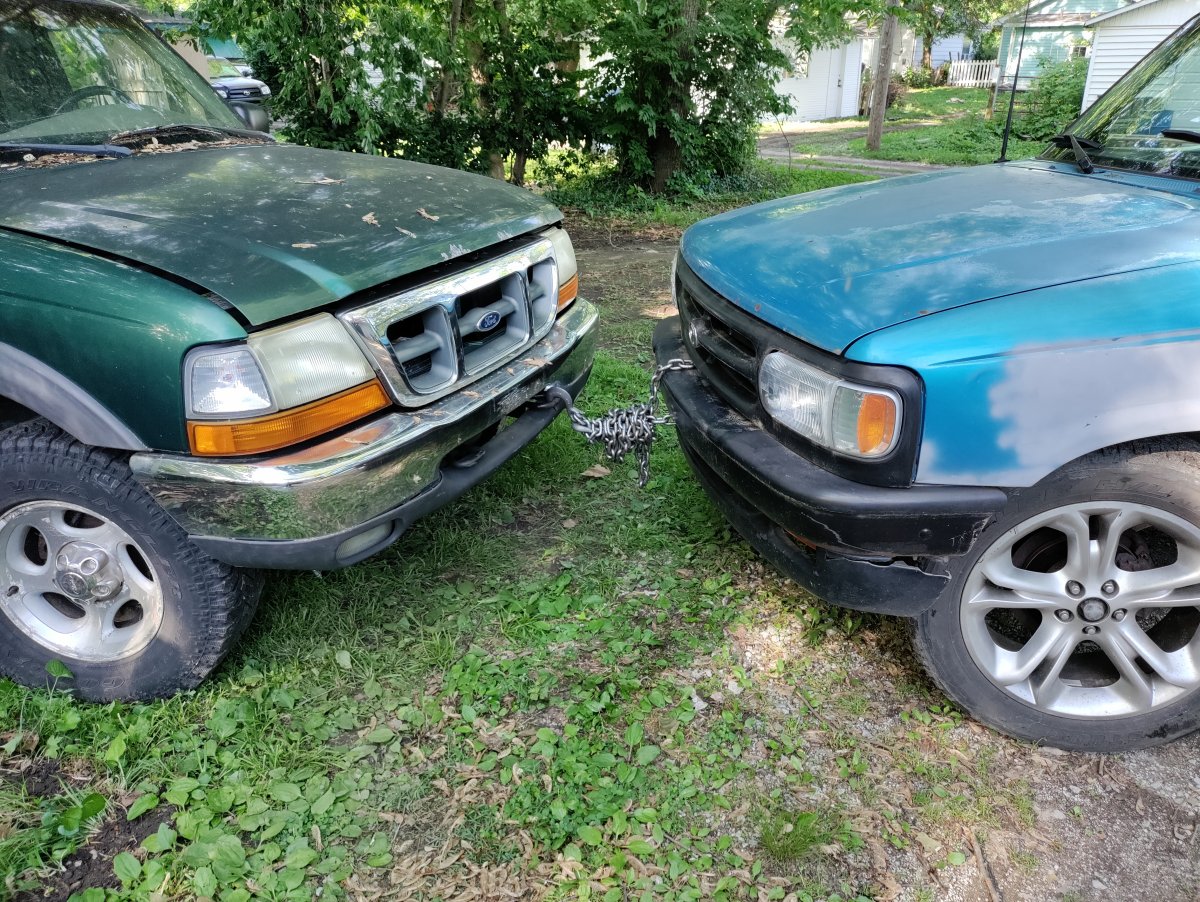

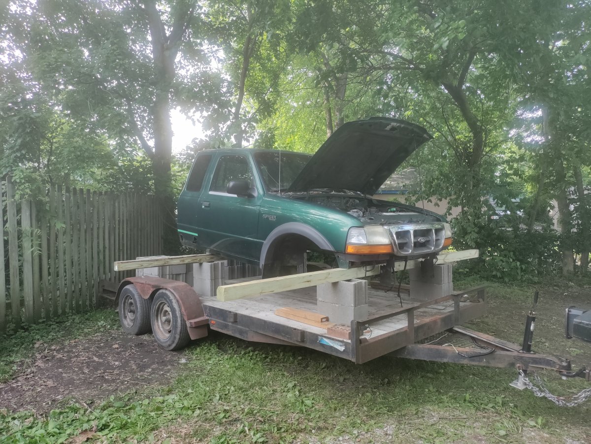

The next hurdle for me was how to get the chassis to steer. I figured I could just stick a socket on the steering box and turn it with a breaker bar. Turns out with the frame pulled out I could get a good look at the shaft shape and it was essentially a triangle. Again I've never welded before so I couldn't just make something that shape on the fly. To my surprise nobody seems to make a 1/2" socket for this shape! What we ended up doing then is using the Mazda as a wall so it didn't roll down the hill and picked up the rear end with the engine crane with the pintle hitch again. We rolled the crane as far away as we could perpendicular with the bumper and then lifted. This pulled the back end toward the crane as it went up. Then once it was fully in the air we set it back down, moved the crane slightly, and did it again.

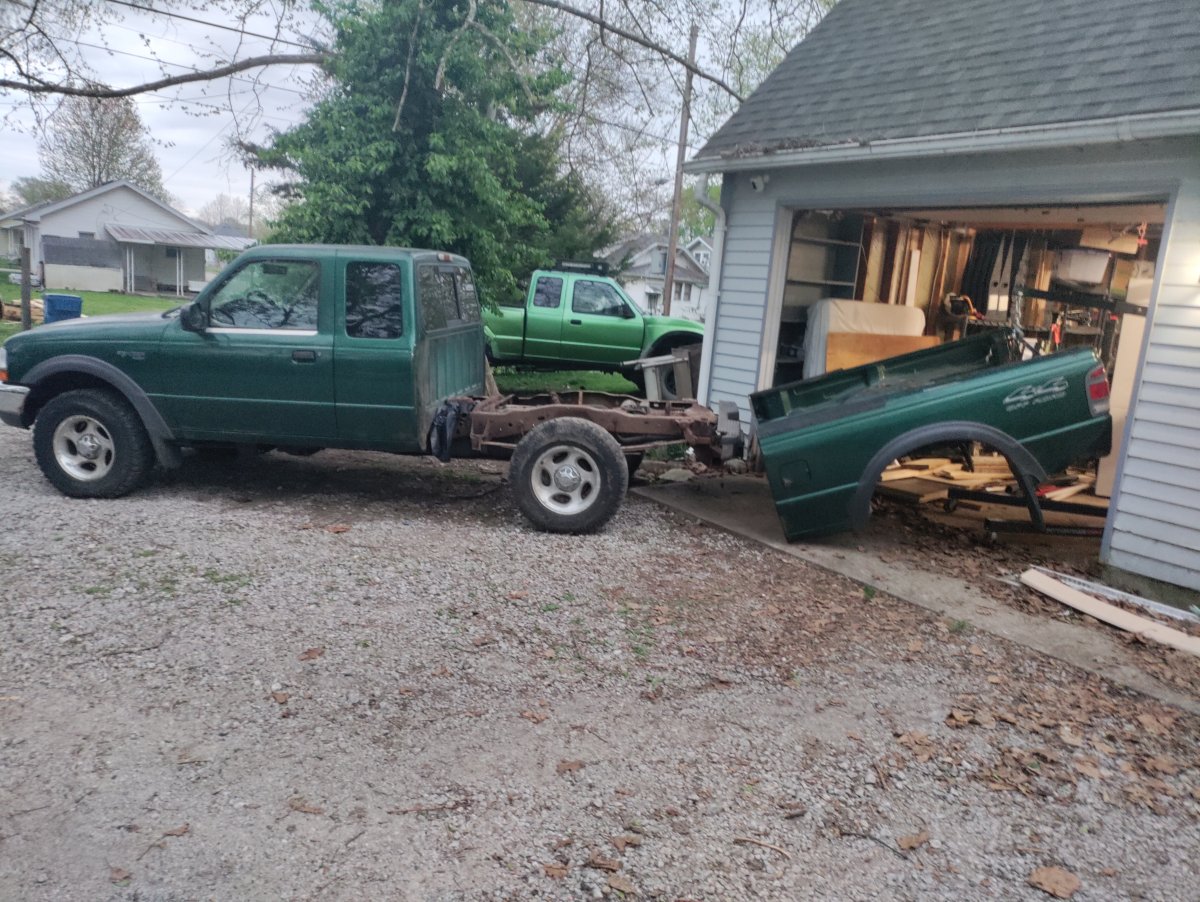

About a half hour later the back end was where I wanted it and since the front stayed in place, the wheels had turned themselves. I imagine this is probably hell on the steering box but I didn't have much of a choice in the moment. Then I just pushed it back up the hill with the Mazda. Steel bumpers made this a breeze.
Finally, I backed my trailer under the body and set it down so that it's not just hanging out in space. I'm not sure what I'm going to do with the body while I work on the frame but this makes it easy for me to move around if I have to. I set the concrete blocks directly under the body so that the wood is not doing any free standing support while it sits. If you're in a windy area you may consider strapping the body all the way down even if you don't plan on moving it.

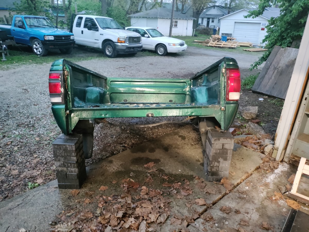

That's the build so far! I've separated the truck into 3 pieces and now I'm taking measurements as I have time to try to plan how I'm going to do engine mounts and get it to fit in the bay. I don't want to bother with cleaning up the frame until I have the locations planned out. If anyone has any hot fitment tips or would like to ask any measurement questions about the old engine or the new, now would be the time!
since you mentioned possible not re-using the bed, what state are you in?
great pics, backyard engineering at it's finest. :icon_thumby:

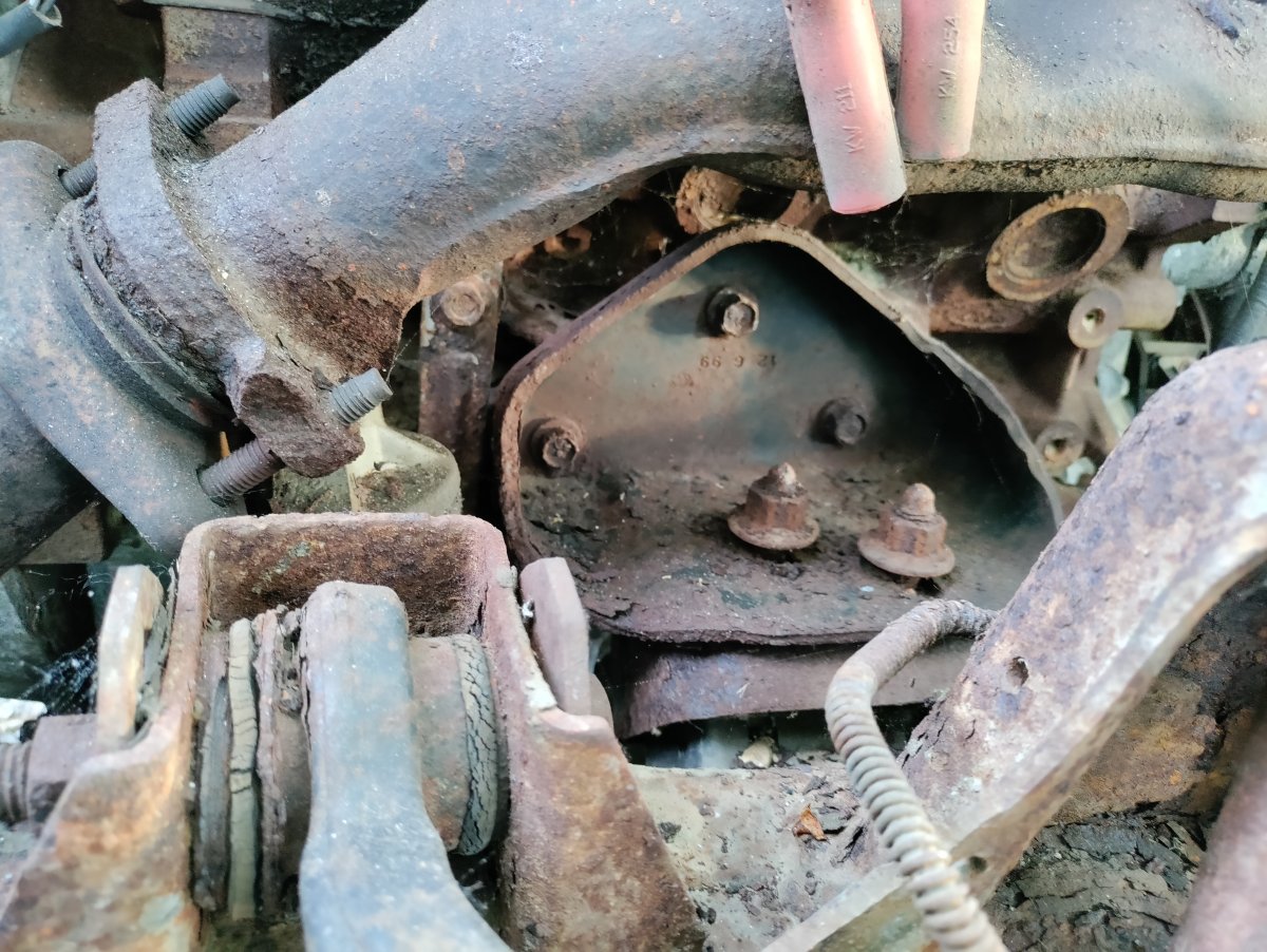

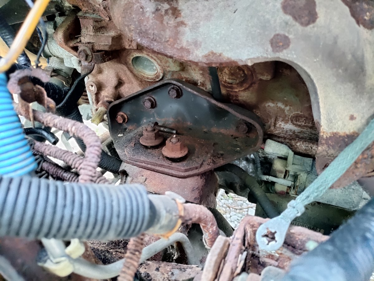

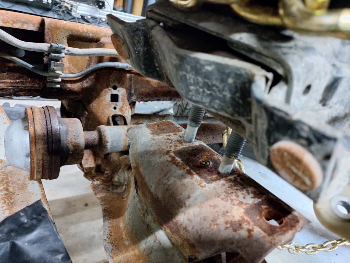

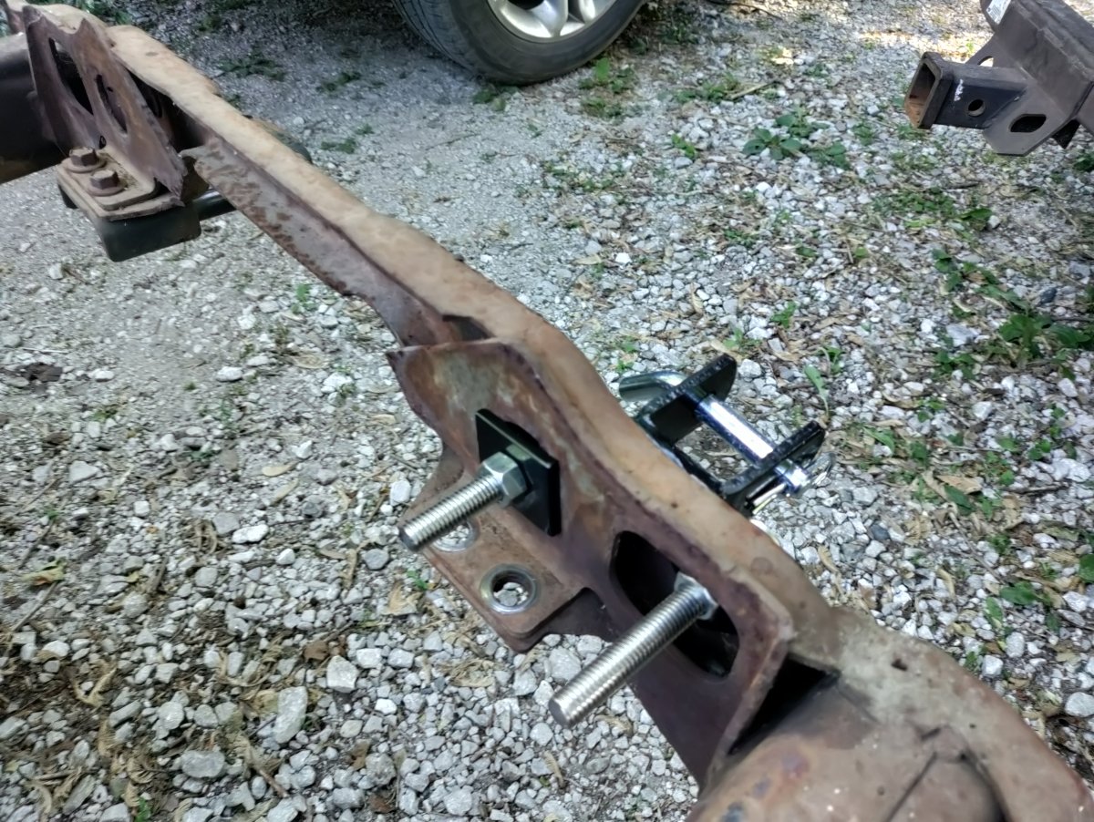

I must have missed a cutoff because my mounts and bolt locations don't seem to be even close.
Driver side:
2000 Ranger 4.0 to 2.3 EcoBoost Swap
Passenger Side:

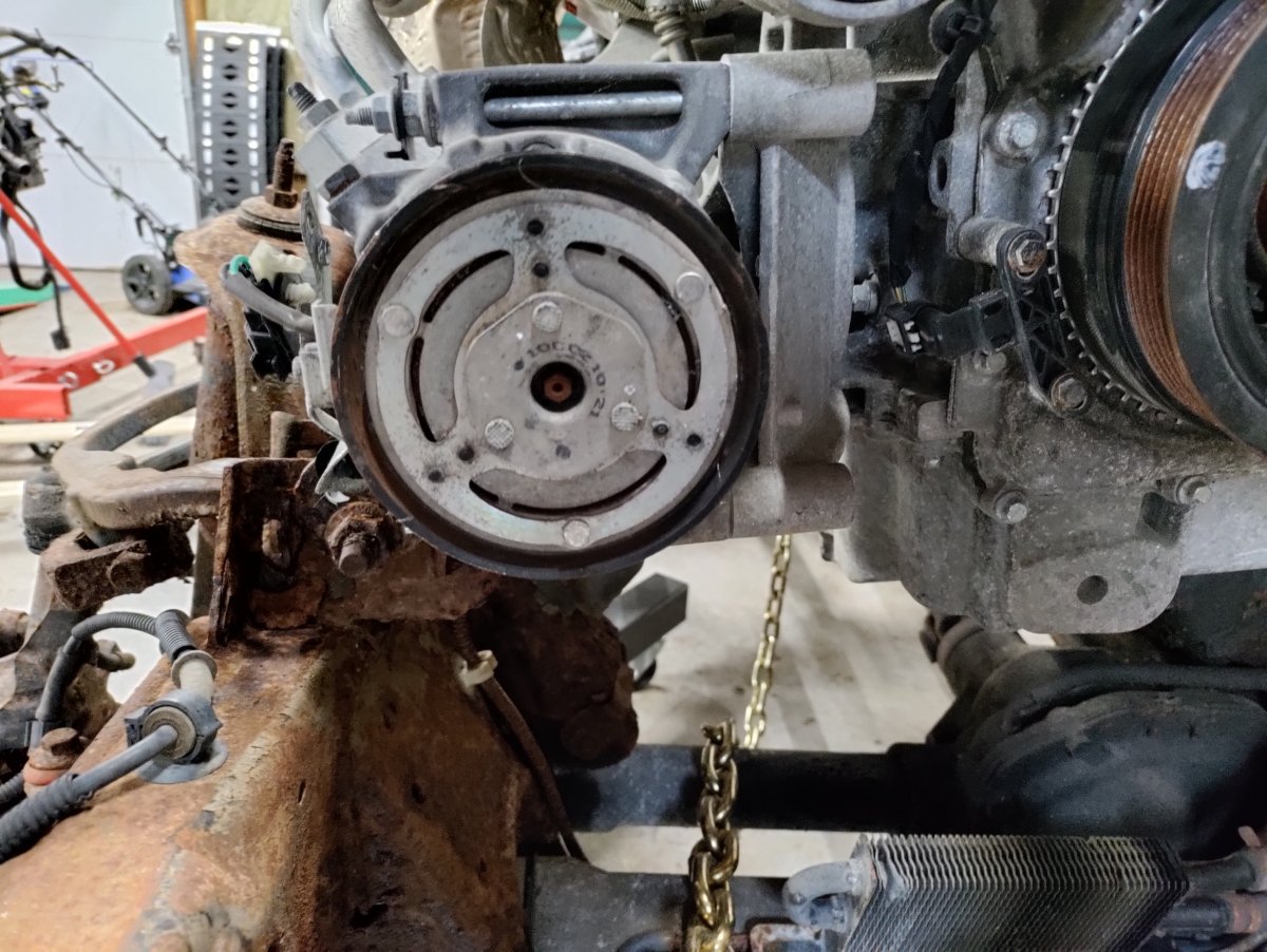

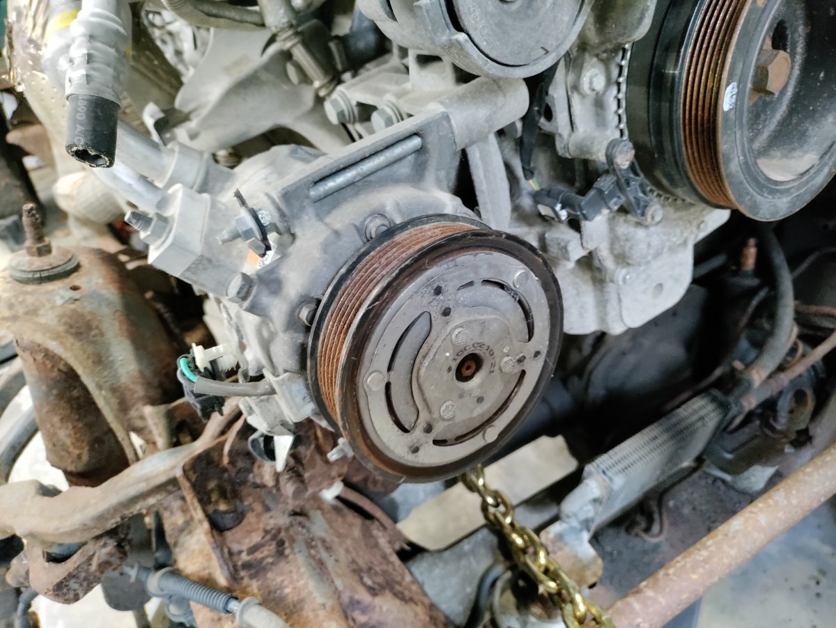

The AC compressor is going to be very much in the way I think for fitment between the frame rails, even if the mounts lined up well. I'll get a little more detailed on measurements when I figure out the best way to do so.

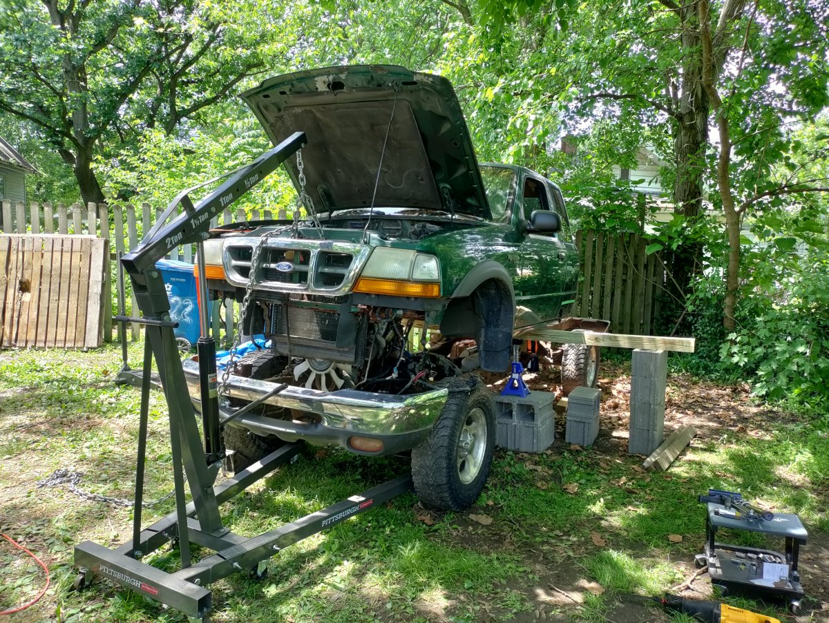

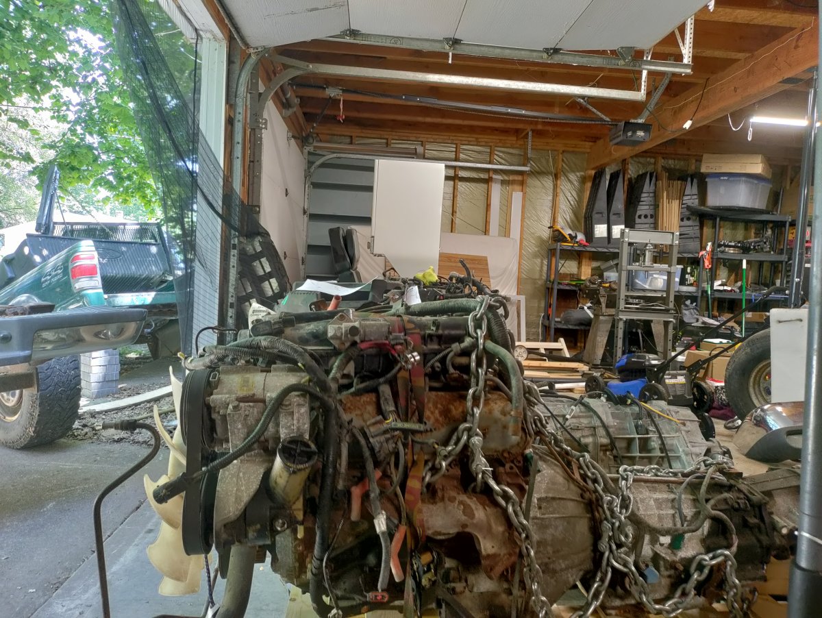

Update: it's been far too hot the last couple of weeks in my area to be working outside on this but I'm making progress again.

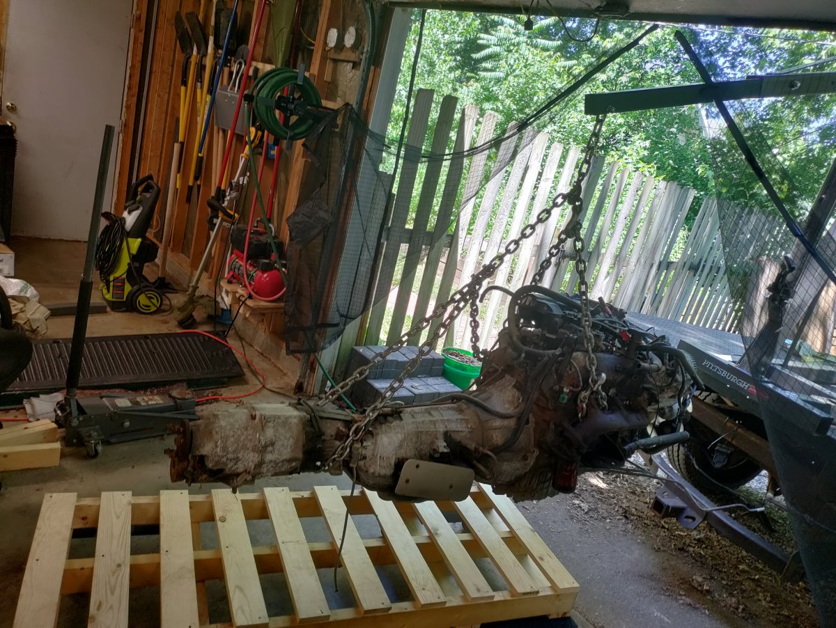

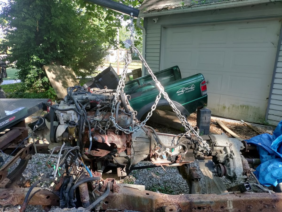

I wasn't able to find a good way to take precise measurements with the engine still in the frame. Since I've already had one attempted theft on the 4.0 I decided to pull the drivetrain and take measurements after. Because of my setup, my two issues were that I needed some sort of modified engine crane setup to pull the drivetrain in the gravel, and I also needed to move the frame out of my way to get it into the shop.

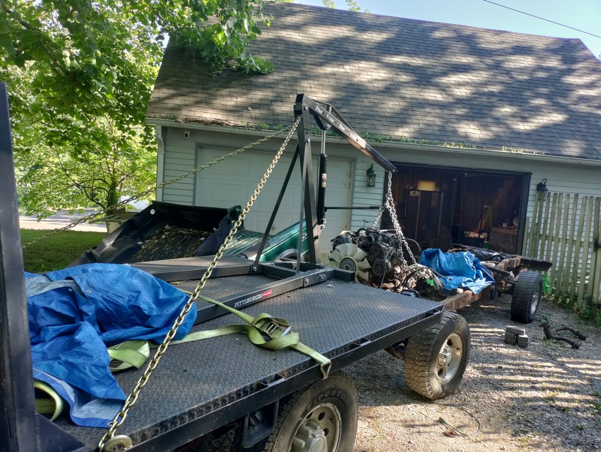

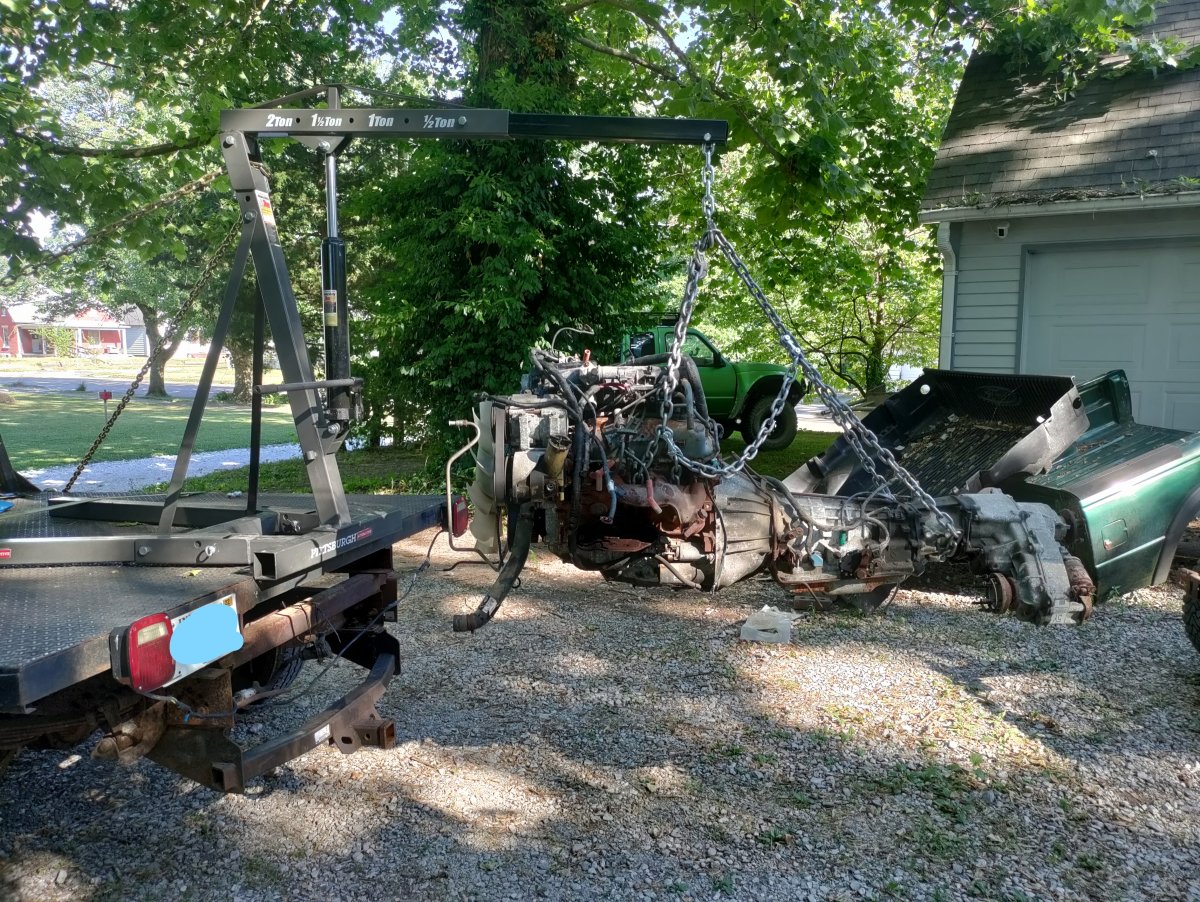

It took several iterations but since I didn't have a load leveler I used a length of chain in various spots and settled on what you see below. I have it wrapped around the center of the exhaust manifolds and just behind the transmission mount. I had to grab it closer to the back because it kept wanting to tip backwards. As shown it holds level in the air.
I ended up taking the casters off of my crane, flipped the arm around, and strapped it to the flatbed to make it mobile over gravel. I did have to drill a couple of new holes to accommodate the new spacing for the support arms but I didn't have to use any new hardware which was nice. I did have to buy another chain though for the top support because the bottom strap and a top strap did not seem adequate for the tipping I was seeing.
This setup ended up working very well and self leveled with the chain placement. Maybe someone else would be more bold but as-is it felt like we were testing the limits for weight in that last 1/2 ton adjustment hole.
I honestly wasn't sure that that was going to work so I ended up putting it in my truck bed while I figured out how to move the frame.

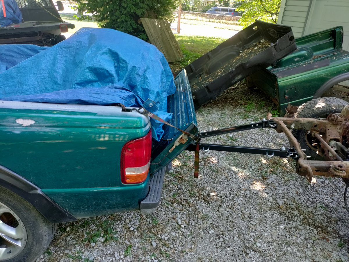

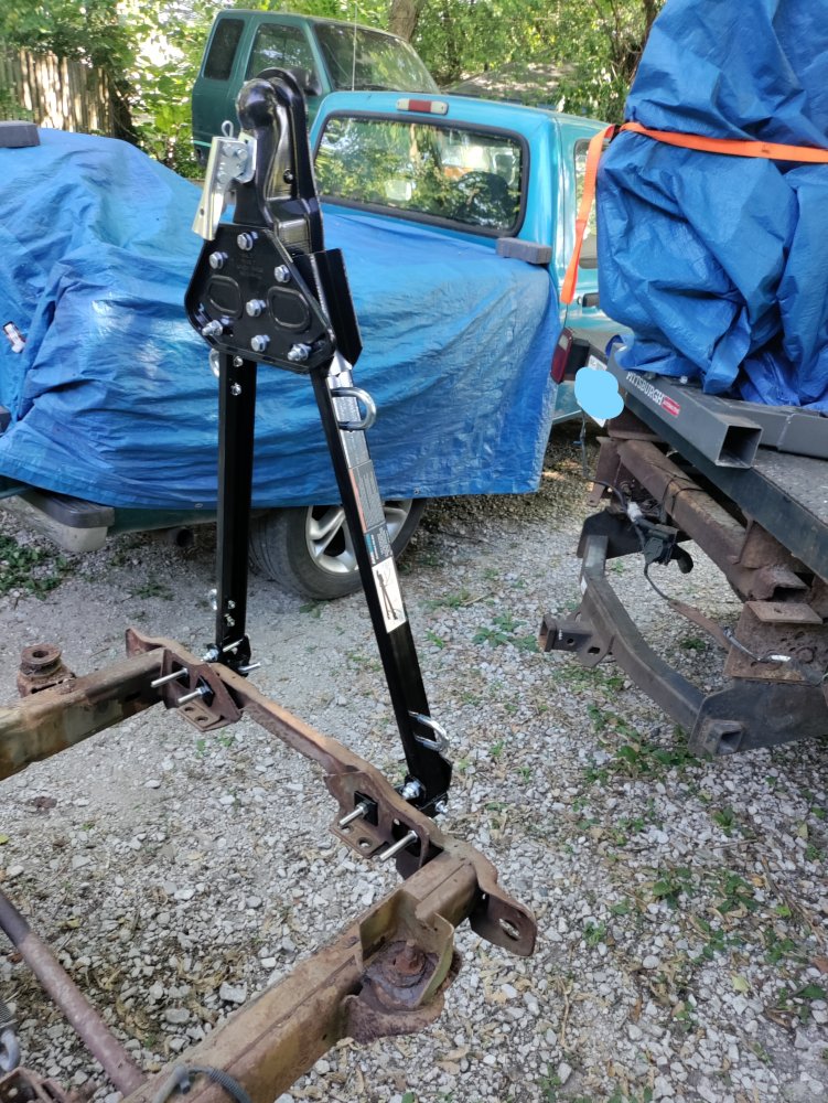

I picked up one of those cheap tow bars from Harbor Freight a while back and was never able to make it work with the hooks on the front of the Ranger, but with the bumper off it was almost meant to be with placement and it bolted right up! I did have to use longer bolts but I happened to have some carriage bolts laying around.
Now with the ability to move the frame forward AND backward reliably, I moved it out of the way.

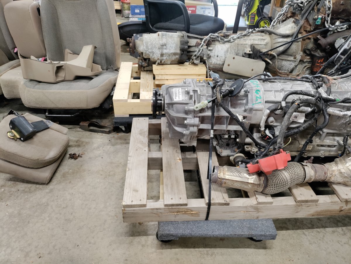

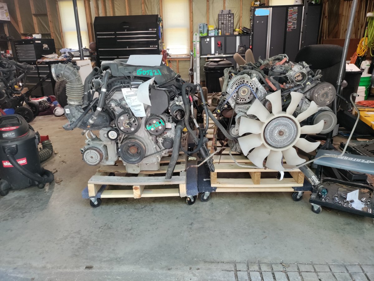

This gave me all the space I needed to back the engine onto a new pallet on mover's dollies to move around the shop.
With them right next to each other it's a little easier to see the differences and potential issues. I lined them up as close as I could for these pictures with the furthest forward pulleys being aligned.
The 2.3 AC compressor is in a really bad spot and will likely need to be removed entirely to fit between the frame rails since the overall shape is more of a rectangle compared to the 4.0.
The overall length of the drivetrain seems to be a little shorter with the 2.3 at the tail of the transfer case. I don't currently have a way to measure reliably what the difference is. One difference not pictured here is the massive transmission cooler on the 2.3. This may cause width fitment issues later.
When sitting on the oil pan, both platforms are nearly the same height.

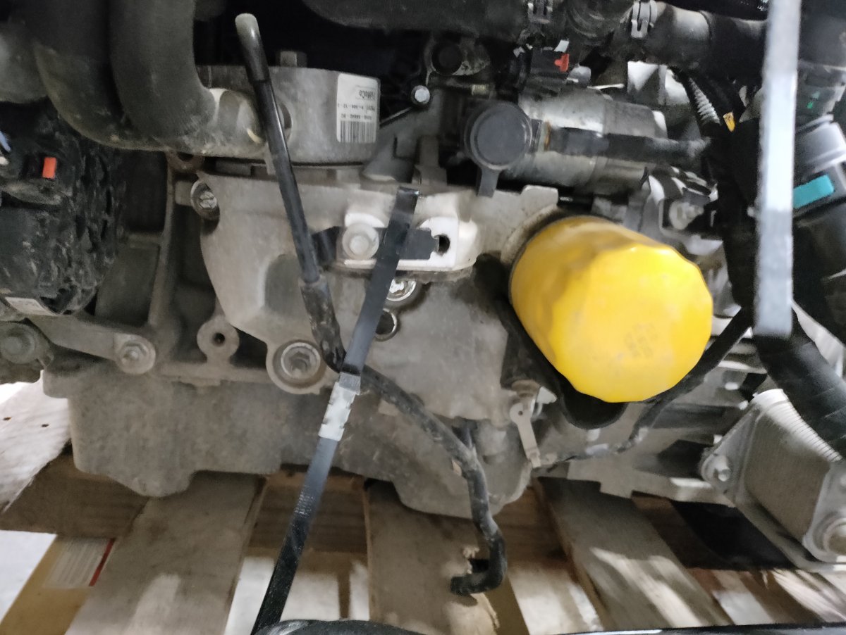

Another difference unsurprisingly is the oil pans. It looks like the 2.3 will need to be modified to fit with the front diff because the 4.0 is very shallow in front. I also don't know by how much yet.
Since I have such an easy side by side comparison I plan to take more pictures of differences as I find them. Hopefully they can help someone in the future.

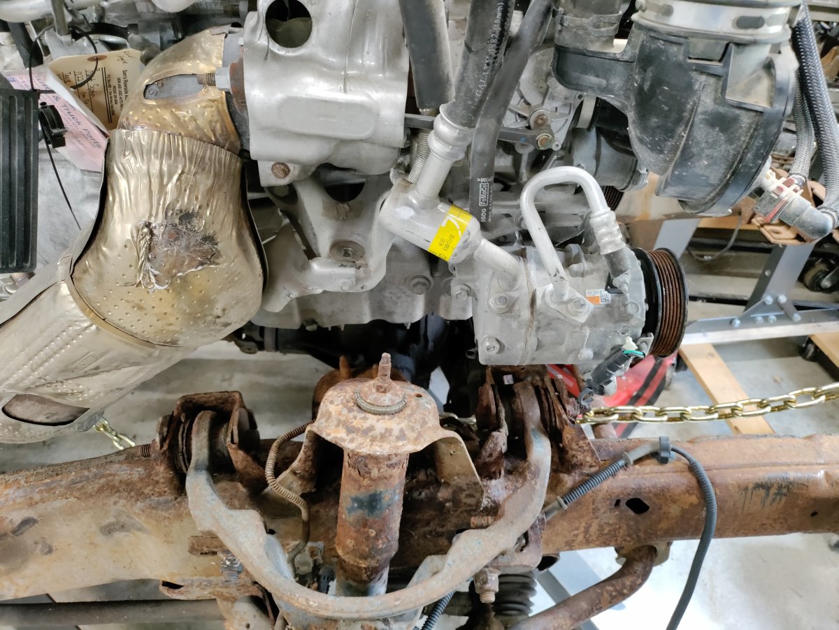

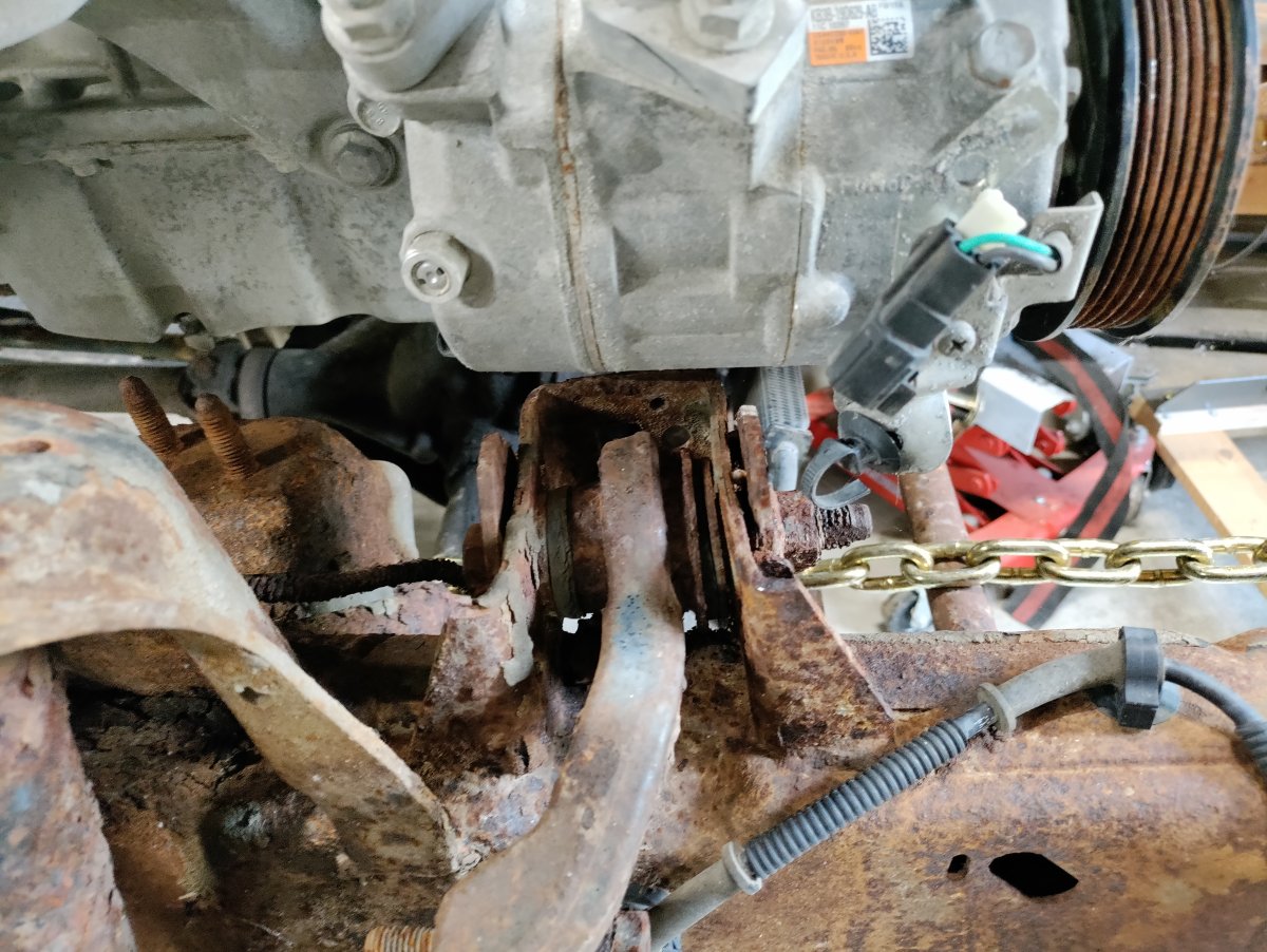

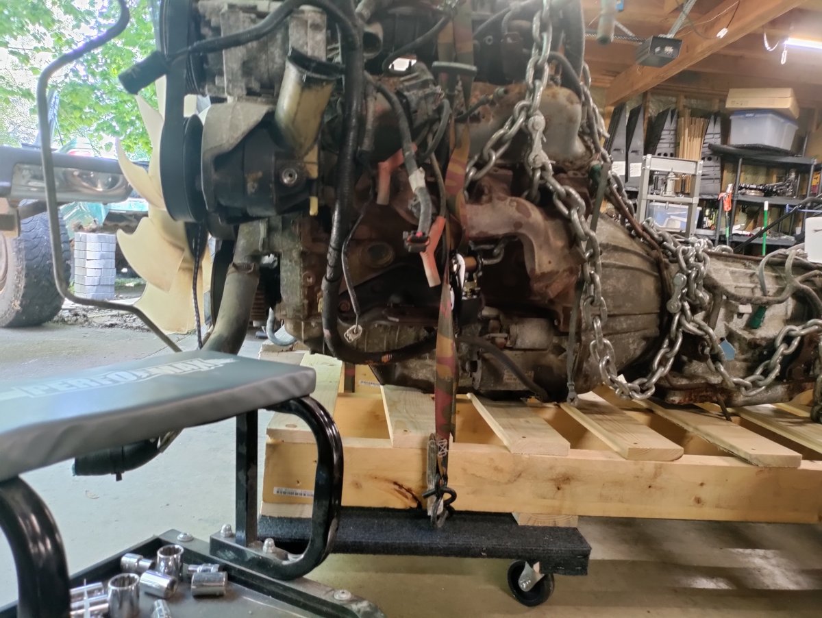

Now that the hot days seem to be behind us for the year, I'm back in the shop. I'm hoping to make some more big progress before it becomes too cold. For obvious reasons, small adjustments to drivetrain placement to measure for fitment weren't going to happen in the gravel. I spent some time cleaning out space to get the frame inside so I could take my time. After fiddling for several hours I'm pretty happy with first impressions on fitment.
Key takeaways:
  • The 2.3 Ecoboost is about 3 inches taller than the stock 4.0 when placed as low in the frame as I can possibly get it. It would be even taller if it wasn't off centered toward the passenger side by 5 inches. This offset is more extreme than I can probably make work.
  • I've removed the AC compressor due to fitment issues with the front suspension. There is no way for the stock mounted location to work with the Ranger's front suspension.
  • Stock engine mounts are actually pretty close to where they line up with the new engine, but not close enough to reuse them in any meaningful way.

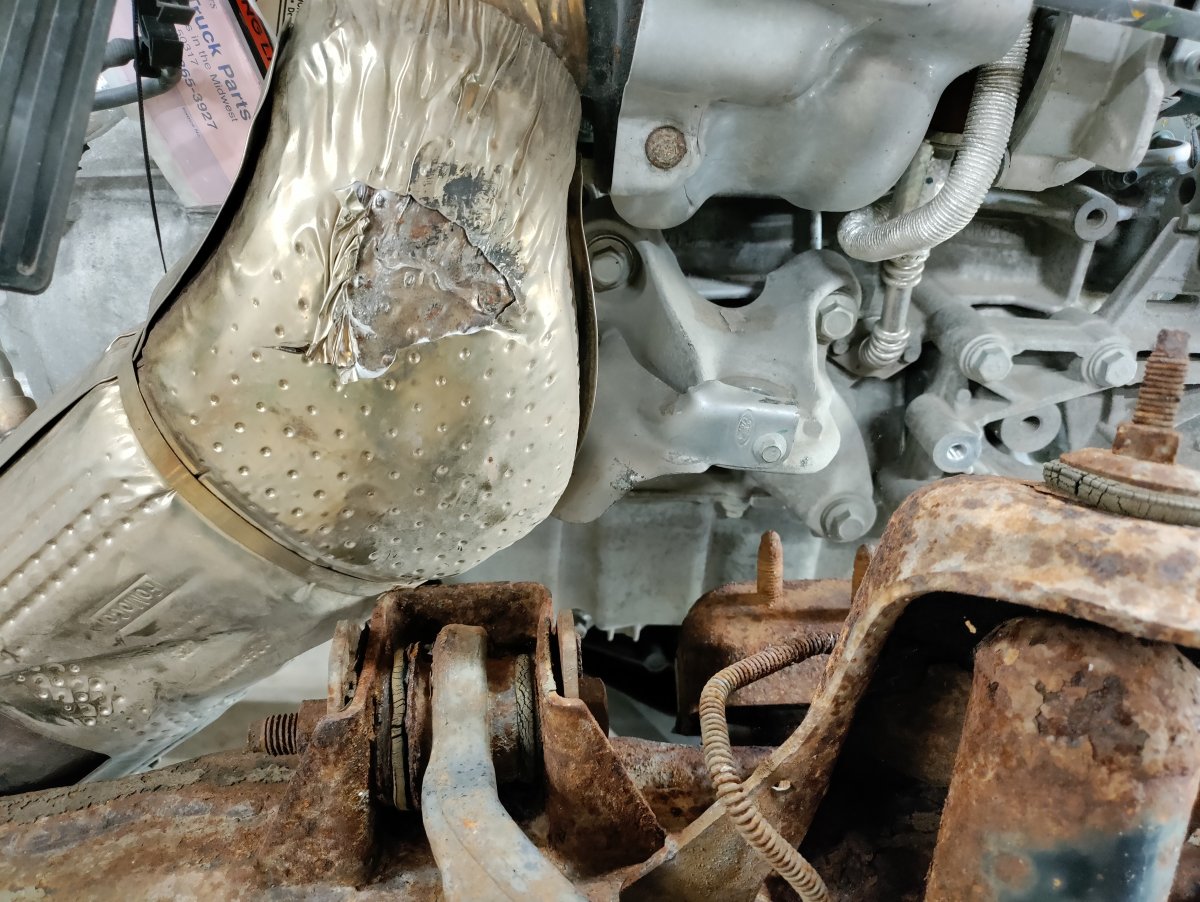

  • I had to remove the stock exhaust for the time being because the cat was bumping into the front suspension. I'm not sure if centering this up will solve this issue or not.

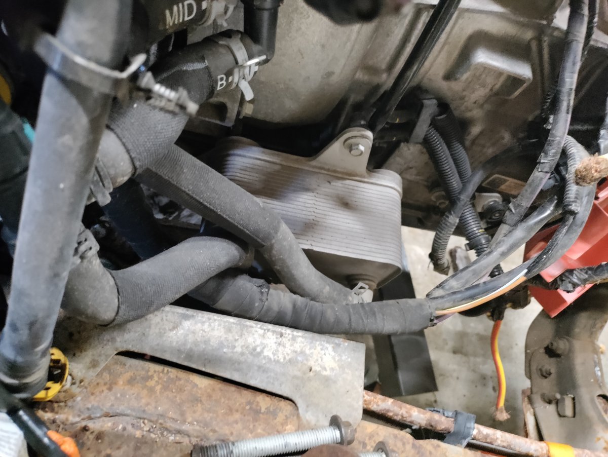

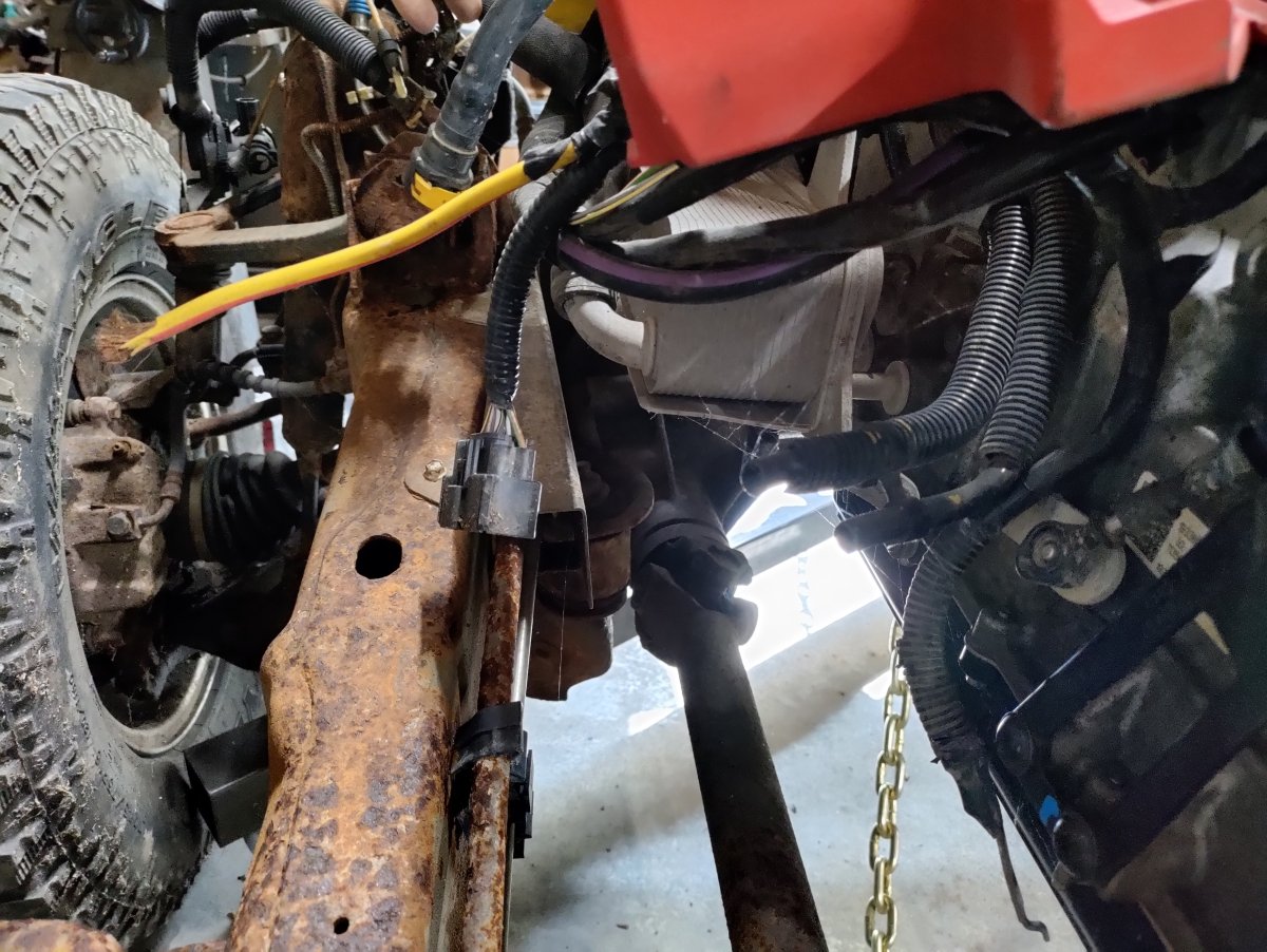

  • Once I am able to center the engine better, the transmission cooler on the driver's side will almost certainly have clearance issues.
  • The stock 2000 transmission cooler had to be displaced while dropping the engine down.
  • The stock steering rack is going to need some attention while the front diff is dropped. It will be the next item in the way while centering the drivetrain. I'm not currently sure how to address adapting steering controls. The 2020 drivetrain used electronic steering so it doesn't have a power steering pump at all.

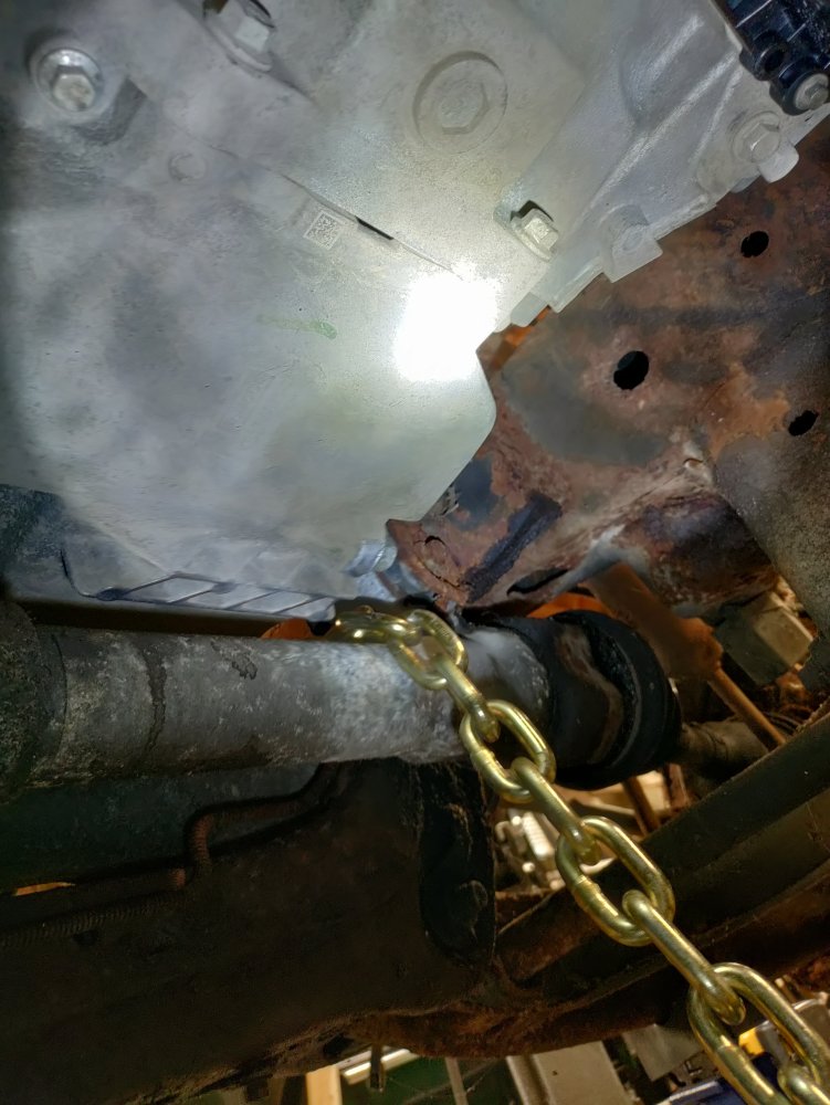

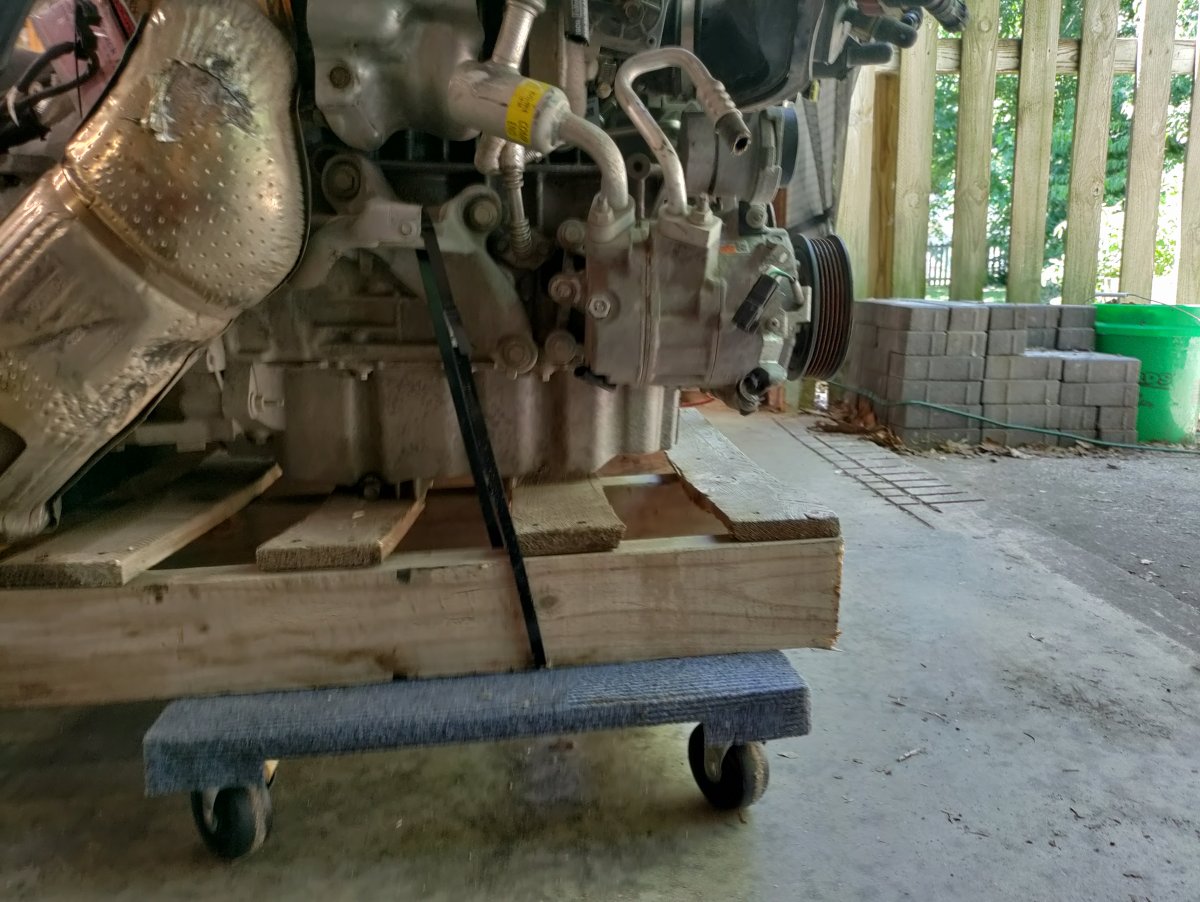

Here are some progress pictures showing some of the fitment concerns:

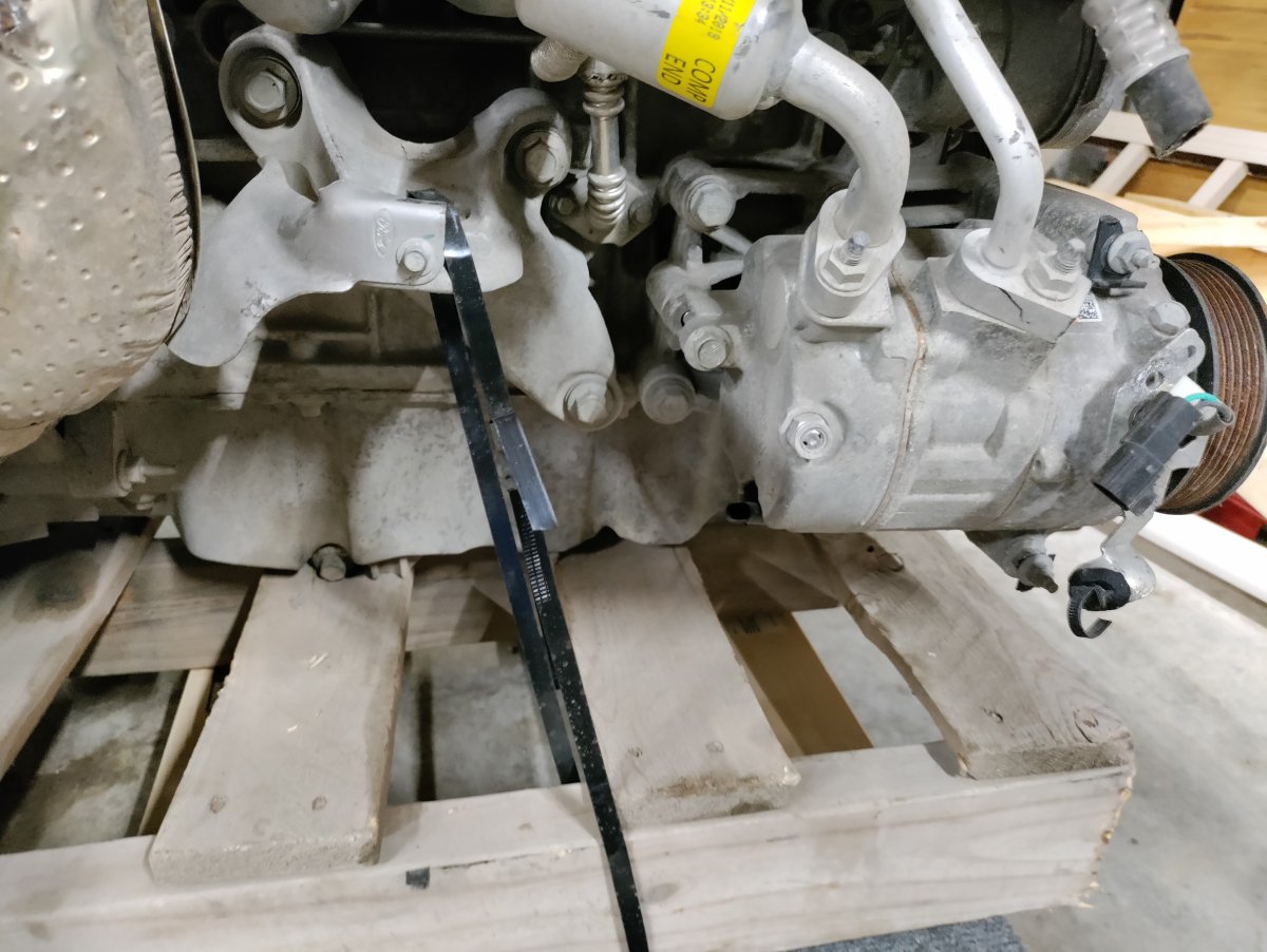

Compressor fitment:
Exhaust fitment issues:

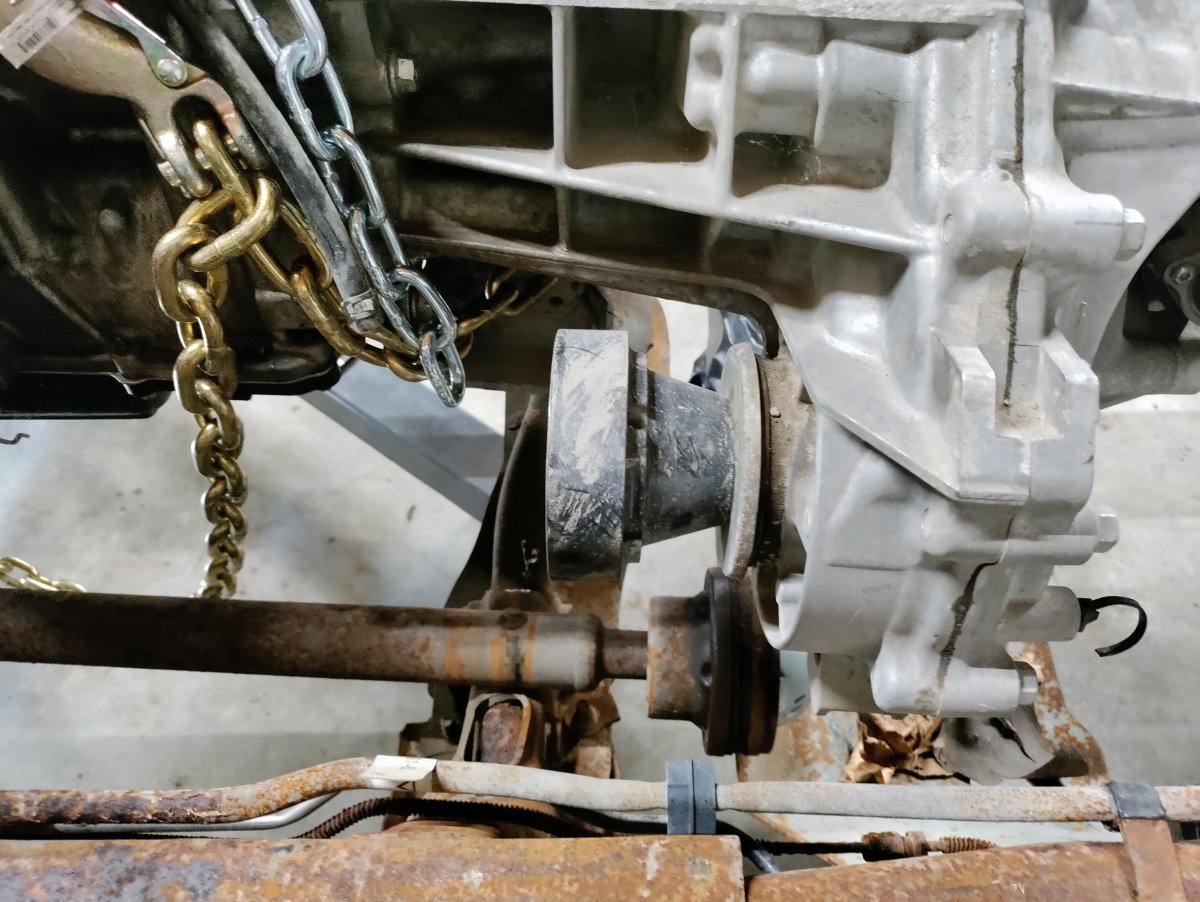

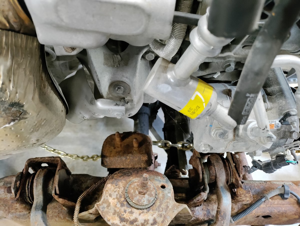

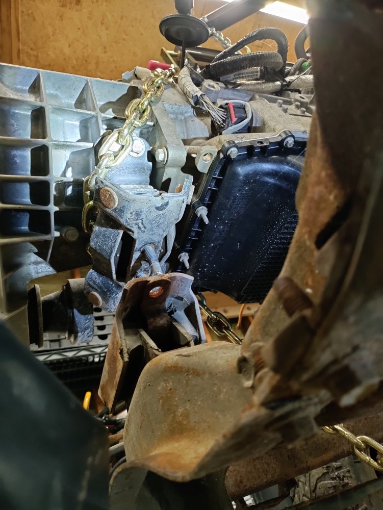

Transmission mount:
Transmission cooler:
Front driveshaft relative length:

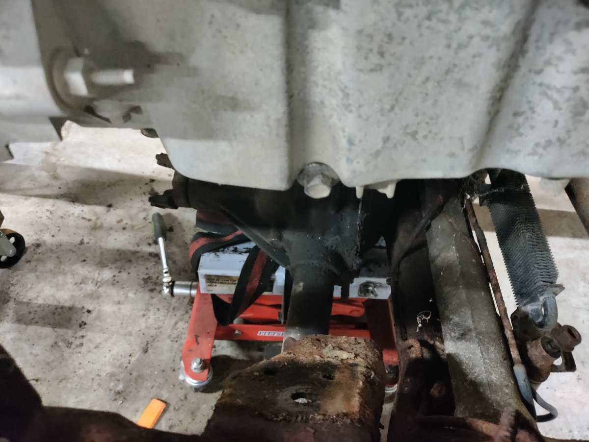

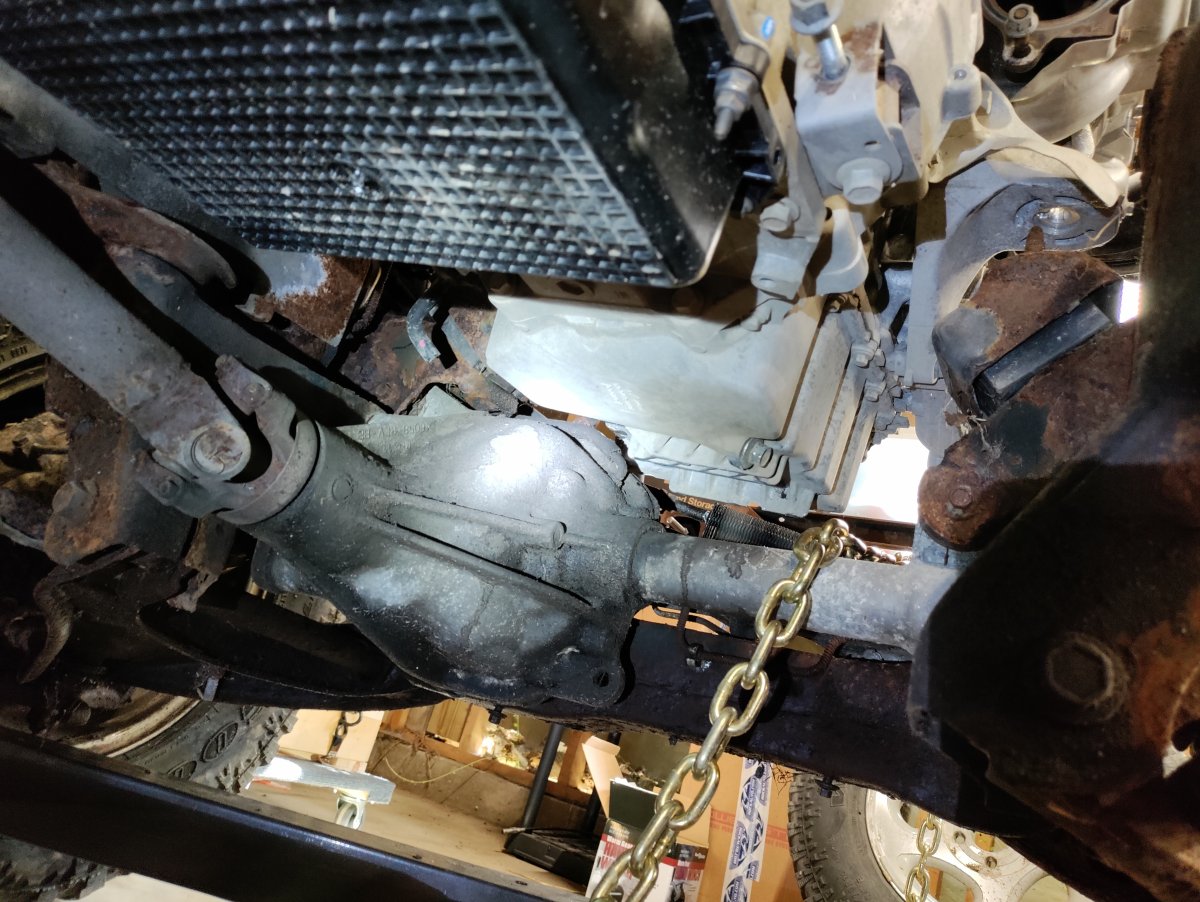

Oil pan/front diff clearance:
Since the front diff and then engine mounts are my next obstacles for lowering and centering the drivetrain any farther, I'm working on removing them entirely for the time being. I'm not set on anything yet. Since I only need about 3 inches of height, barring other fitment issues I'm considering a 5 inch suspension lift for simplicity. At this point I've only picked up a welder a handful of times so I'm by no means leaning on fabrication skills unless I absolutely have to.
Once I have the drivetrain centered where I want it, I plan to take some reference pictures with measurements to help those in the future.

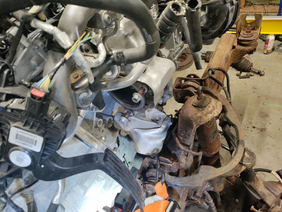

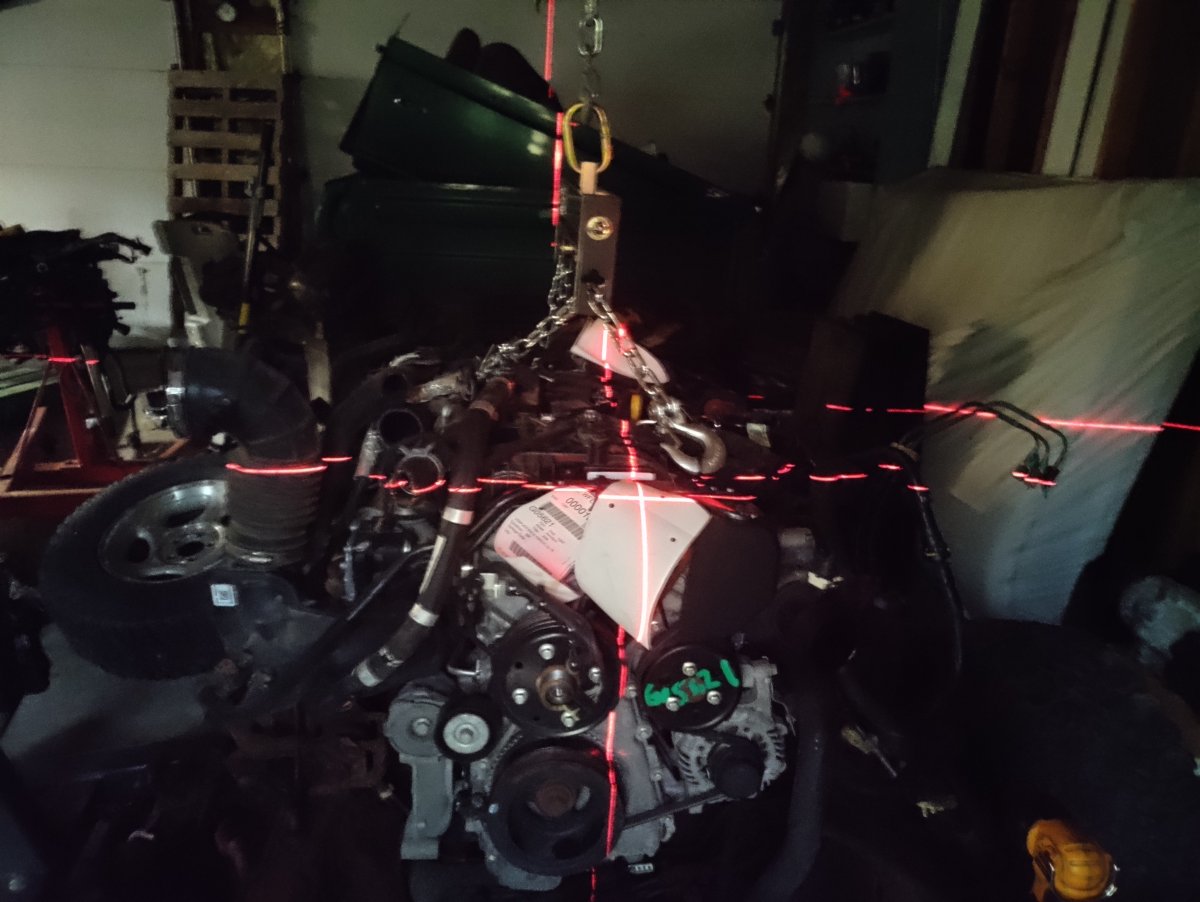

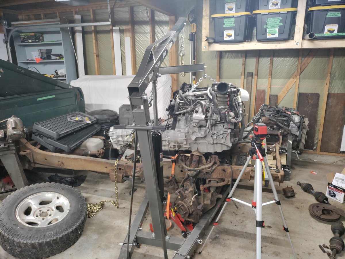

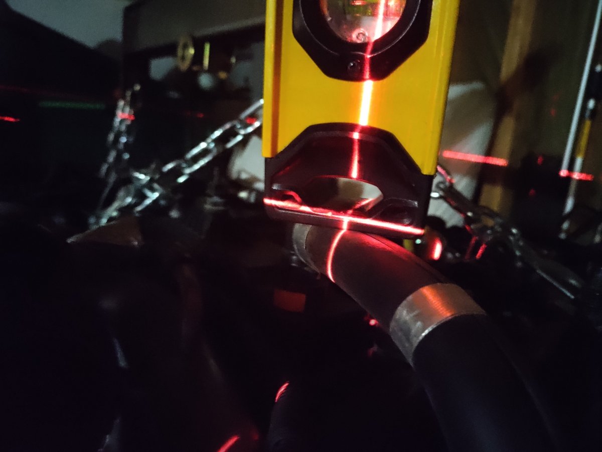

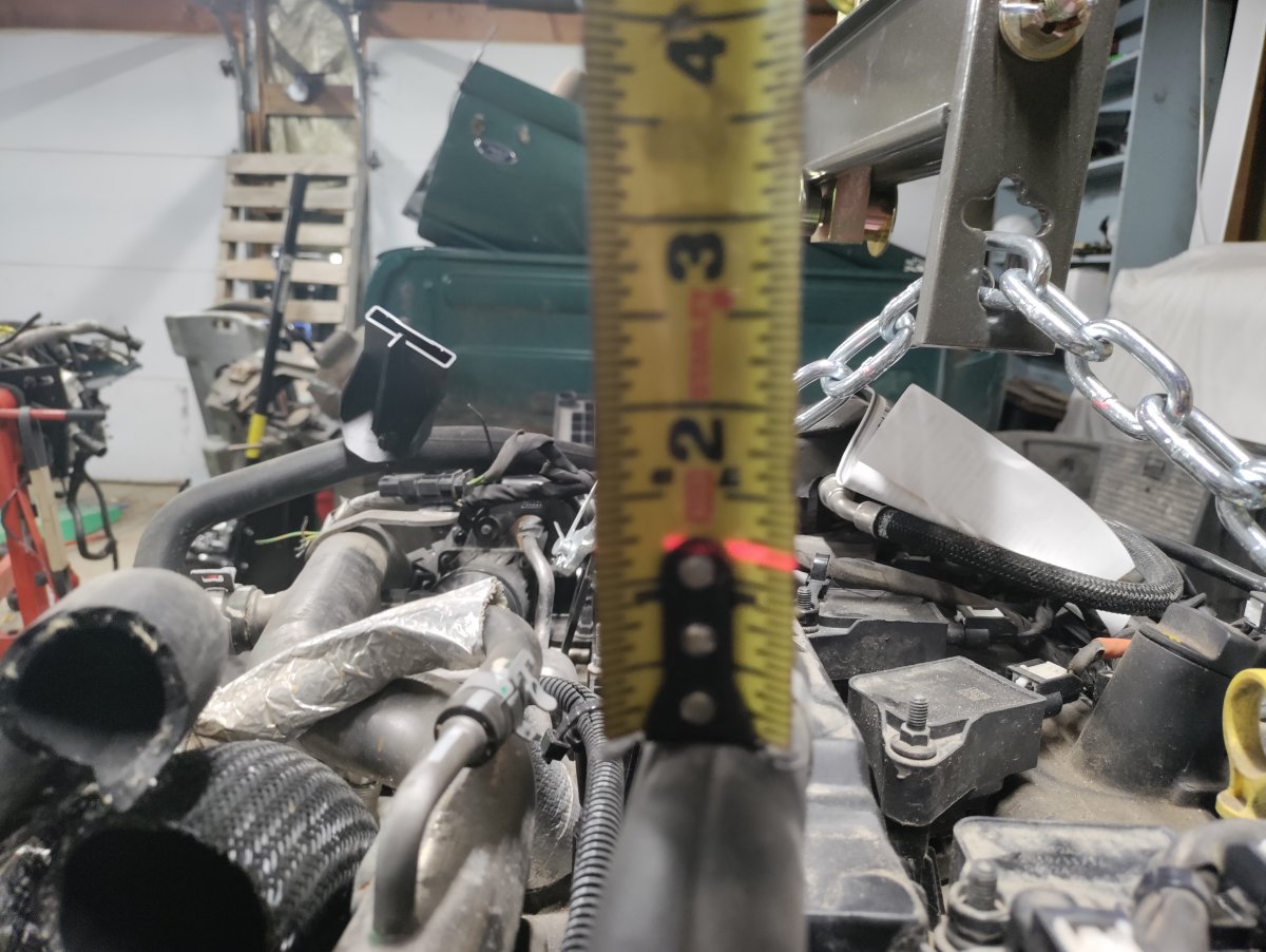

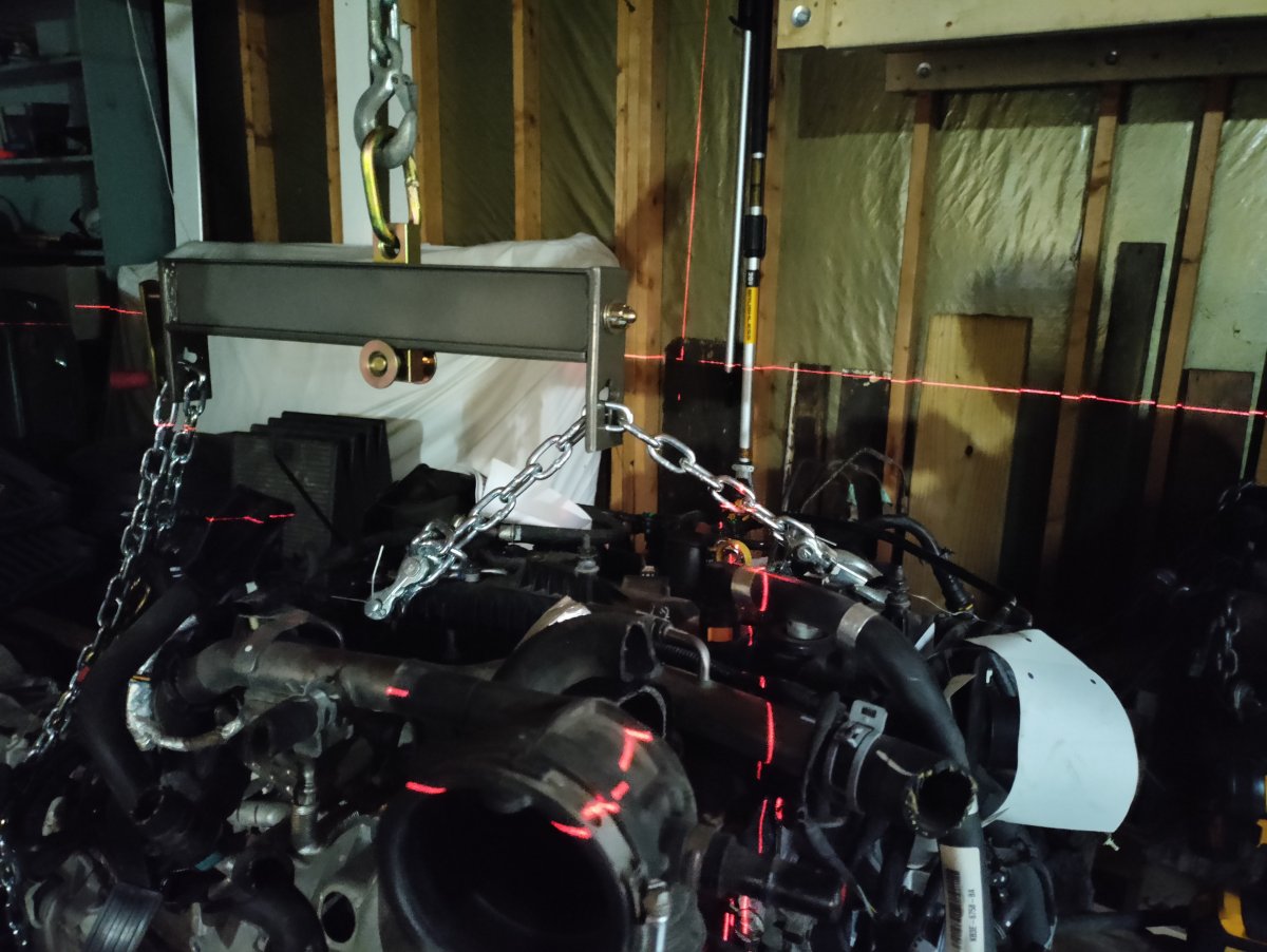

Back at it again. I got pulled away on some other shiny Ranger projects for a few days. After a lot of fiddling I'm happy with how things are shaping up so far. There are a couple of inches of wiggle room but for the most part there is really only one place to slot it in due to the steering rack, suspension, and sway bar boxing in the oil pan.
I did end up getting a laser and tripod to help the process along.
For the most realistic chance of a fit here I did end up offsetting it by just a little bit to the passenger side. The centerline isn't exact, but close enough for what I needed.
First I shot a reference line on top of the highest hose on the top. This is with the engine as far down as it would go with the engine mounts and diff still in place:
Taking off the stock 4.0 engine mounts only netted the smallest sliver of height before we ran into the top of the diff.
Dropping the diff out of the way gained quite a bit of room before finally coming to a rest with the oil pan on the steering rack.

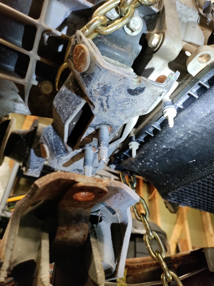

Here is where the 2020 mount ends up, it is very close to lining up where the crossmember is.

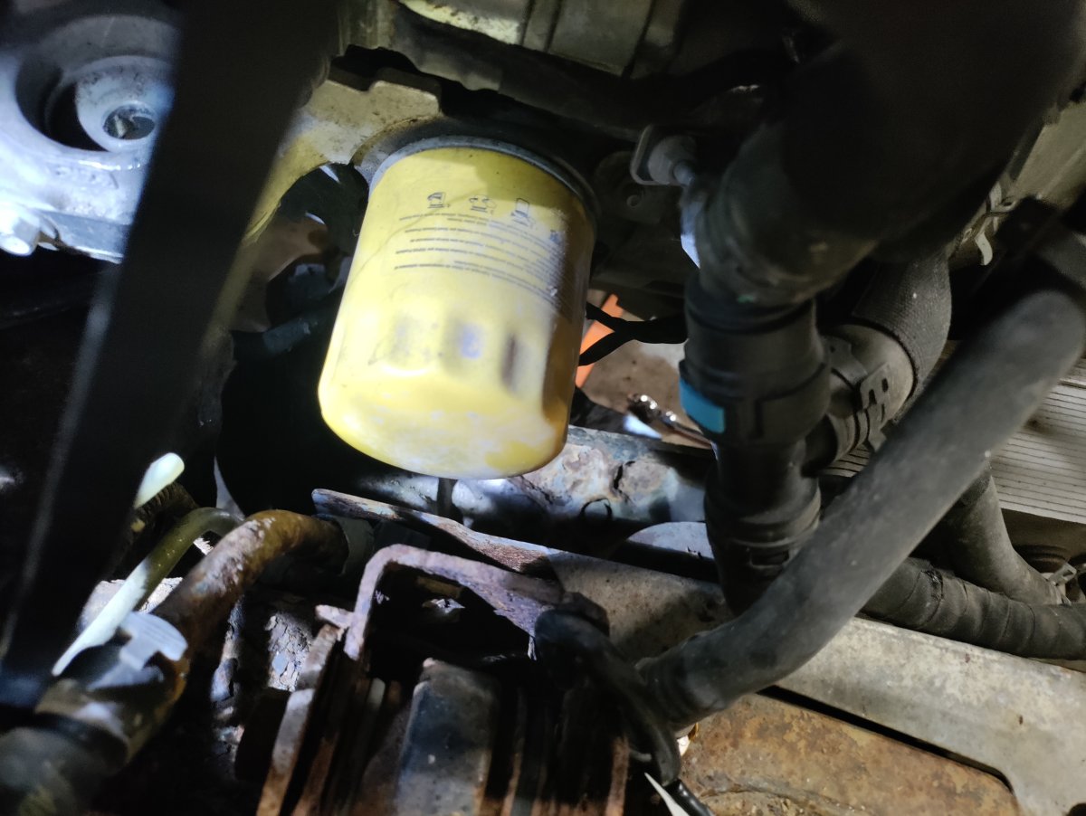

Here are some fitment concerns now that I'm closer to set: an extremely unfortunate drain plug location, oil filter position and transmission cooler cutting it pretty close as well.
After doing some reading it seems that I am probably close enough right where it's at. Since there is a body lift available if I need more hood clearance and a suspension lift available with a diff drop bracket, I should have an extra inch or two I can purchase if I really really need it. There is very little room now between the stock 2020 motor mounts and the crossmember so I may have to get creative making a bushing. I called the local Ford shop today to see if they could get me the rubber mounts so I had something to work with but they said it would likely be a week or better if they can get them at all. Even so it is looking like ~$100 per side, if available. I doubt there is even room for them in the first place. I'm calling in a buddy to come have a look who has more experience to hopefully offer some advice before I start on some bad ideas.
At this point I'm only around 58 hours of actual work in on the build so if you had more time on your hands, a lift, or more experience than me you could get to this point in a hurry.
