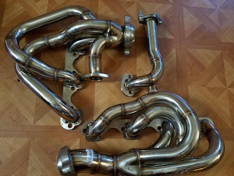

I will be the test subject. I just ordered them. I got 15.00 off on ebay. I paid 478.00 shipped to the door. These will be going in a 98 4x4 torsion bar ranger.

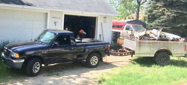

I’m on my way to the scrap yard with the trailer I just finished.?

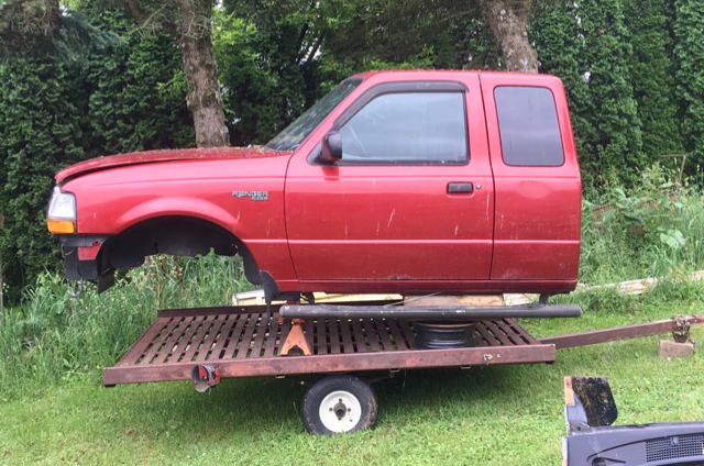

Sorry, the front end and other assorted parts from that truck are going on the 2000 that’s getting the V8 so it will be a 2005 look alike.[emoji4]
Well they have arrived. It is going to be a few weeks before I can install them because we are getting our doublewide set up Monday and I will have no time for a while to install. I will upload some pics of them later. I am getting an error when trying to do so. I checked the headers over with a flashlight in the dark and did not find any cracked/bad welds.
They look nice! :icon_hornsup:

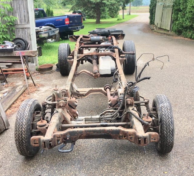

I finally found the time to remove the V6 & automatic trans from my Ranger.[emoji4]
Plus everything else LOL
Yep, I may have went a little overboard. But now fitting the V8, 5speed, transfer case, drive shafts and exhaust should be a lot easer.[emoji41]
