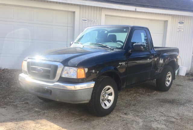

I will be parting out a 2005 Ranger in a few months and I’m going to use the front end and some other parts to make the 2000 look like a 2005.[emoji106]
Yeah I like the newer model front ends.
This is the front end I’ll be putting on my truck, I’ll be adding a new front valance with fog lights too.

I have a 1999 and added the 2011 front end, headlights, grill, bumper, valance, hood, etc. I didn't have to drill a single hole. Everything was a direct fit with the 1999 core support. You do need to add the newer style hood hinges.
