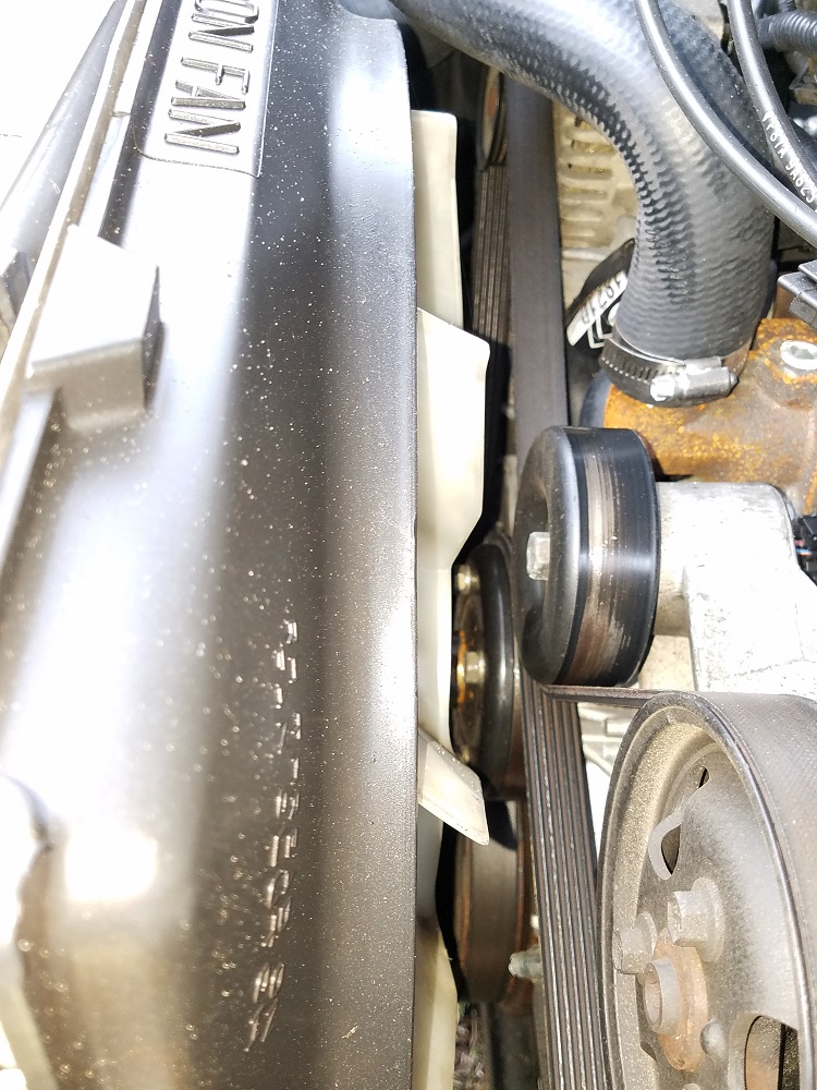

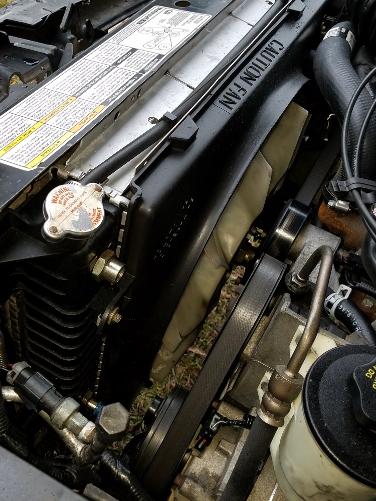

Looking good Craig.. I have another picture request when you get time if you don't mind.. Can you show where you have the engine sitting at on the mounts(like front to back) and where the stock clutch fan sits in the shroud?
Here is the pics of the fan and shroud. This is the explorer radiator. It is raining and 35 out right now. I will try and get some of the mounts. They are not even really noticeable off factory location with the engine shifted over to the side a 1/8 inch. You can barely see the old nut ring where they were tightened down from the factory in the explorer.

That's perfect! Exactly what I wanted to see. Thanks Craig! Should not be ANY cooling issues this summer chilling with the Ac in.
Wow, I thought I was looking at my truck for a minute. That is exactly how my fan sits in the shroud. With maybe 3/4 of an inch or so of the blades sticking out. In the Decmber Florida temps right now it is running all day at 180 degrees with a 180 thermostat. In July it runs at 190-195 with the same 180 thermostat. Using the 190 degree thermostat in July it will run up to 204 sitting at a light. I quess it makes sense, about 10 degrees hotter.
I am in south Mississippi so I decided to go with a 180 thermostat. I have not had a chance to run in the summer heat down here. I suspect it will not be a problem. In October with the 80 degree temps i was running 179/181 on the scanner. Explorer radiator has a lot more cooling coupled with all the blades on the clutch fan. The shroud was also off the explorer since I stepped on my ranger one and broke it (:. Also I did not run the trans cooler lines back to the radiator. I bought an aftermarket cooler and the trans line go in to the cooler and back to the transmission. So far the cooler has been warm at most. Plus the transmission is not pulling a lot of weight in the ranger either.
