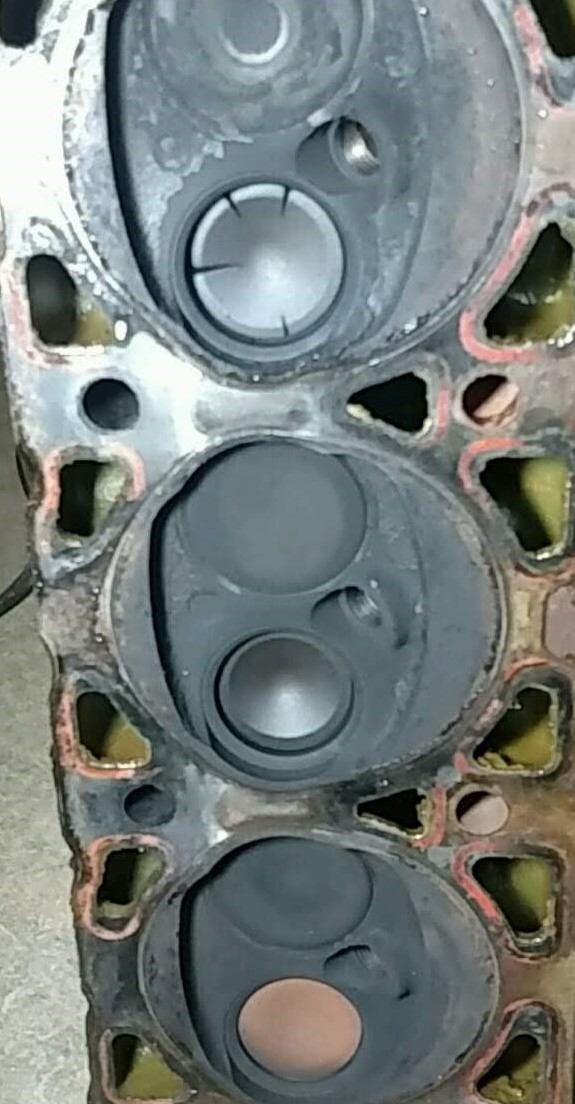

Well, we figured out that our compression gauge leaks so the readings aren't accurate, but we can extrapolate for the leaky gauge. Did an exhaust valve leak test, and all three valves were leaking bad. I was really hoping that it was a weird or easy fix, or something that just happens to the 3.0s or something that got missed during the swap that could easily be remedied.
To my knowledge the 3.0s didn't have head problems so was thinking the worst. Pulled the head to find the valve seats were gone. At this point i was pretty mad because I was lied to. The lady told me it ran fine...
Anyway, we replaced the head, with the head off the seized engine and runs fine. I attached a picture of the bad head but had to resize it to upload so I hope it comes through alright.
now i just have to fix an abs code or two and should be ready to go.
Thanks for all the help!

WOW, those valves and seats look bad. Glad you got figured out.
Those are NOT valves, they are animated decorations
