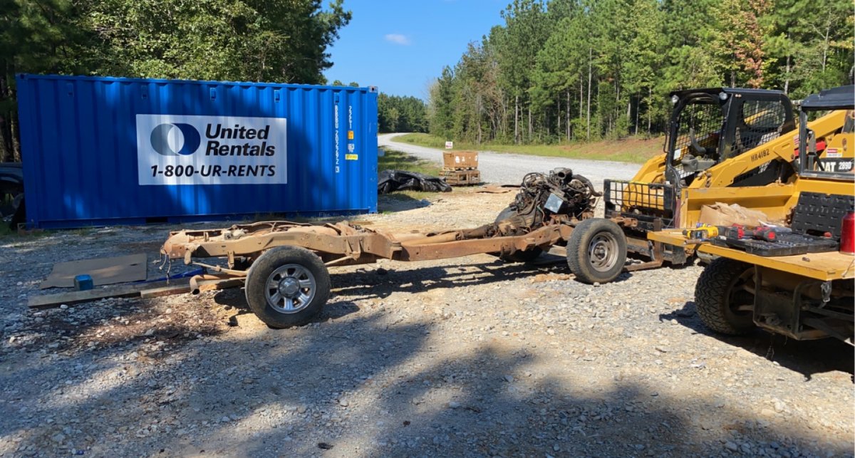

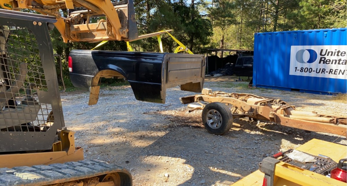

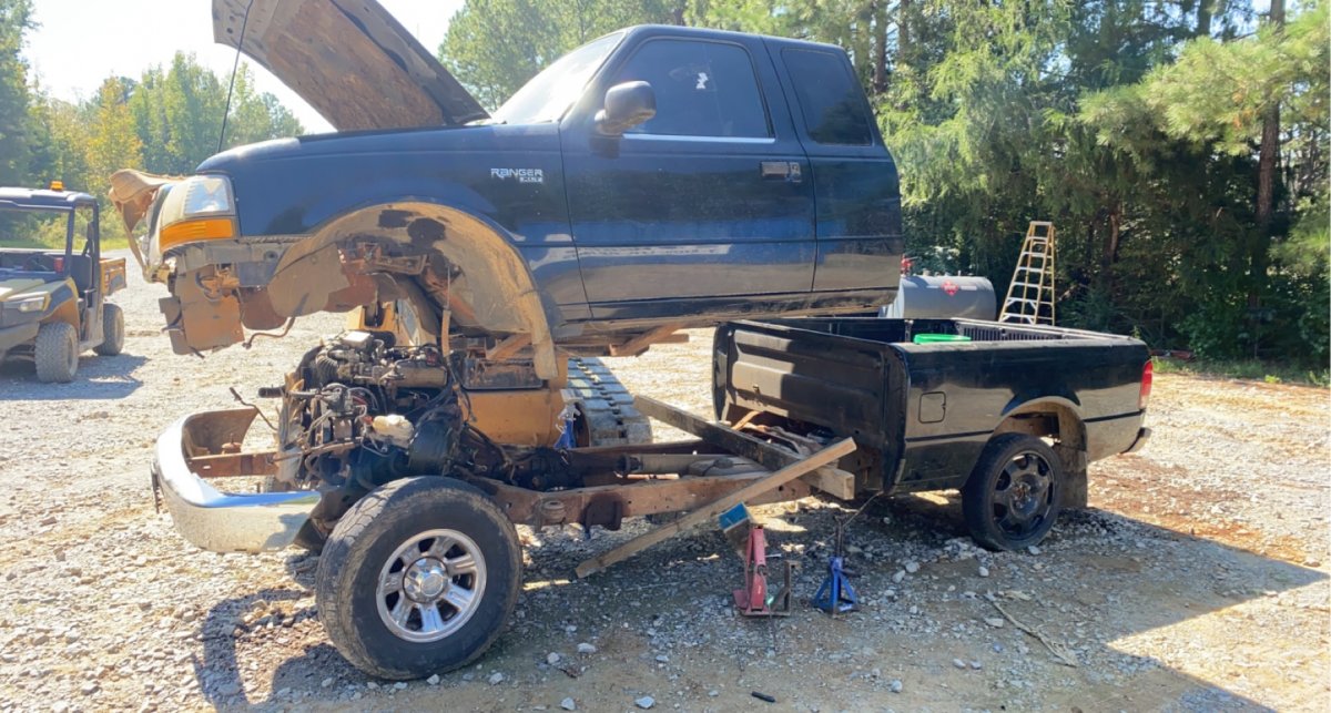

The swap is underway. I have both rangers torn apart and first thing tomorrow I’ll be dropping the 2000 cab on the 1995 frame and 2.3l.

So I now have the 2000 cab on the 1995 chassis with the 2.3l and M5OD.
