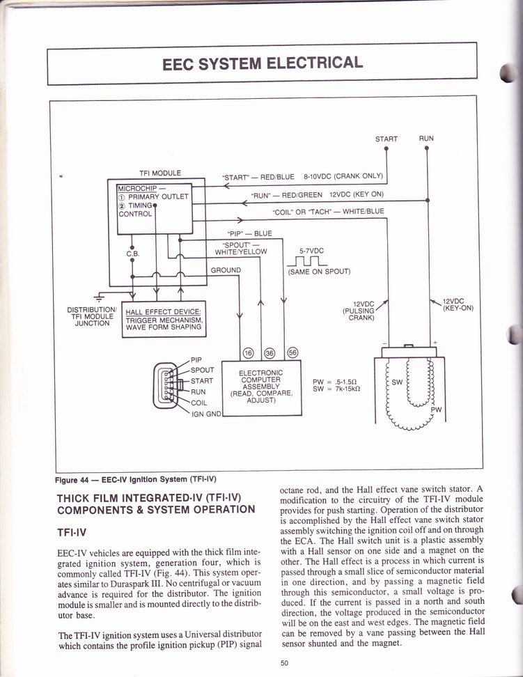

Continuing onwards, it seems like I'm getting 12V to the red wire coming from the starter to the ignition coil, and I'm getting ~4-5 volts to the green wire coming from the TFI (and pin 4 of the ECM w/ ballast resistor between) to the coil. Are these typical values that I should be seeing? Might end up replacing the coil, I'm just a little confused about the voltage difference here. I know it has a ground, but I'd assume it should have a 12 V difference across the primary winding side, right now its about 7 V. Tried two different TFI modules (both known good) and there's no change.
I have come to the conclusion that the distributor I purchased has a completely blown pickup coil, and it's sending weird voltages to the ignition coil through the TFI, none of which are reaching the correct voltage to arc across the gap between the rotor and cap.
After diving into a bunch of schematics, the TFI was the only connection that the green wire to the distributor had. It's supposed to be delivering 12V pulsing to the green side of the coil when cranking, but I'm not really getting that. Seems to be connected to the hall effect sensor and the pickup coil. My working theory is that the hall effect sensor tested fine, output a bit of signal when it was connected, and then failed almost immediately after 20 cranking rotations or so. Just pissed that it took this long for me to figure this out. The above resistance reading where I mentioned the new coil read at like 1/4th the resistance compared to the old one should've tipped me off earlier.
