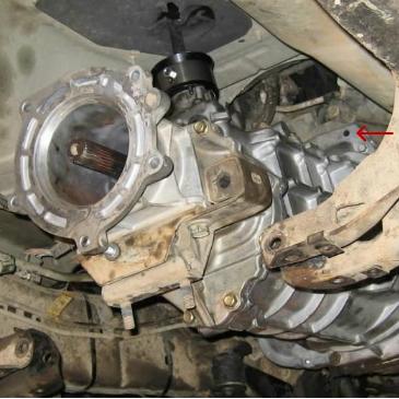

It came behind the 4.0 until 2011 I believe:

No... that was the M5OD-R2.
If it bolts to the 4.0, it can be bolted to the 2.9. Just remember to use the right starter for the clutch you use. It may or may not use all the bolt holes in the bellhousing.
BTW, 4.0 automatic starter is a nice upgrade for a 2.9 if you can handle the wiring changes. (IIRC it's just one wire moves on the fender solenoid.)
It will definitely mechanically connect. The only change there is the addition of one bolt hole on the SOHC engine. What someone else would have to clarify is whether any other changes happened over time that need to be addressed (like VSS, etc). @RonD ?
