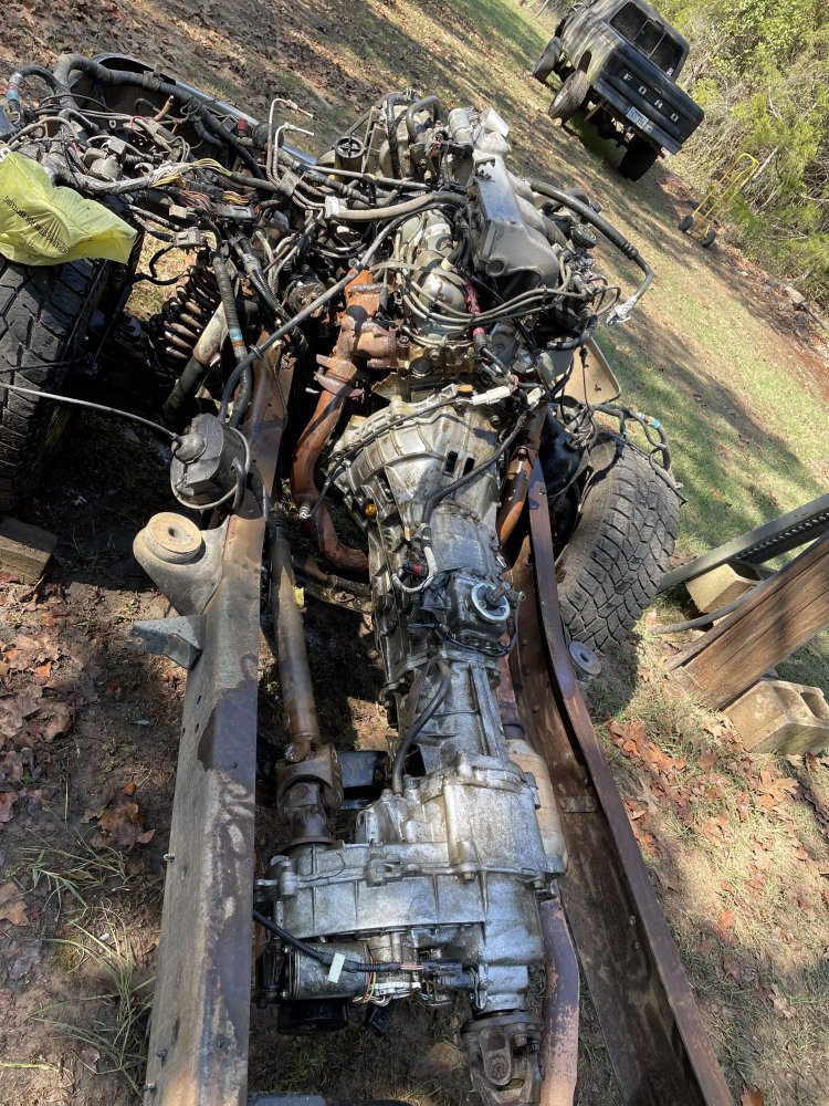

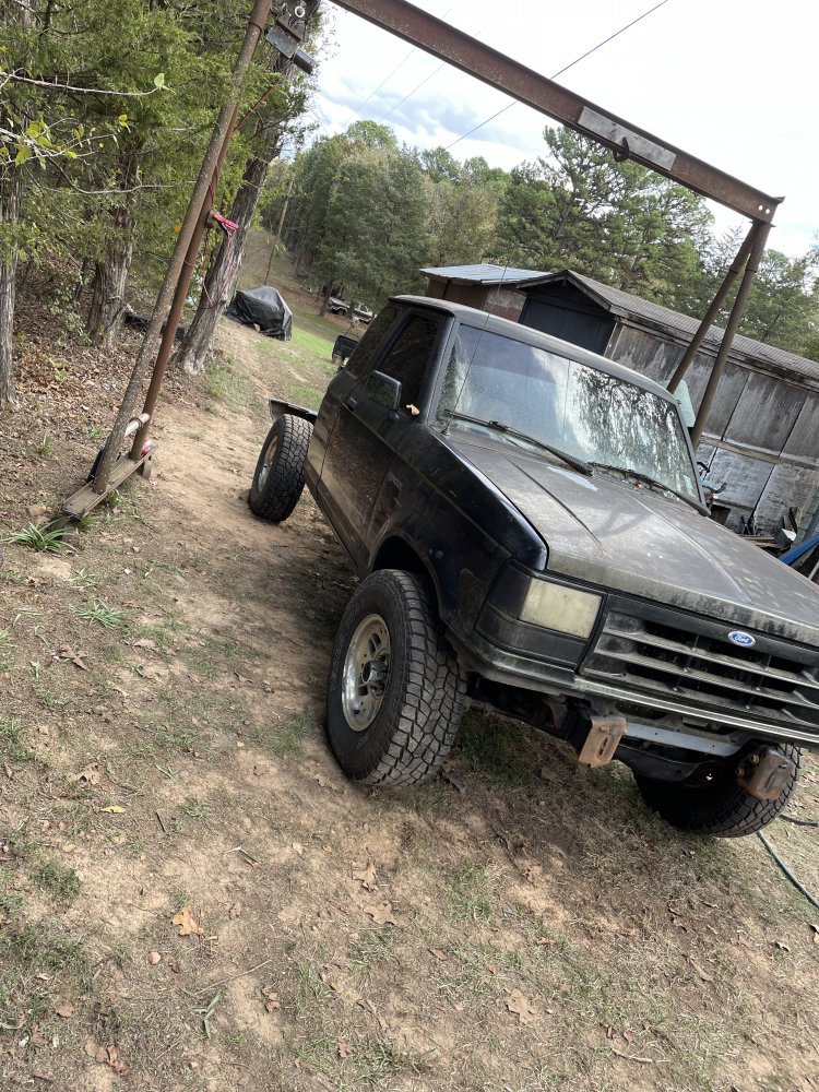

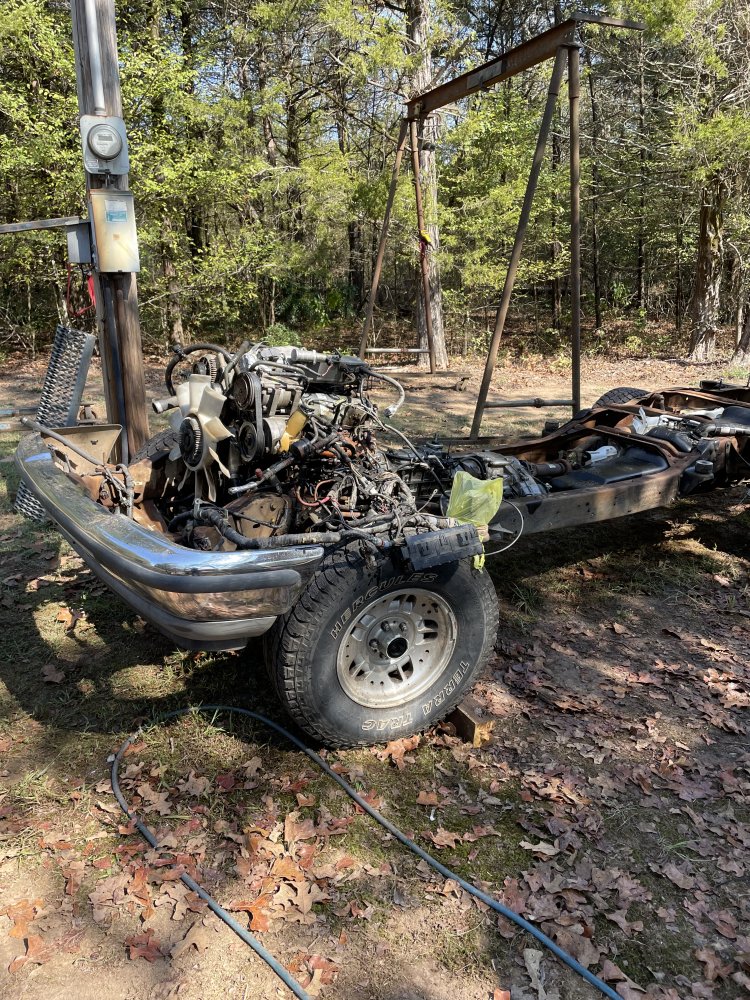

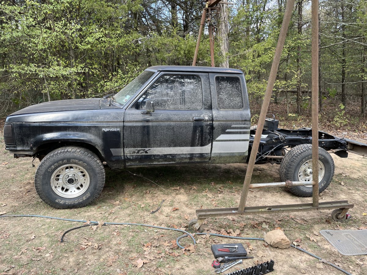

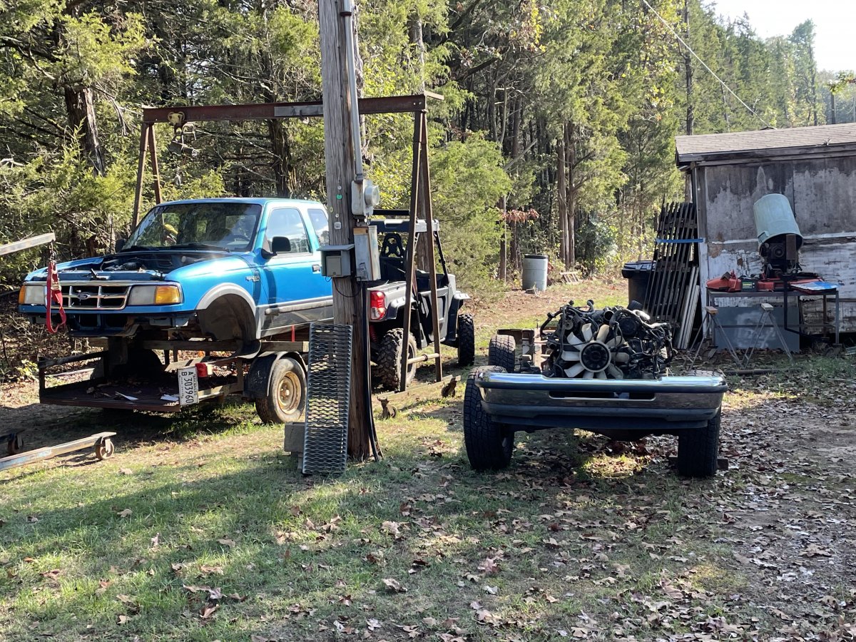

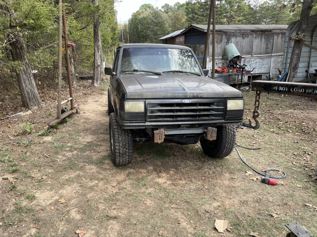

Ok I’m new to the ranger station have read many write ups on the 4.0 swap but first time posting.
Original Vehicle: 1992 Ford ranger STX 2.9 4x4 manual trans
donor vehicle: 1994 Ford ranger XLT 4.0 4x4 manual trans

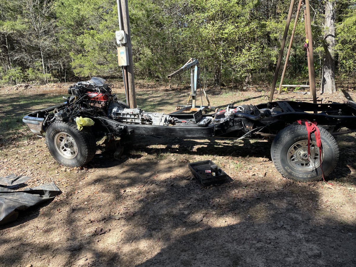

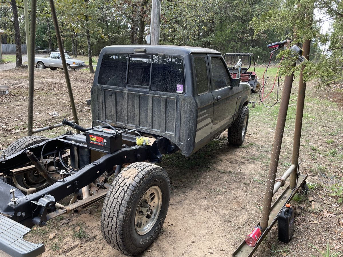

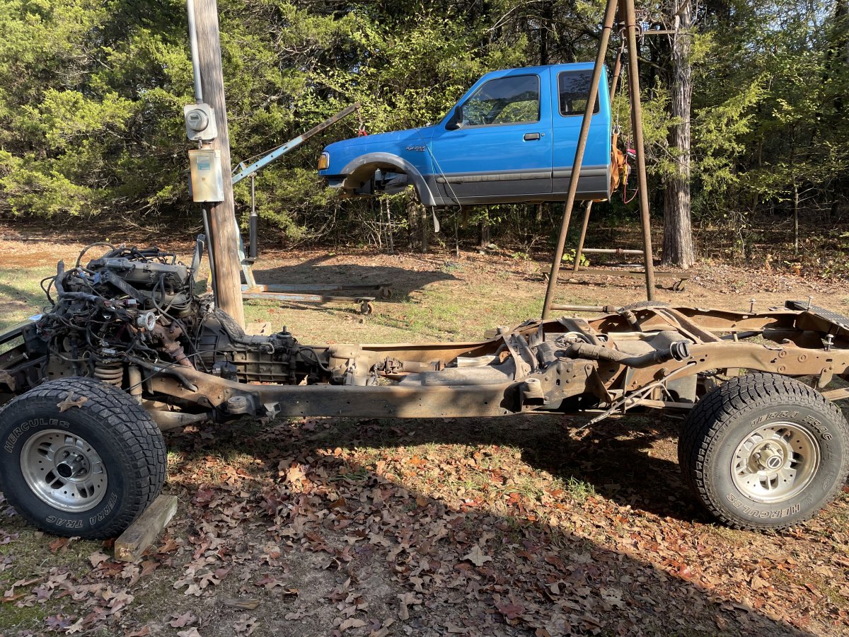

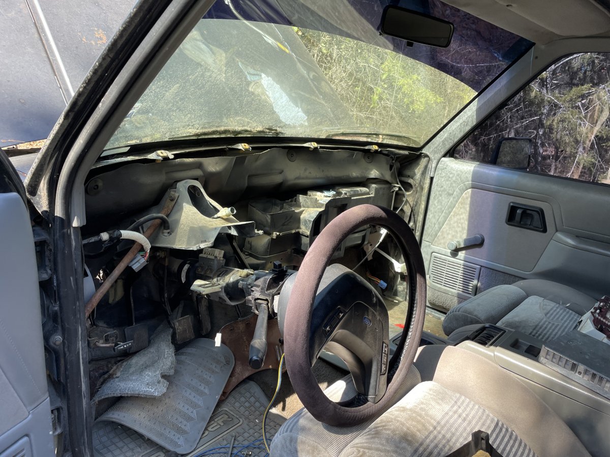

I actually done a chassi swap left all harness intact with the motor and chassi pulled the body’s swapped them over and swapped dash harness everything plugged in and mounted all the wiring harness back to the body and firing wall starts runs drives perfectly no problems at all
ONLY thing is the computer from the donor went through on driver side and my ranger computer went through on passenger side firewall
so my question is can I splice the computer harness and leave a pigtail on the plug and extend the harness to run across the firewall to passenger side to mount the computer under passenger side dash?
There’s 39 wires total my plan was to cut the plug and leave a pigtail on the plug and just Extend the harness and color match the wires but I didn’t know if extending the wires the far would mess with any thing electrical…. May be a dumb question I’m just no Electrican and I don’t wanna mess up the computer or short anything out but I don’t know what else to do to get the computer in the cab to stay dry

well I’m using the harness from the 94 the only problem is that the harness on the 94 goes through the fire wall on driver side and computer mounts in between the fender and cab and is sealed off the 92 is not like the the computer runs through the fire wall on passenger side and is mounted in passenger kick panel. So all I’m needing to do is lengthen the harness so the colors all match I’m just worried that lengthening it will cause problems…
it’s hard to explain but the computer on the 94 isn’t accessible from inside the cab it is literally inbetween the cab and fender on driver side and sealed off completely and my 92 body isn’t and there’s really no room to cut a whole on driver side with the main harness round plug the clutch master cylinder the throttle cable and peddles all in the way and I can’t leave it inside the engine bay without it getting wet or moisture or dirt on it or in it
