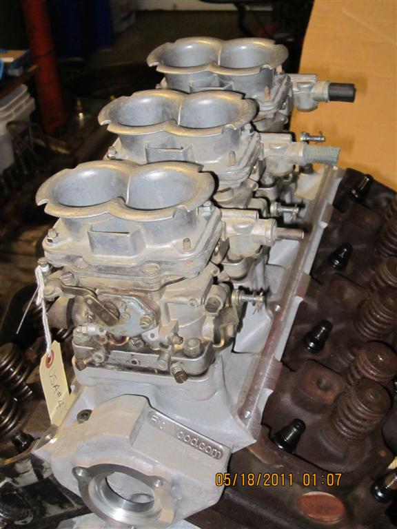

Attached should be a photo of the mocked-up 2.9L engine, just a test-fit of the intake and carbs. And, no, at that point I had not properly sized the ARP head studs, but that's easily done from existing 4-cyl Ford OHC stud kits.
