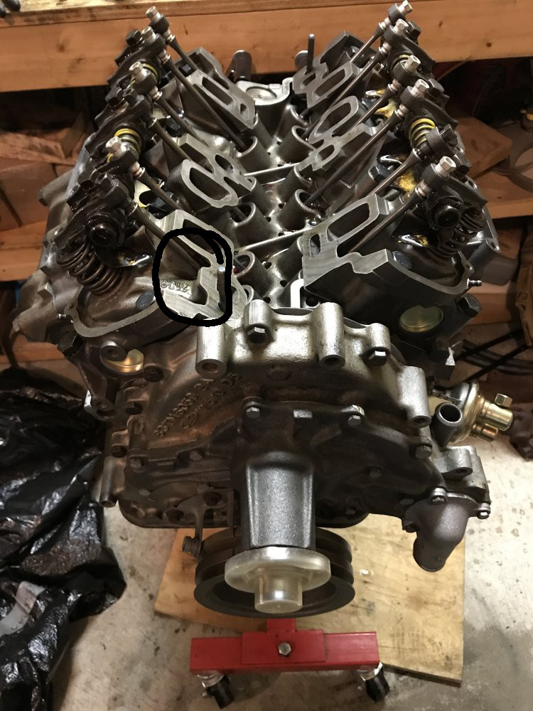

I circled where I think it fell into. Which still isn't good.

There aren’t too many places where it can fall through down into the crankcase. Good luck.
