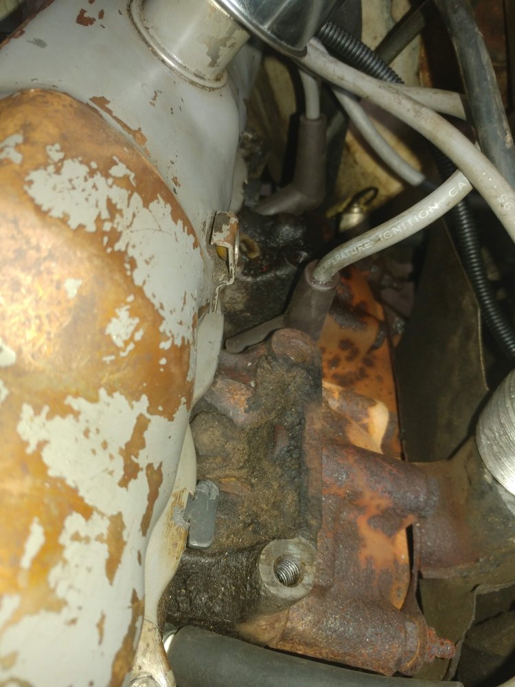

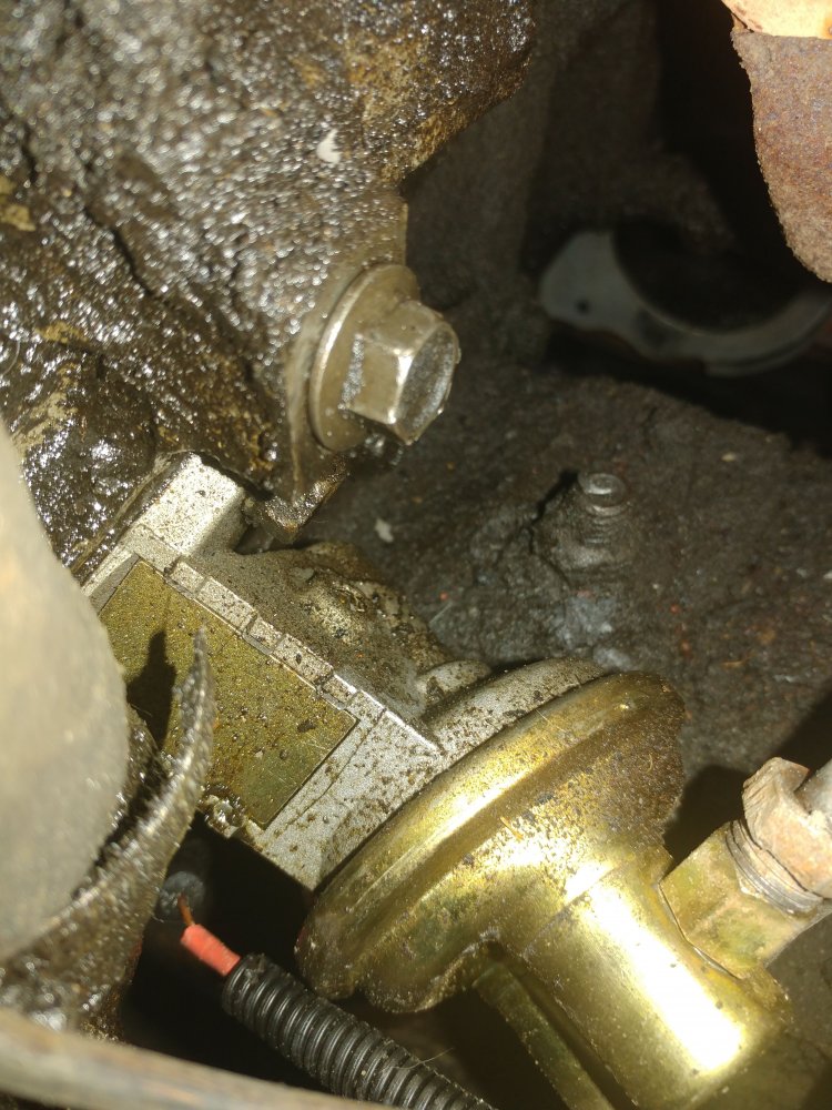

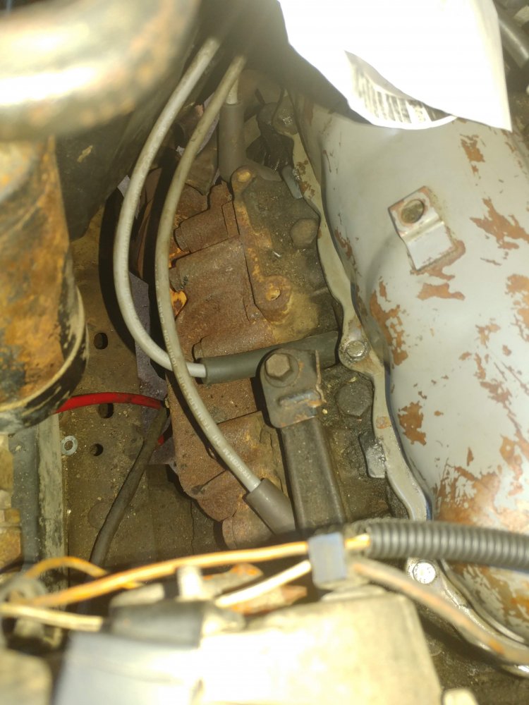

Since the original block grounding point bolt was seized and I really don't wanna have to deal with trying to break it free. Since its so hidden away. I also don't wanna break anything else.
Would either of these points make good motor grounds?
