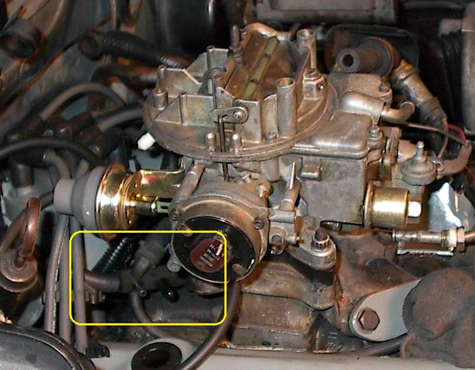

You are looking for the "tree" shown below, which screws into the manifold behind and below the carb.
40110
Follow @AndyB. 's advice, and remove the hoses and cap the open tubes on the tree. In this picture, pointing toward the camera is an open tube, left, and a capped tube to the right of it. Caps would be best, but for temporary testing you can wrap electrical tape around the tree to close the tubes. An open tube is a vacuum leak.
I might have removed them slightly by accident and that might be part of my temp issue. Ive got caps so Ill remove the weird things hooked up to them and recap them all up.
Ill see about capping them off and see if that fixes anything
Thank you all for the encouragement and help! Im truly grateful for all of it!!!
