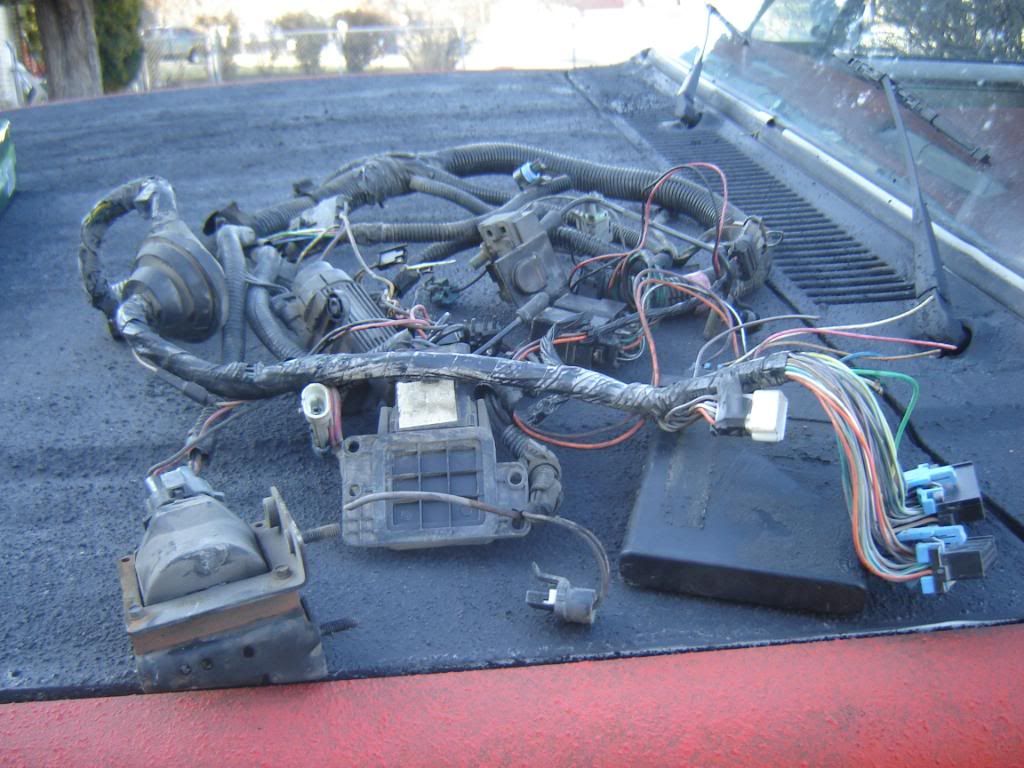

we used the ecm pinout seen here: http://www.vessels-clan.com/jay/truck/tbipinout.htm to weed out the un needed wires, and consolidate the harness:
2.8L Chevy TBI swap
2.8L Chevy TBI swap
the wires needing to be spliced:

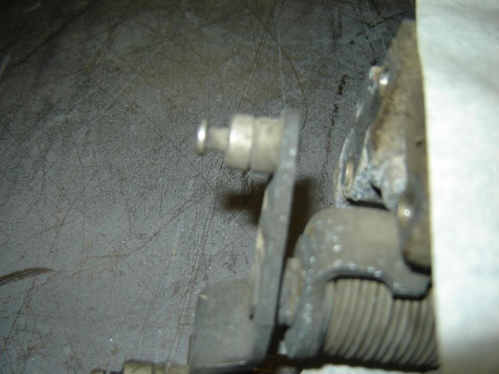

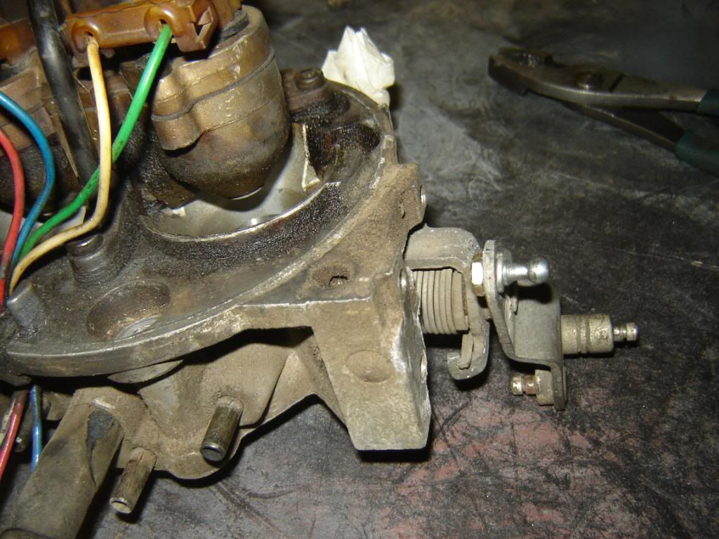

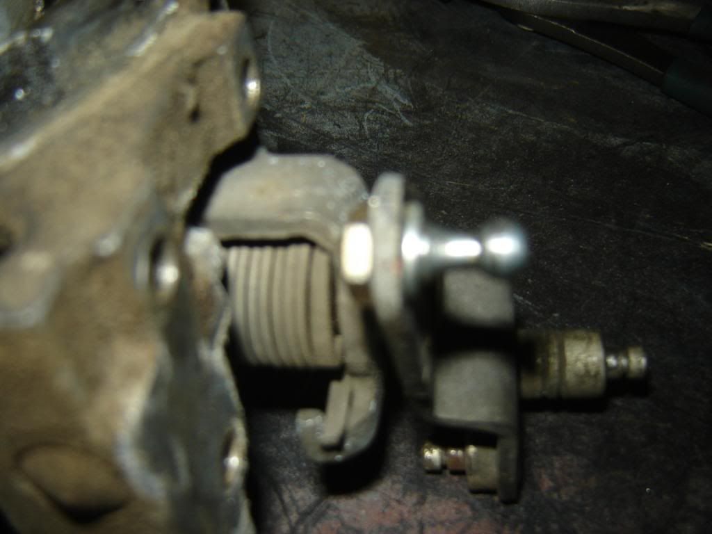

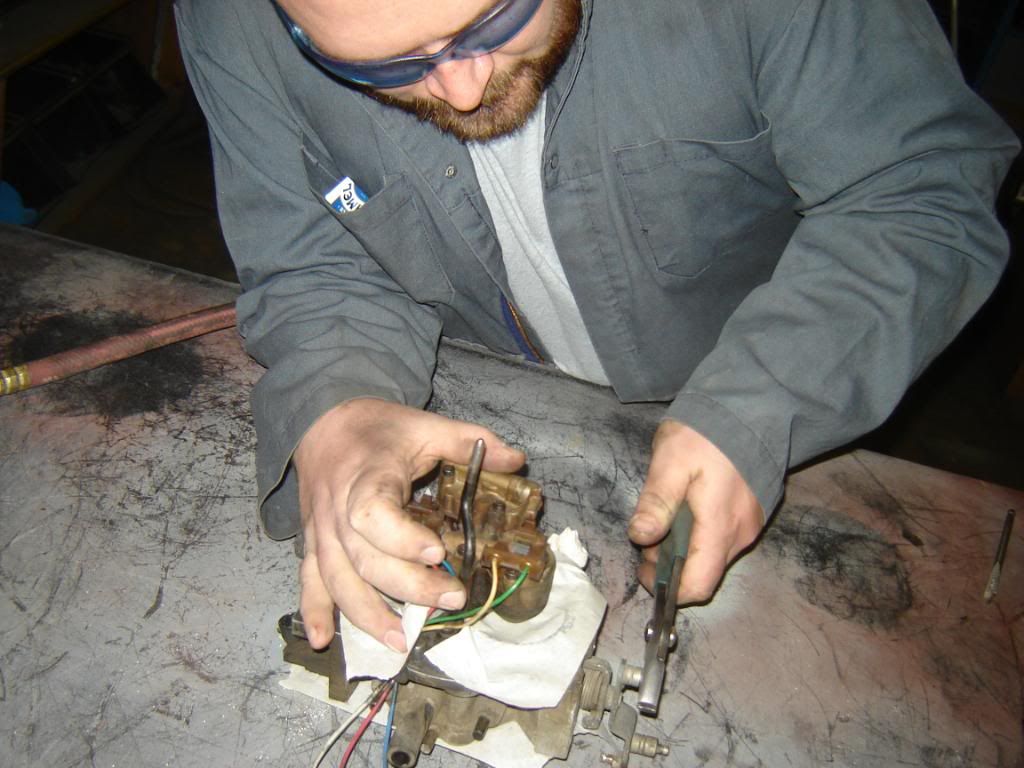

you need to grind the back of the rivet off on the TBI linkage. once you have ground the rivet off the post will come off and leave a hole for your ball "nub"

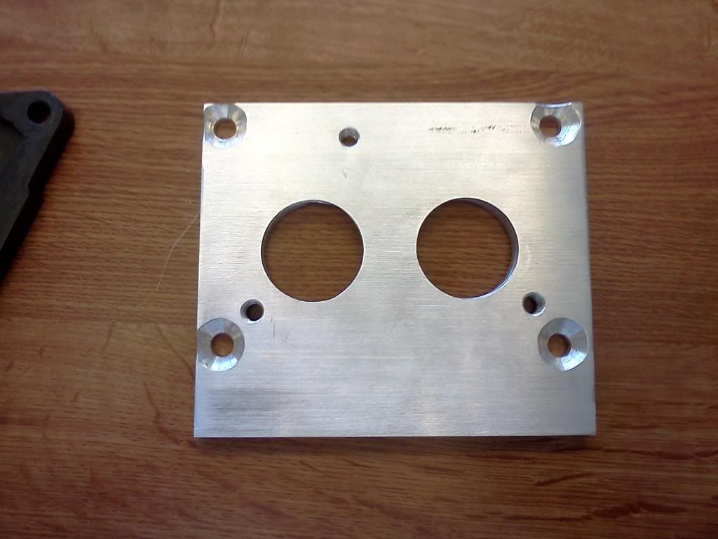

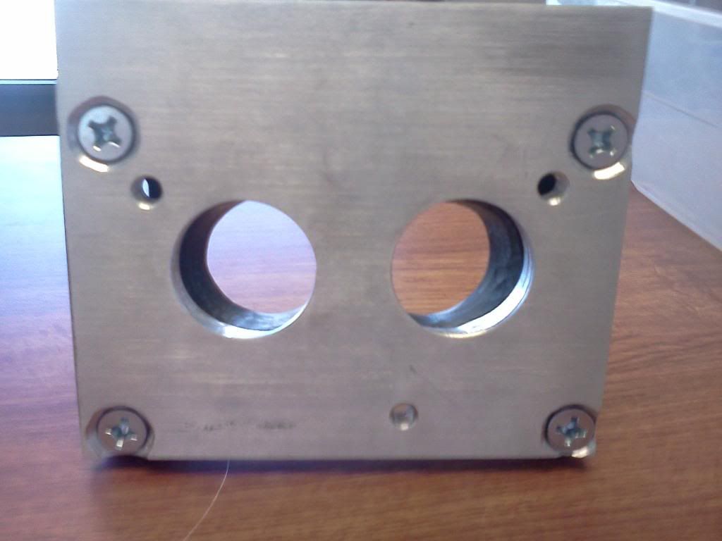

we then made the TBI adapter plate
2.8L Chevy TBI swap
the spacing of the holes is slightly wider on the gm tbi

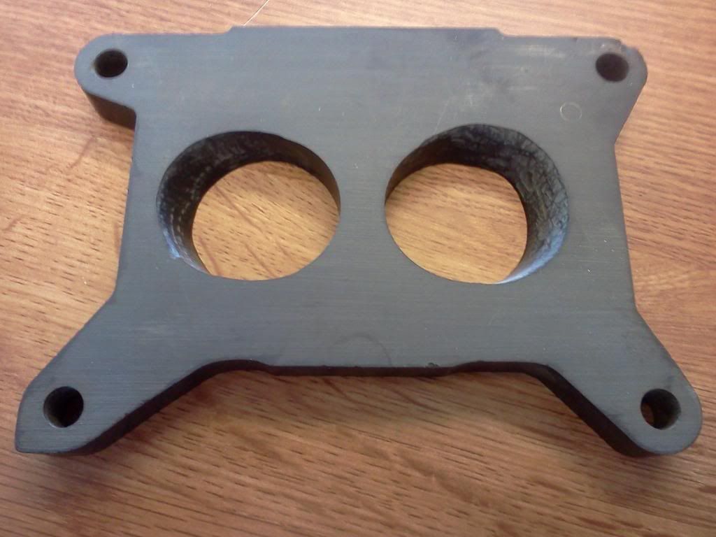

the modified Phenolic spacer:
2.8L Chevy TBI swap
the gradual modification on the top spacer:
2.8L Chevy TBI swap
with them loosely bolted together:
2.8L Chevy TBI swap

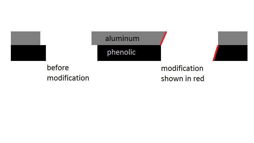

A cross-sectional view of how i used a die-grinder to modify the spacers. on the left is how the overlap was, on the right shows how i took material off 1 side of each spacer to channel the air flow smoothly, the difference was less than 1/4"
2.8L Chevy TBI swap
before criticisms fly, i deliberately left the finish rough with the die-grinder to promote atomization.

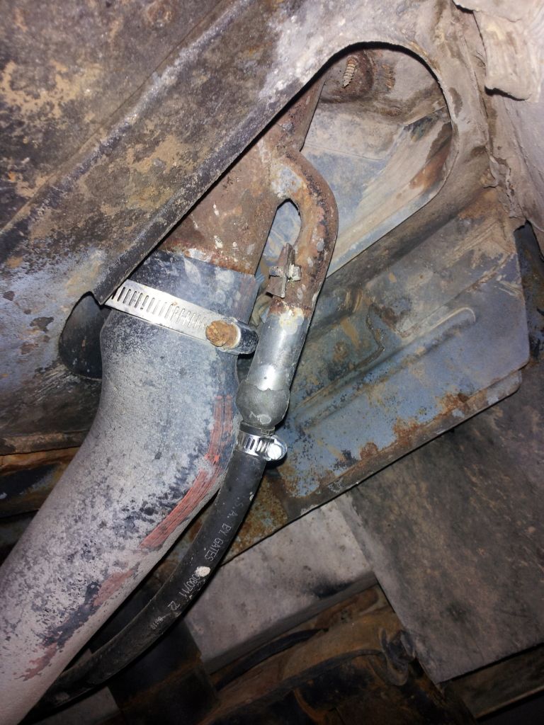

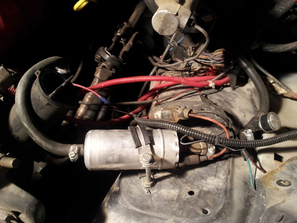

next comes the fuel pump(s), what we did was use the factory ford 2.8l mechanical fuel pump to draw the fuel from the tank, and feed the high pressure pump, which we just put under the hood.
2.8L Chevy TBI swap
This is how the return line is ran. (Ford explorer filler neck which bolts in)

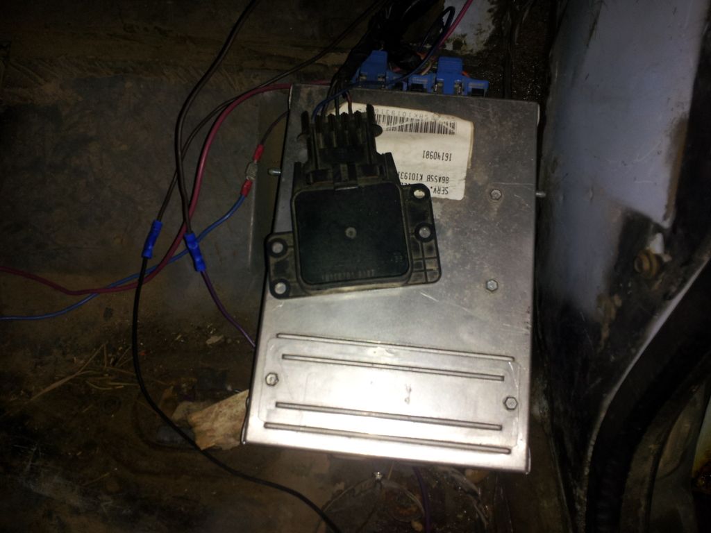

the distributor module needs to be mounted to a heat sink in order to prevent premature failure.
Rico made this heat sink as over kill to prevent failure (which caused the demise of our first module)
2.8L Chevy TBI swap

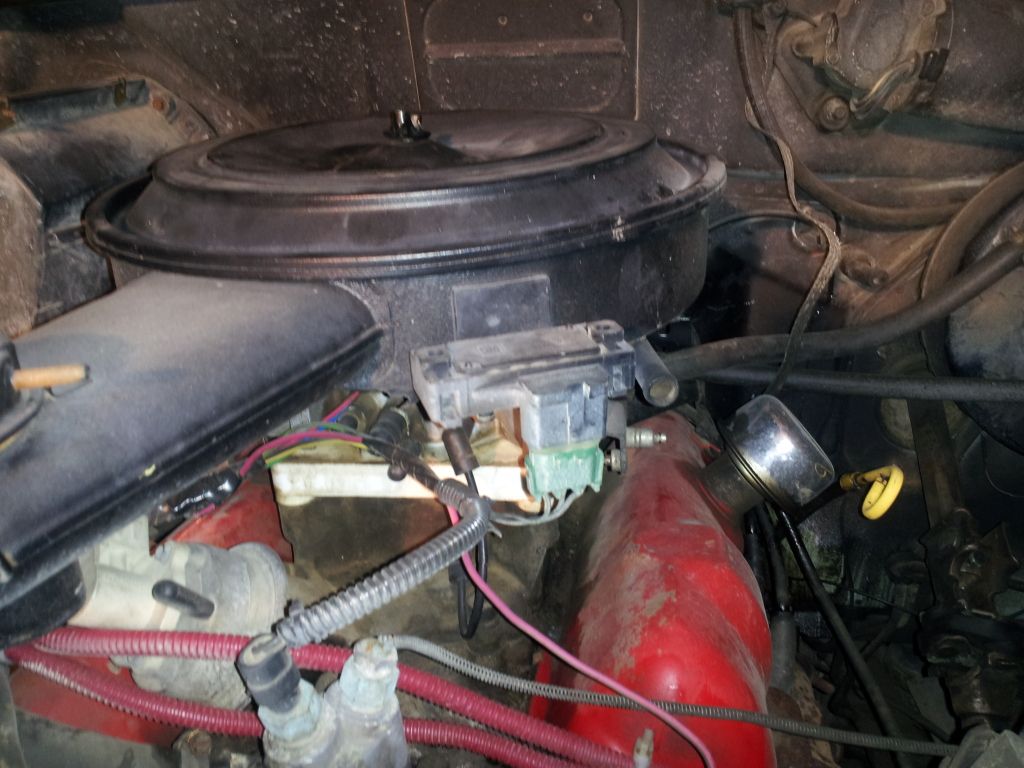

the gm air filter housing, with attached map sensor
2.8L Chevy TBI swap

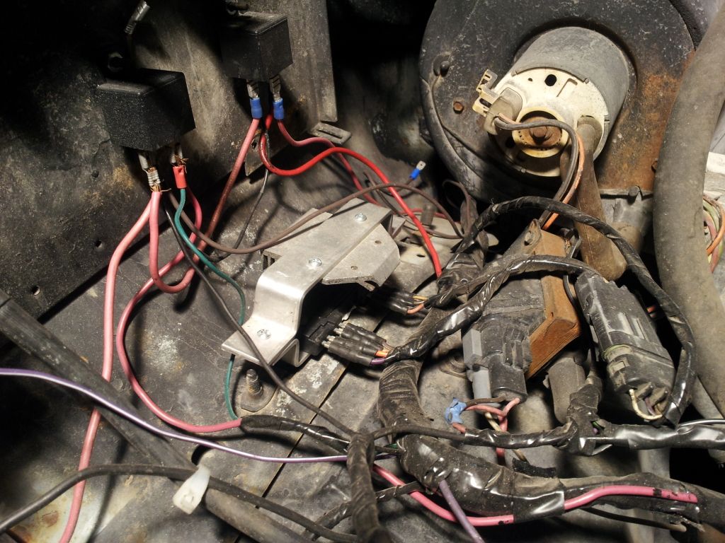

we mounted the EST module near the ECM under the dash.
2.8L Chevy TBI swap

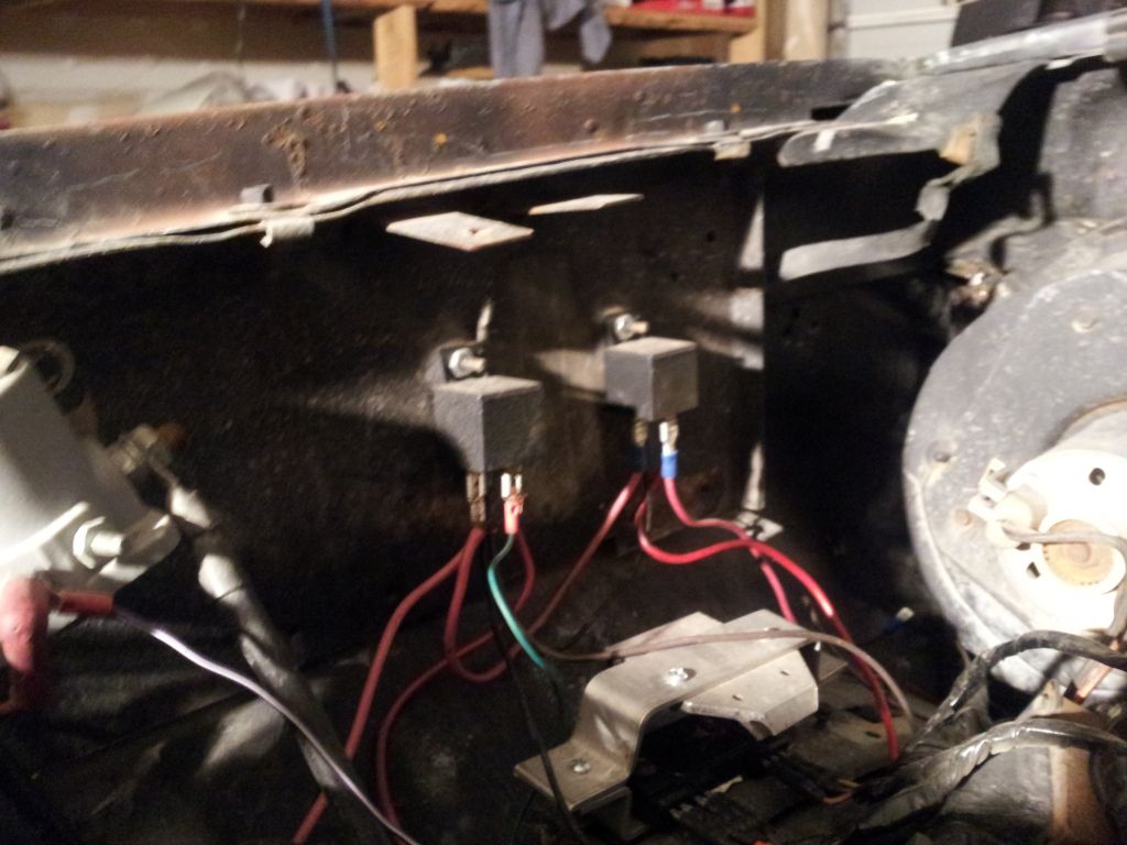

here are our 2 universal relays that we used, one is for the system power, the second is the fuel pump relay.
2.8L Chevy TBI swap
the system power relay uses the switched ignition as a trigger, and the output goes to the ecm
the fuel pump relay uses the green/white wire from the ecm as a trigger and the output powers the electric fuel pump
the ecm uses a signal from the ignition switch to know when you are trying to start, we ran this wire (purple/white) to the post on the starter relay to get the "crank" signal
