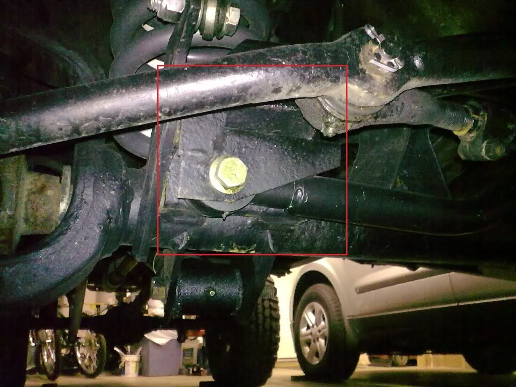

The JY doesnt have adjustable track bars, got that off a Jeep Cherokee for $20.

Your track bar mount is different than mine.
2.8 liter TBI swap
I noticed that my mount is different when i went take it off the jeep from the jy. The one i got from the jy is the same as yours. need to find out what kind of D30 i have.

Did some looking around. I think your D30 is from a Grand Cherokee
Ya from what im finding it has to be of a Grand Cherokee. The next thing need to do is figure out how to mount my steering stablerizer and track bar to it. I also need to get a new stablerizer as the one that came with my steering linkage has a huge dent in it. Still debating on getting long arms, but if i do decide to get them it may be a few months before I get them, thats when I should have the money to order them, Im also debating whether to use the coil springs I have or get some 3.5 EB coils, 5.5 coils seem like a bit to much lift for the tire size Im going for.
