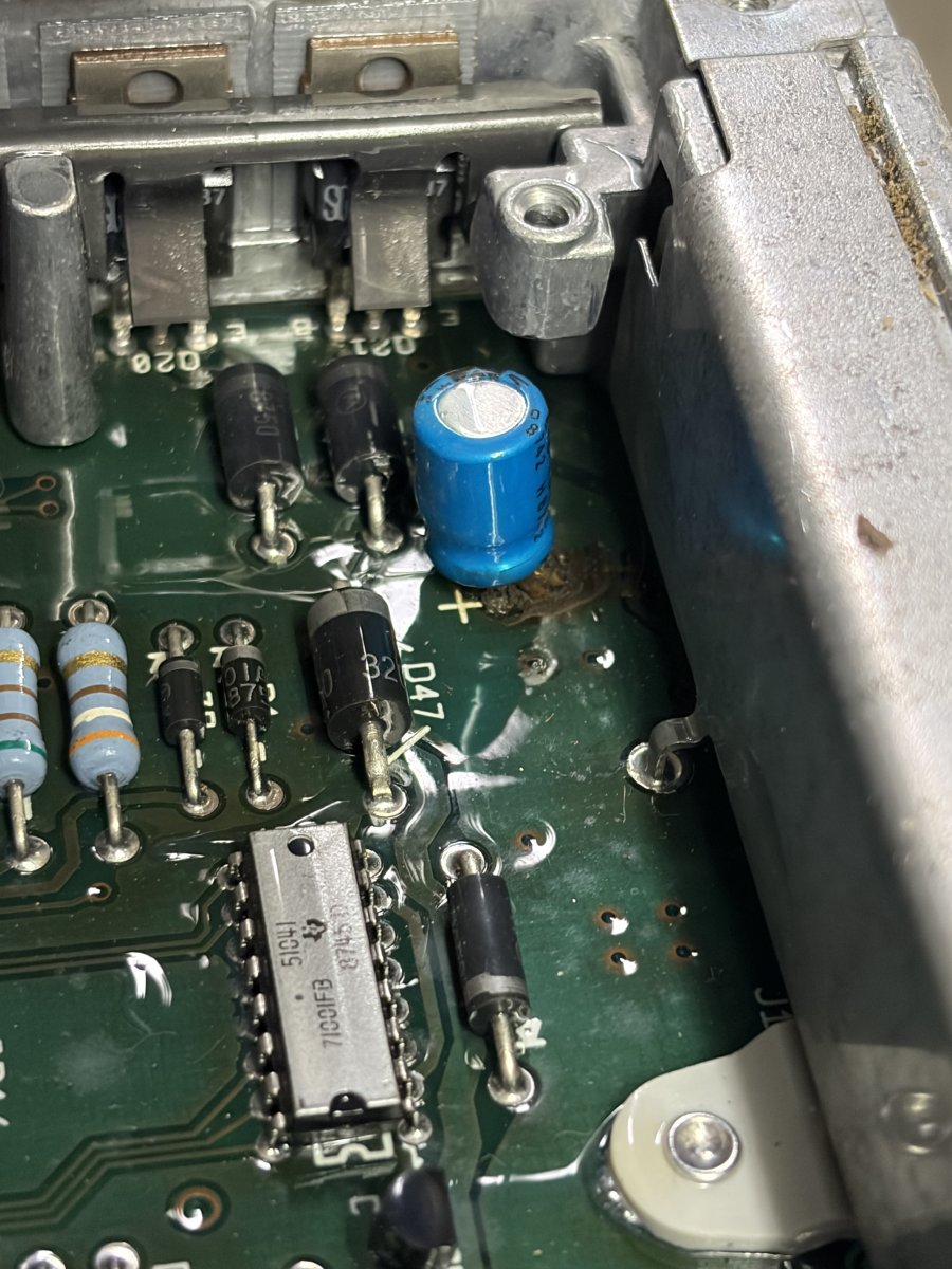

So I took out my ecm and I found what looks to be a burnt spot. Could this possibly be my issue and if so are they all the same for a manual transmission? I thought about trying to fix it but not to confident.

That blue cylinder looks like a capacitor that has leaked. Apparently fairly easy to solder in a new one. Couldn't hurt to try before buying a different ecu.

I’ve never soldered anything before. I’m going to look into it. Hopefully this is my problem. I was about ready to junk the truck
That silly little $0.50 capacitor definitely can cause random problems... the dumb thing about this stuff anymore is you can't go to Radio Shack and get one for $0.50, soldering iron for $6 and solder for like $2, you'd have to order it online somewhere (there's options like digikey or mouser and such) just look for capacitors with whatever Farad reading that one is and get any generic soldering iron even the cheap one from Harbor Freight or Walmart and some solder.. If I remember right on that type of capacitor you want the black line to be on the same side as what you have now as they do have a + and -.

I agree it looks like there is a mess under that cap. If you see a few other similar capacitors, replace them all. I should add that job to my video collection for people.

I got it ordered and now I just have to wait for it to get here. I got my fingers crossed this fixes it
Capacitor didn’t fix it. Took out the injectors today. I bought a tester/cleaner it’ll be here Friday. After that I’ll have done everything I know to do.
