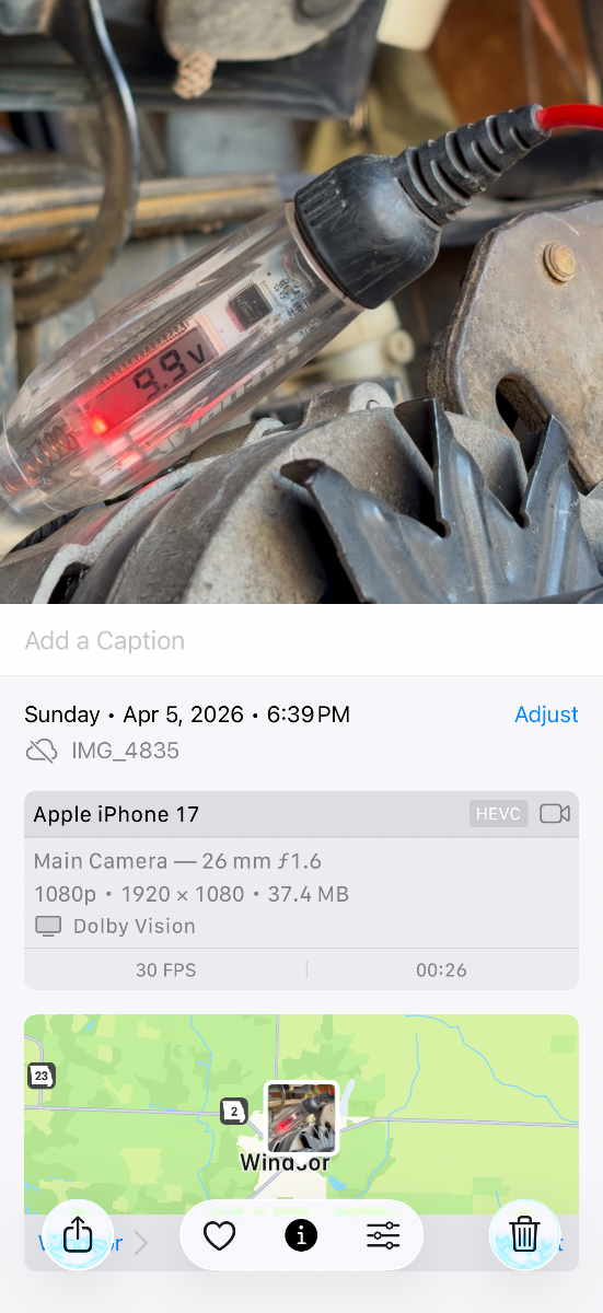

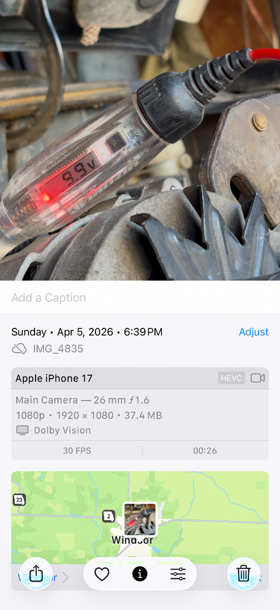

My test light is only reading 9volts at the injector. It drops while I’m cranking it so I’m guessing they’re getting signal
  • 2.3l
