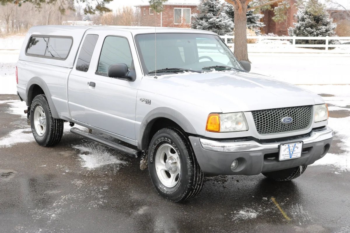

I am planning on getting a fiberglass camper shell something like this.
Note: Mine isn't an extended cab, and I have the alloy 15in rims.

I once had a 1984 Ranger that was a 2.0L 4 cylinder 4 speed short bed that I bought a used cap for the bed and I noticed there wasn't much a difference in power if at all since it was already underpowered to begin with.
With that size tire and 3.73 gears I would expect to be downshifting on inclines at highway speeds. The duratec has more power than the Lima but at higher rpm... That's the size tire I run on my Lima with 4.10 gears and it does fine but I have to downshift to 4th up some hills... RPM is your friend...
That said, the canopy will be fine...
