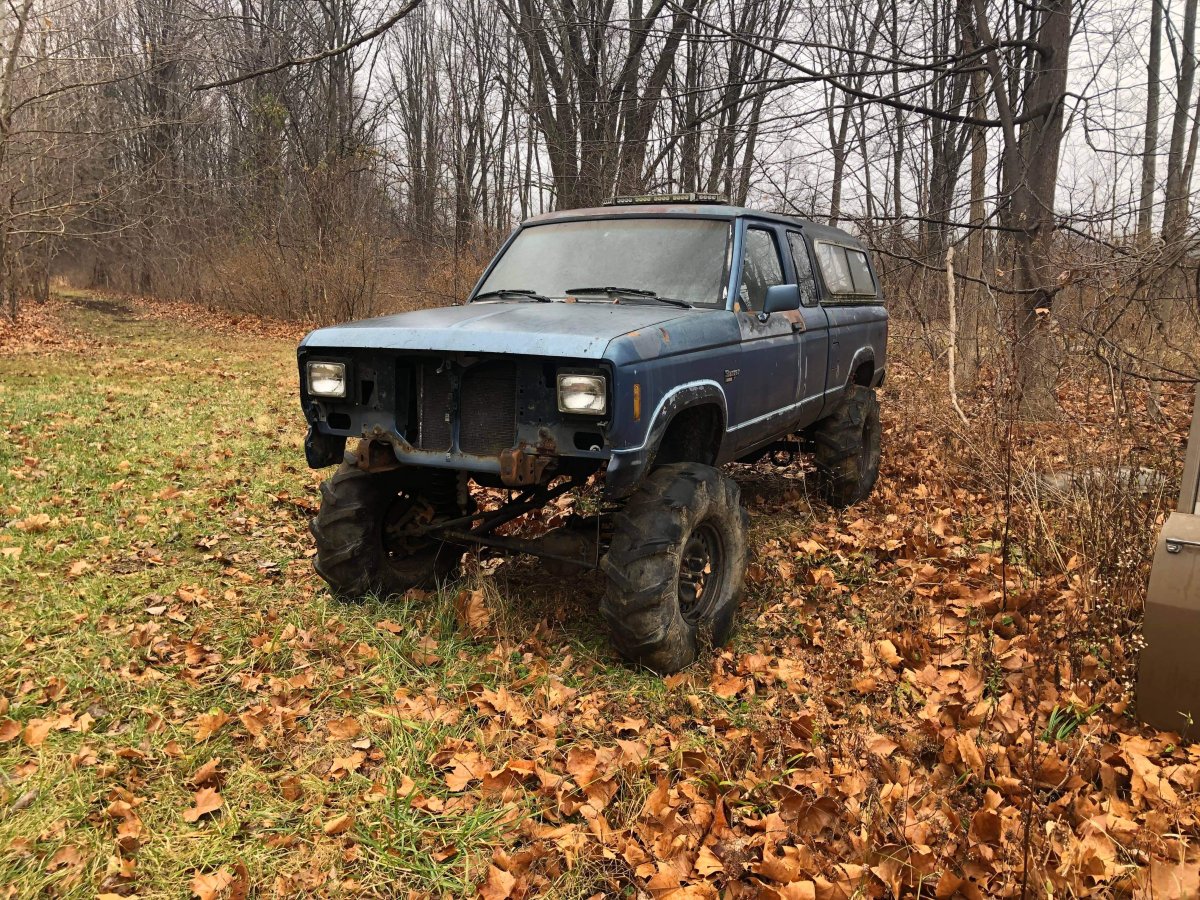

here is the current ranger. It’s lifted tall with jeep axles and tractor tires but that’s all going

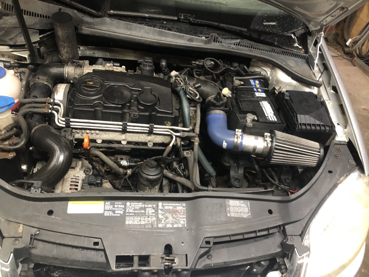

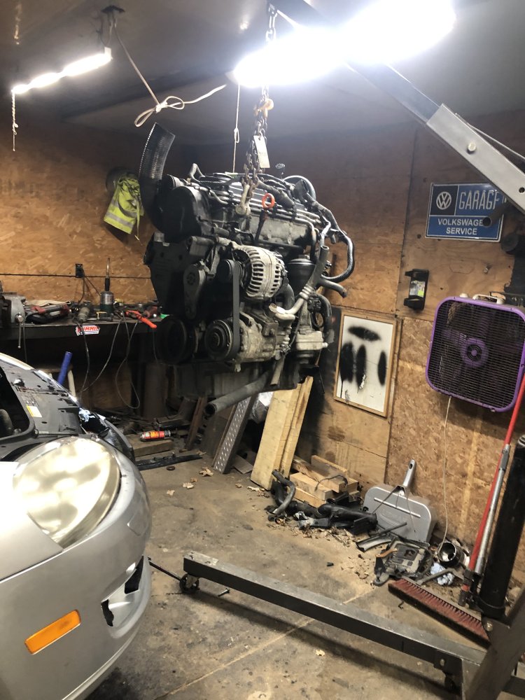

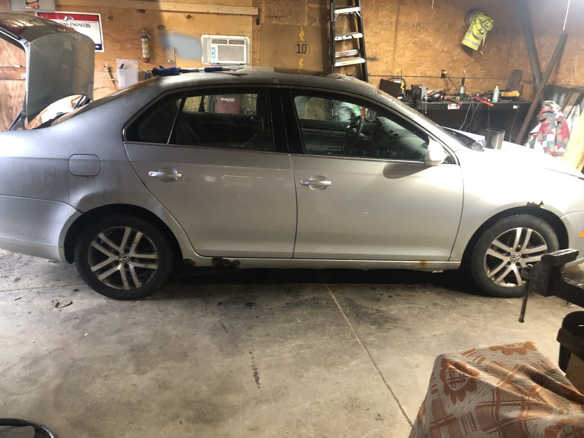

So far I have stripped my last daily driver which was a 2006 Volkswagen Jetta and saved the engine and all the wiring.

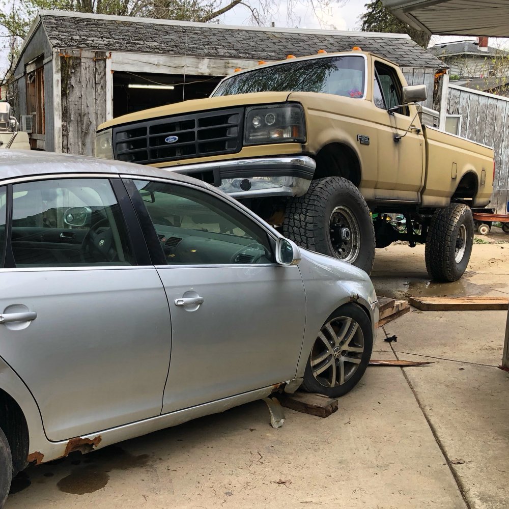

One of my 2 OBS daily drivers attempting to crush the Jetta before the scrap guy comes to get it lol

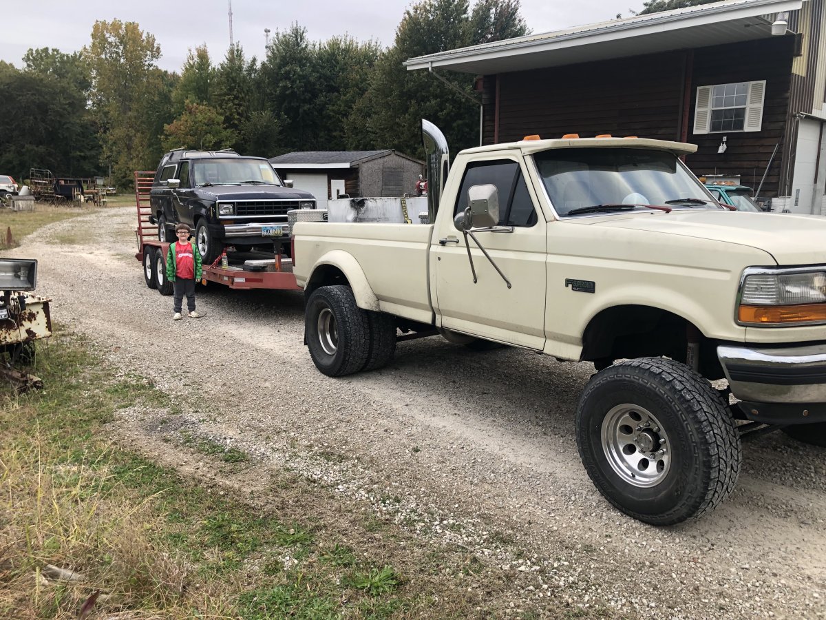

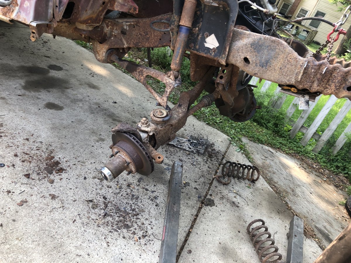

Next I acquired what was left of a 95 f150 for the front ttb and rear axle. I also saved the coil buckets, not sure if I’ll be able to repurpose them on the ranger.
1st gen TDI ranger, prerunner style build.

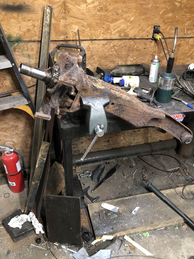

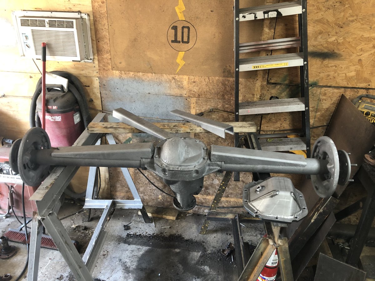

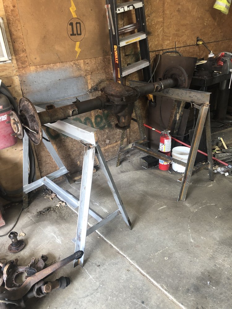

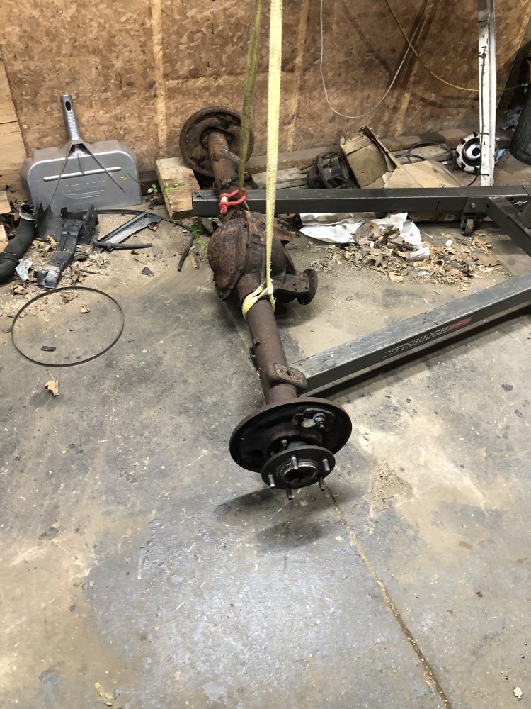

So naturally I live in Ohio so everything’s super rusty. I stripped everything down and to start, I took the rear axle to the sandblaster. I’m going to start with the rear axle, get it regeared and done up the way I want then move on to the front.

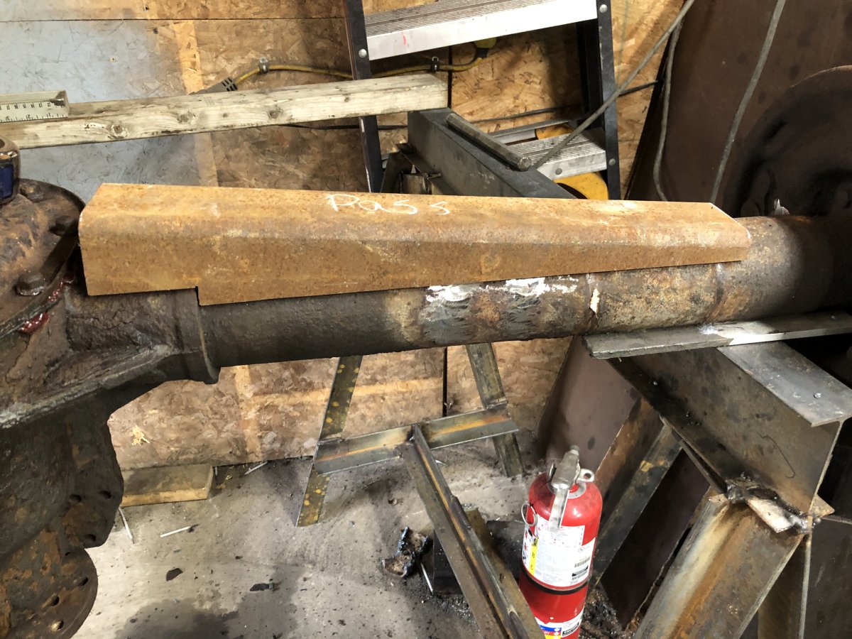

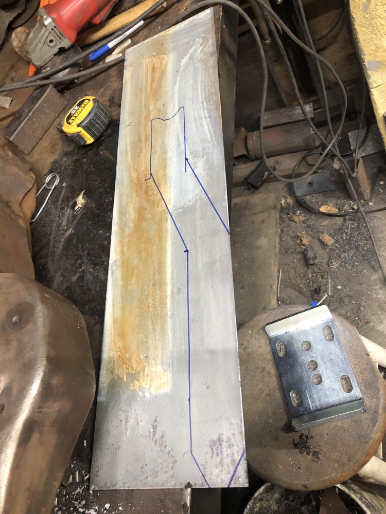

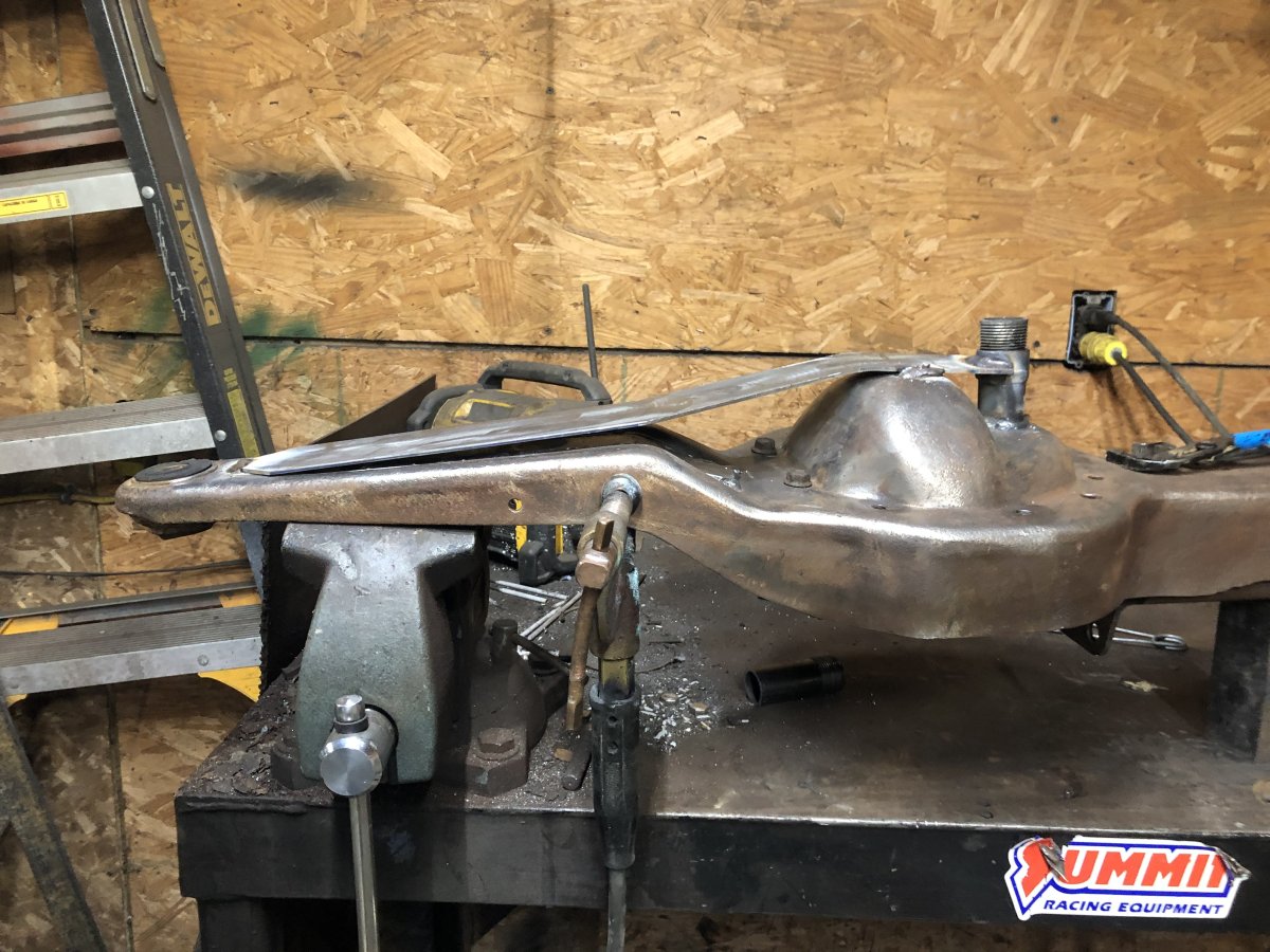

I started messing around with making a truss of some kind.

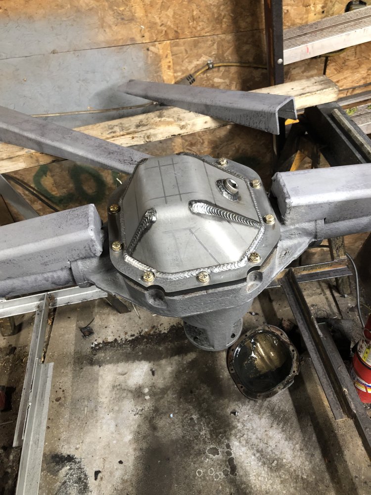

I ordered a diff cover from Ruffstuff

and back from the blaster

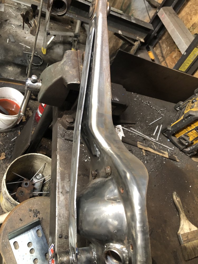

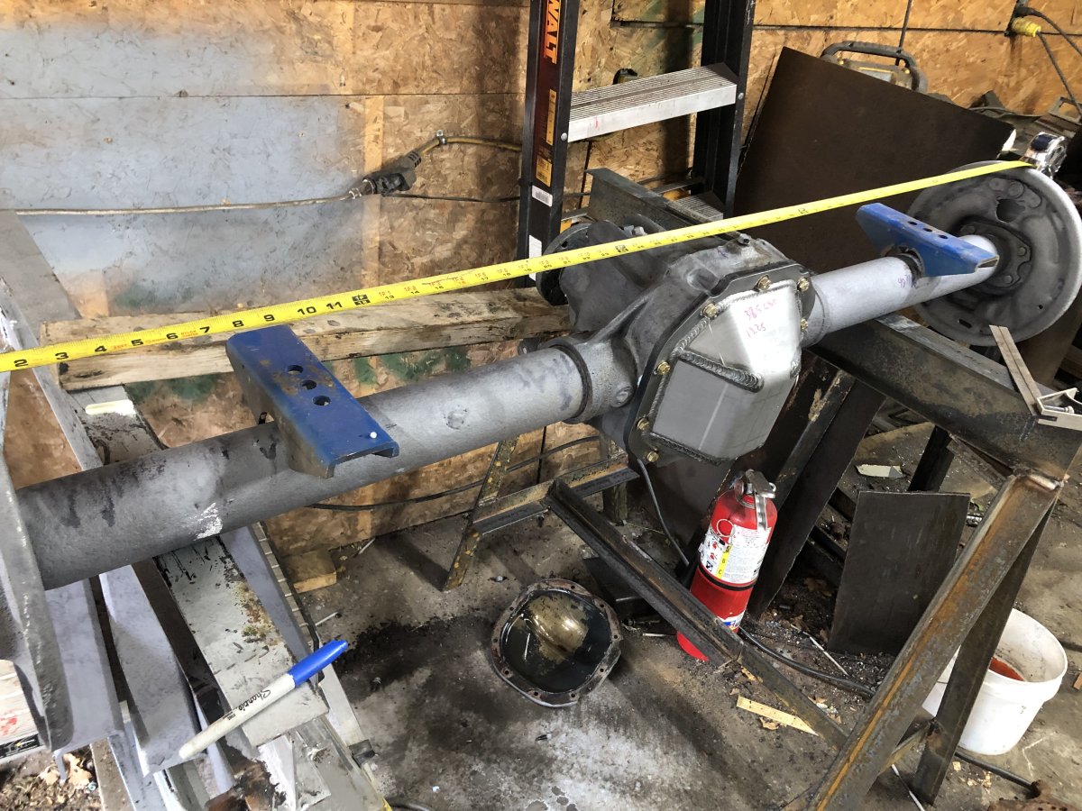

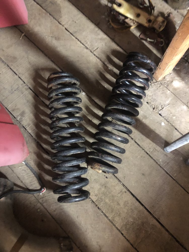

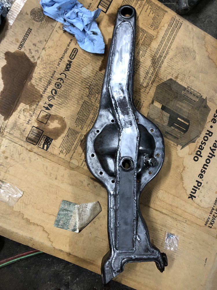

Getting an idea where the spring perches need to be

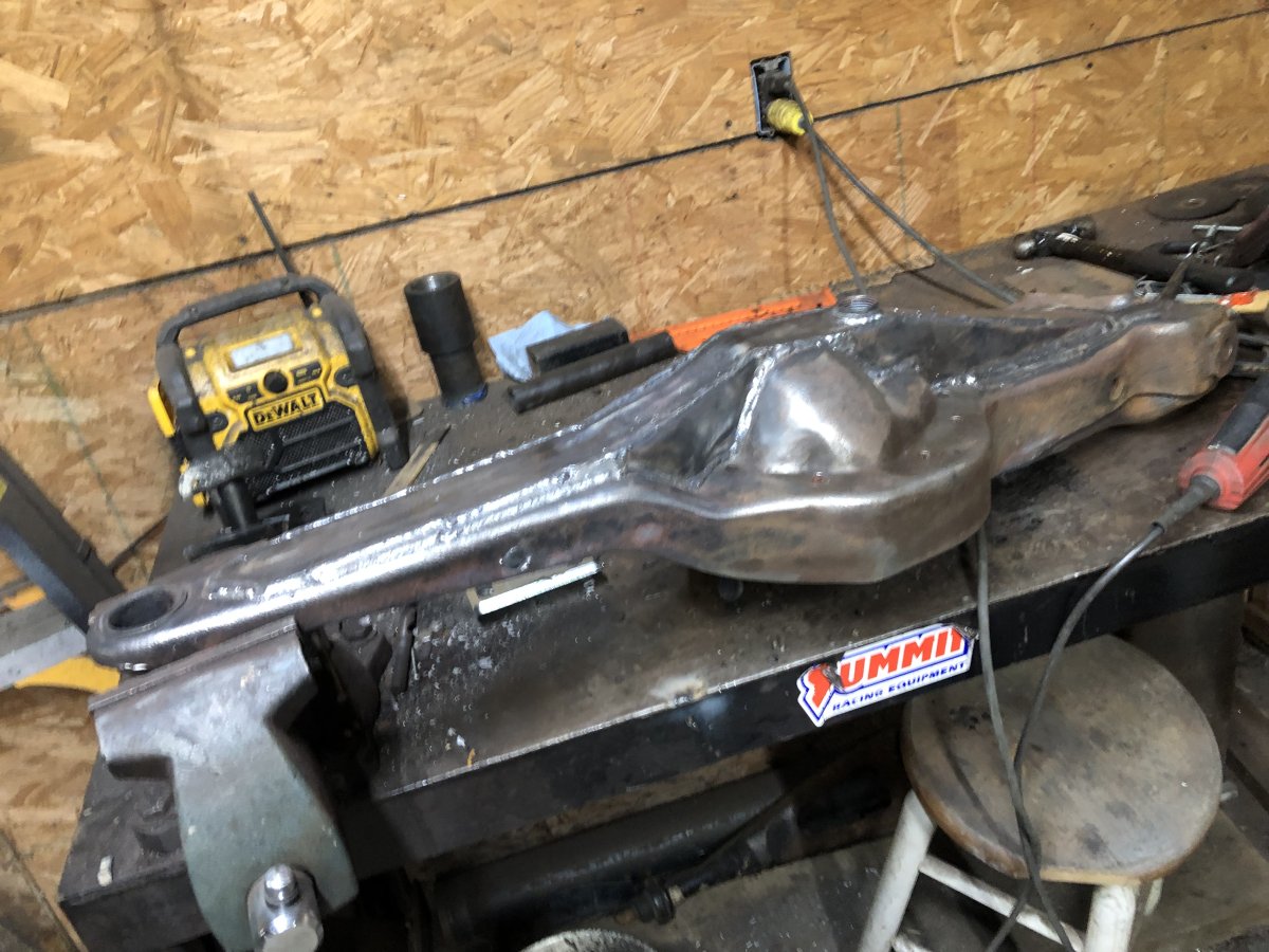

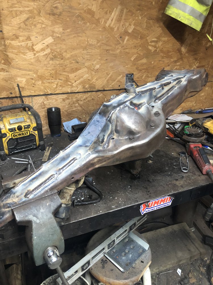

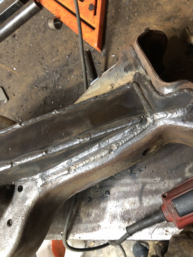

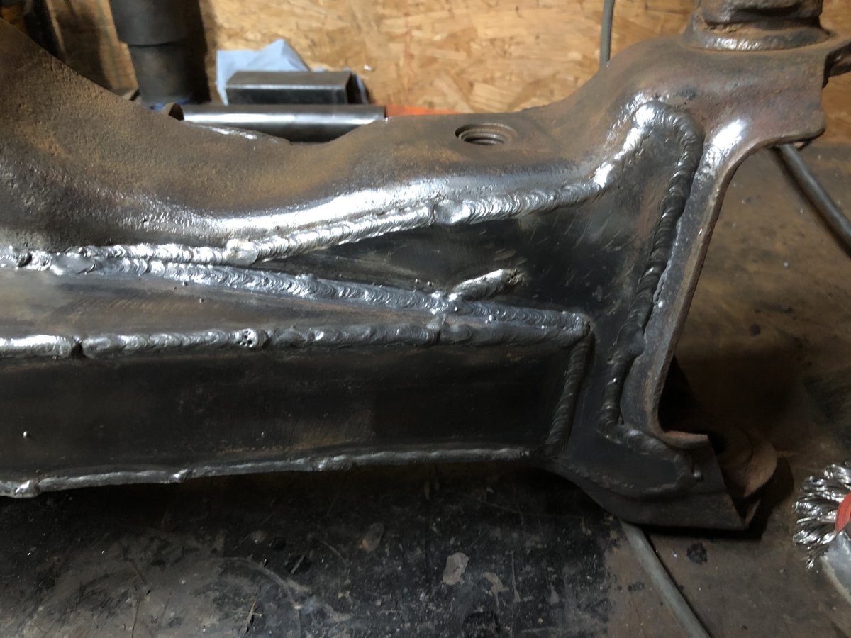

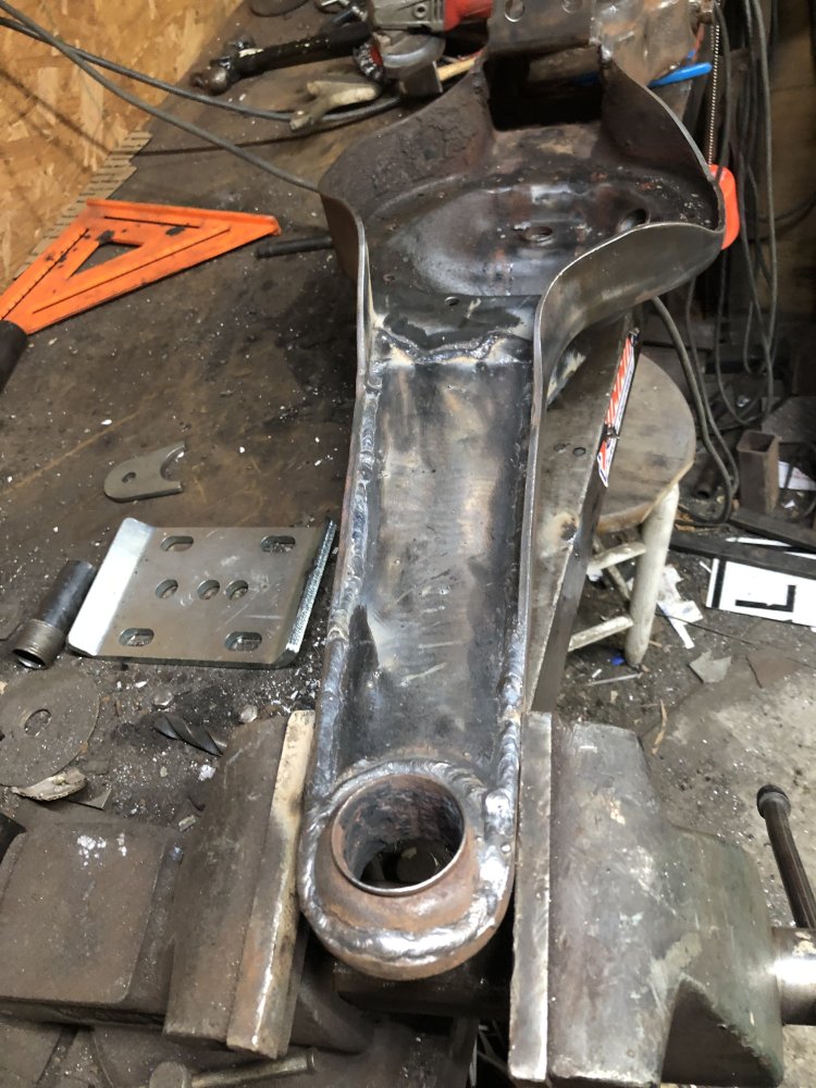

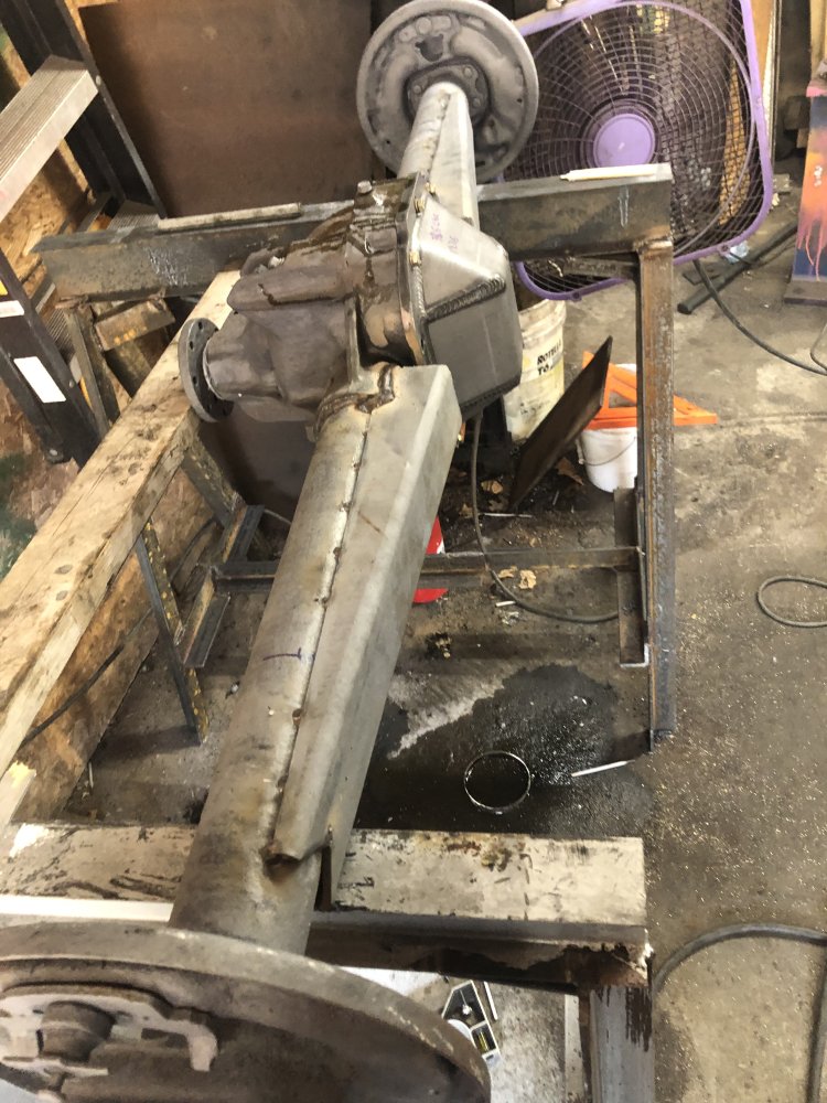

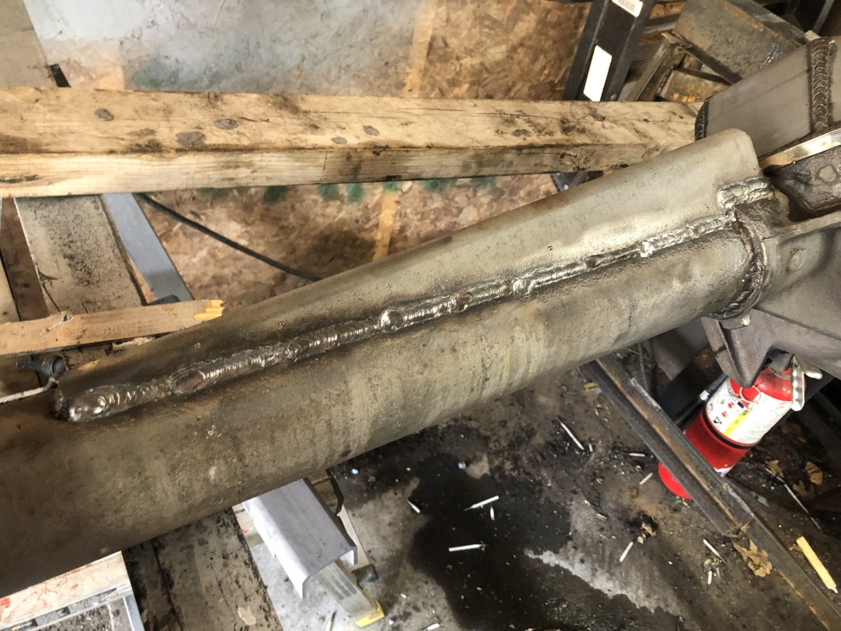

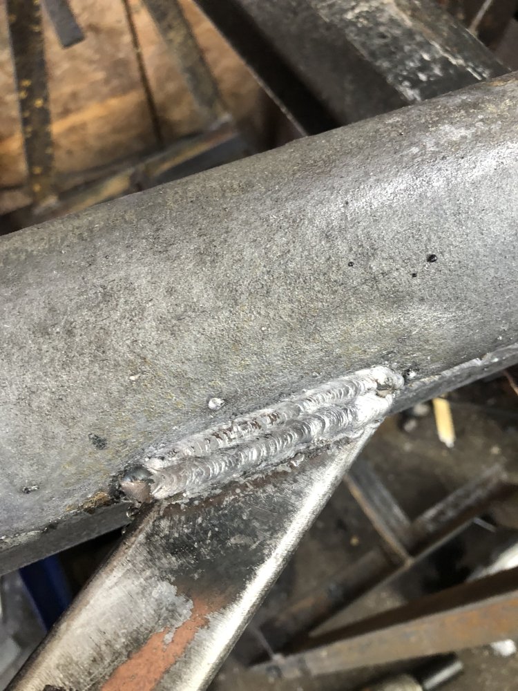

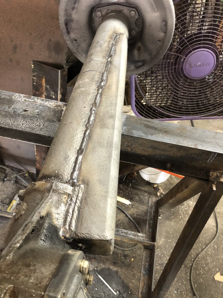

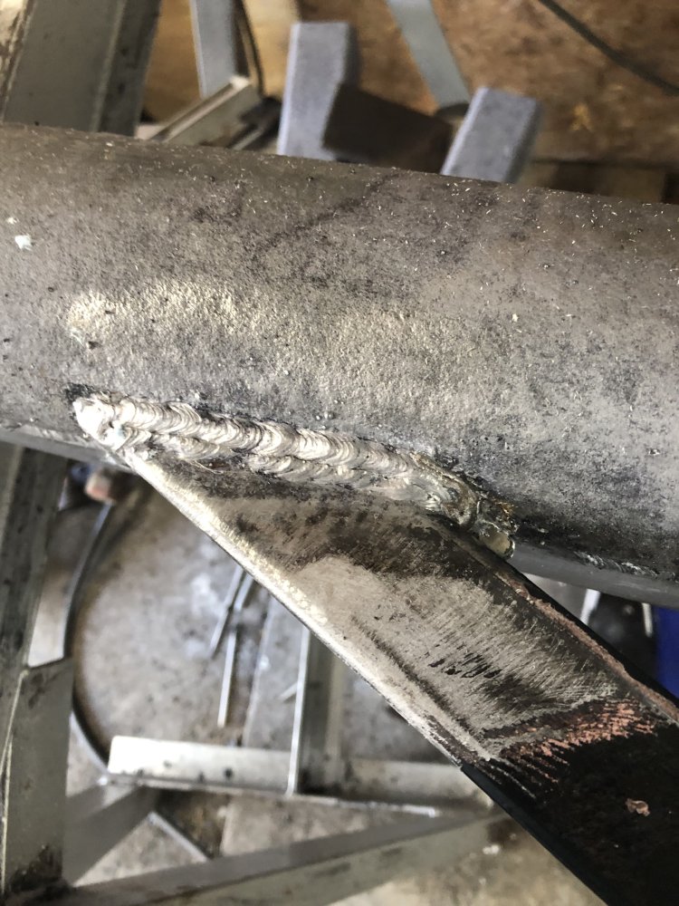

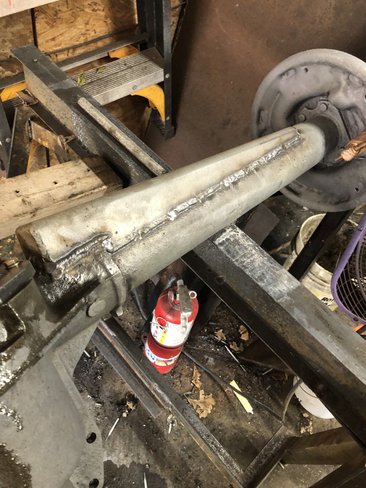

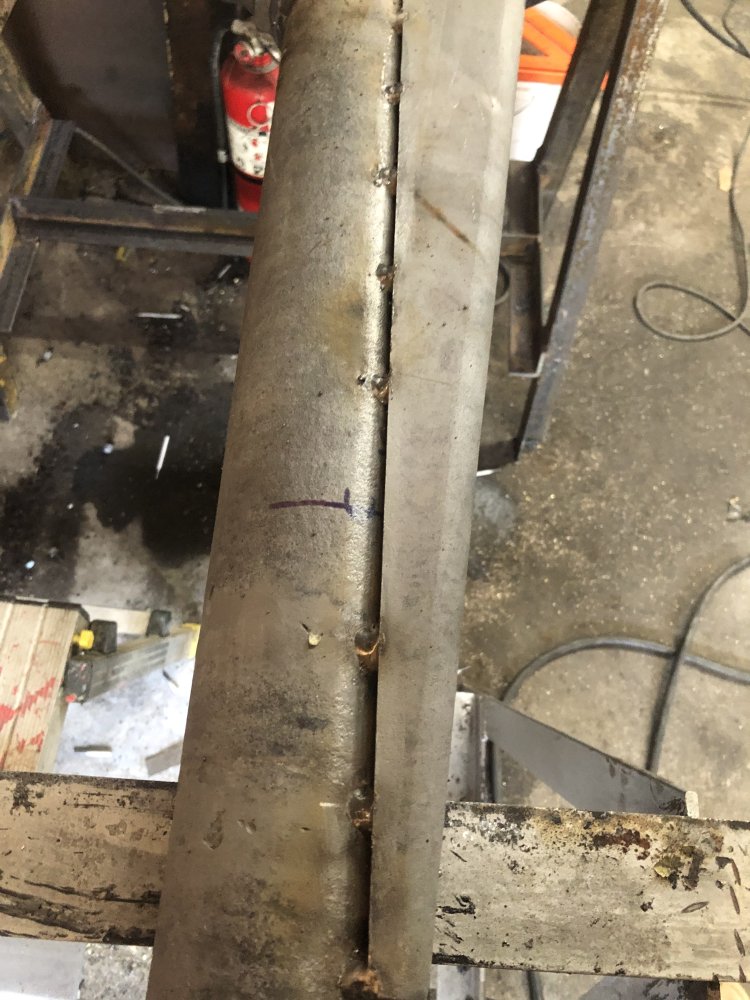

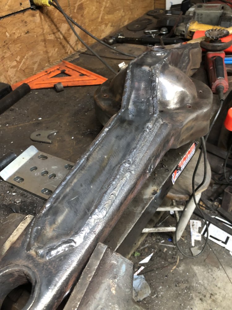

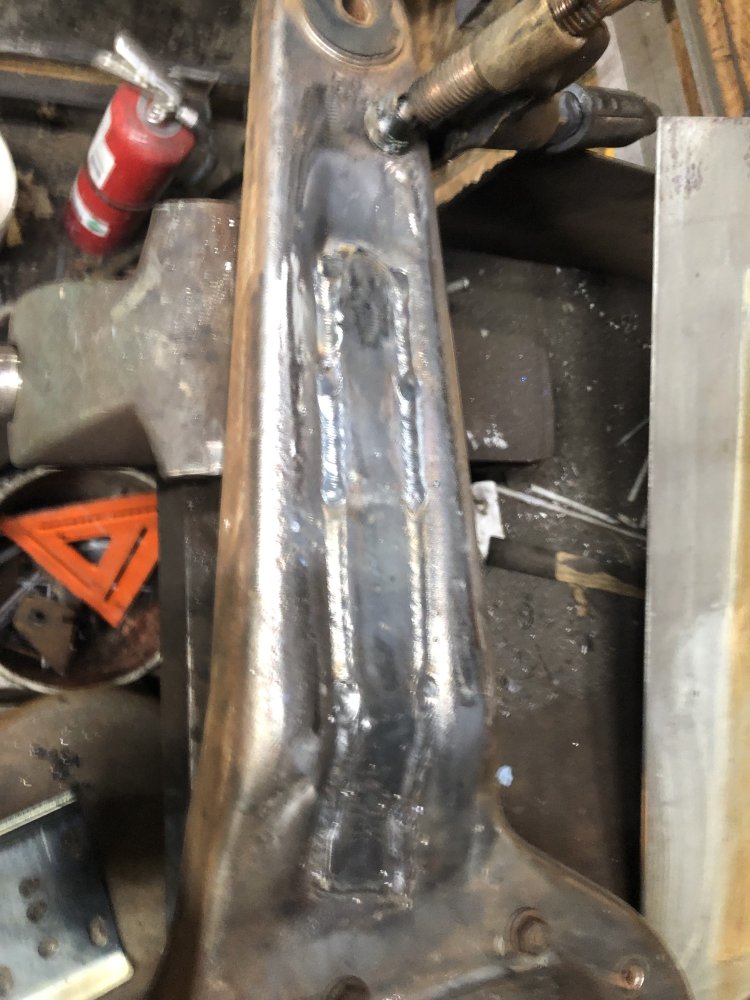

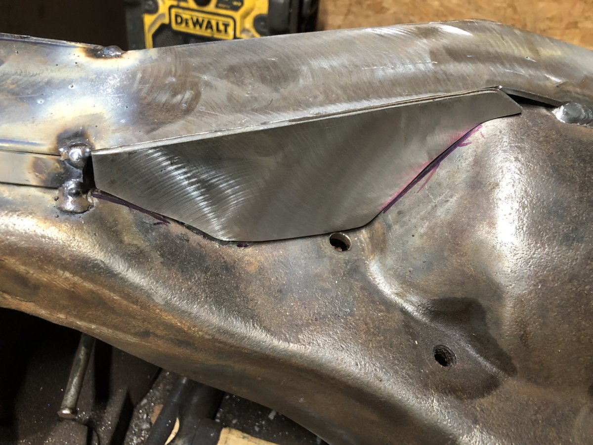

I finally got around to welding some bracing on my full size 8.8. Is it necessary? Idk but I do plan to jump this thing at least once lol
I welded every other 2” stitch then came back and welded the rest hoping nothing would warp. Seems ok

Reused a crossmember I had laying around. Everything is recycled.

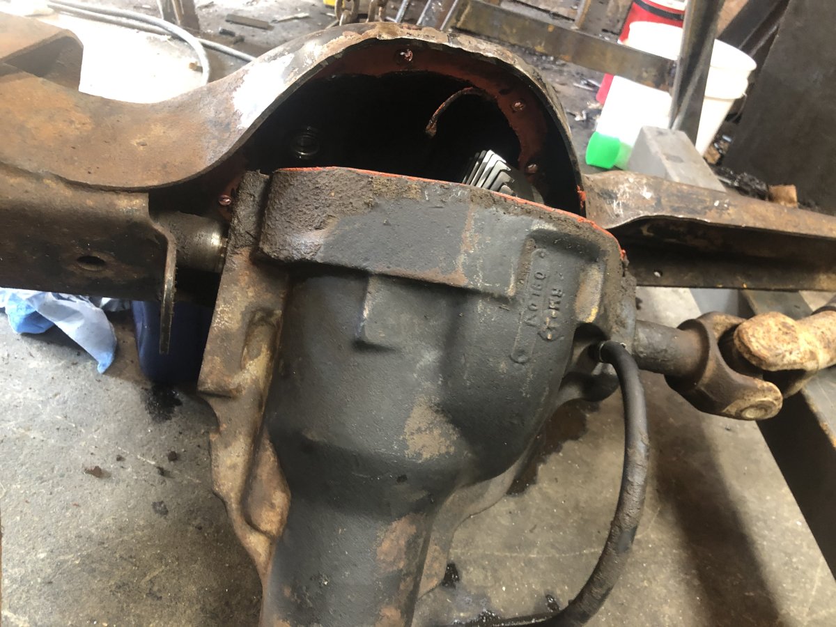

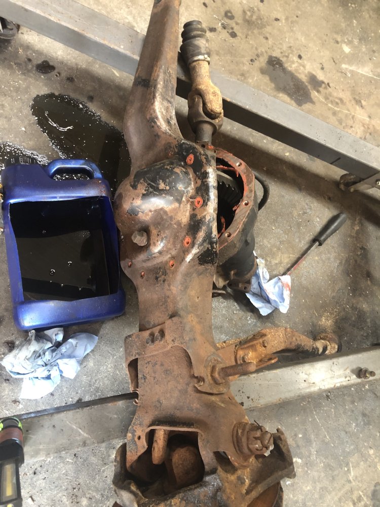

Haven’t done much lately. I drove a few hours for a Dana 44 that supposedly had 4.10 gears. Took it apart when I got home and it is 3.54 so that sucks. But these beams are cleaner and I got 4” lift coils with them.

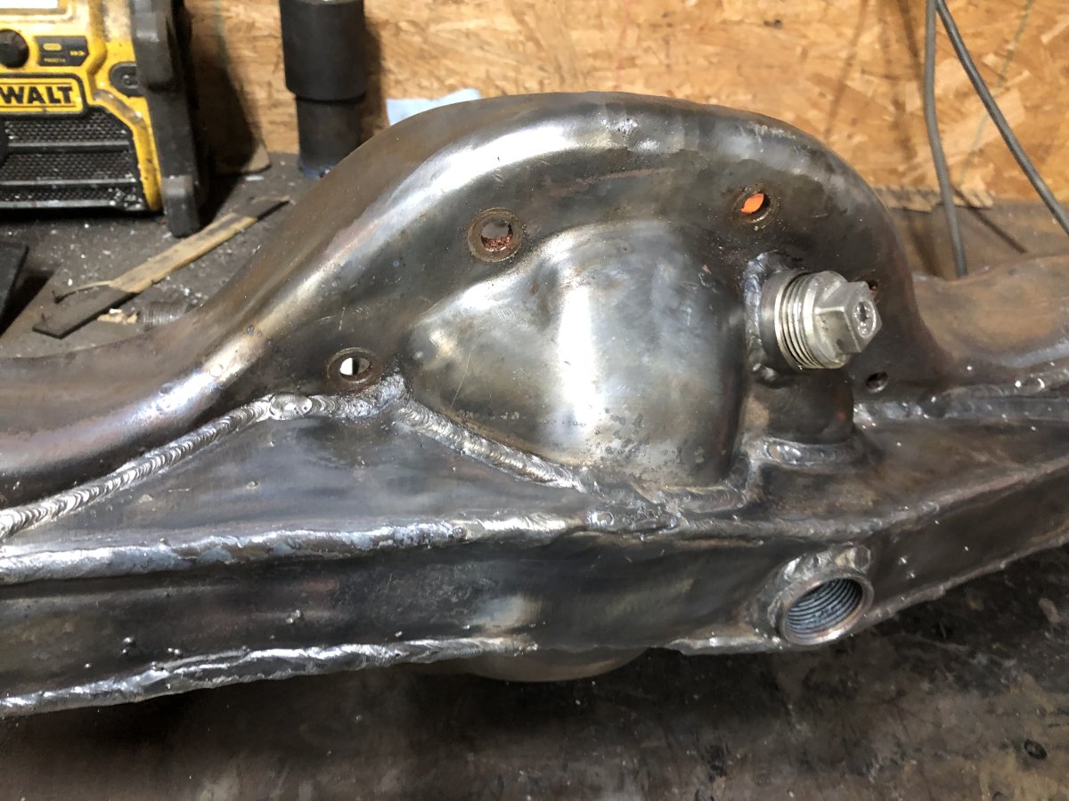

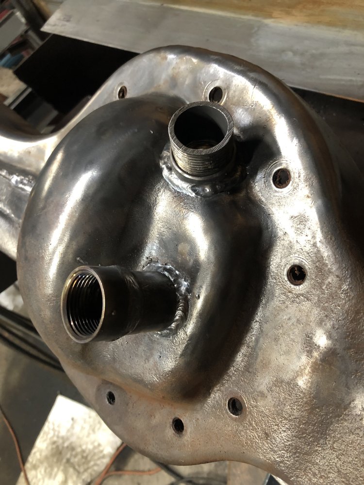

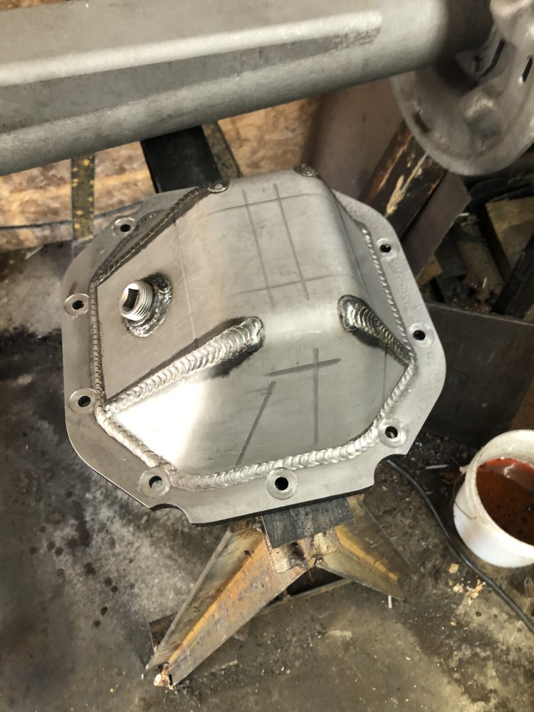

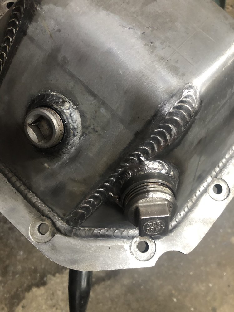

also added a fill plug to the 8.8 diff cover, I’m going to put a sight glass in the level hole.

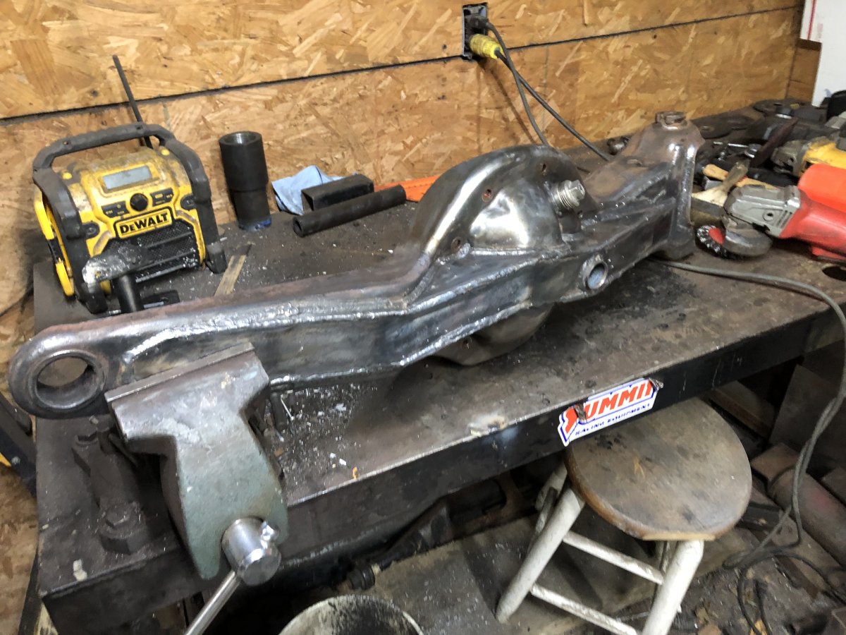

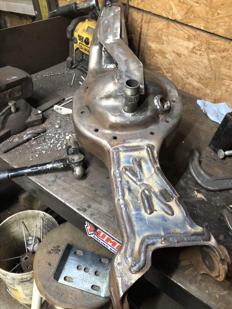

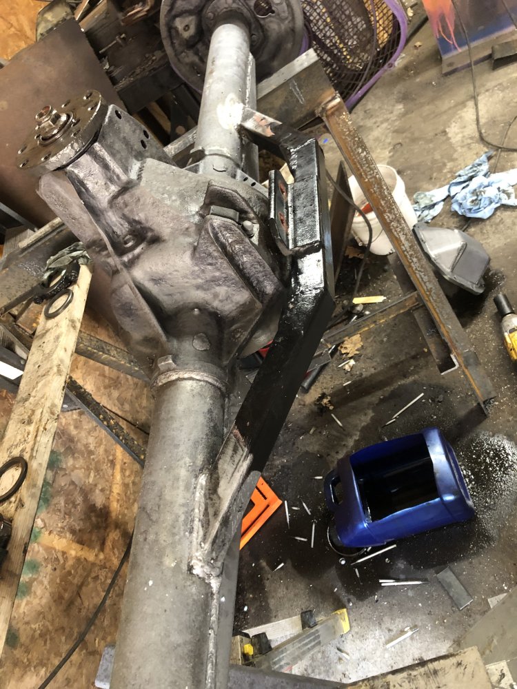

So I made some bracing for the driver side beam. As well as added a fill plug

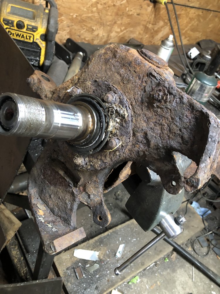

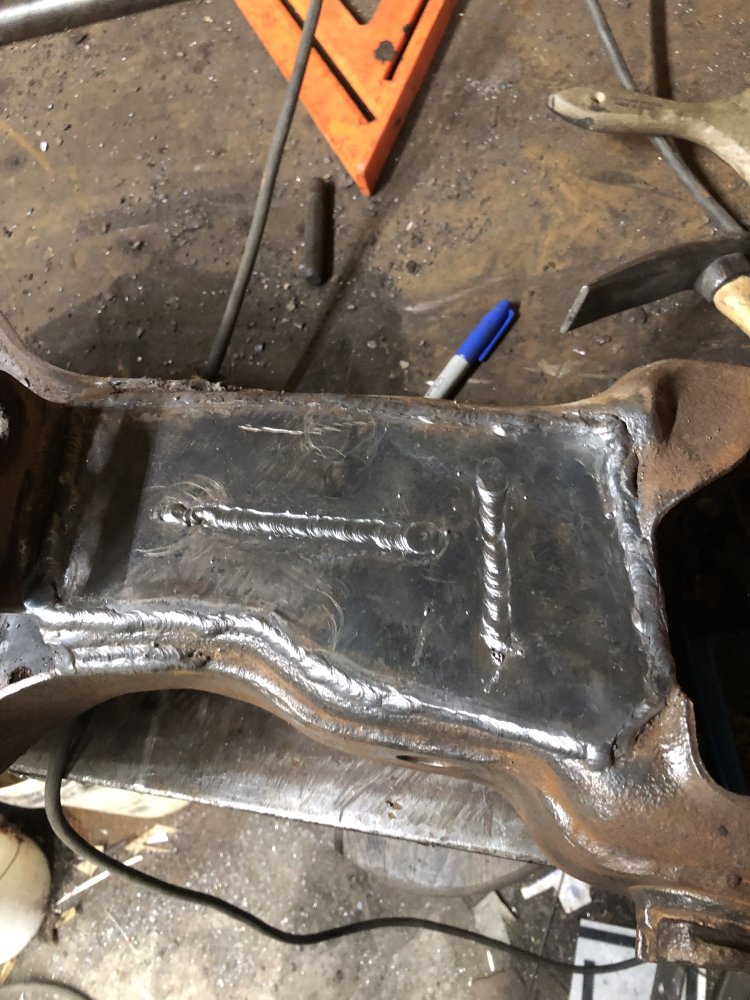

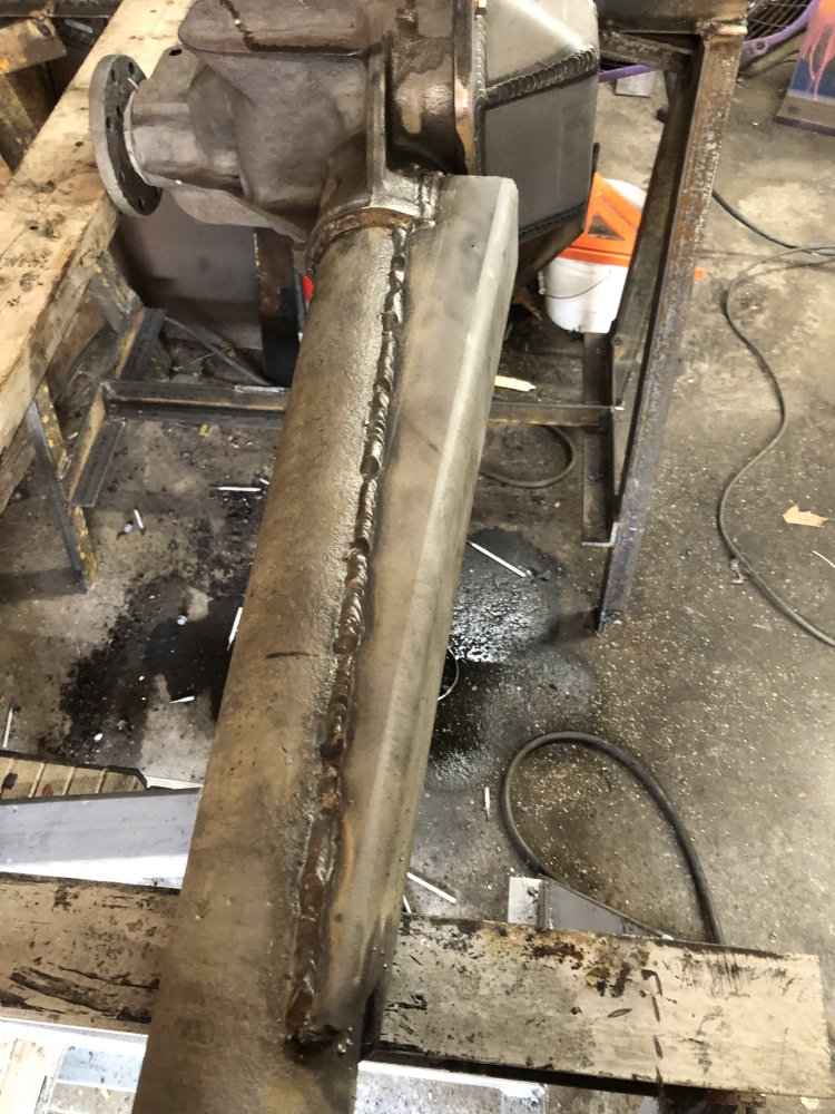

it might not be the prettiest but I’m using an old tombstone welder. I sprayed it with Eastwood after blast so it won’t rust while it sits. Passenger beam next. Then I still need to rebuild the 8.8. Once both axles are done then I will bring the ranger home.
  • 1st gen TDI ranger, prerunner style build.
Nice job. Might want a drain plug, also. To me, that’s the irritating part about a TTB axle.

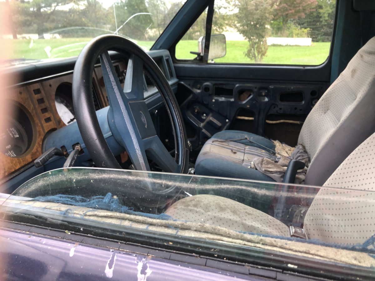

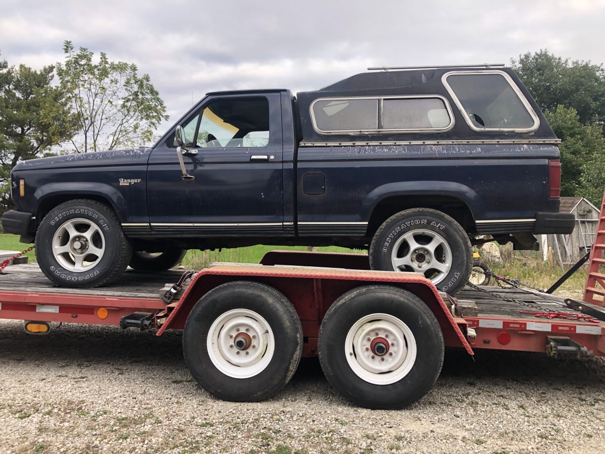

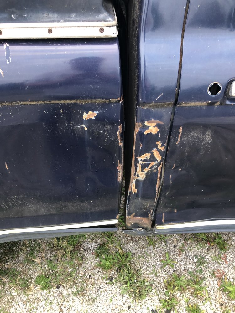

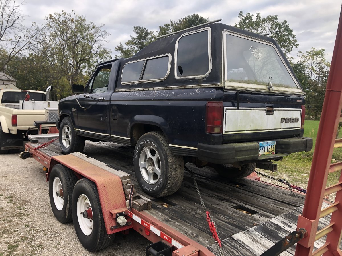

So I haven’t posted in awhile…a friend called and said come get this ranger. For free. It’s rust free from North Carolina, just has some damage at the B pillar, bed and door. 2.8 5spd 4x4 been sitting for 15 years.

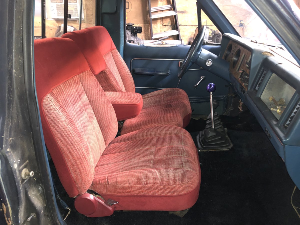

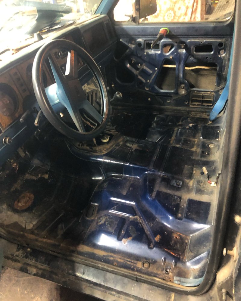

so I’m not sure if I’m going to use this for the TDI swap but a free, complete truck could really speed things up…

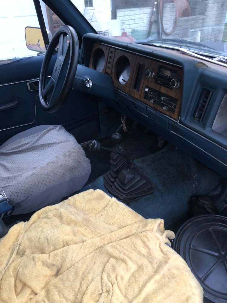

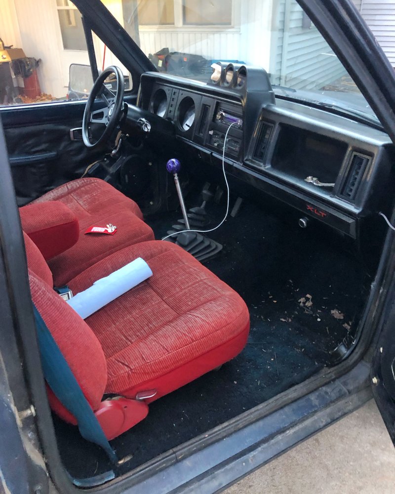

I stripped the interior and pulled the dash in search of all the mice nests.

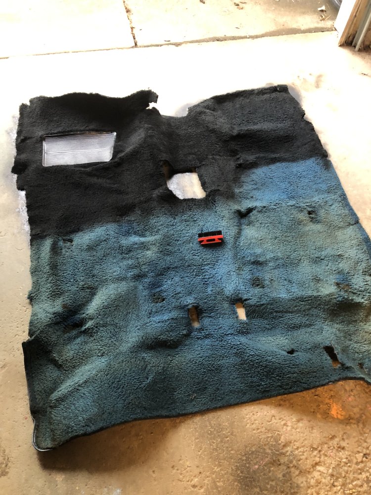

Dyed the nasty carpet after washing.

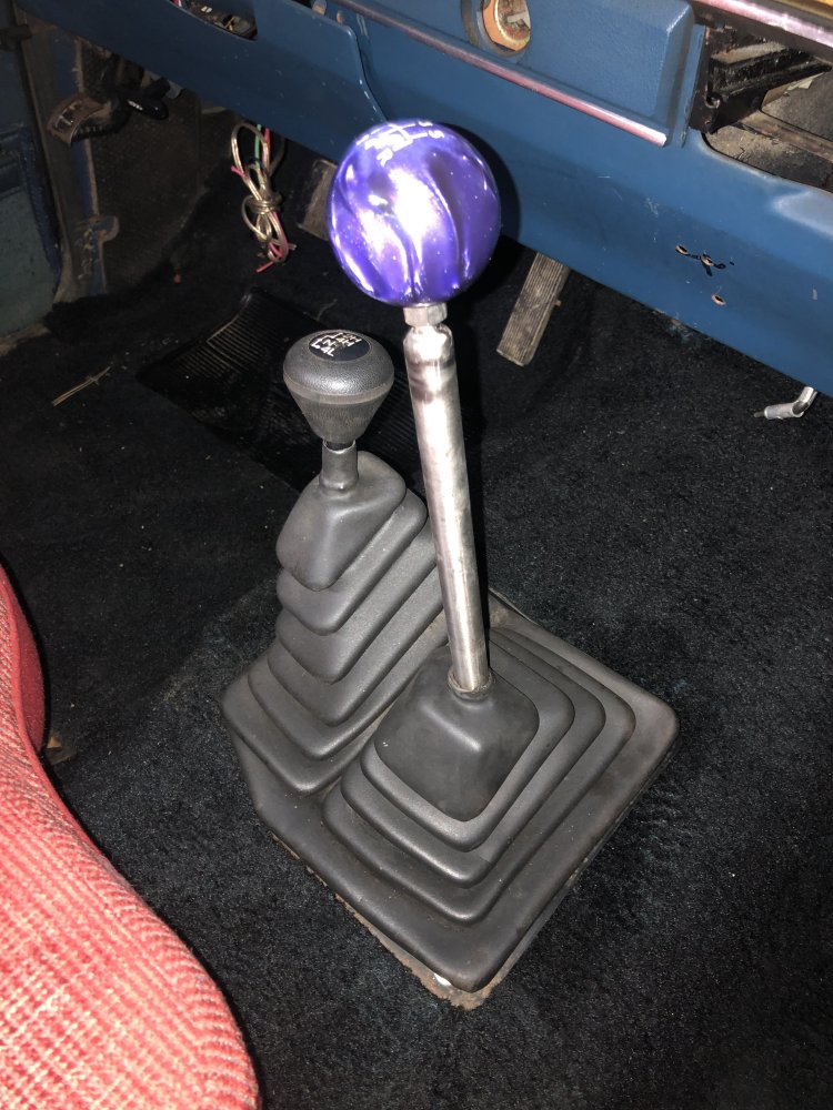

made a shifter from stuff laying around
put seats I had been storing Up stairs in.

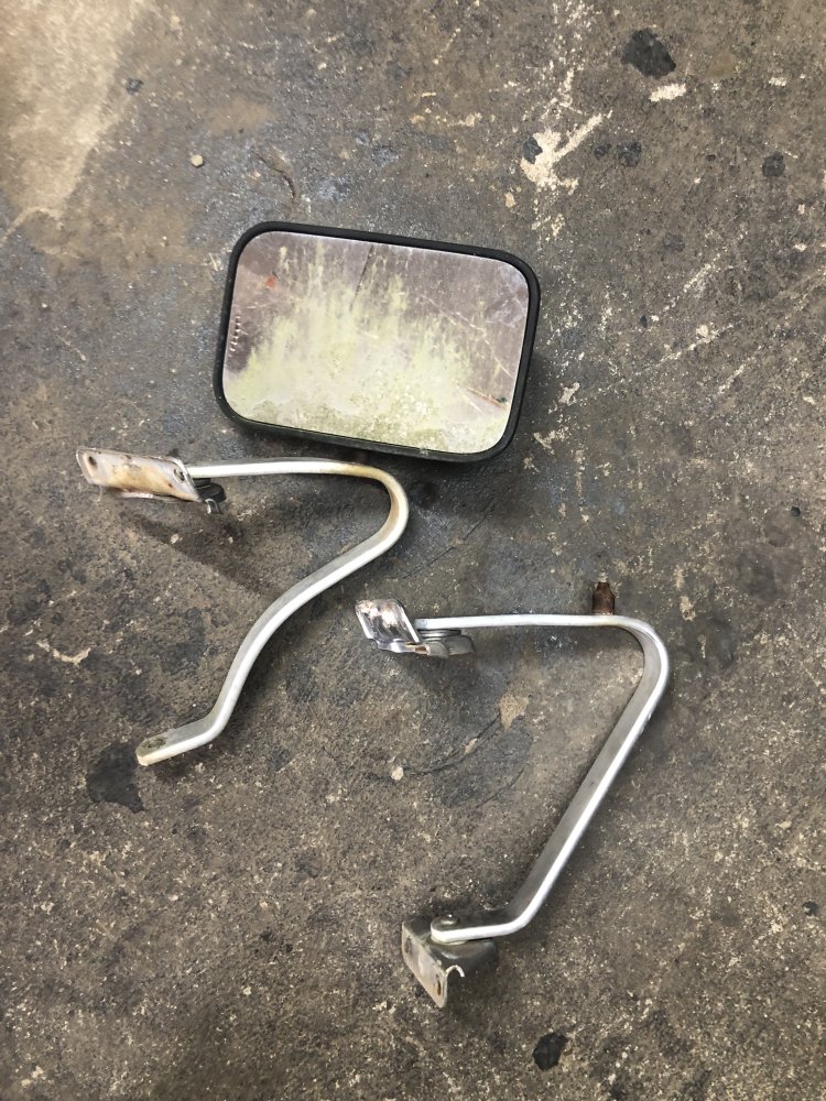

fixed the mirror with a spare I had

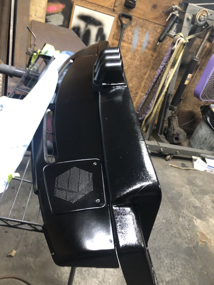

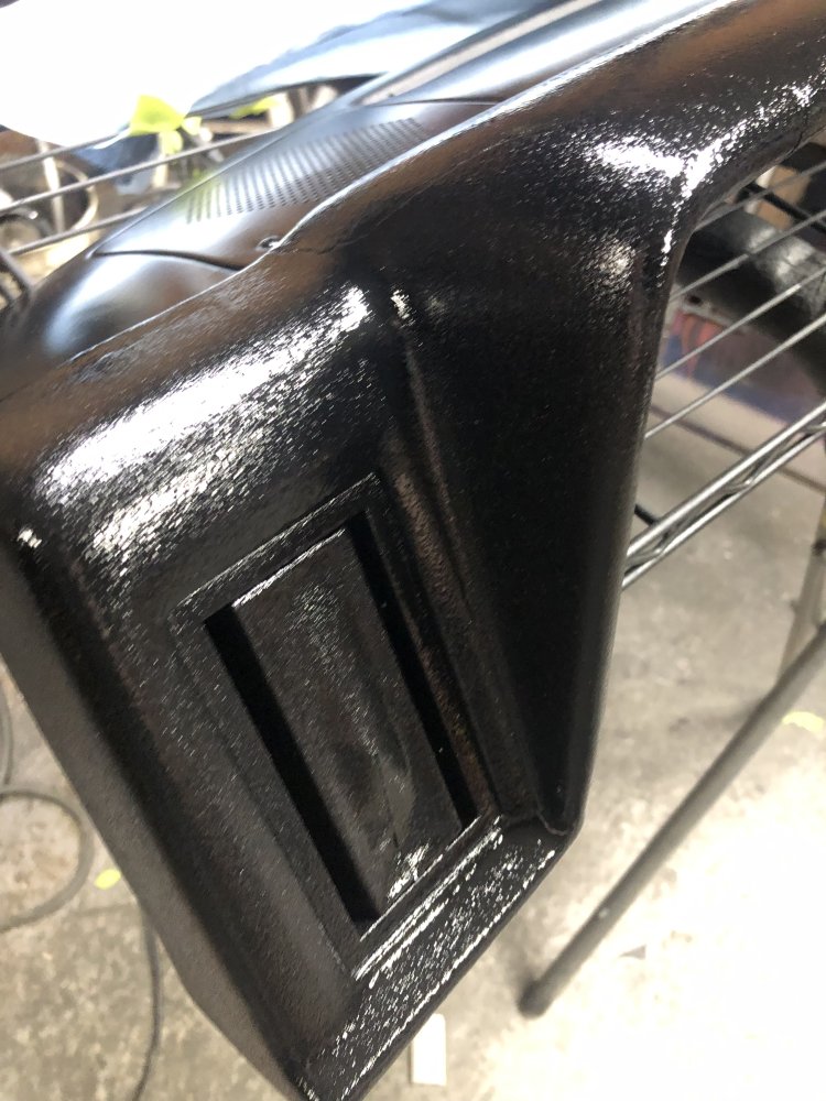

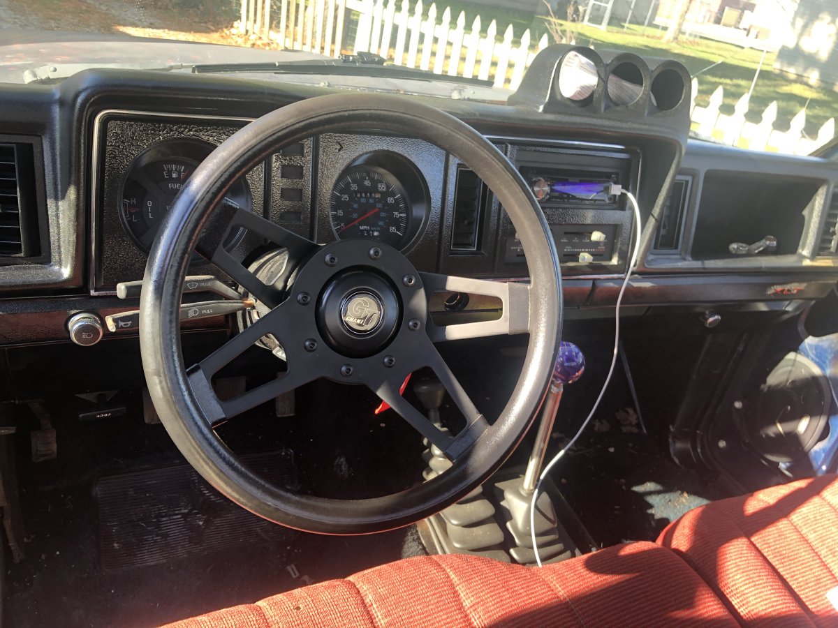

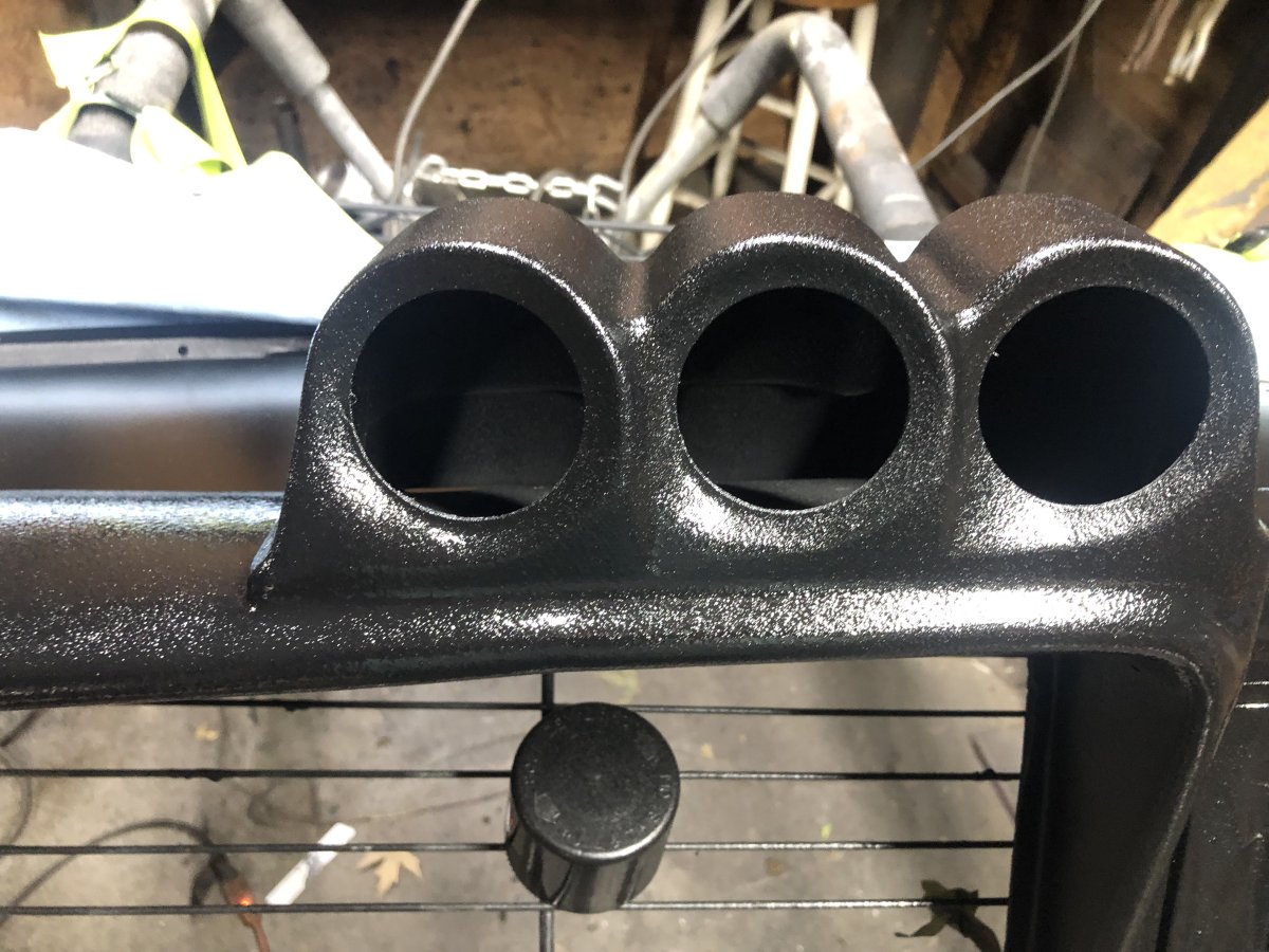

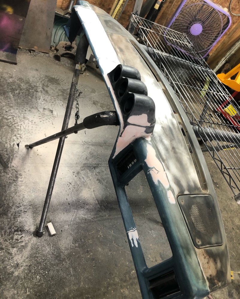

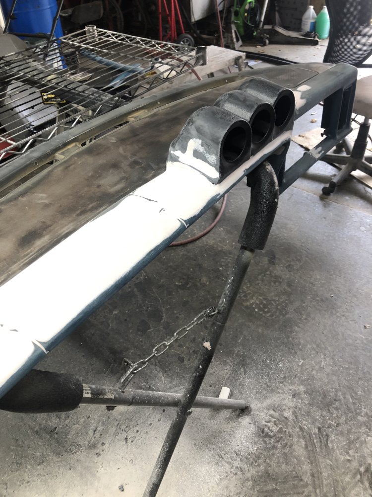

The dash pad was cracked really bad and I always wanted to graft a gauge pod to the dash so why not now. Still using parts laying around.

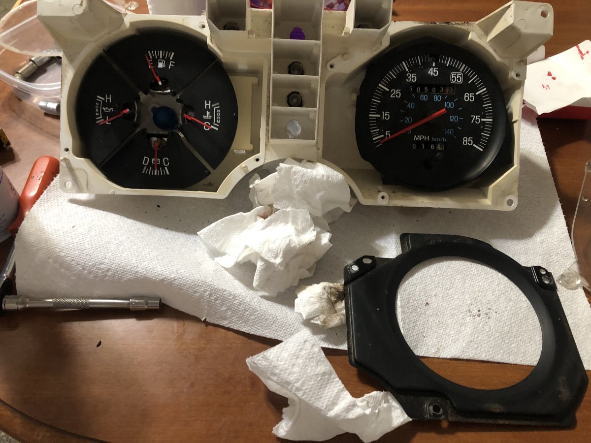

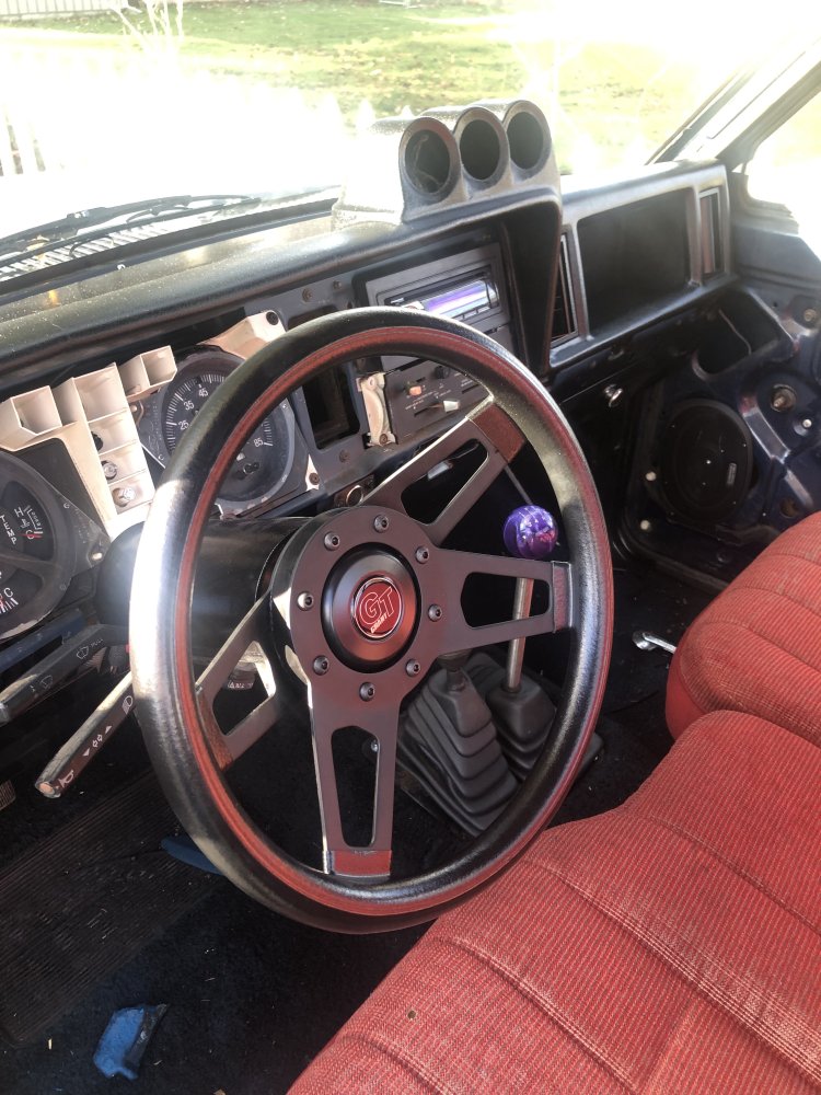

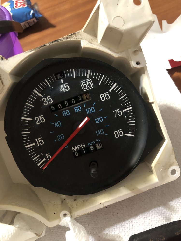

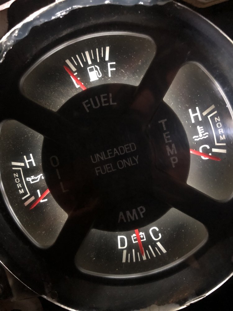

the gauge cluster had a lot of dirt in it and the gauge needles were faded almost white. I cleaned and painted them. Installed LEDs.

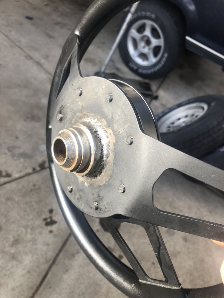

Cheapest steering wheel summit had and cut up the old one to adapt.
