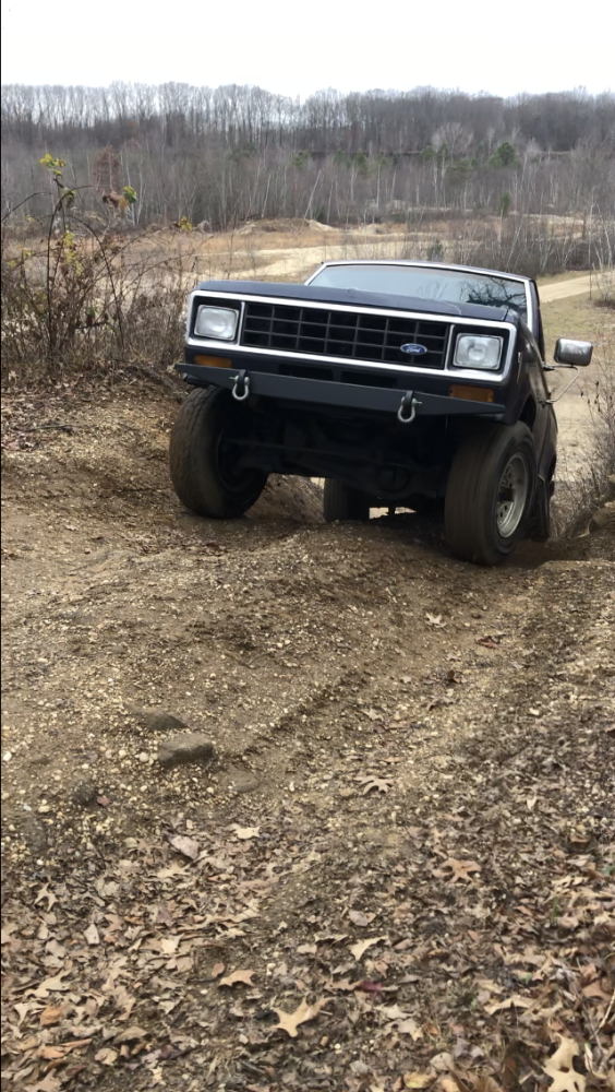

I took the ranger to southington. It continues to impress me, I can’t wait to start on this tdi swap because the truck is slow, and is burning a lot of oil. It was loading up bad idling around. I ordered door panels, I think the only other thing I’m gonna buy for now is new door seals then I’ll start saving for the tdi adapter!

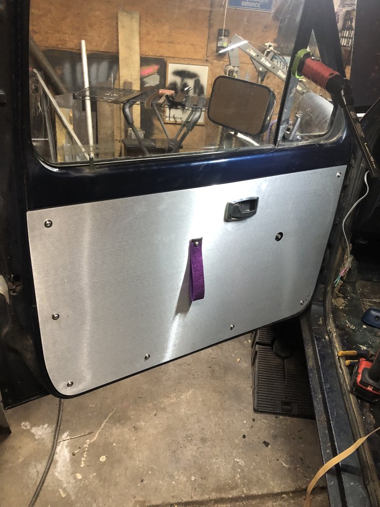

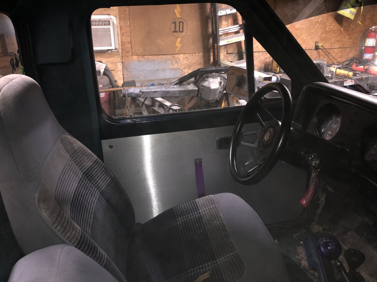

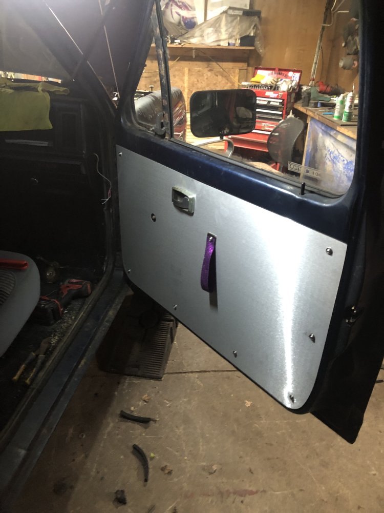

So I have always wanted aluminum door panels in a first or second gen body style and thankfully someone on the internet sells them! LRB speed. They came with m5 rivnuts and hardware but I didn’t have that size die. I used 1/4” rivnuts and stainless bolts/washers.

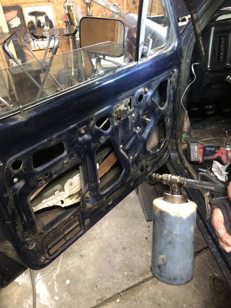

Before closing up the doors I sprayed fluid film down inside since it’s rust free and I’ll be driving in the salt.

I added the middle bolt on the back edge of the doors. I felt it held it down better. Other than that they fit perfectly!

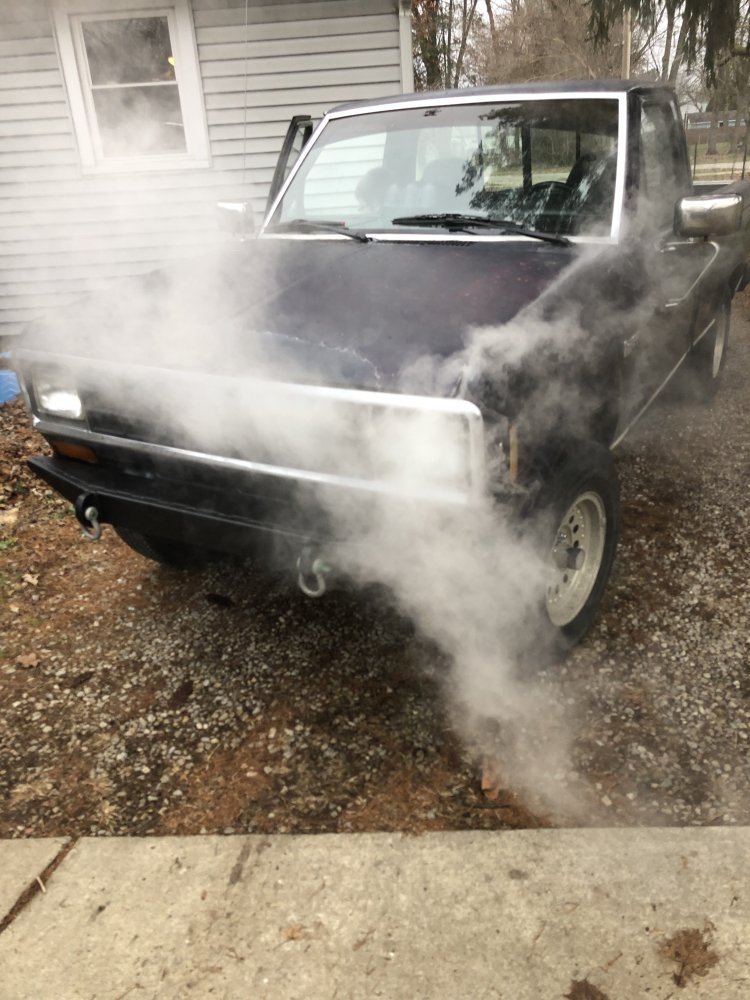

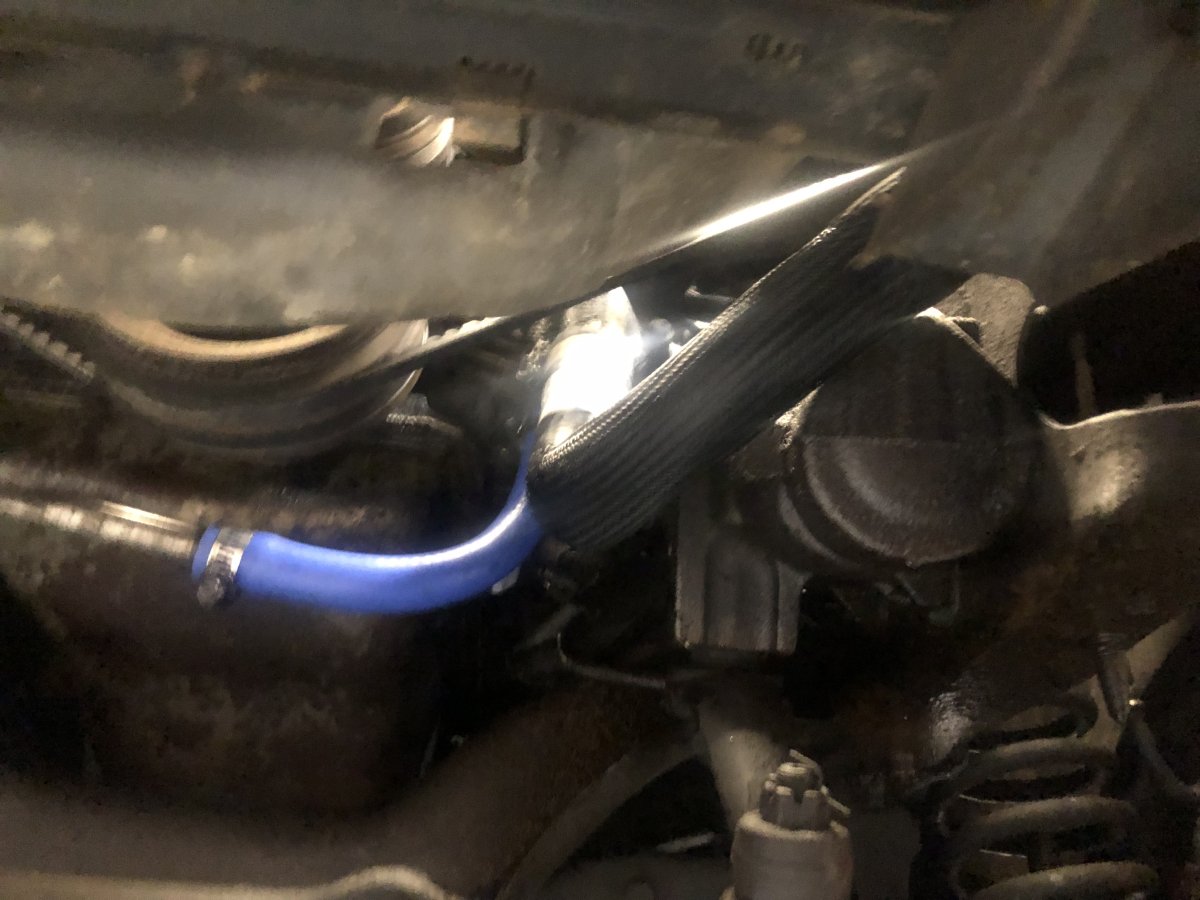

I thought a blew a radiator hose, after all they’re at least 20 years old if not original? So I replaced all hoses.
1st gen TDI ranger, prerunner style build.
Started it and idled, no leaks. then after it started to get warm it opened up a crack in the radiator 😬

There are some really nice large all aluminum radiators out there these days. I think I paid $240 for mine and it came with an E fan. It works so good I can rarely get the truck to heat up to the N in normal

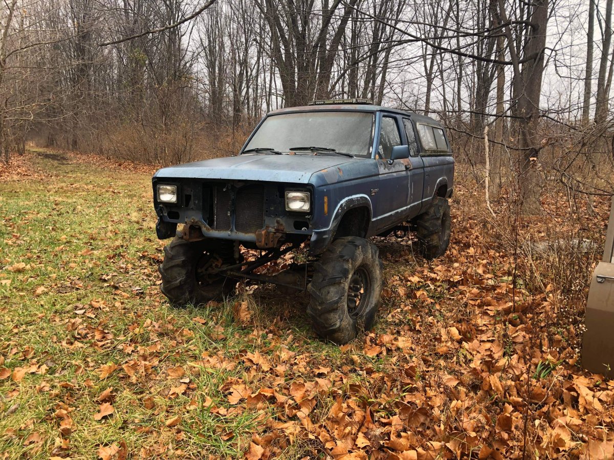

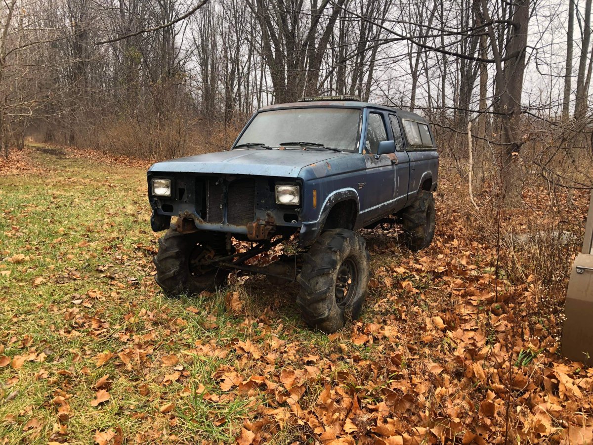

here is the current ranger. It’s lifted tall with jeep axles and tractor tires but that’s all going

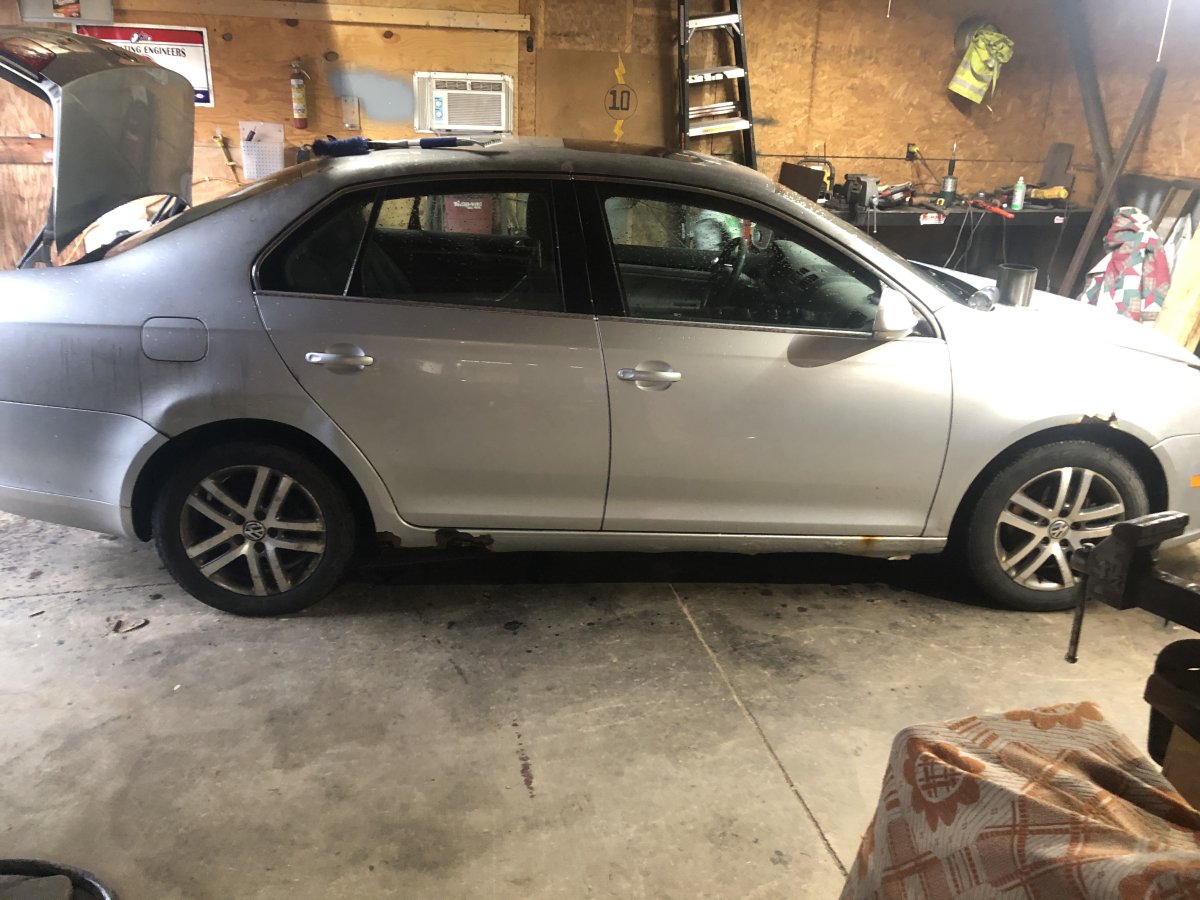

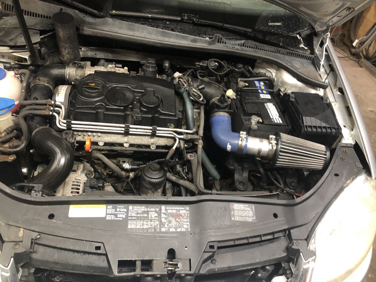

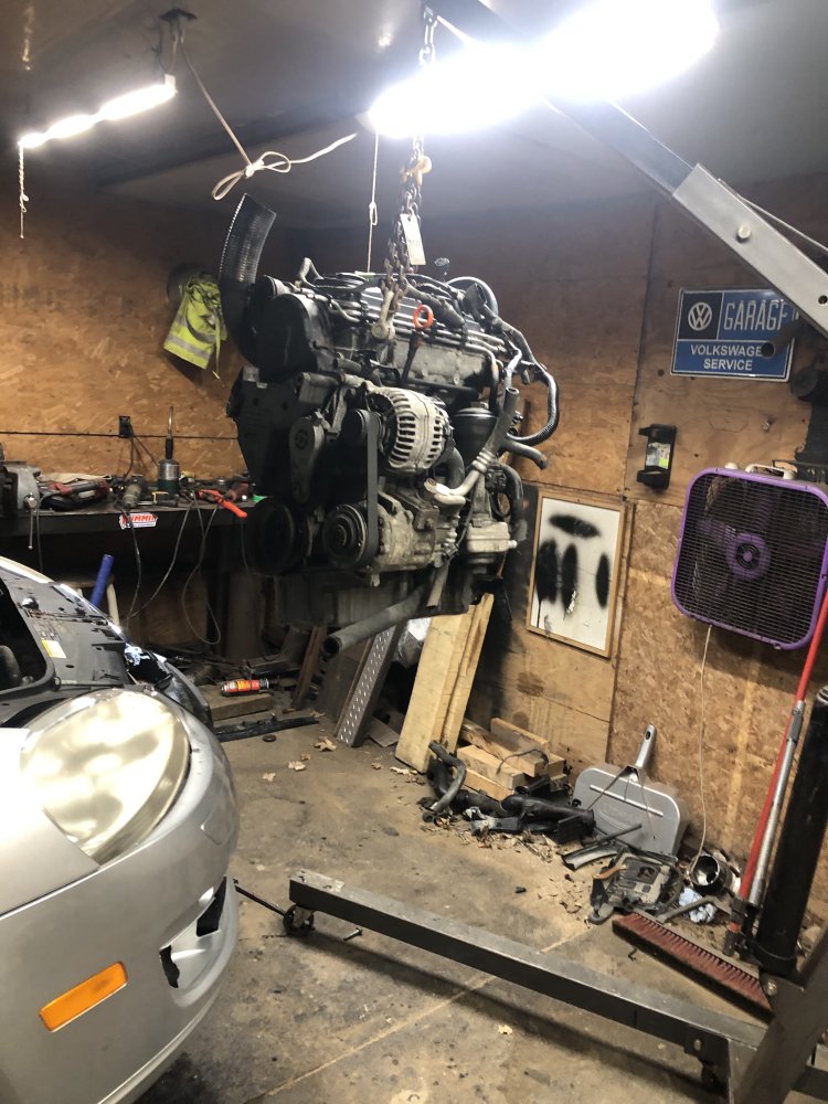

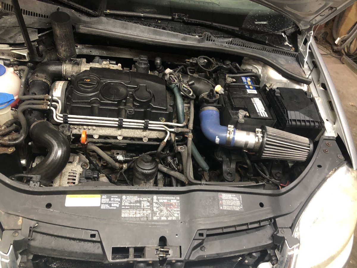

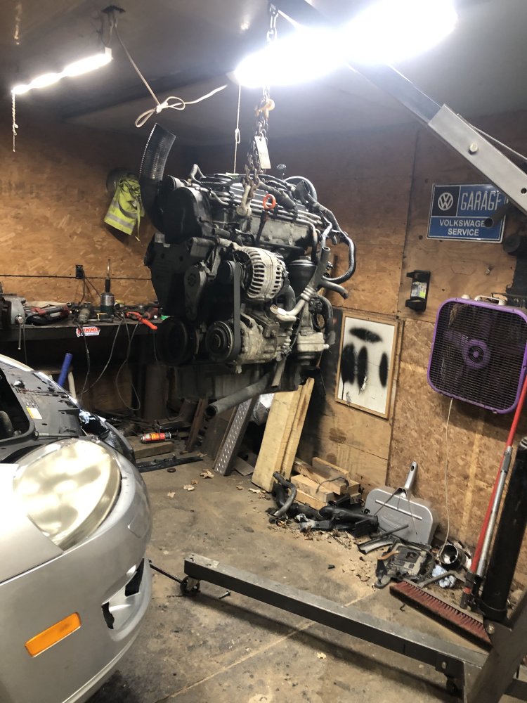

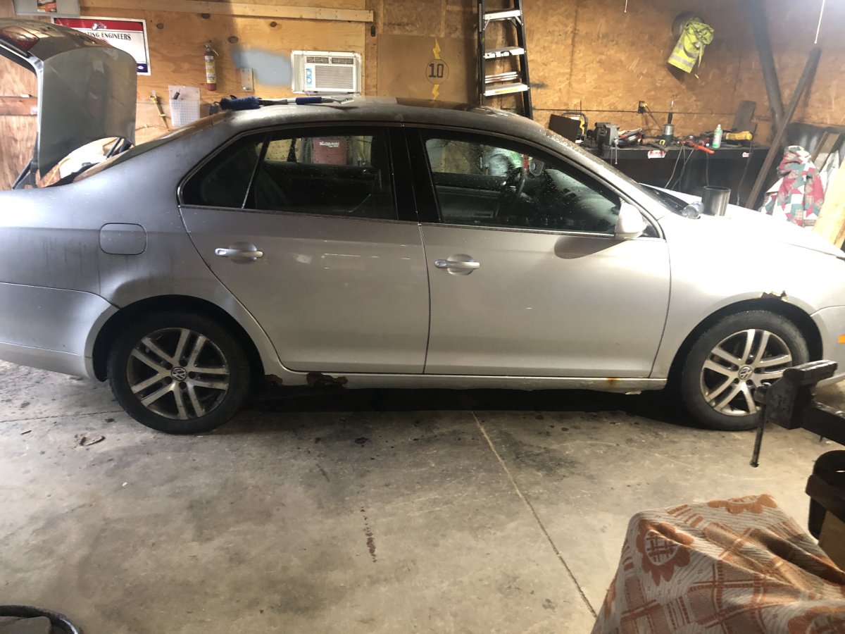

So far I have stripped my last daily driver which was a 2006 Volkswagen Jetta and saved the engine and all the wiring.
View attachment 95175View attachment 95176View attachment 95177

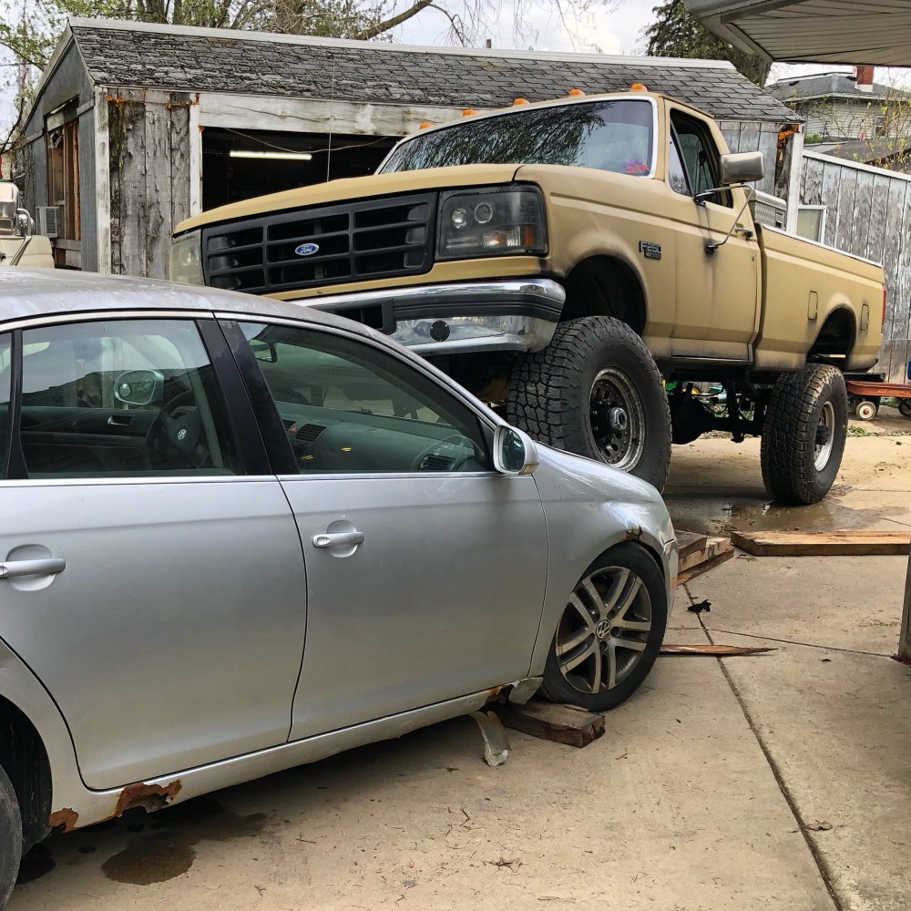

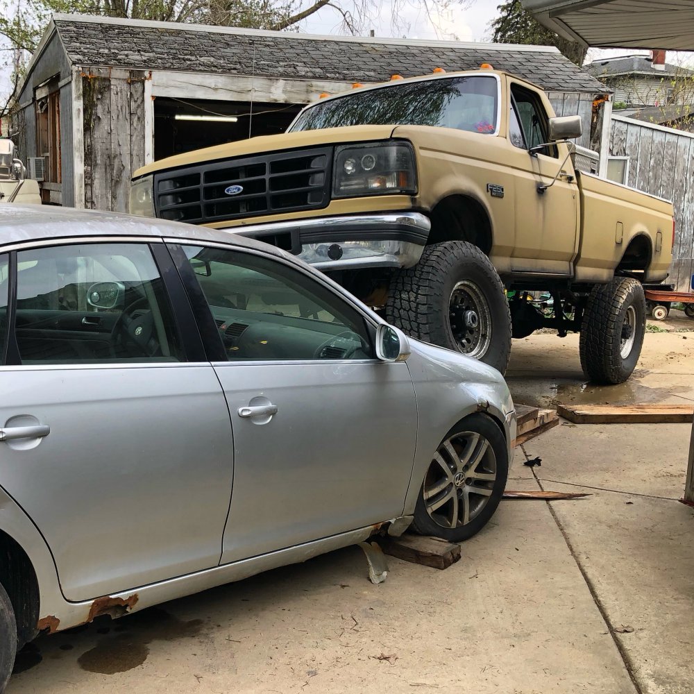

One of my 2 OBS daily drivers attempting to crush the Jetta before the scrap guy comes to get it lol View attachment 95178

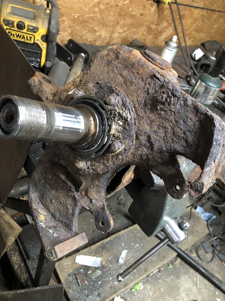

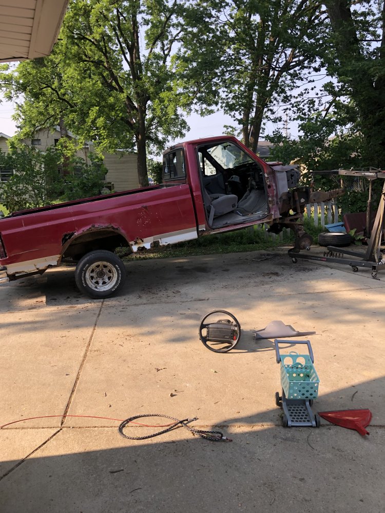

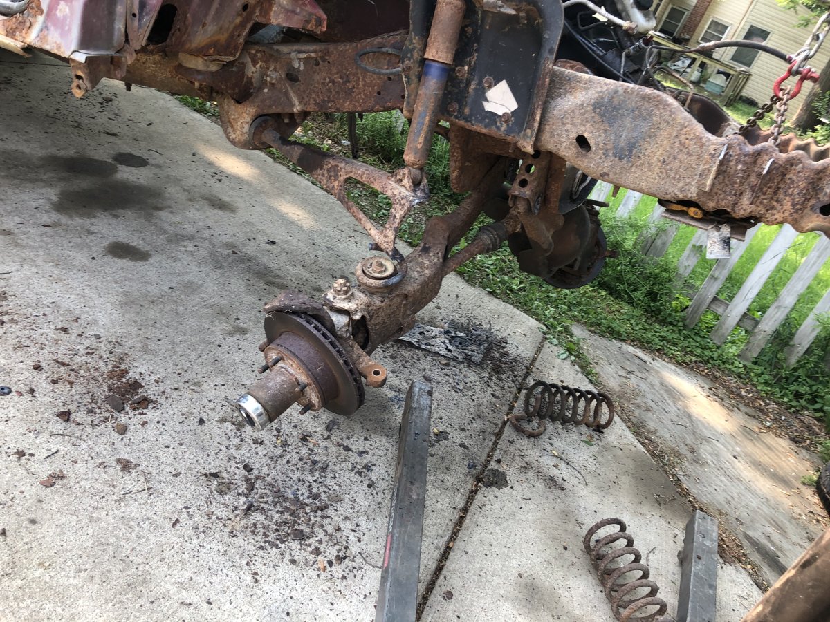

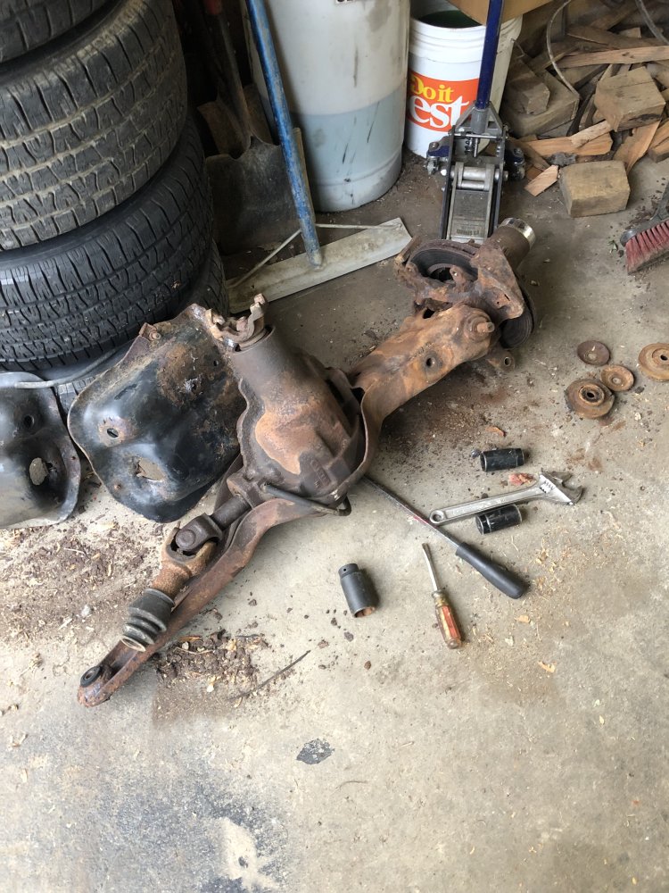

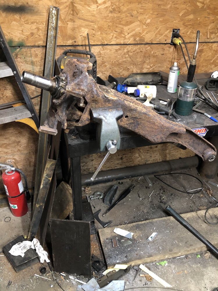

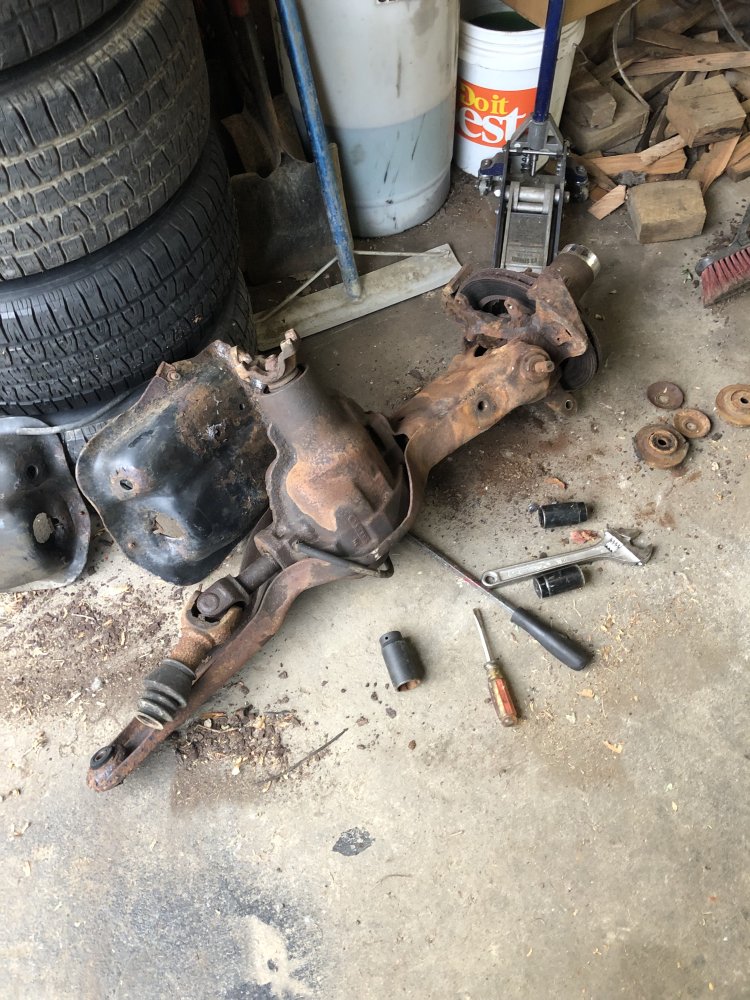

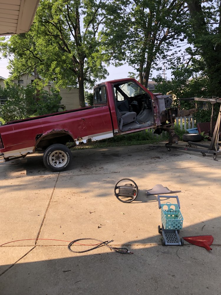

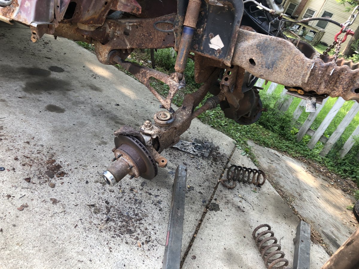

Next I acquired what was left of a 95 f150 for the front ttb and rear axle. I also saved the coil buckets, not sure if I’ll be able to repurpose them on the ranger.
View attachment 95179View attachment 95180

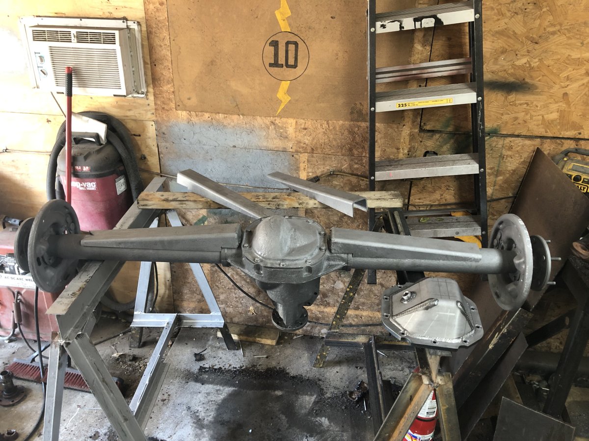

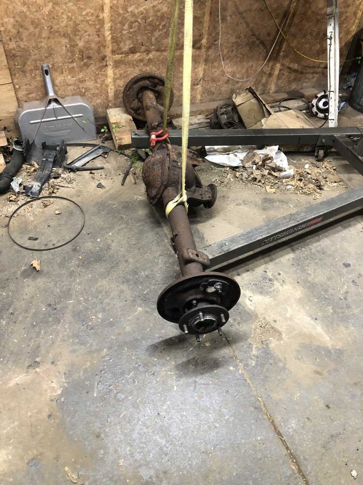

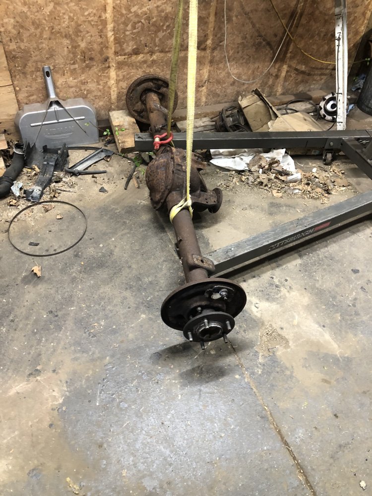

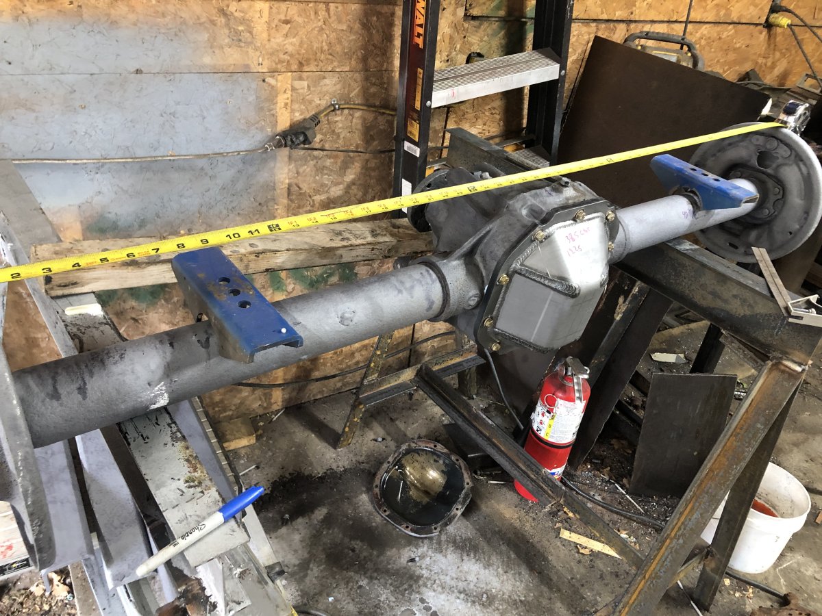

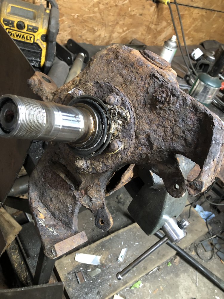

So naturally I live in Ohio so everything’s super rusty. I stripped everything down and to start, I took the rear axle to the sandblaster. I’m going to start with the rear axle, get it regeared and done up the way I want then move on to the front.
View attachment 95181View attachment 95182View attachment 95183View attachment 95184

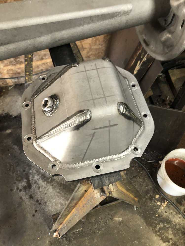

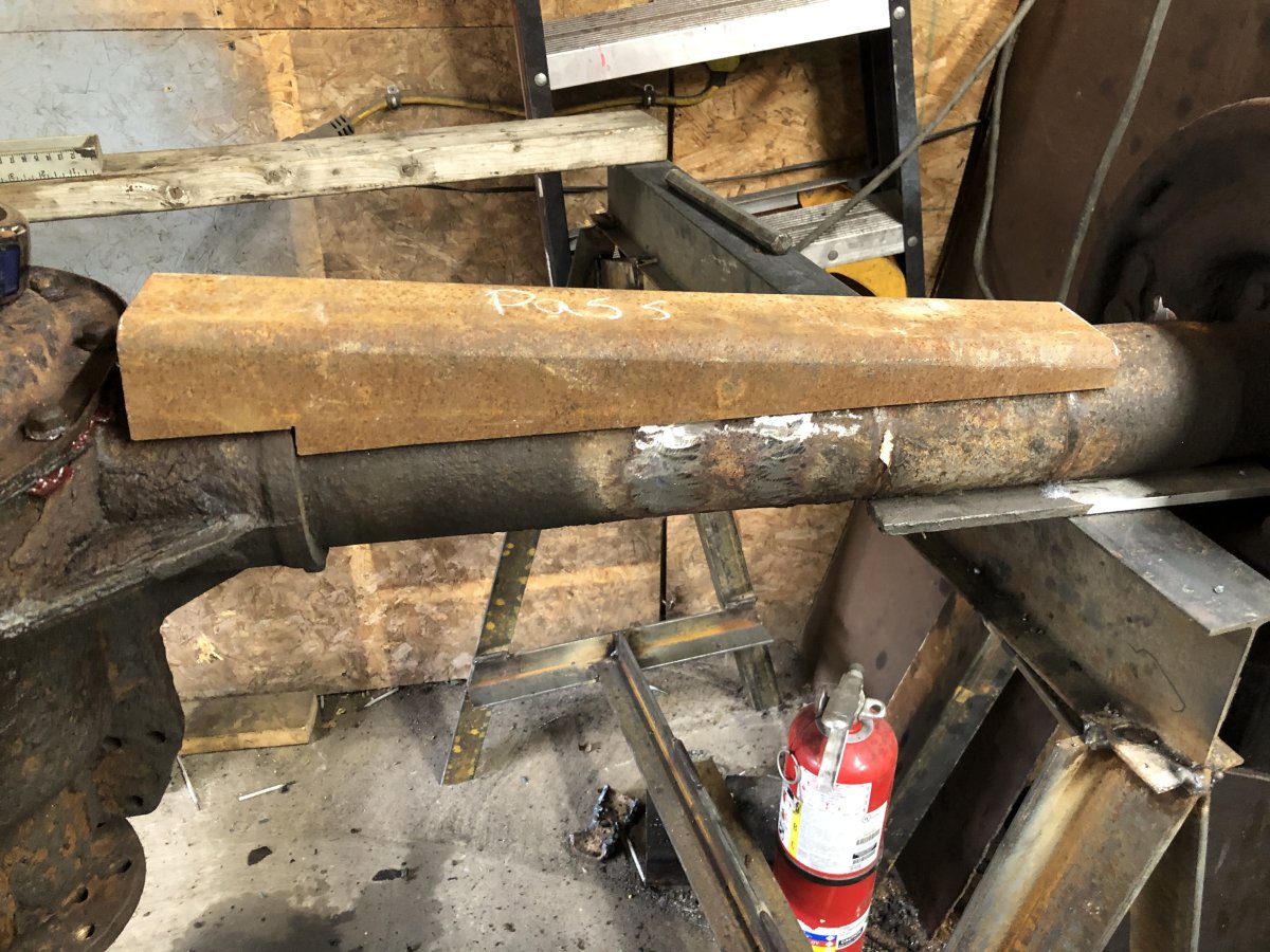

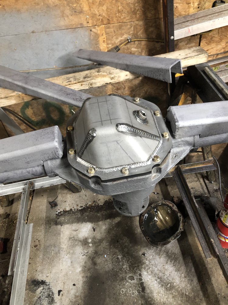

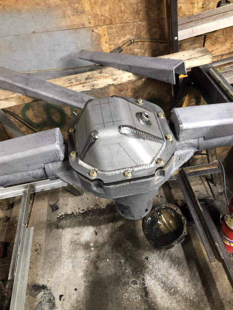

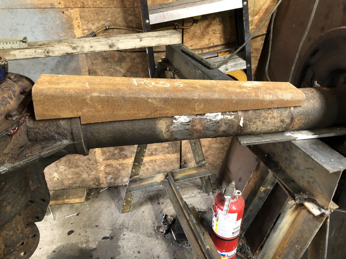

I started messing around with making a truss of some kind.

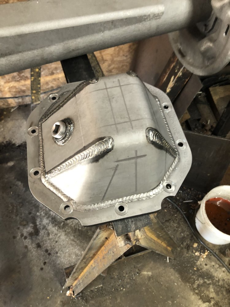

I ordered a diff cover from Ruffstuff
and back from the blasterView attachment 95187View attachment 95189

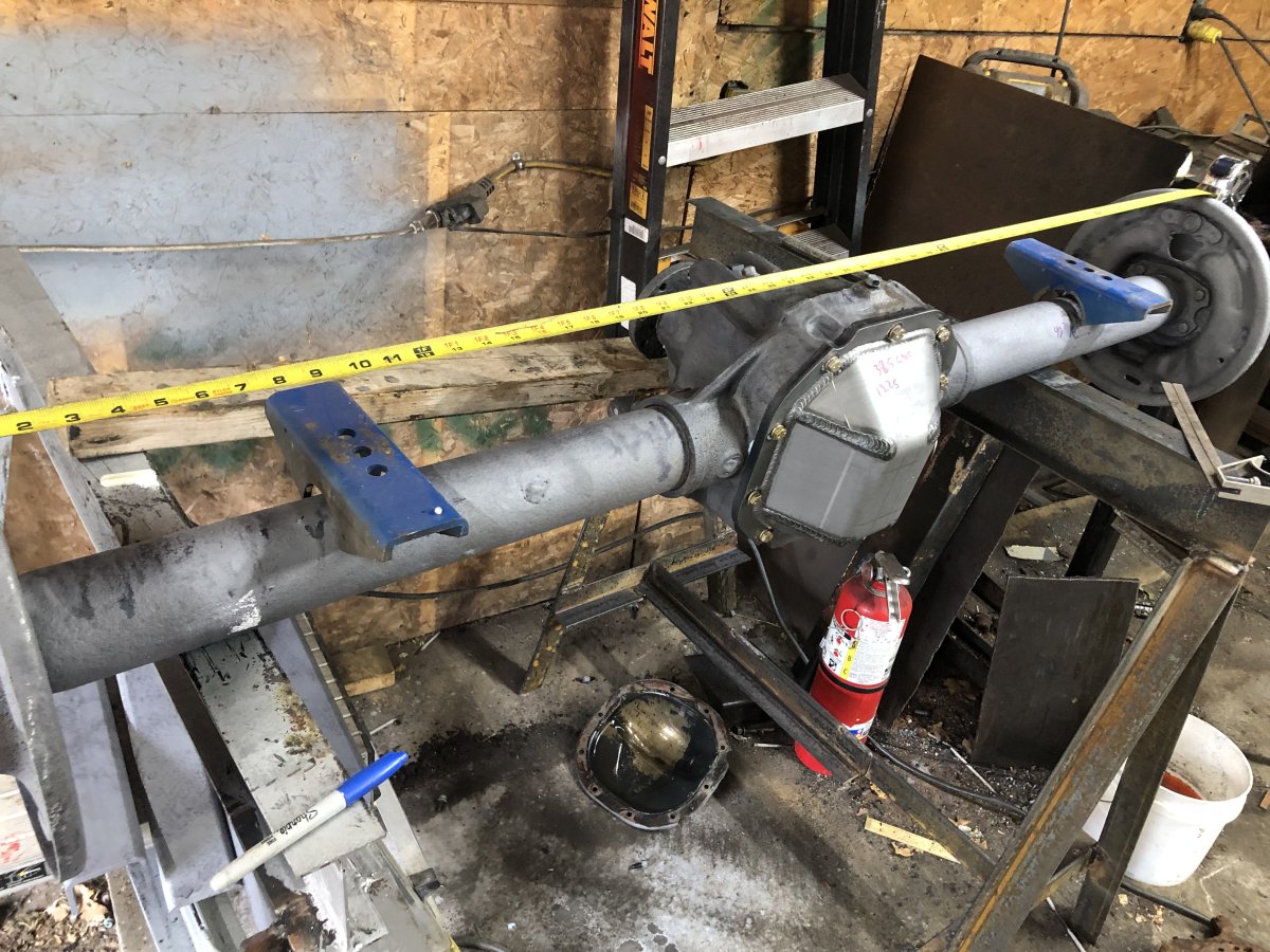

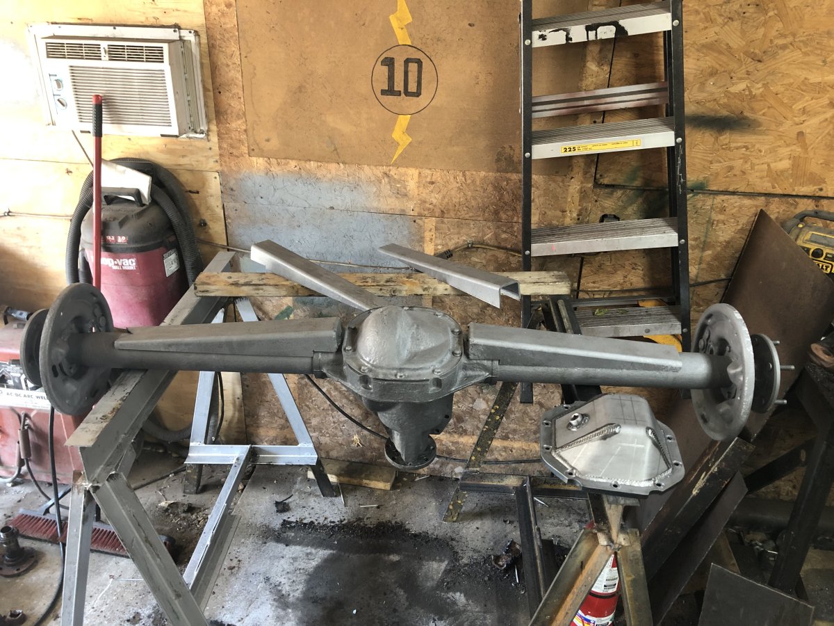

Getting an idea where the spring perches need to beView attachment 95190
