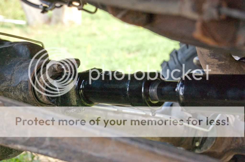

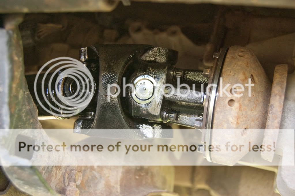

ITS GOT 4WD!!! had a shop in town get rid of the stupid plunger thing on the front drive shaft and replace it with a c-v joint. then they extended and balanced the stock bronco driveshaft that i saved. im so glad i saved that thing, ive gotten rid of pretty much everything as ive been going along on the project. DONT DO THAT!!! it was so stupid of me. there are a couple things that i wish i still had that i didnt think i was going to need at the time. o well lesson learned i suppose....
anywho, the new driveshaft on there has almost no clearance over the tcase crossmember. so im going to go play around in the back yard to see what im dealing with here. im definitely going to have to make a new one, just have to decide exactly how.

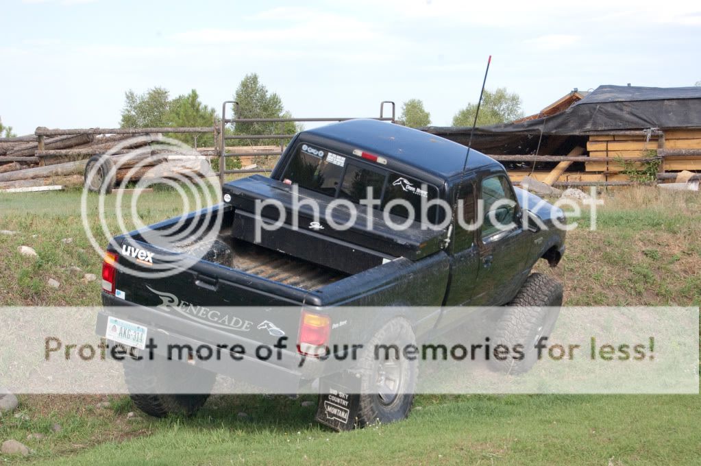

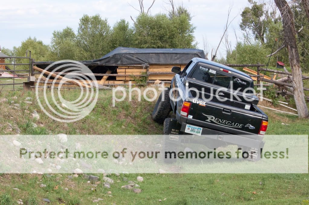

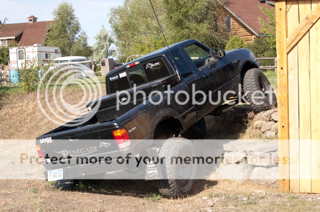

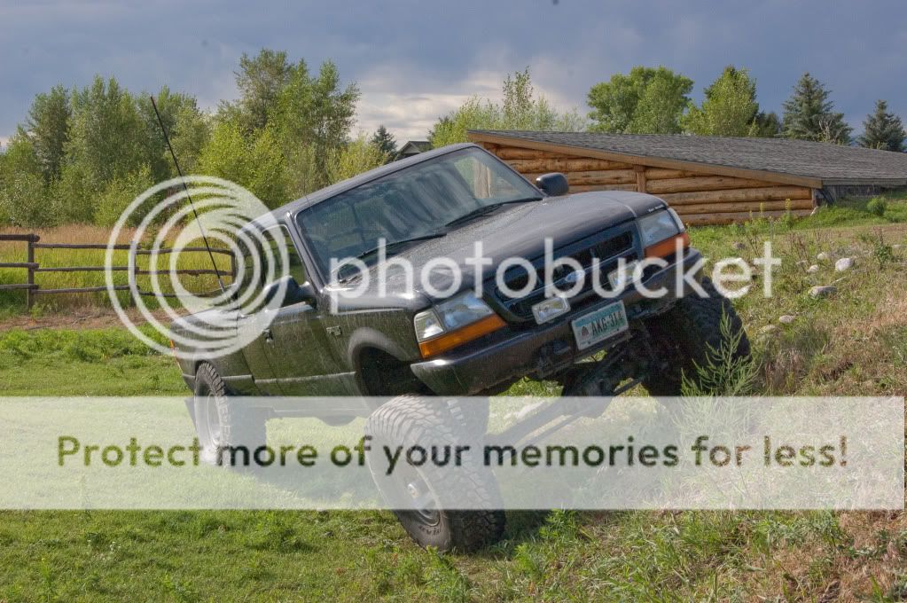

heres a couple of it flexed out with the wheel wells stuffed...
and a couple more...
i dont like this very much (gonna need some bump stops)
i like this a lot!
all in all for what my truck is it totally kicks ass!!! And it will only get better!!!
however, she is quite done for now....

Looks good man. Looks like you got about the same amount of clearence on your front shaft as I do. Havent noticed any problems yet either. I do however haver rubbing on about three different places on my rear drive shaft. Rubs on the gas tank brackets. Looks like your haven a good time with it. Keep up the good work. And the cost to do this does make you a little sick.

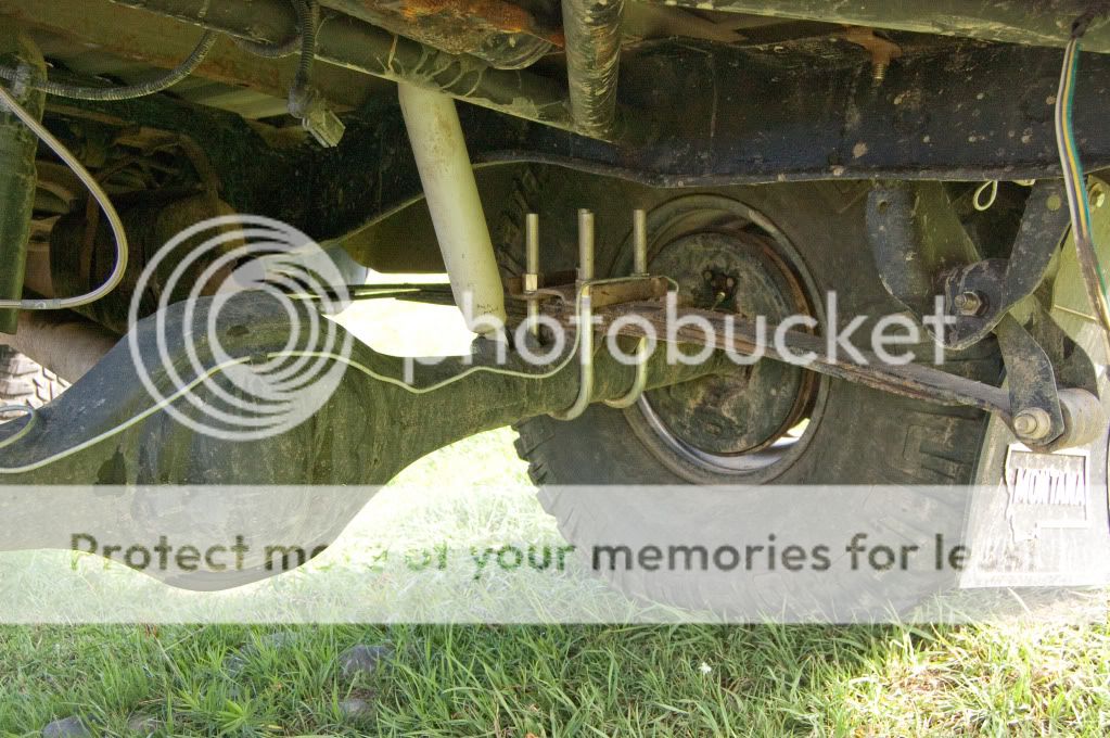

BTW, can I get some more info on what you did with your rear springs? I want to flip mine, but dont want the "Cali" look going on. How did you flip it and still get it to ride pretty level?

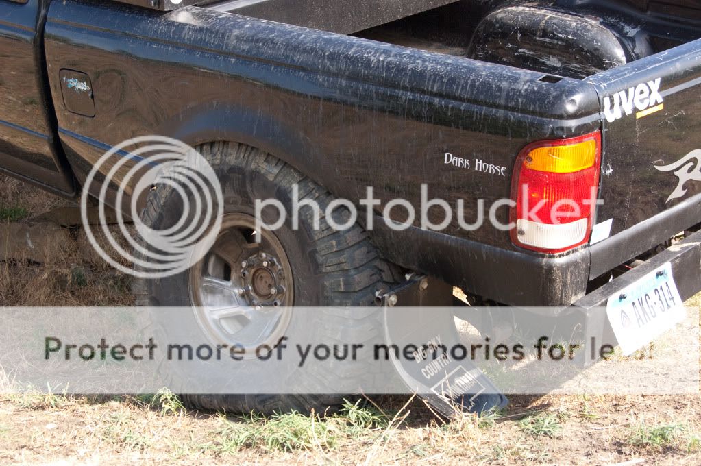

did i miss the tire size somewhere?
They look like about 35s. And Im curious how flipping the springs gave you lift.... or didnt, Did I miss something?
I don't see any flipped springs, just compressed, and i see how he got lift, slid the stock bracket down on the frame....any plans of fixing that?
I just read the whole post, and i wanted to mention something. If your driveshaft ever fails instead of passing out booquoo bux for a new one, just get some 2 inch solid stock like you did for your hitch and make a 2 piece driveshaft. The t case connection on the larger piece and the Ujoint for the front diff on the smaller one, slide on inside the other and mount it up. The front shaft will most likely never be used fast enough to need balancing, and it will be strong enough to hold up to most abuse, given the welding is done right on the ends. I have a guy here in TN did it to his yoda on 37's and he says its an awesome setup. Cheap and durable.
look bigger then 35's to me
