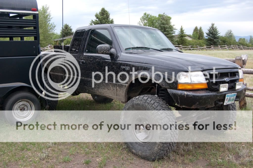

man i wish there was some video of what my ranger did today so everyone could just see what this thing did. its still 2WD so i took it up to the mountains today with the intention with some light wheeling just to see how the thing works. what i ended up doing was far from "light".
i started off being nice to it until a really long, really steep hill came up, i originally was going to turn around at this point so i didnt **** anything up, but the i thought to myself, "ah **** it, i just need a little speed"
so i floored it and was going at least 20mph bouncing from side to side on the trail, bouncing my front end up the air, and all around romping the shit out of the ranger. i was in total disbelief when i got to the top and finally took my foot off the floor! if i didnt break any of my welds doing what i did, then im pretty sure i got nothing to worry about!
gangster lean...

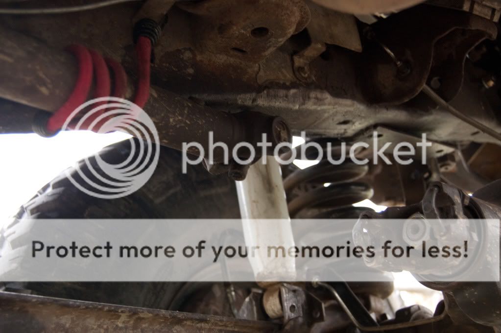

i went to fix the leaking brake line fitting today, but the flare is the one that it came with, not even one i did, so its perfect, and still leaking. i think it must be the threads coming off my master cylinder. i put some thread locker on the fitting for now to see if that does anything. its drips were going all over my shock. the brake fluid "ate" through 2 bushings, one last week and one today. im really sick of replacing bushings already so i really hope i fixed it with that thread locker.
i dont think that how much i beat the shit out of my truck today helped this situation much:
holy shit i cant wait to take care of this:
danger ranger survived the day!

i just went outside to check on how much brake fluid ive lost lately and my thread locker worked!!! its all dry and the master cylinder is finally staying full!!! now i just need a seal for my 9 inch and ill be good on leaks for now.
