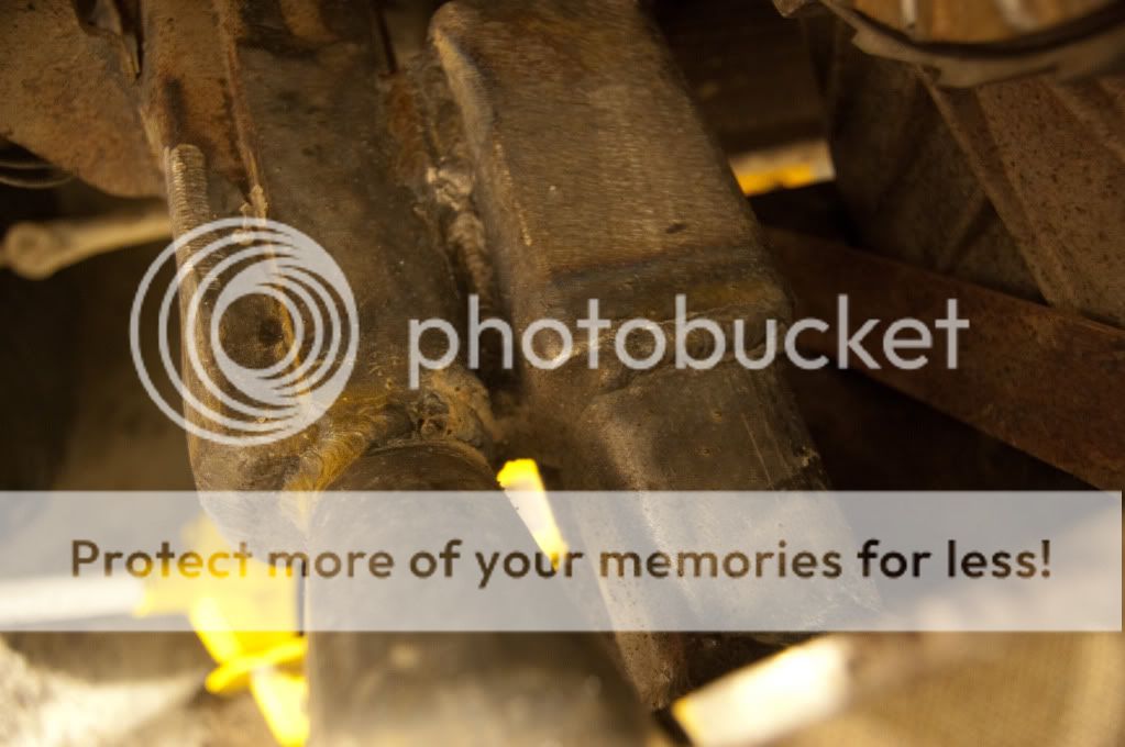

alright so its been forever.... last time i put something up i think it was about breaking off my track bar. so ill do my best to remember everything since then, but it hasnt been a whole heck of a lot...
i havent been keeping up with taking pictures, but i went out and snapped a few to give ya an idea of the last couple months...
first off, i put the track bar back on. this time i cut the stock bronco shock/trackbar mount in half to get rid of the shock mount so i could use the bottom part.

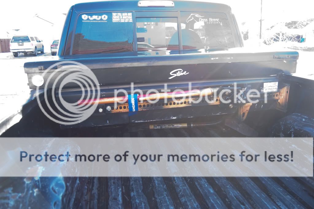

got a high lift hooked up on the toolbox. first outing with it i got to use it cause i tore a sidewall.

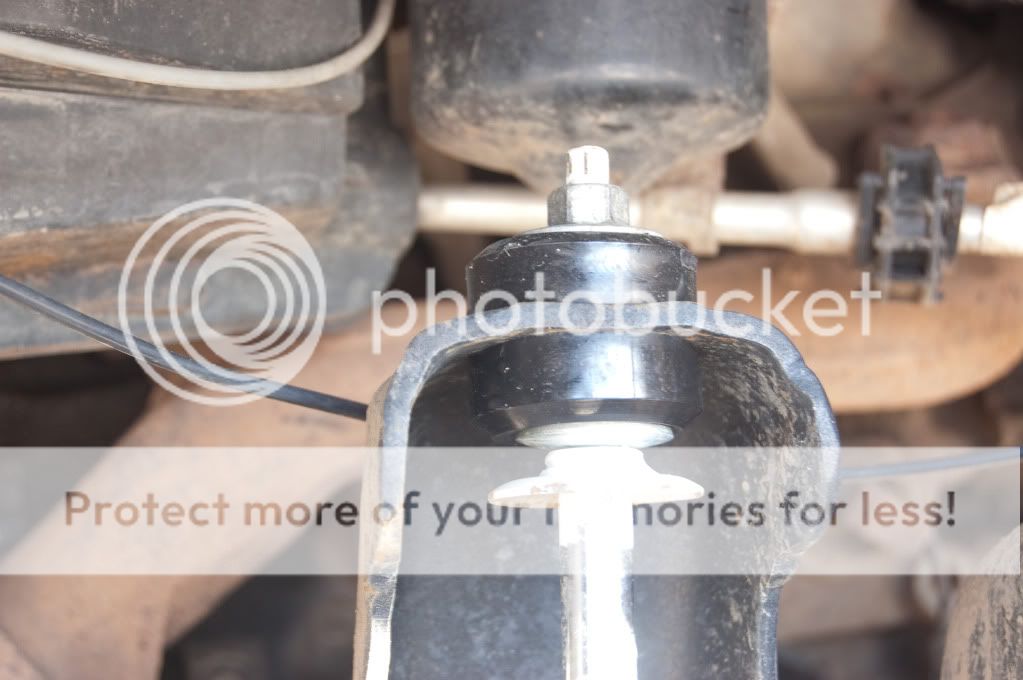

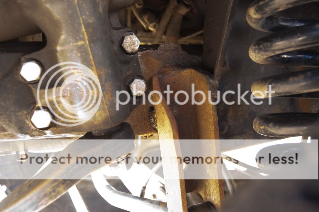

next up i finally got shock bushings burly enough to not get ripped apart...
1999 Ford Ranger Solid Axle Swap

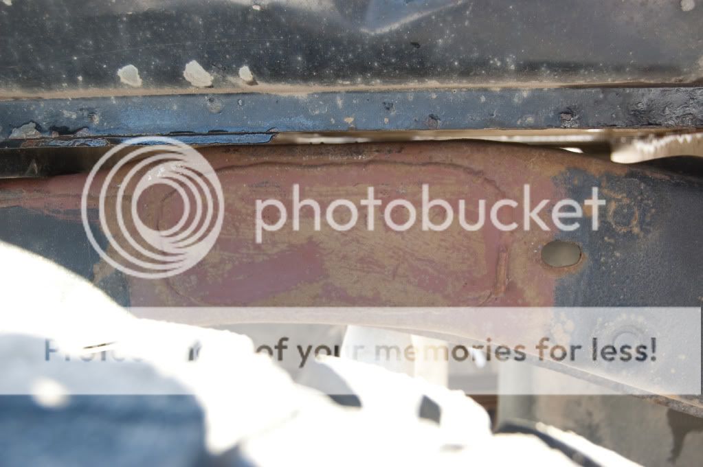

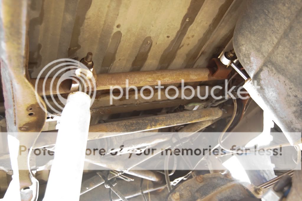

i did a really shity job originally mounting my rear shocks. the way i mounted them put so much stress on the frame that it cracked all the way through. i didnt get any pictures of the cracks, but heres the fix, just some 10ga slapped over the frame after i welded the crack itself.
so i boxed the frame around the crack fixes and put a 1.75X.120 tube crossmember in to mount the shocks on. i cut some 2X4 rectangle tube in half and put bolts through to mount the shocks to the tube.

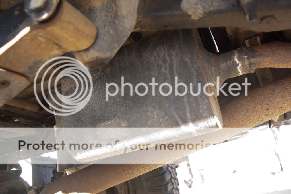

i also got a new muffler which makes my truck drive surprisingly better. its a flowmaster delta 60 series.

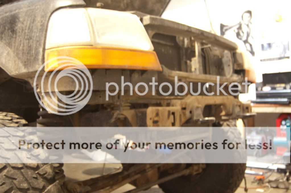

recently i started a bumper, this is all i have for pictures so far:
stock bumper off

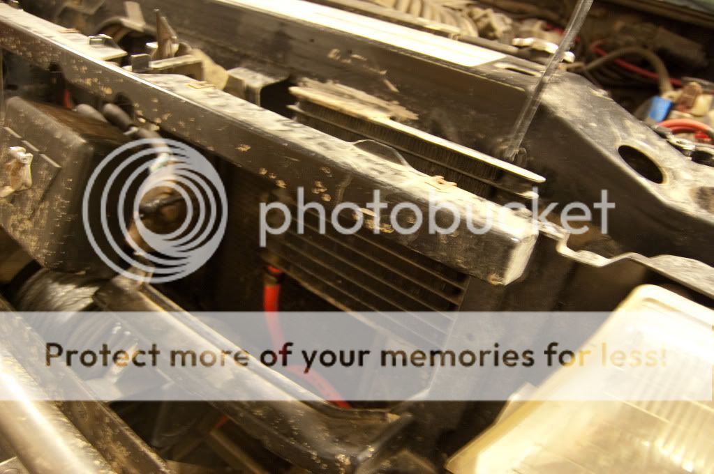

tranny cooler off to be relocated

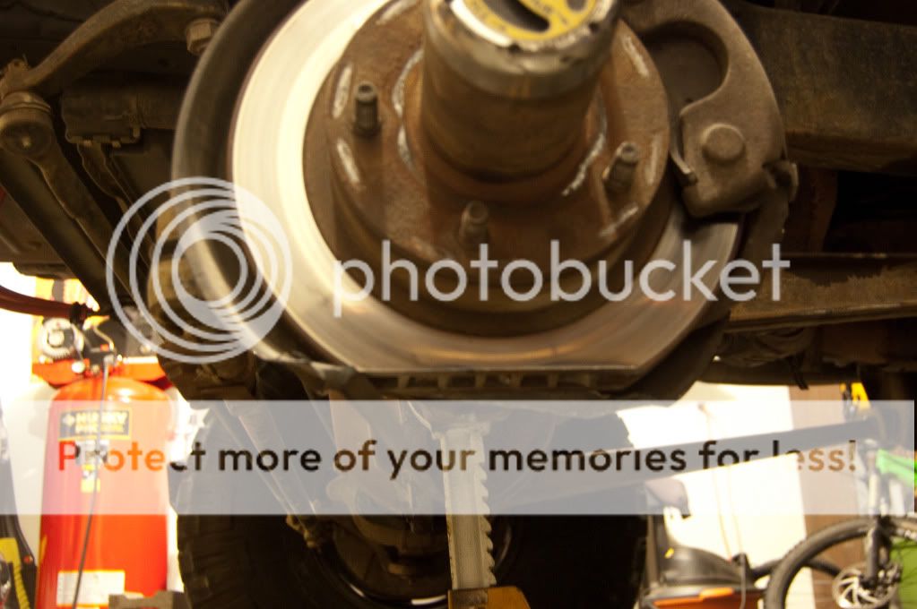

****n thing tried to kill me yesterday... just driving along down the road at 60mph, all of a sudden my front left just drops and i thought my tire blew out and went flat. then i look out my window to my left and see my tire bouncing along down the highway next to my truck... i pull over to the shoulder only to watch my tire bounce down the highway, over a fence, and 300 yds out into a field.
it was so wierd, my wheel never wobbled or shook and nothing out of the ordinary happened until the wheel just fell off. all 5 lugs just unscrewed themselves, nothing was bent, broken or stripped. took my brake rotor down a bit though...
had to run out into the field, grab my tire, then run it back to the truck. stupid high lift it too short to use on my new bumper so i had to flag someone down on the road to borrow a cell phone (no i dont have one) so i could call a friend to come get me.
he picked me up off the side of the road so i could go back to my house to grab my floor jack.
got back to the truck and i couldnt get my floor jack under my axle, so i ended up having to use the highjack after all to get my axle a few inches off the ground so i could slide the floor jack under.
jacked her up, threw the wheel back on with 2 extra lugs i had and stole one from my other front wheel.
drove it right home into the garage and it made the worst metal on metal squeaking/scratching noise the whole way.

this is where i relocated the tranny cooler to:

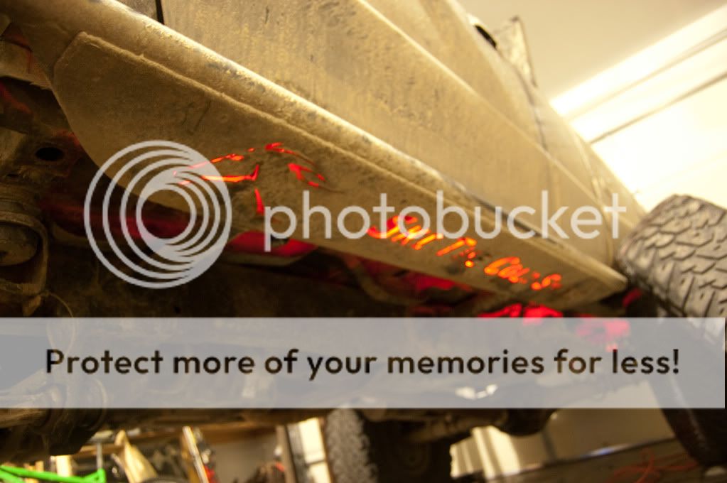

i also built sliders last fall which i still have yet to finish. covered them with 3/8" plate with "ski the cold smoke" cut out for bridger bowl, mt. they have the logo of the shop who plasma cut the plate, Dark Horse Customs in bozeman, mt.
sliders are cool as hell.
Good to see ya back round here! And yeah, dig the sliders for sure.
