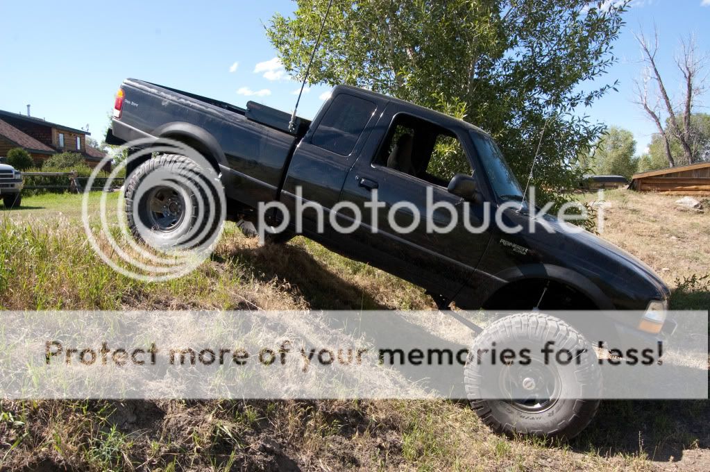

nothing crazy, just some 10min 2WD fun!

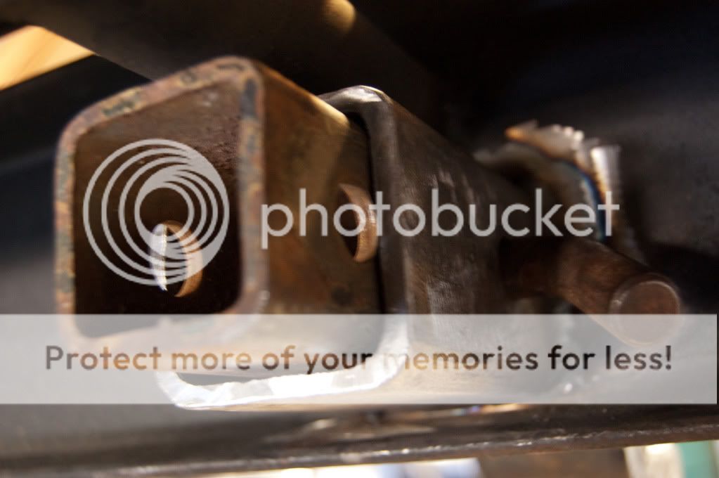

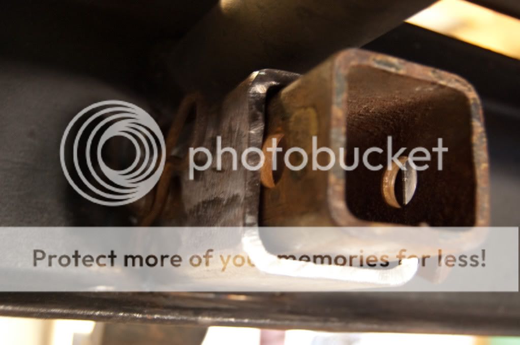

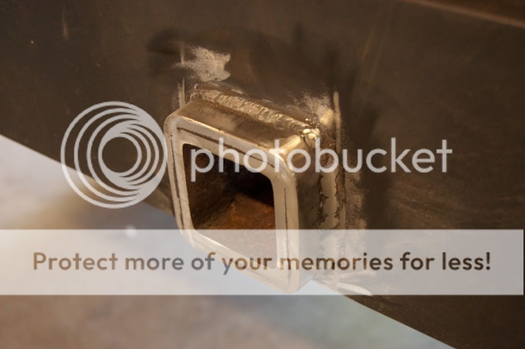

well my truck can officially function as a truck now... it can tow! just hooked me up a hitch receiver!!!

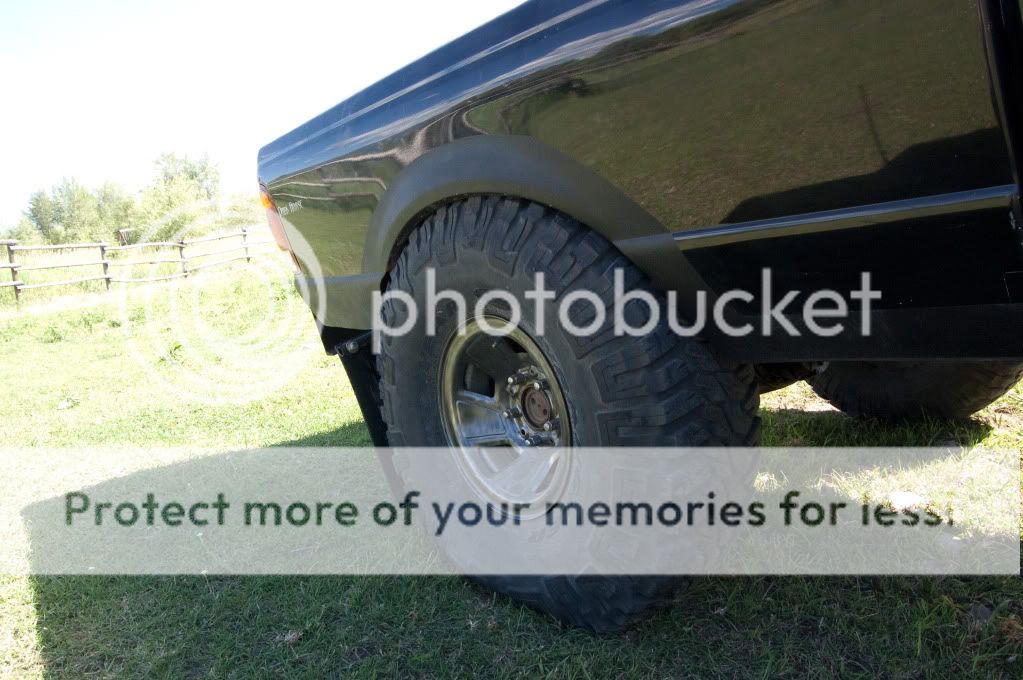

No flares on my truck now, got a full "Box 2' government safety... essentially go through everything from ball joints to TRE's e-brake, windshield, suspension... so it'll be off the road for a little. When the time comes though, I'll just screw some conveyor belt to the fender to cover the tires. Won't break, that's for sure.

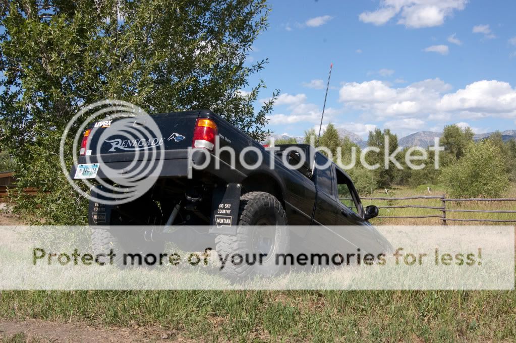

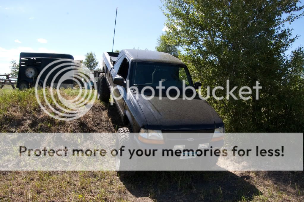

took the ranger to the mountains for the first time since the swap today. still rockn 2WD it did ok. i like how the rear works, but the front straight up sucks, its way too stiff. im leaking brake fluid everywhere cause i think one of my flares is not up to par so i have to re do that one. i am also leaking oil out of front and rear diffs. i think i am leaking in the rear cause i put the yoke on too tight and it probably ****ed up the seal, im gonna loosten it and see what happens. as for the front, i think it is just coming out of where the vent hose is supposed to be so i guess i just have to put a hose on it and see what happens.
my brakes squeak all the time and there is still an unknown noise coming from the front which i think has to do with my brakes because it stops when i apply the brake.
so all in all everything i built seems to be running fine, its just the damn brakes
and i towed today after installing the hitch receiver yesterday and the trailer didnt fall off so id say it was a success! now i need a drop hitch...the list just gets longer...
