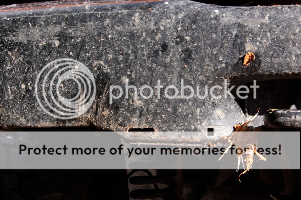

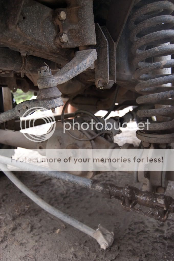

last weekend i took the ranger on its first trip to a legitimently gnarly trail. long story short, she broke and didnt make it...
i broke the ruff country track bar mount i put on. all of my welds held up though... thanks ruff country...

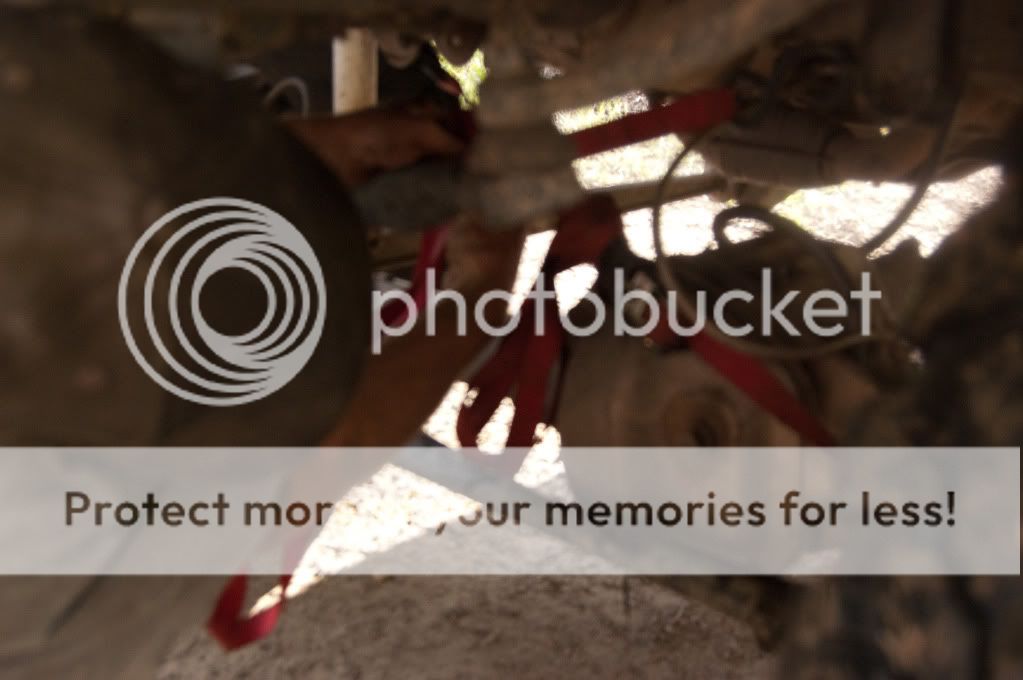

got 2 rachet straps in an X pattern to keep the axle centered so i could get out of the woods...

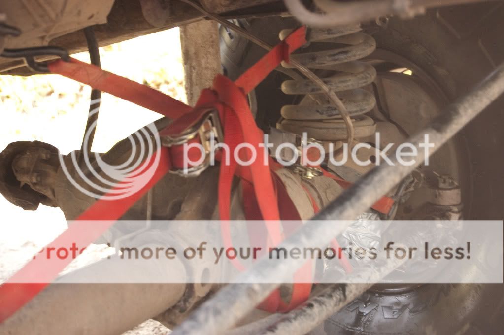

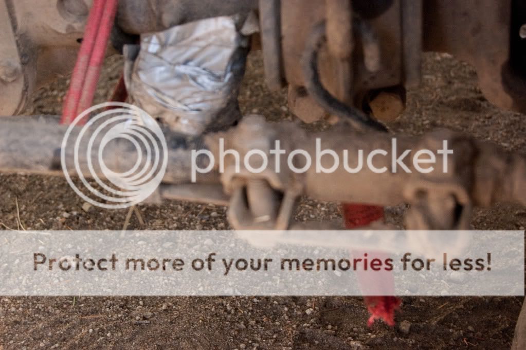

but then they would break...
1999 Ford Ranger Solid Axle Swap
i went with 4 rachet straps and came back with one. i was so glad that last one held out for me!
